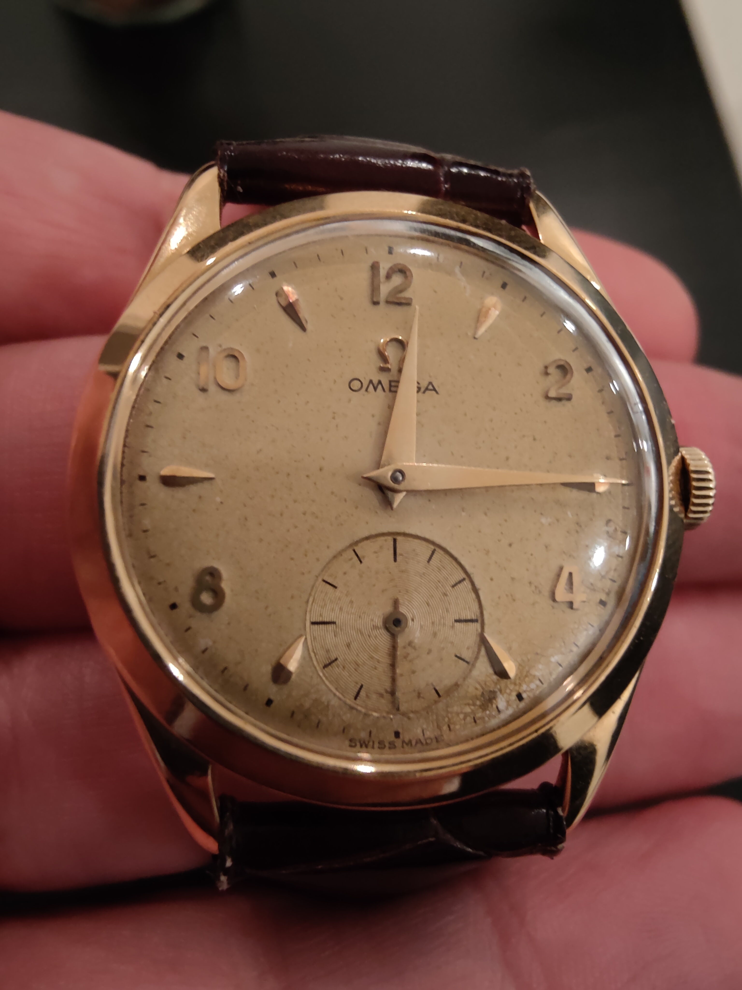

Well, my old sub second, cal 265 does quite well given that i don't even know the service history
Not to bad for an old vintage model

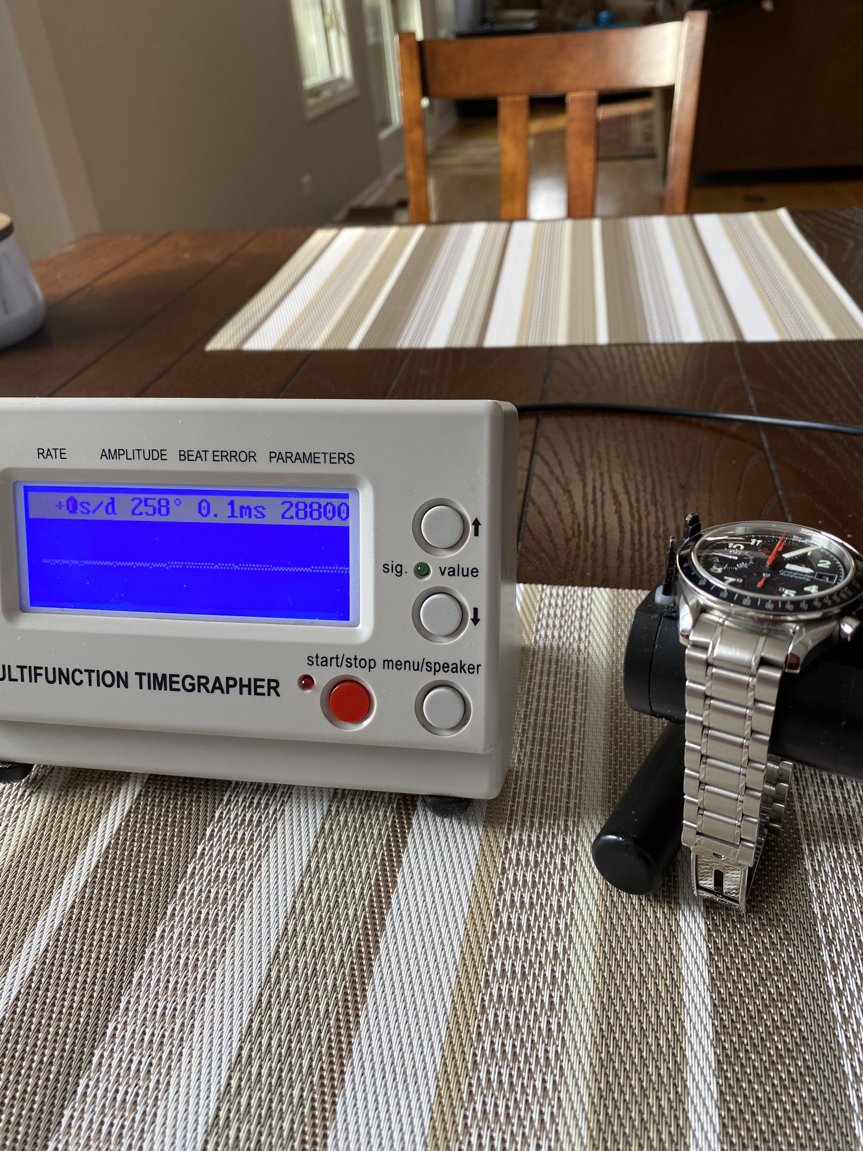

My 3861 Speedy is running at an about +1spd on my timegrapher. Its the most accurate watch I own.

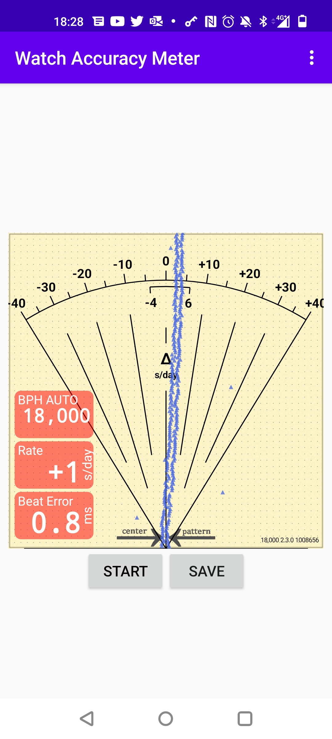

My basic skills at the timegrapher indicate 0 +\- at 49 lift angle for my new Mark 40 (1152 cal).
443
875

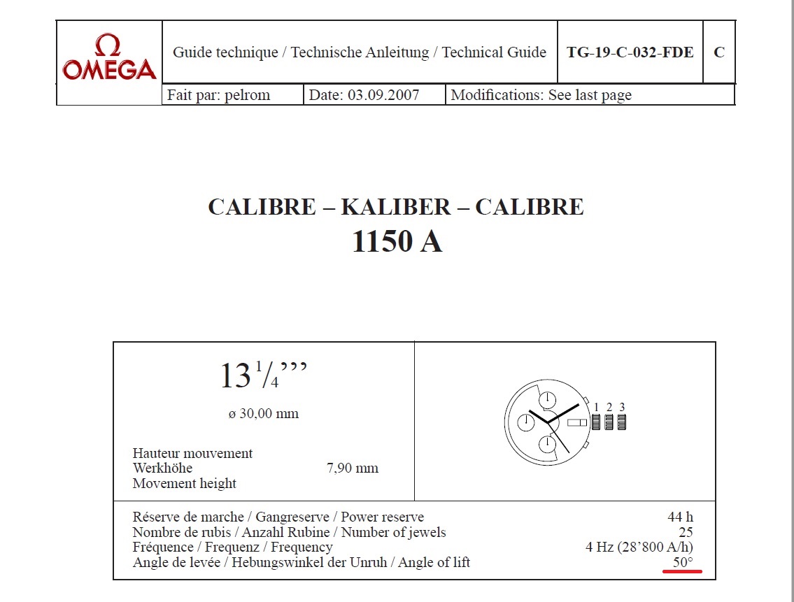

lift angle is 50 degrees on the 1152, but having the wrong lift angle will only affect the amplitude reading, and not affect the rate you are reading.

Thanks for the feedback. I’ve looked at several online resources that were all consistent about the lift angle for the 1152/7750. Which source do you recommend?

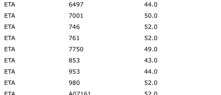

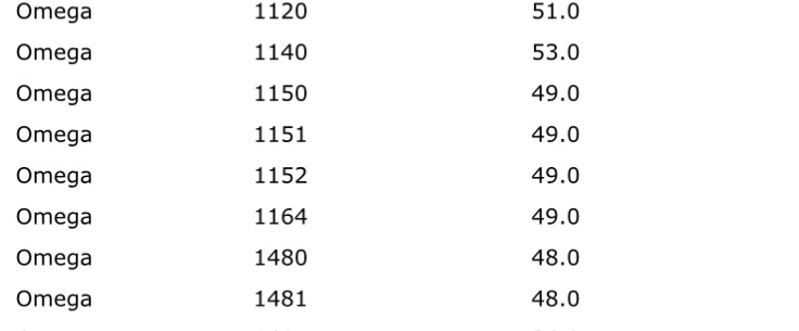

Not that big of a deal, but I’m fairly certain even UK watch guy says it’s 49°
You can believe Christian if you like, but I'll take Omega's word for it...
I didn't realise he had a database of lift angles, I was linking you to the omega manuals pdf's where it lists 50 degrees.
No big deal at all. Just curious about the variance…
