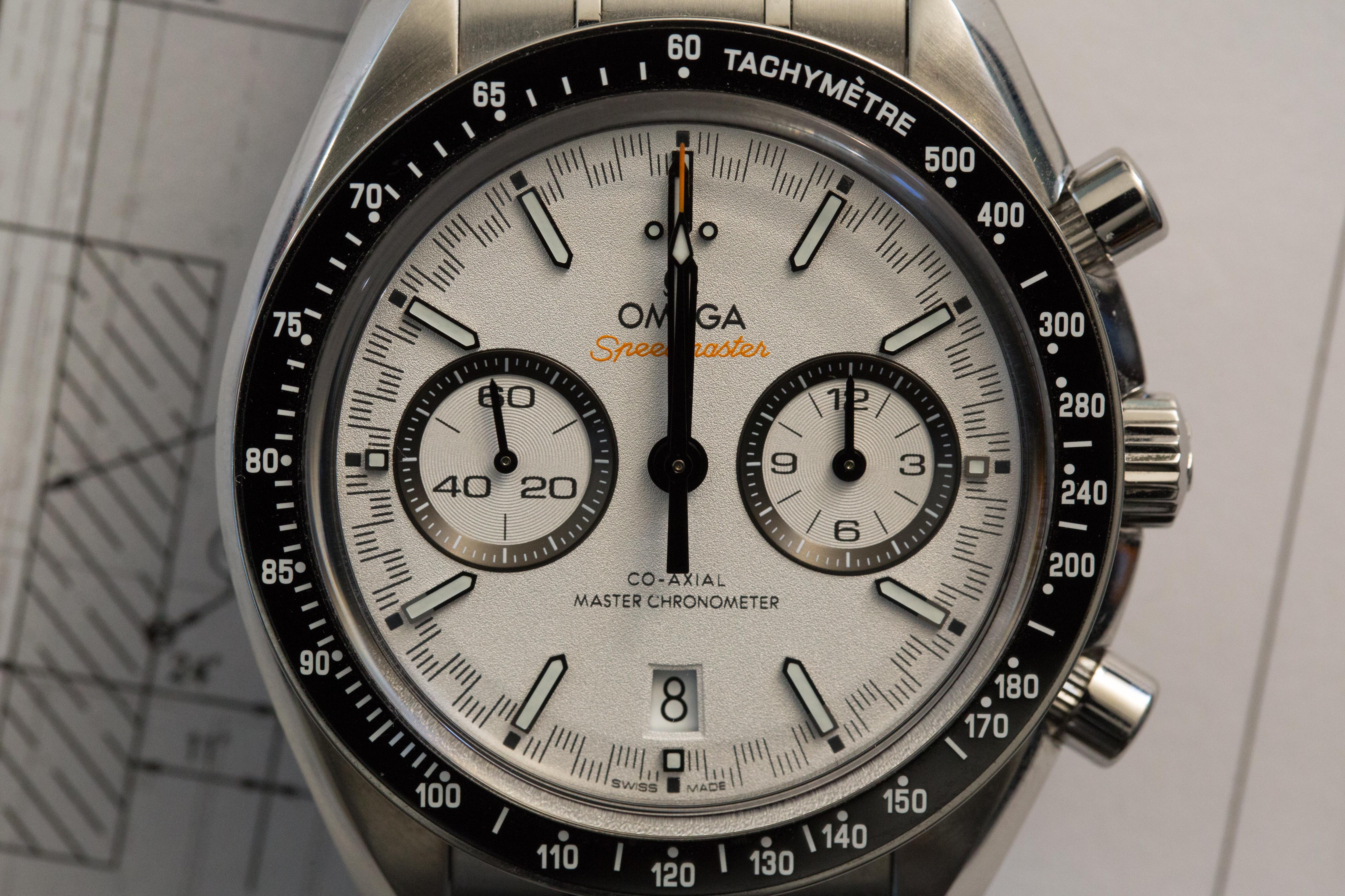

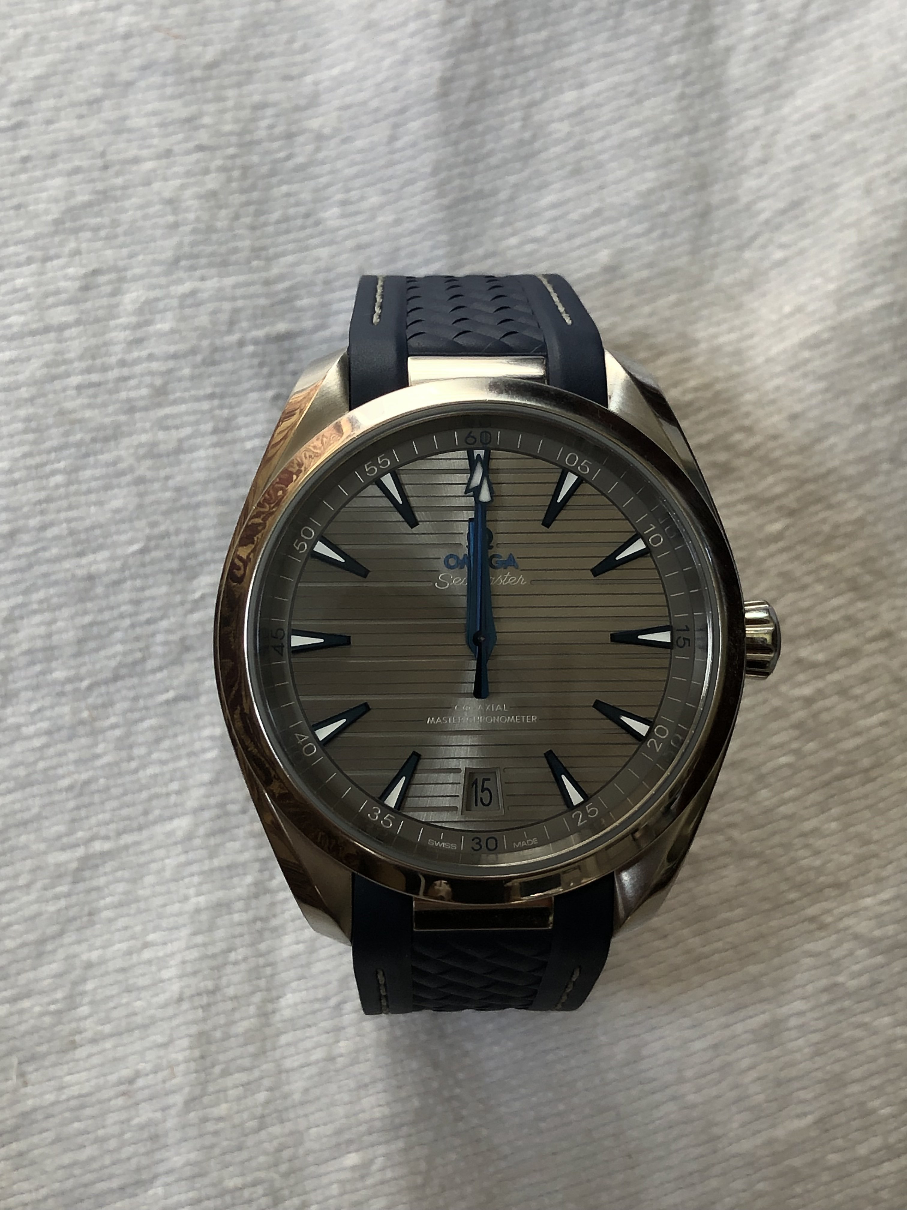

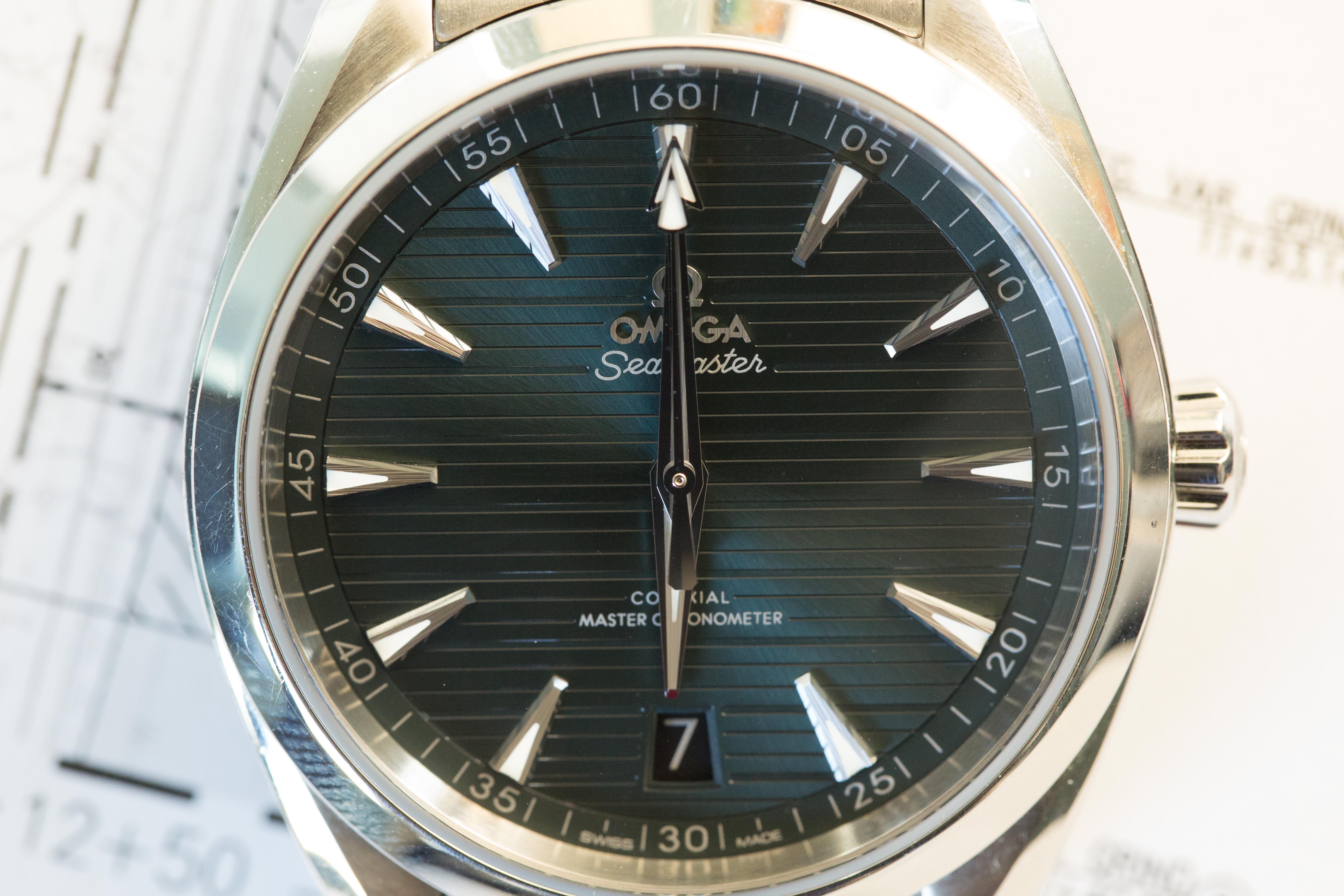

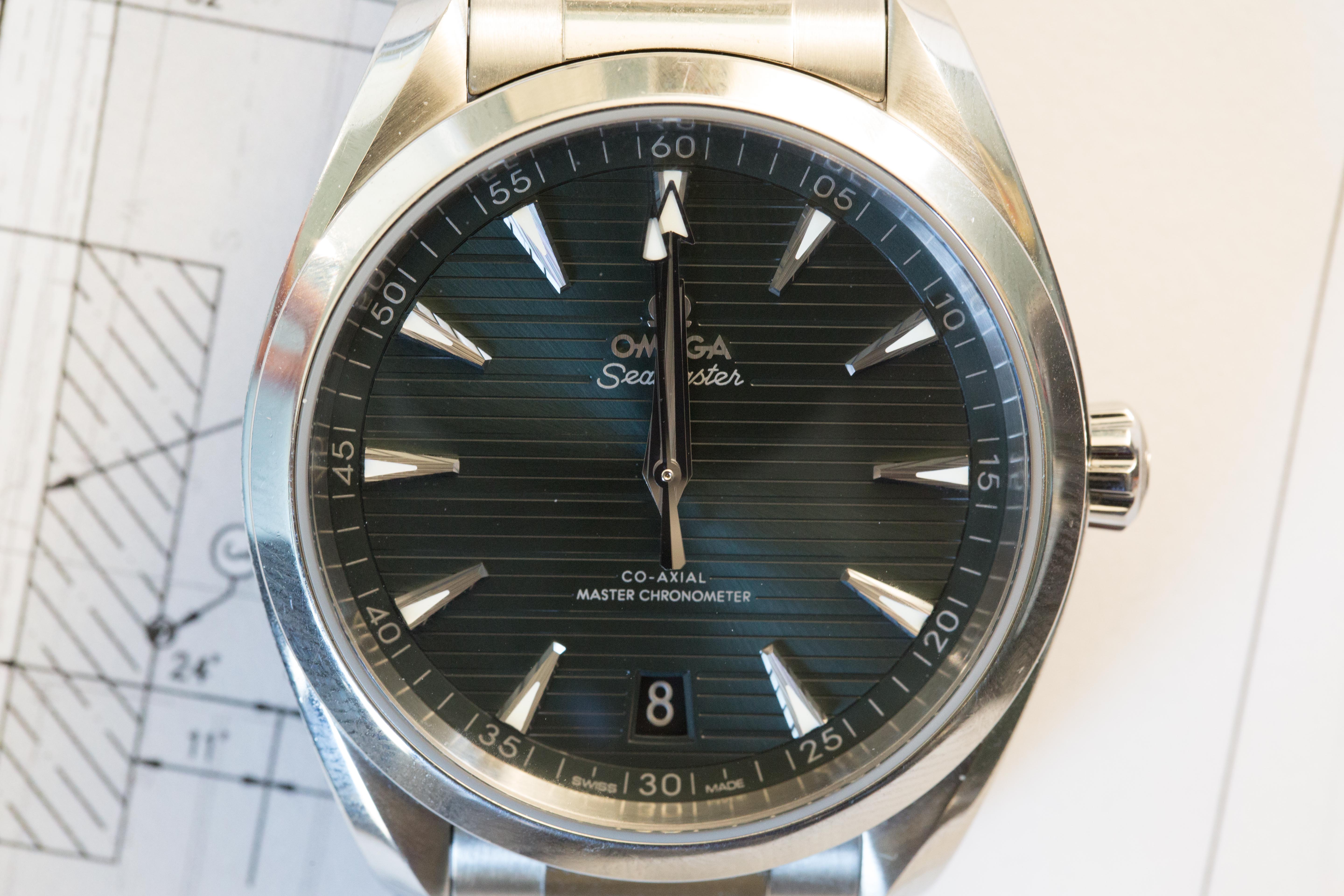

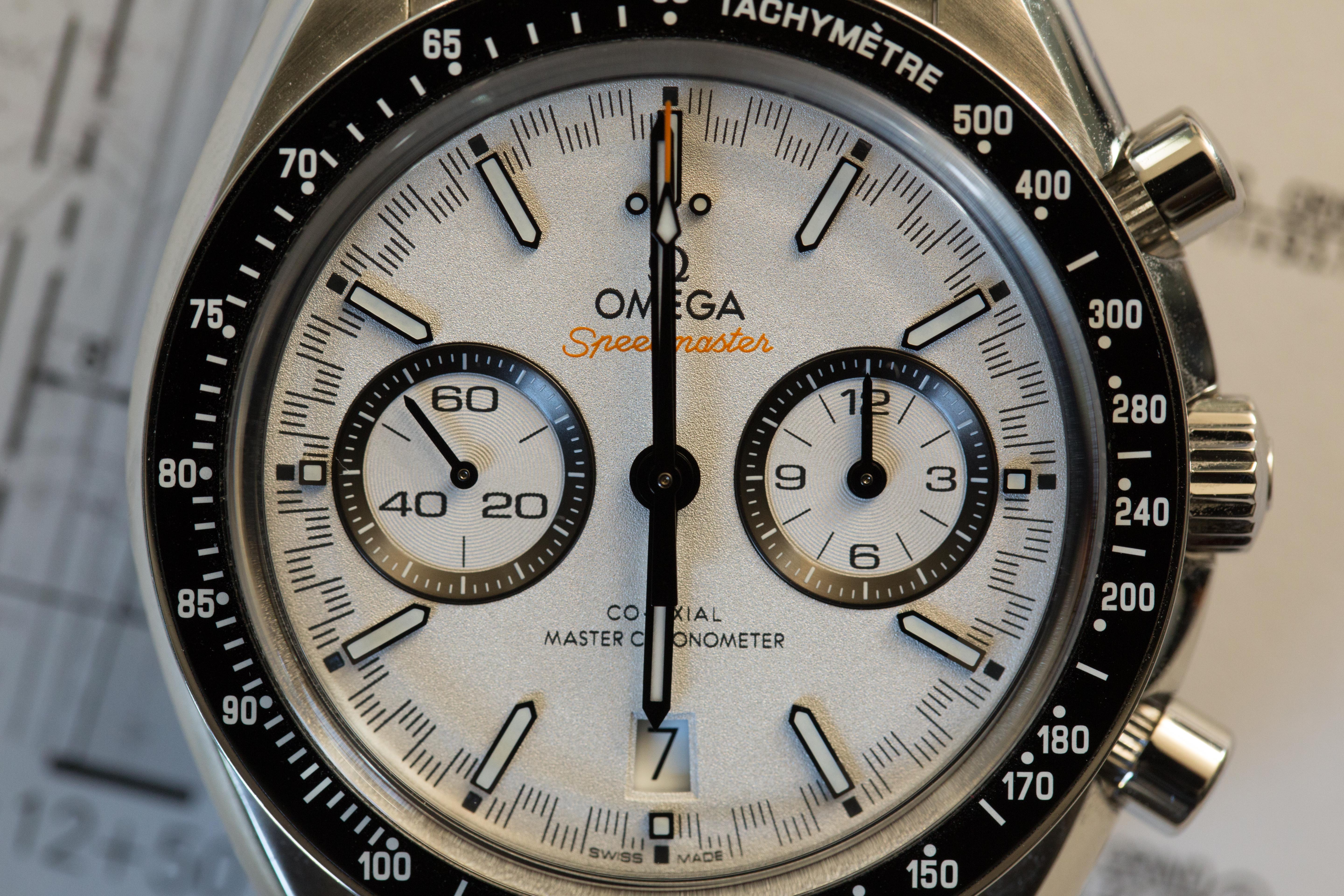

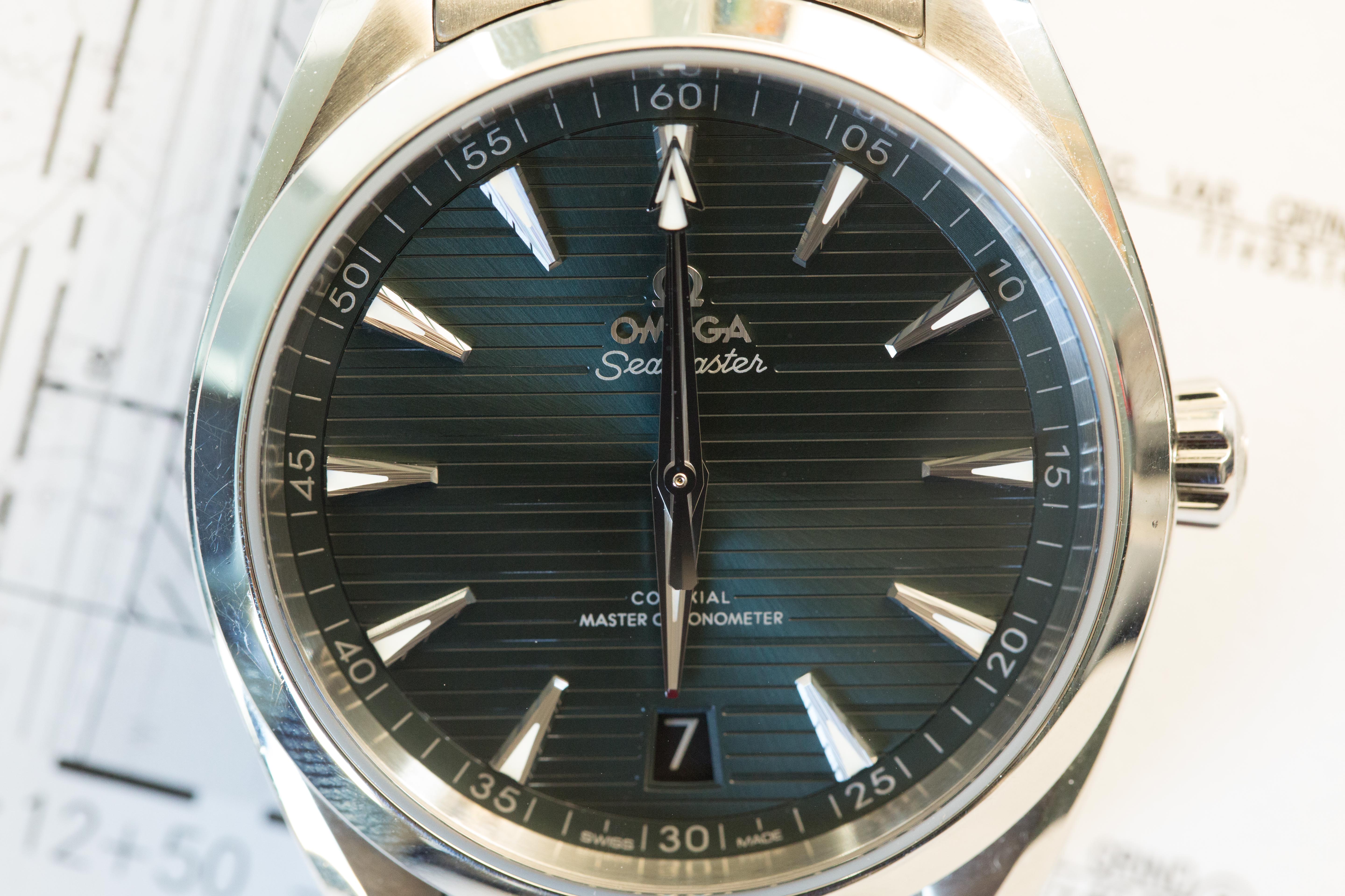

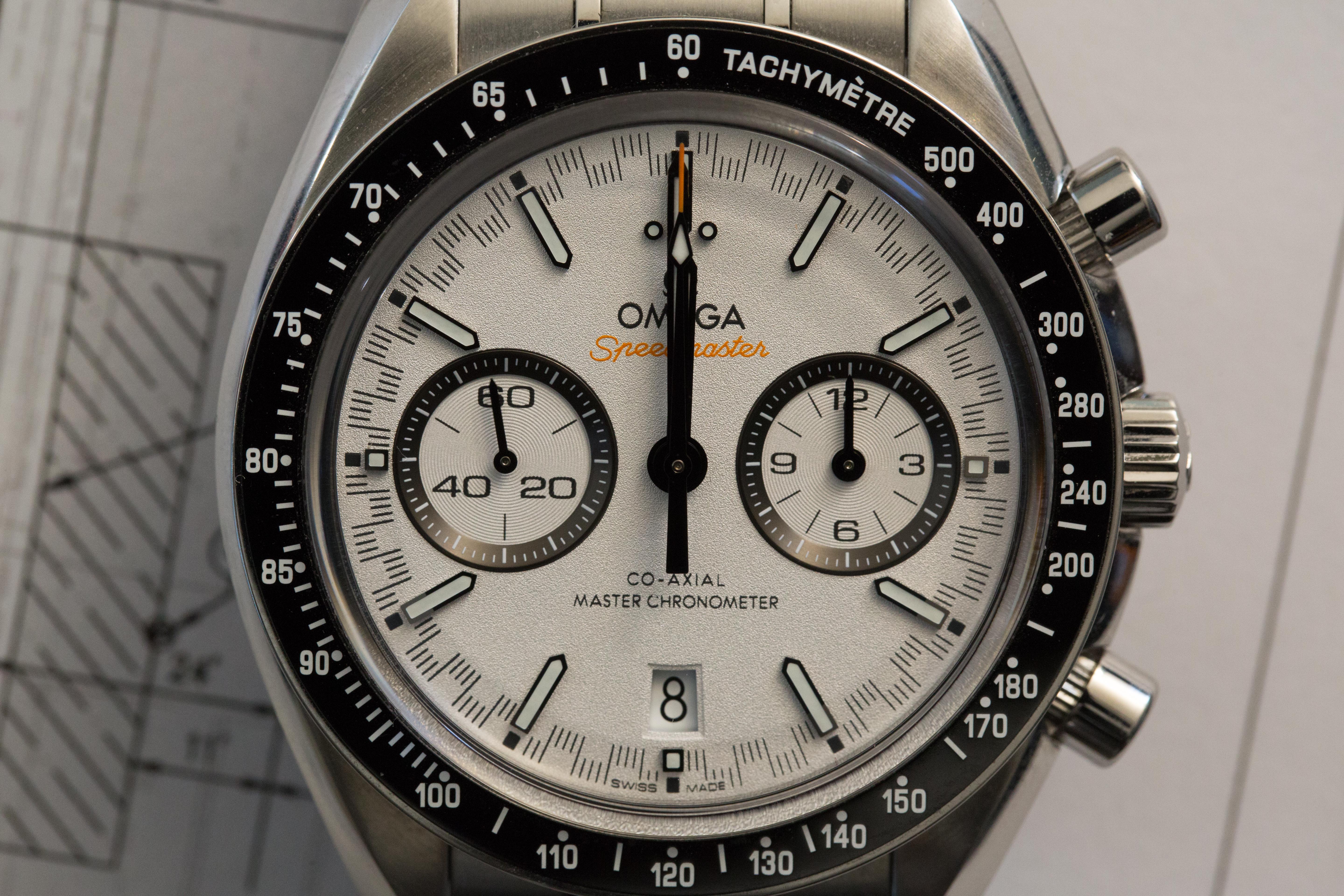

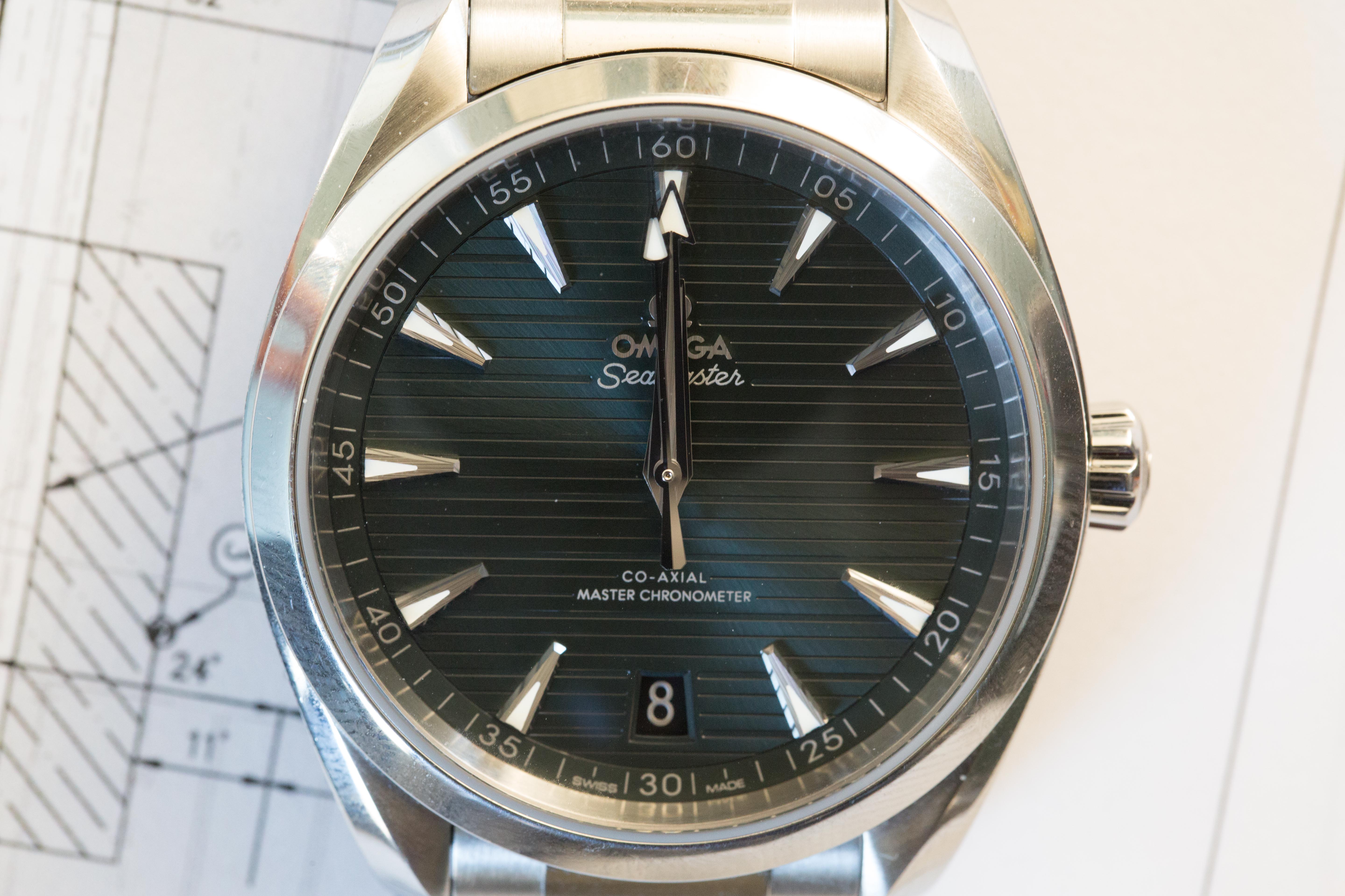

I've noticed on my Aqua Terra (8900) and Speedy Racing (9900) that the hour hands are slightly misaligned (it's more noticeable at the 6 o'clock vs.12 o'clock) and I was wondering if this is within Omega's specs? (I'd appreciate your input to know if it's changed, @Archer ). I purchased both of these watches last year so they are still under warranty. Is this common amongst movements that have the jumping hour hand feature? If I did wish for them be worked on, how does the watchmaker go about re-alignment (e.g., do they open it from the caseback?)? Thank you as always for your responses!
18,307
27,671
To fix you remove the hands and put them back in. So yes the back is opened and the movement removed.
to determine if it is in spec please post pictures with the slack out of the movement. Ie running for at least a minute after setting.

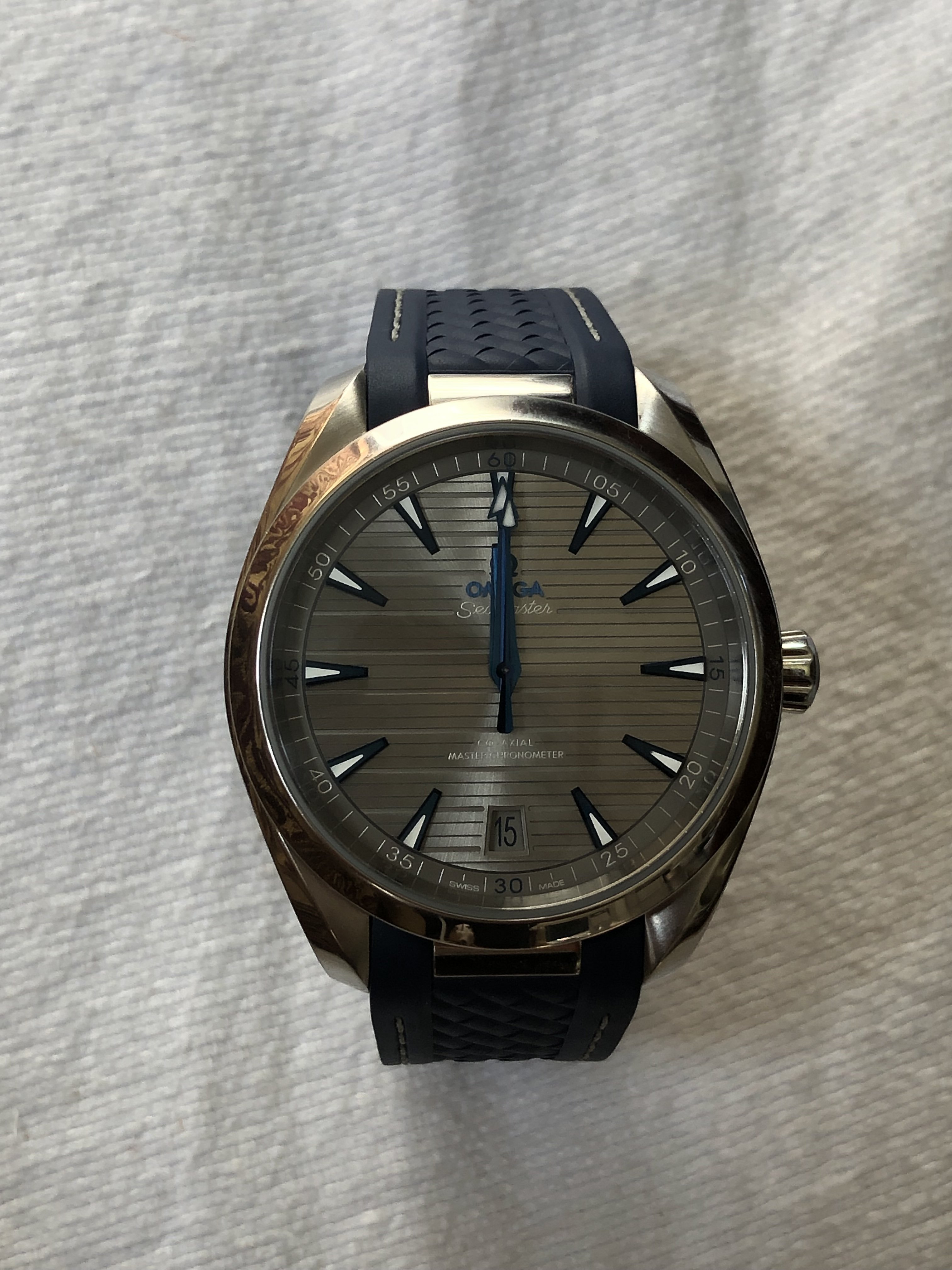

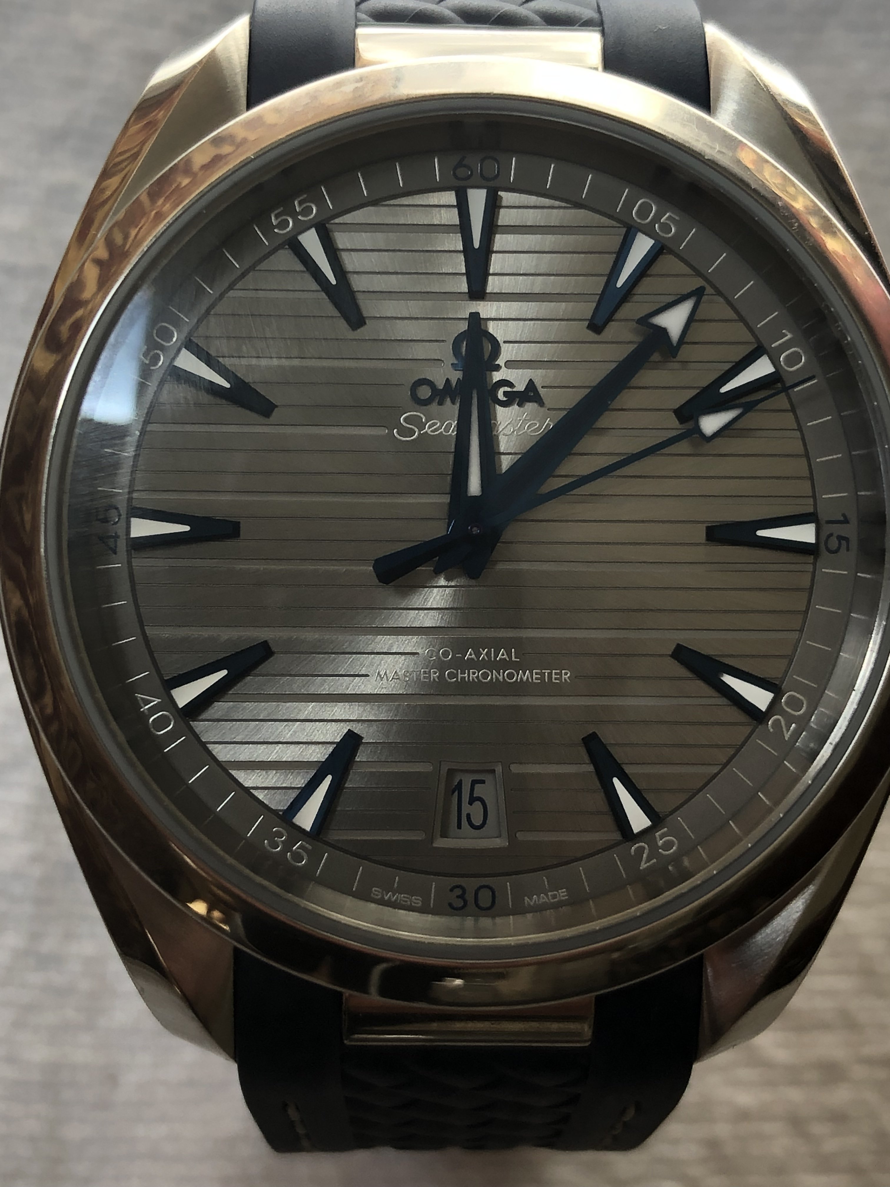

I found this issue to be common across modern Omegas in general. Both my Omegas have misaligned hour hands by varying margins (one is three minutes late, and the other one is two minutes late). And they don’t have jumping hour hands.
You could try fixing it, but it is a delicate process and things may go wrong. Your local service centre could also just say it’s “within tolerance”, which is what I was told (nonsensical excuse, honestly).
Share some pics for us to see how bad the misalignment is. If it’s less than two minutes, I would suggest simply waiting until your first service.

The hour hand on my Speedy 3861 is about +2min misaligned. It irritated me at first, but I don't regard it as being sufficiently noticeable to warrant dismantling the watch, which is working perfectly otherwise and I don't think about it now. Life is too short to sweat the small stuff! I will ask for it to be rectified at the first service.

If you show the watch with the hour hand at 12, I’ll tell you if I think Omega would fix it under warranty...

Thanks, Archer, but I'm sure it is within tolerance. The slight misalignment varies around the dial (presumably the hand spindle isn't precisely concentric with the dial) and at 10-12 o'clock the hour hand is actually spot-on the hour marker. it is only at around 2-3 and 7-8 o'clock that the hour hand points precisely to the hour marker about 2 minutes early. I only noticed it on my third day of owning the watch and although it annoyed me a bit at first I quickly came to accept it as just being one of the little 'quirks' of my watch. It's certainly not worth the hassle of sending it back to Omega who, in any case, would say that it's within spec.

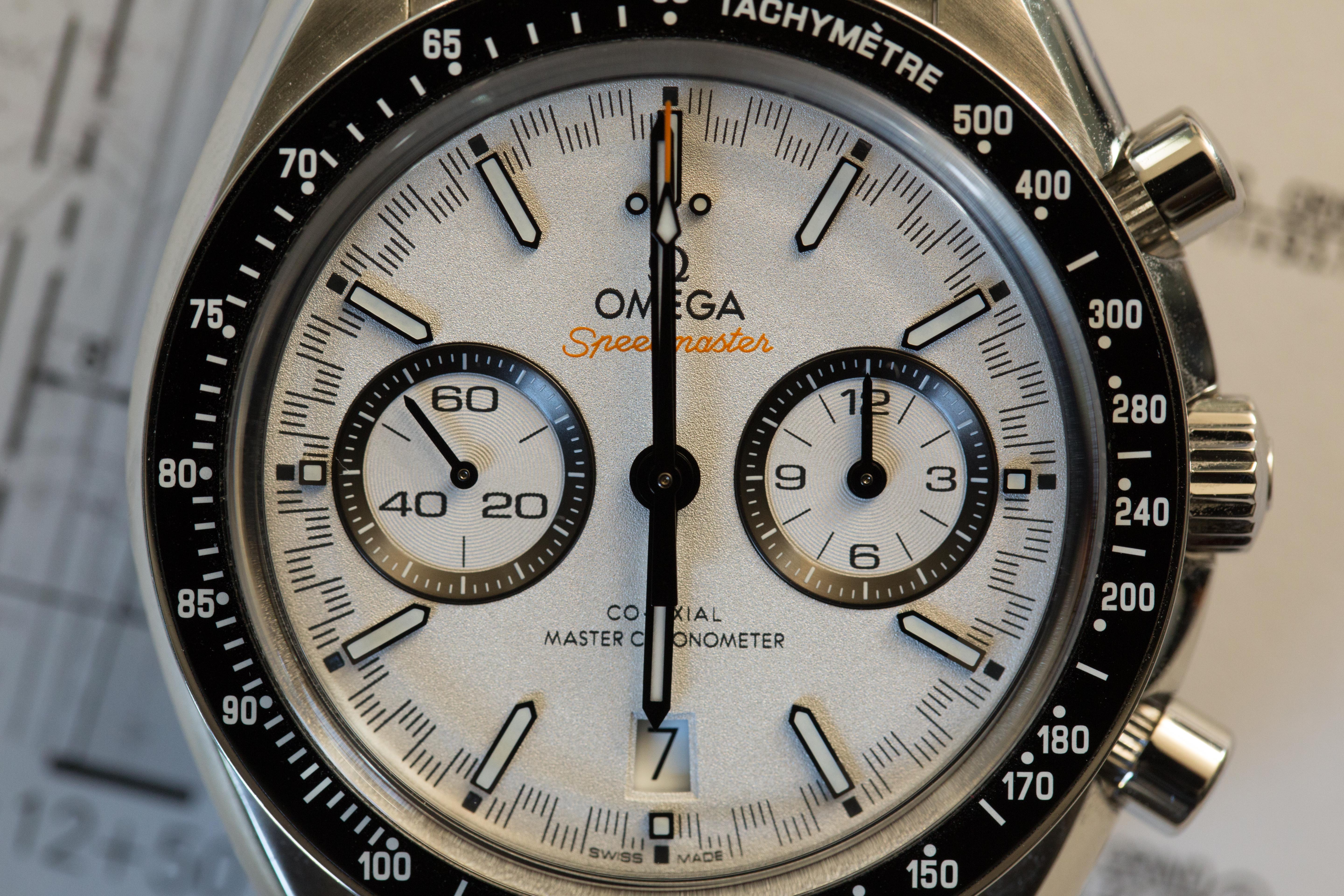

Sorry to bunp an old thread, but I was curious if my hour hand being misaligned would also fall within tolerance? It's not lined up until the minute hand reaches ~7min usually which seems a little bit off to me but I don't know if it's enough for Omega to take it for in warranty service.

Yes, that's way too far out. It will be fixed under warranty I expect, as long as the watch has warranty.
