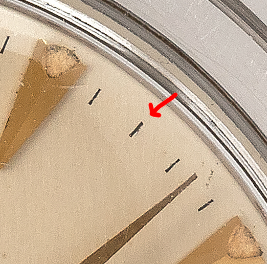

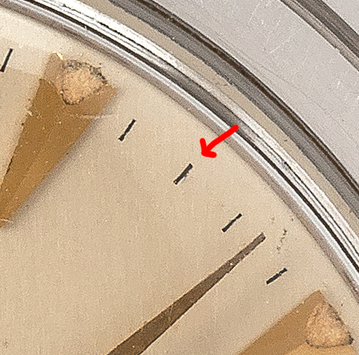

Back in the old day´s it was not uncommon with dials showing small imperfections, if you study samples there are imperfections in many Omega dials. (Example below.)
The dial is genuine in my opinion and the printing was done on the laquer. That´s why you can se this devastating result.

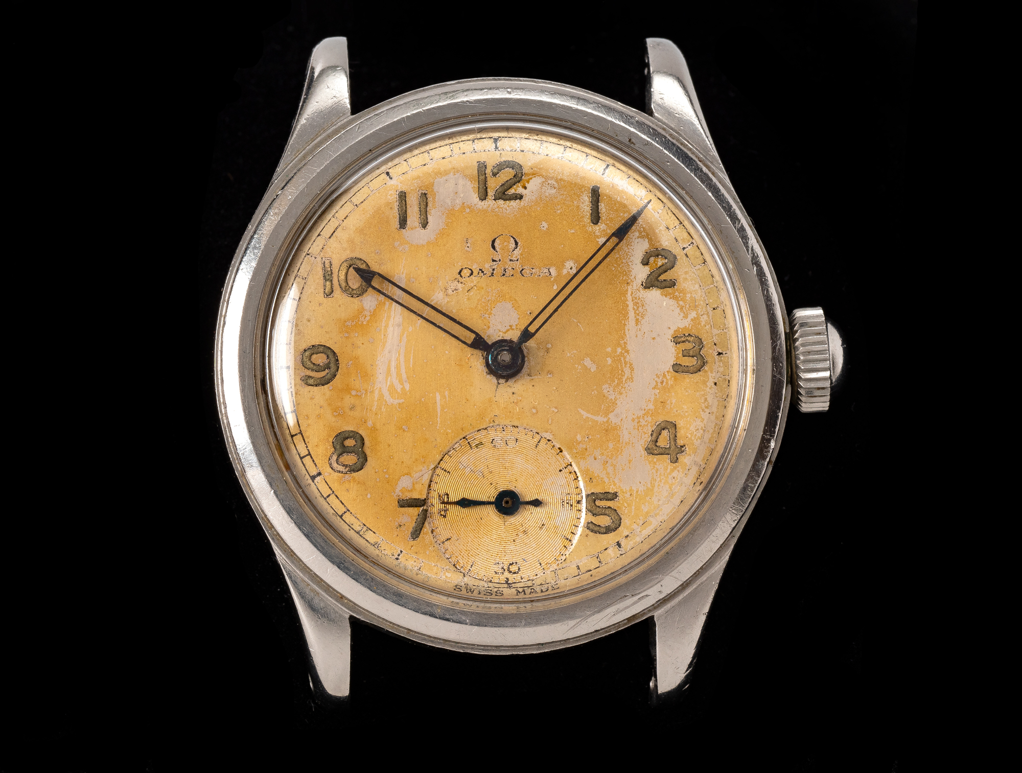

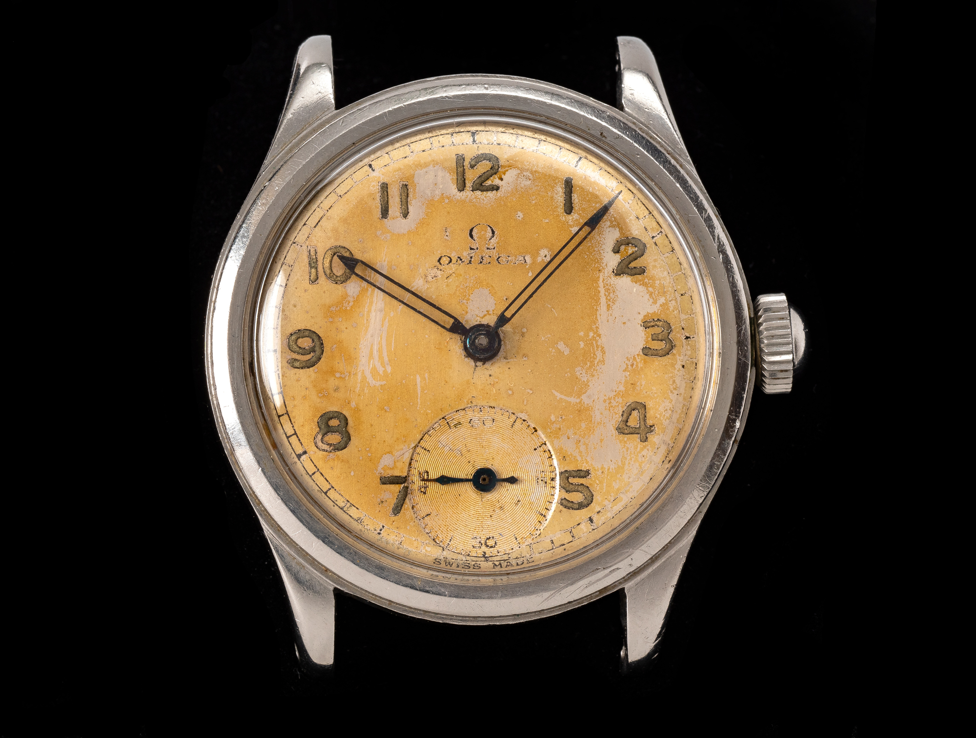

An Omega from around 1940 - flaking with loss of print.
Irregular printing of markers...

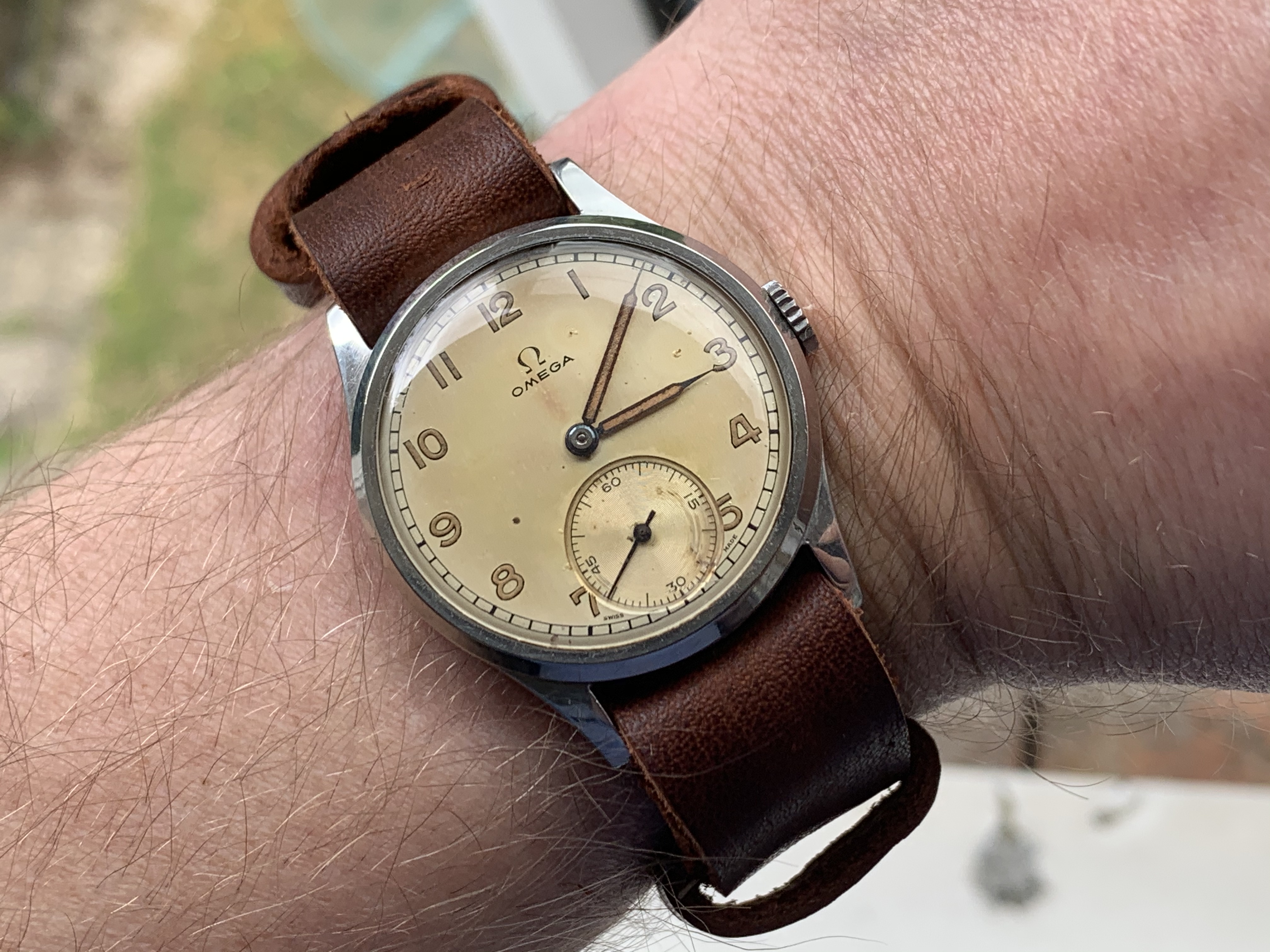

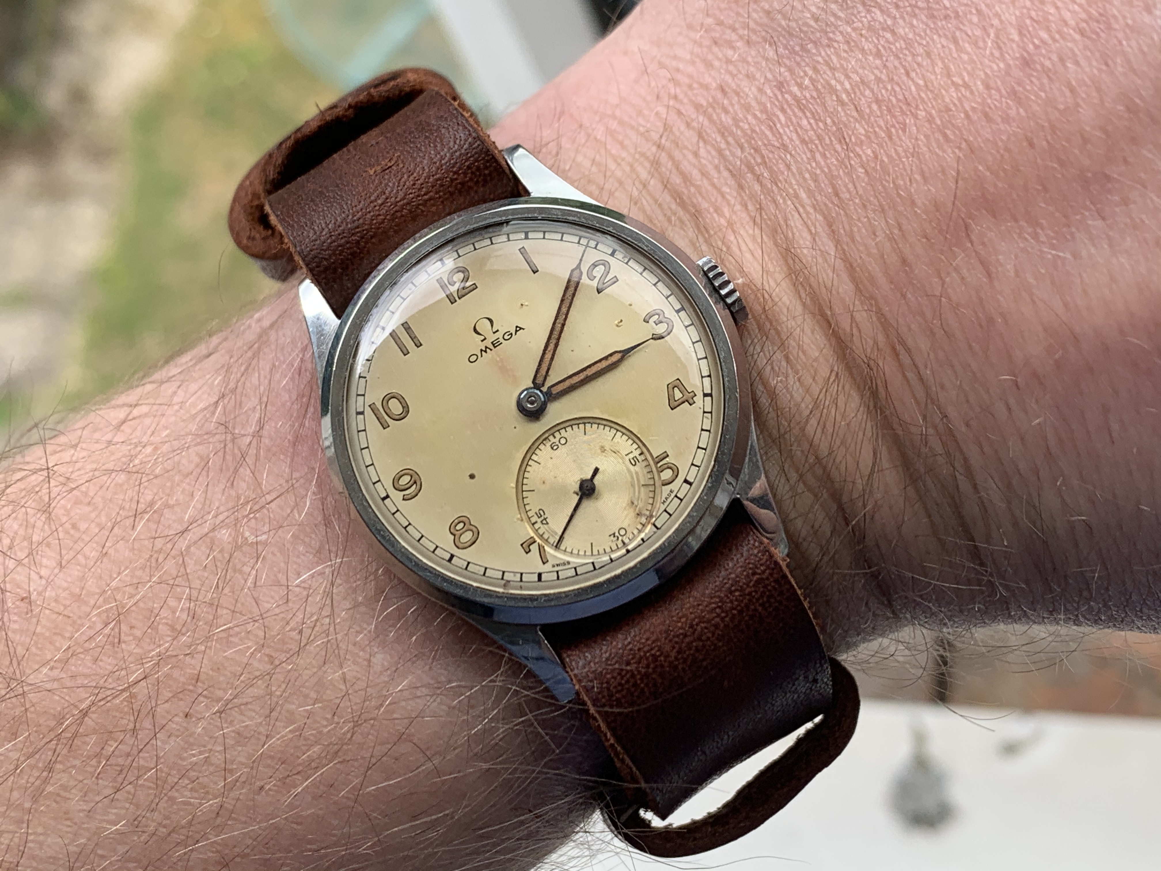

Hey guys thanks for all of your responses - I will have to do some more exploration into experts in this field. For those interested here is a before photo 🙁 Only recently got its new strap made by @Duracuir1
From that photo you can see a significant amount of damage in that exact spot already - looks like scraping. Sorry, but this looks like it was bound to finish up with a sub standard sub seconds dial.
