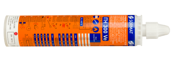

Just a hint to secure a safe to the wall or floor, use a thick 16-20mm and approx. 40cm long threaded stainless steel rod, and add two component vinylester expanding mass / glue in the hole. Will rip out sections of the wall before the bolt itself...

So how does it work - with this tool, they pry the safe away from the wall simply with leverage and ripping the self-expanding dowels (sorry, had to look up the translation to english, basically those plastic inserts that you fit the hole so the bolt threads into something)?
Just educating myself for a future possible carreer reconversion here 😁
You always have to bolt the safe to the wall studs and floor, not using toggle bolts or anchors in drywall.
