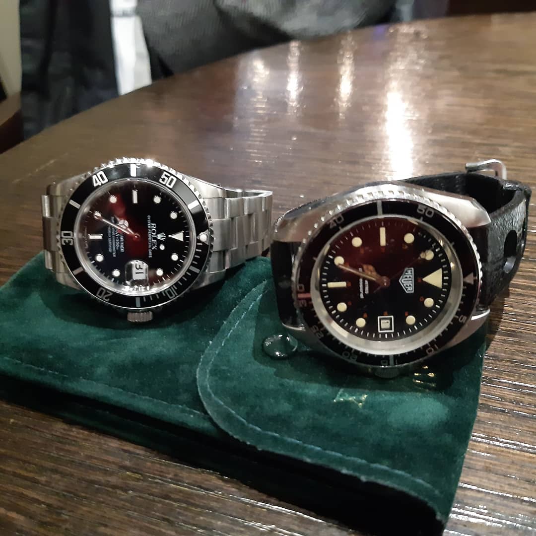

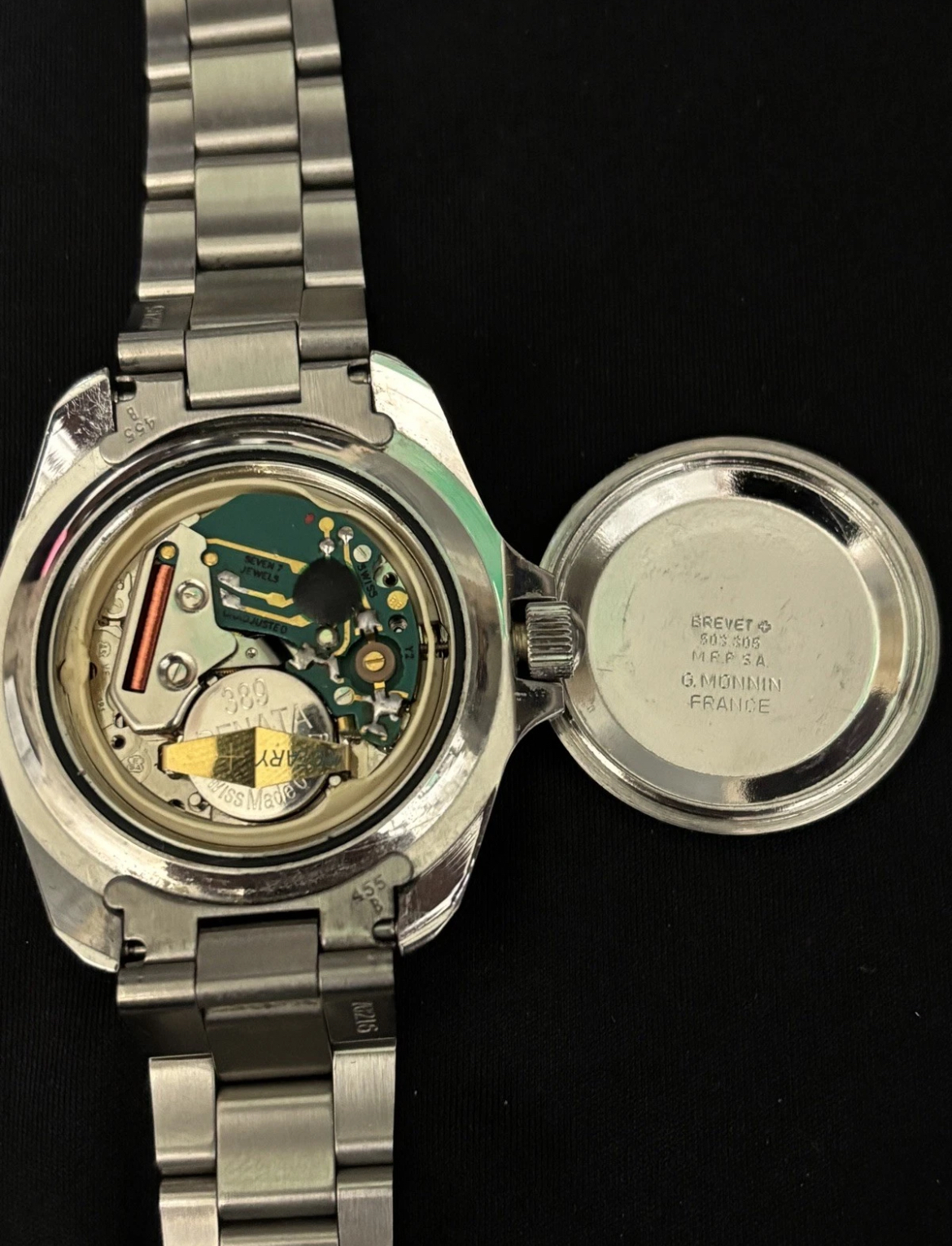

I’d suspect it’s put together. Bezel looks to be a Rolex style, and with a Monnin France dial would anticipate a FE Quartz movement. Some early Monnin Quarts had ESA movements such as ESA 9263 or 9362. Seems off that it would have ETA.
Having had a dig around I’d say it’s pretty similar to the 980.xxx series. The 980.006N shares the ETA 955.114 movement and the 980.013L has a similar submariner style bezel.

Both the models you reference are Swiss made Heuer/Tag Heuer, with Swiss dials and Swiss movements. The watch you showed has a Monnin style made in France dial, Swiss movement and Rolex style bezel insert. It shares a resemblance, as I suspect the person who put it together was aiming for that. If it was a late 70's/early 80's Monnin, it would either have an FE quartz or ESA quartz as noted. It would also have the proper bezel - all be it it could have been replaced at some point, but its still incorrect. There are no share of fake dialed Heuer Monnin's out there, and it's not entirely surprising given they go $3-$3.5K for a authentic one. Scammers try and take advantage of this (as with many popular watches) and either put together Franken's or out right fakes to sell. Always best to consult opinions prior to purchasing any piece you may be unsure of.

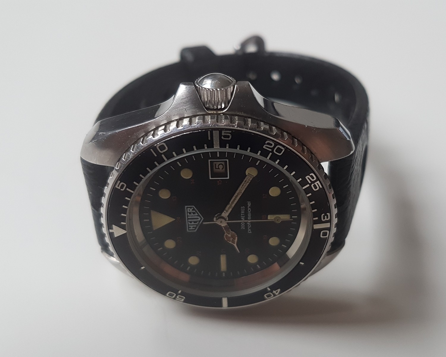

I received one of those for my 16th birthday. It was made in France and has the cathedral hour hand, which was later updated to the Mercedes hand. It's been serviced, but everything is original, with the exception of the crown. Mine is number 6069, so I believe it could be one of the prototypes. It runs well and keeps excellent time to this day.

The seller was in no way a scammer. Price was low and there was 100% no intention to mislead. Back in 2016 they were clearing out old stock (they were one of the middle sized French manufacturers, with strong connections to Breitling, Lip/Blancpain and LeJour, and others), and were selling completely original and very rare parts for pennies. I jumped on the lot of three quartz watches as they were inexpensive, and they made no indication other than it was old stock.
So whilst I completely agree with what you’ve said (in most case), I think that there could be more too this than you’d expect. I mean the complete watch only cost three times the wholesale price of it’s movement.

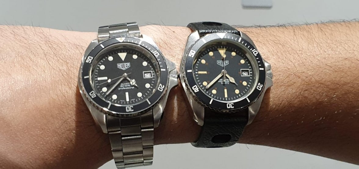

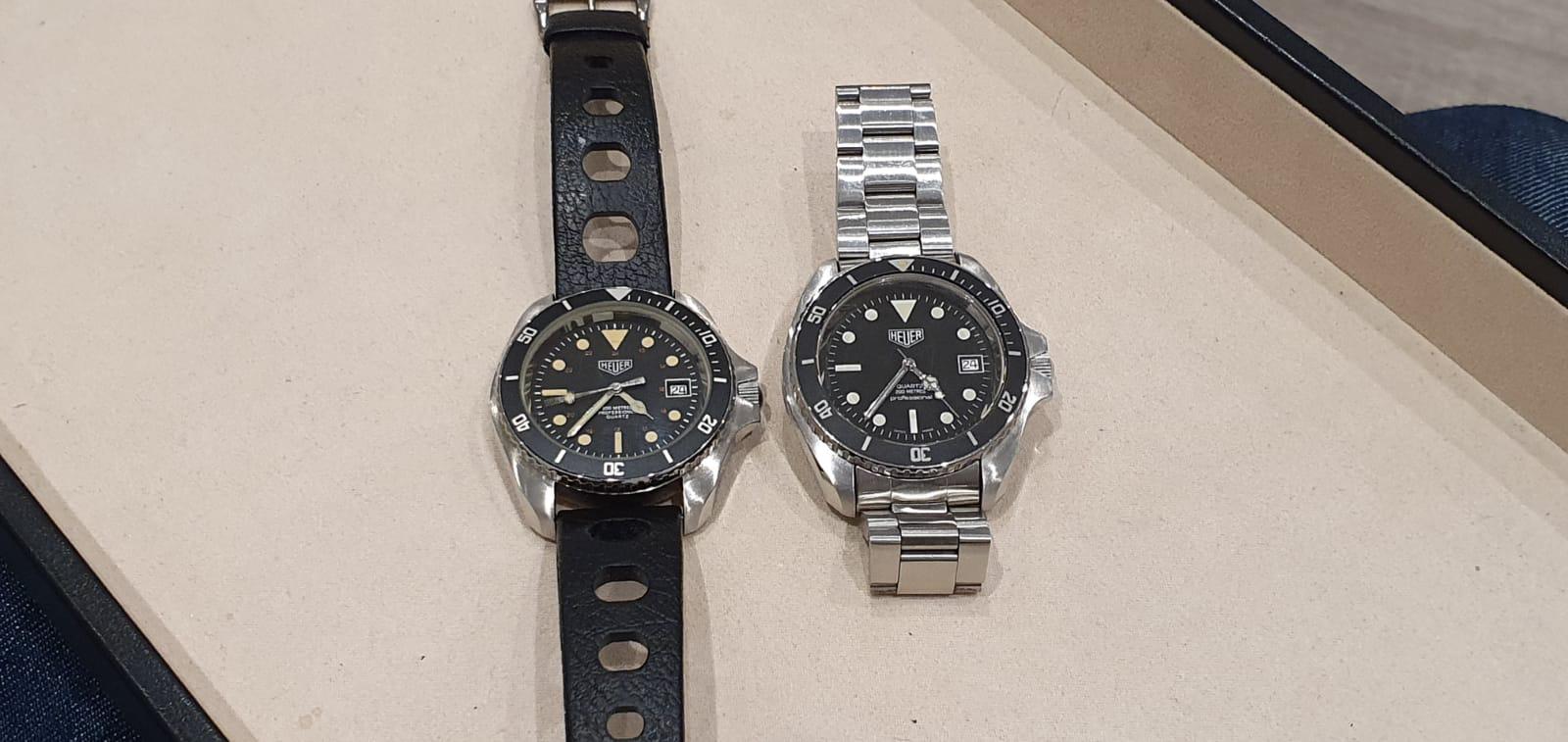

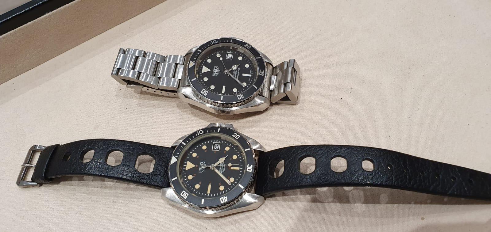

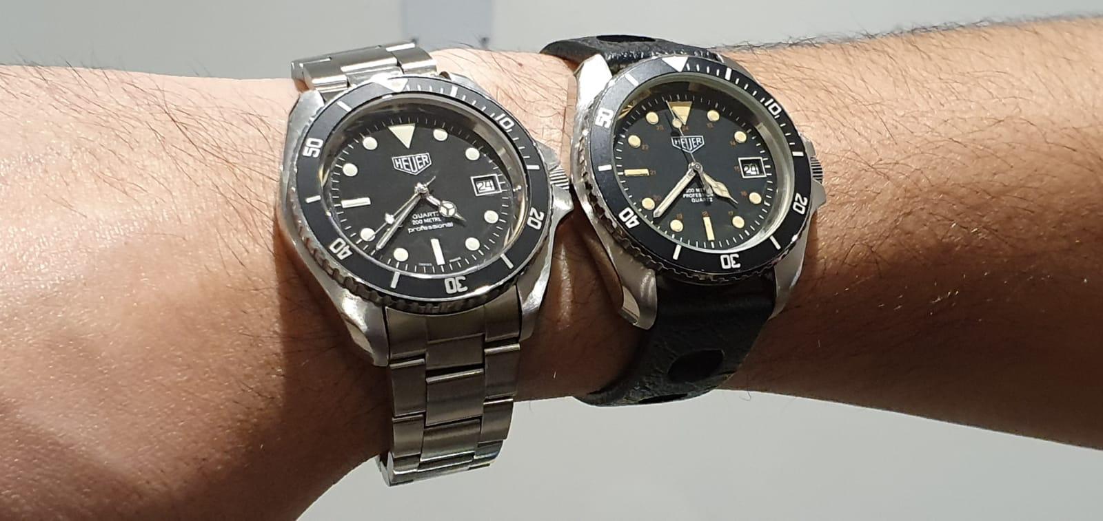

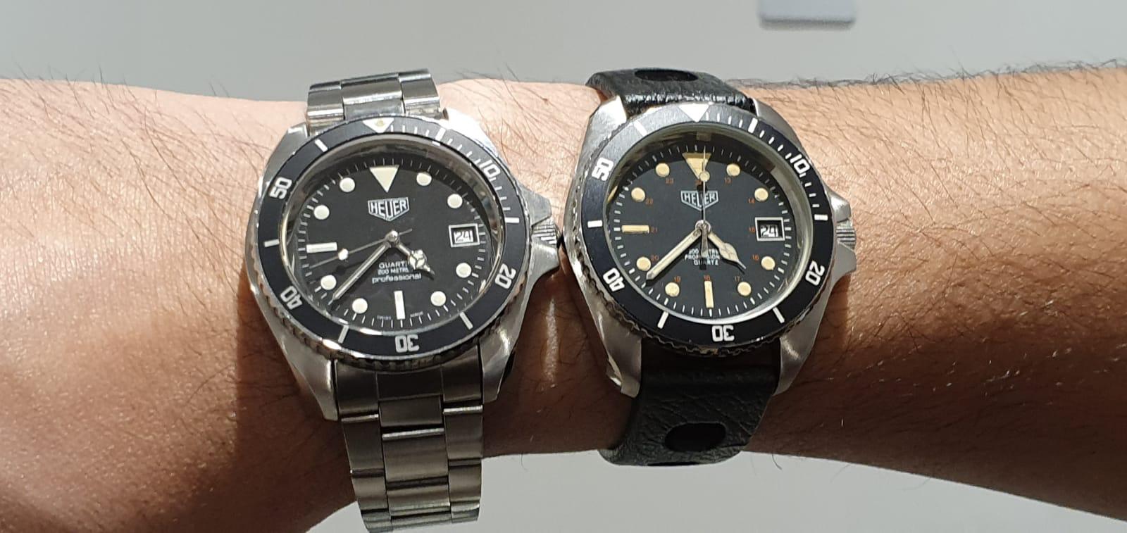

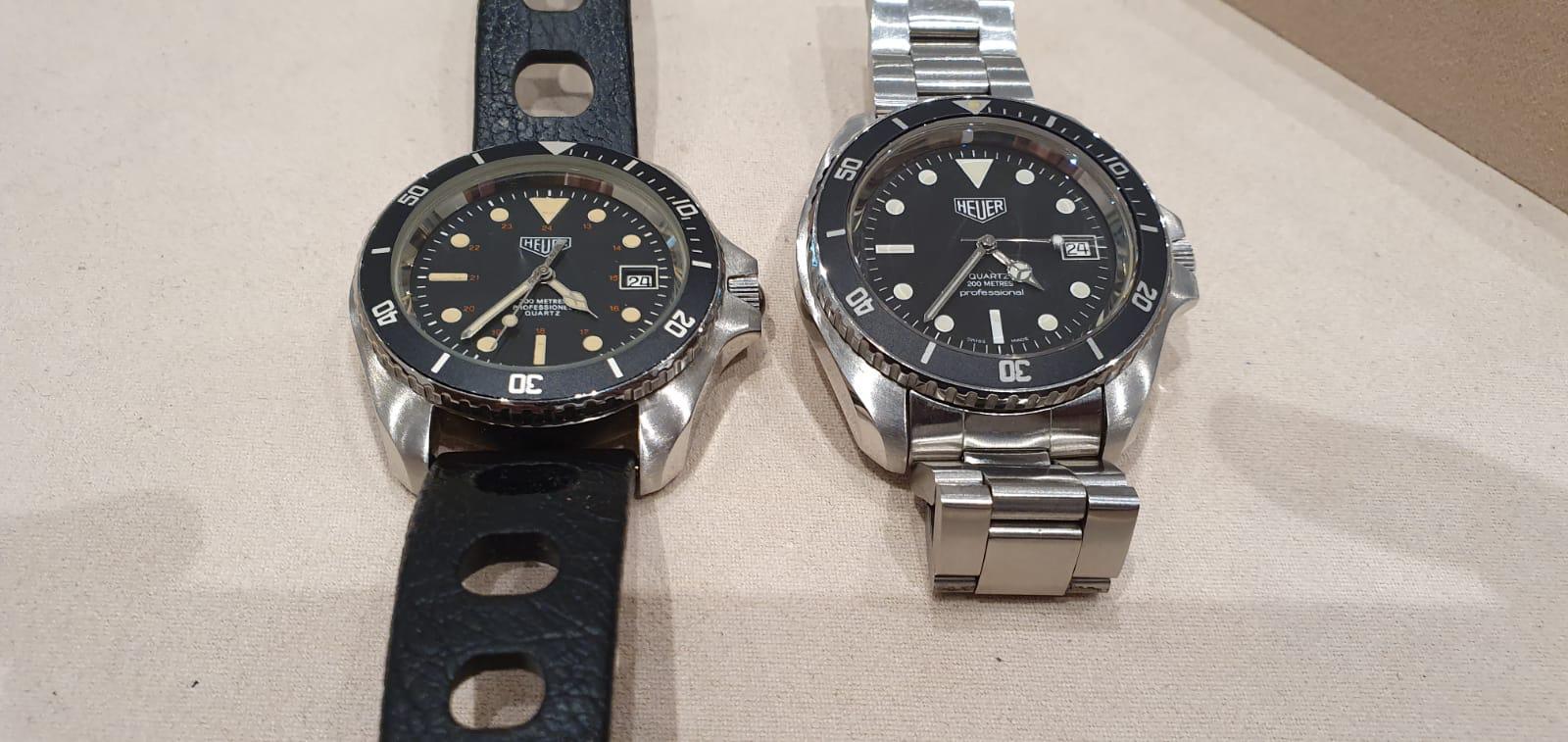

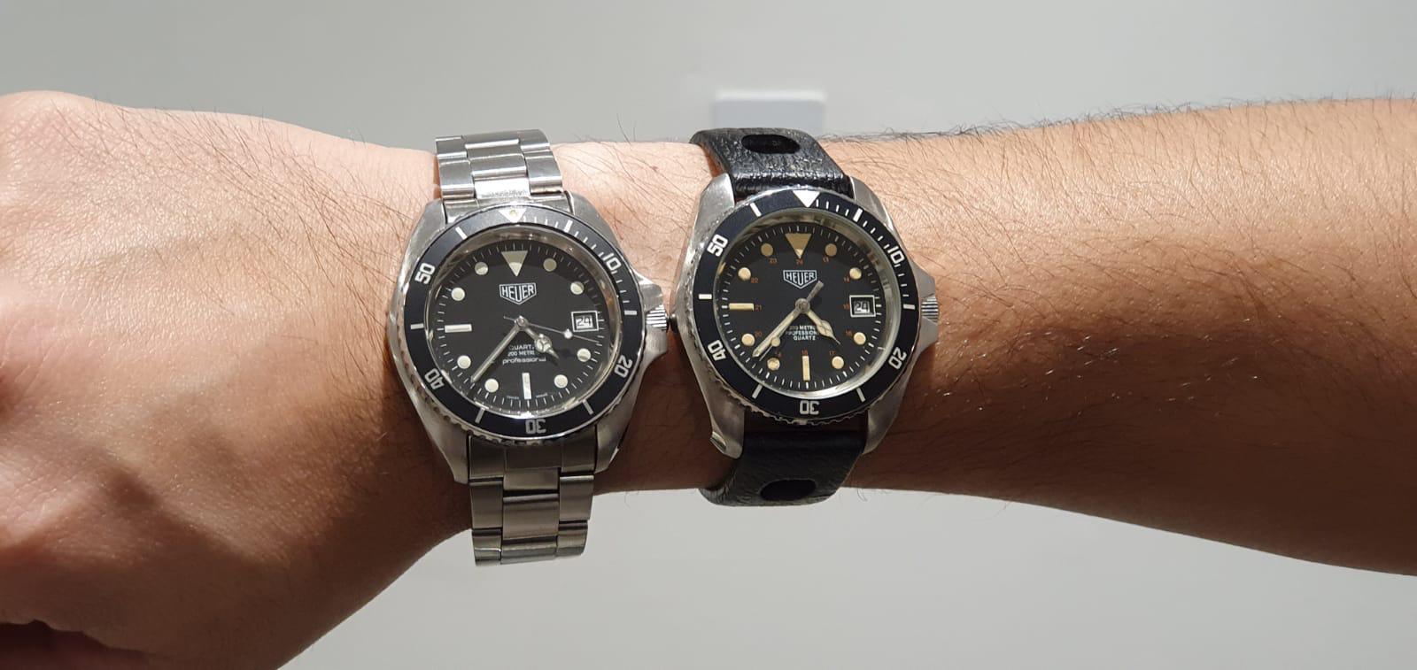

Here are the pics after full restoration to like new condition. They werent far off to start with. Classy Watches, loved the whole restoration project.

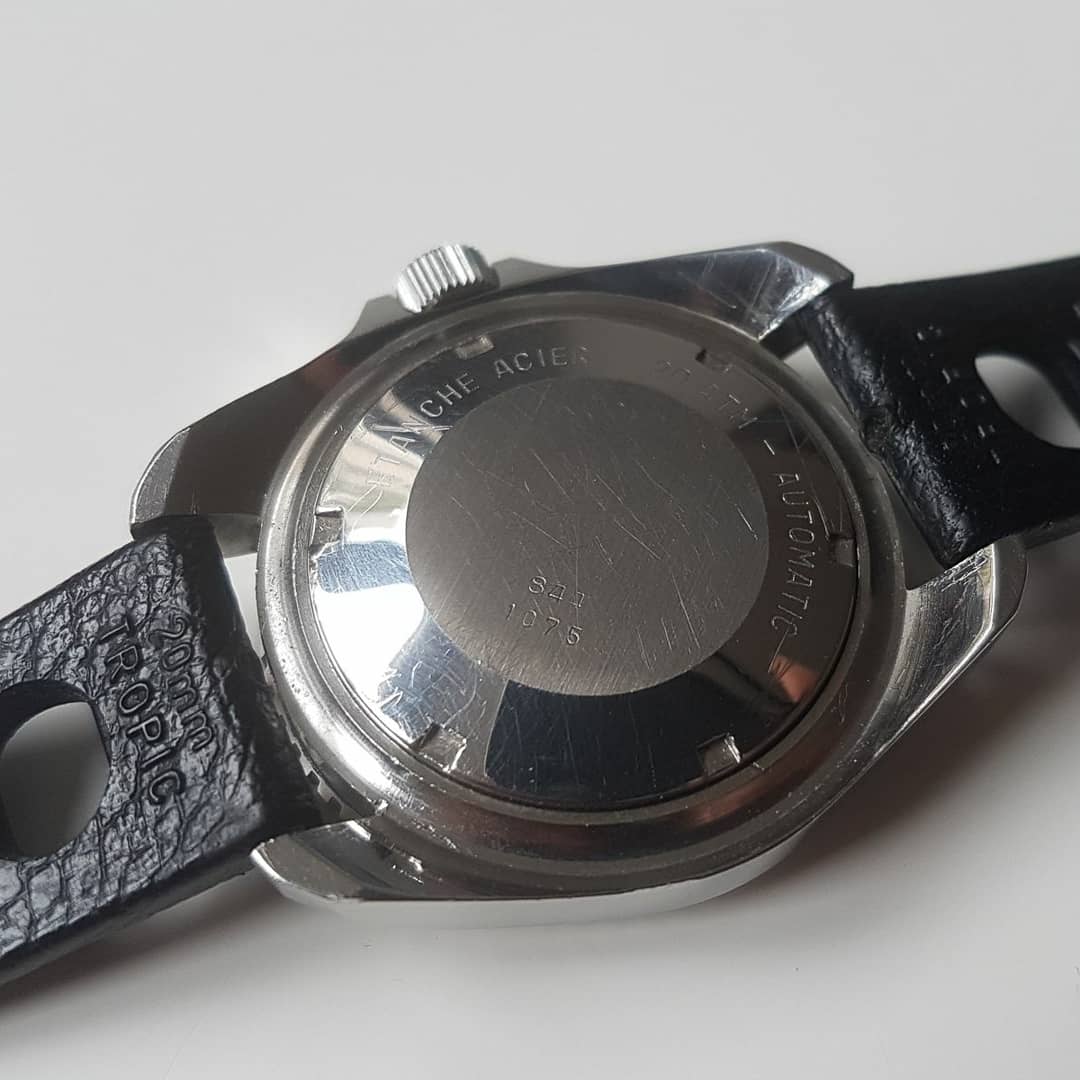

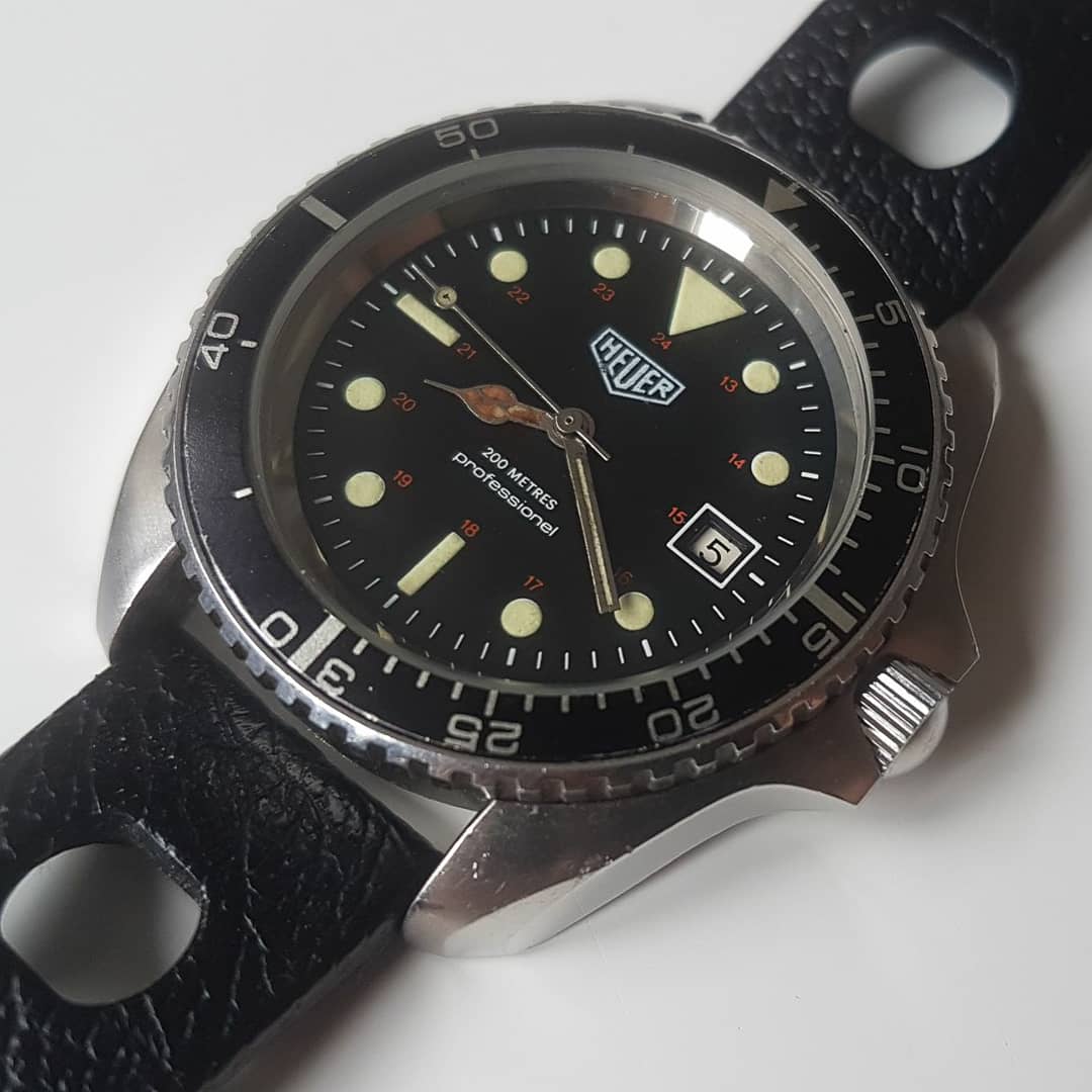

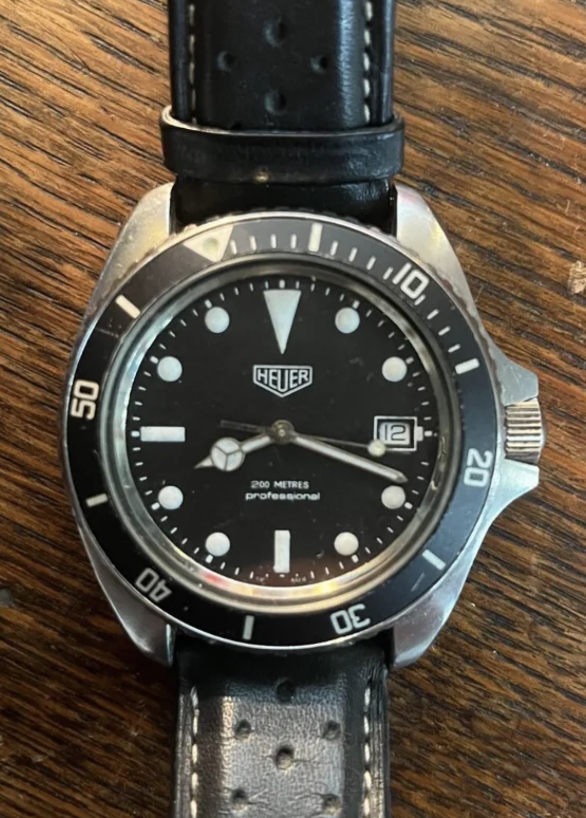

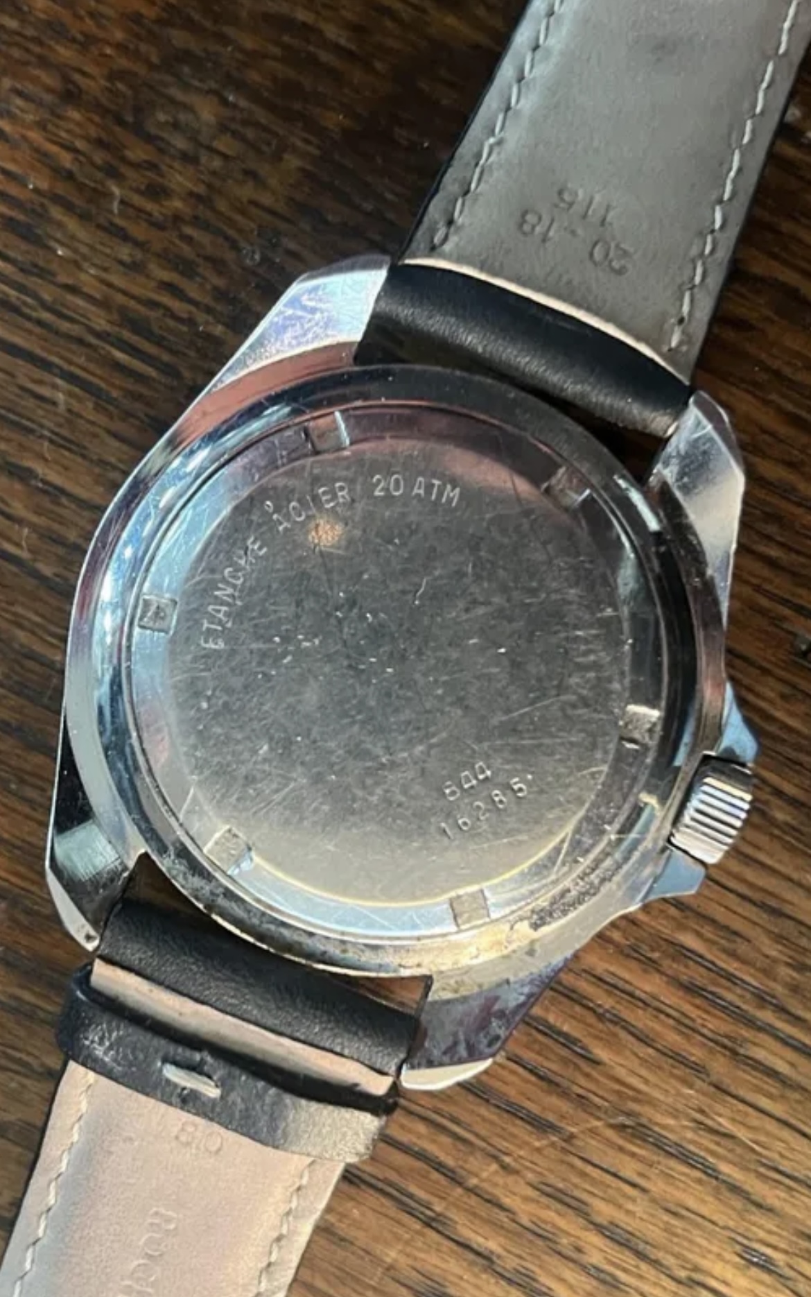

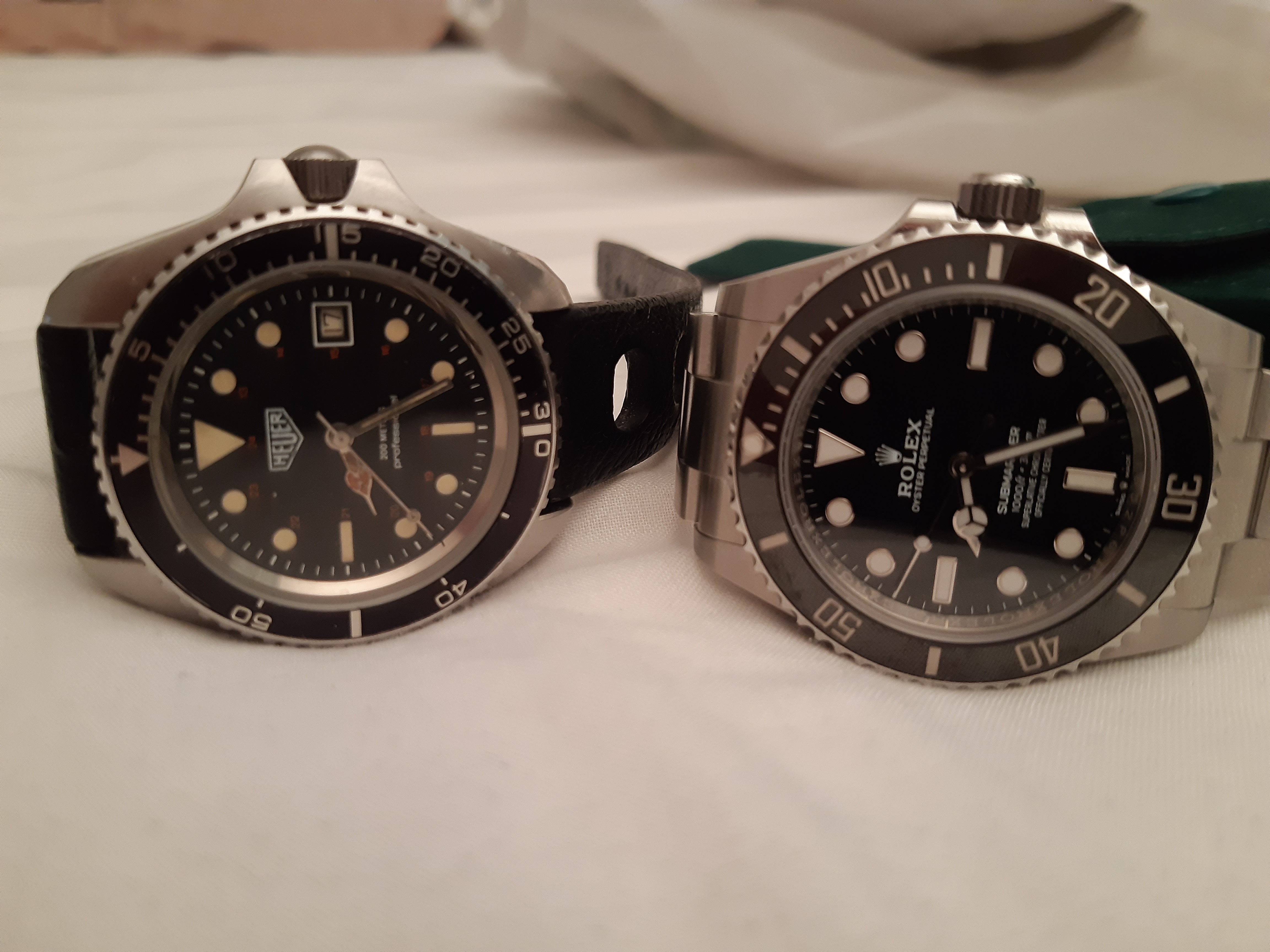

Hello Guys,
can anybody help me?
I’ve found that watch in my grandfathers drawer that seems to be a Monnin 844.
But I have never seen a dial like that one.
Is it a genuine/original watch, or a redial/fake?
i hope so much someone can help me with my struggle.

<Hi,
case is good,dial is from new taype,with redial plots.
best reg
bassem

Hi, I don't think this started life as a Heuer but another brand 844. (Of which there are many.) The dial is refinished and while the case is the same used across this type, the caseback isn't one used by Heuer.
If you look under a strong light at a certain angle, you MAY be able to make out another name on the dial.
Thanks, Steve

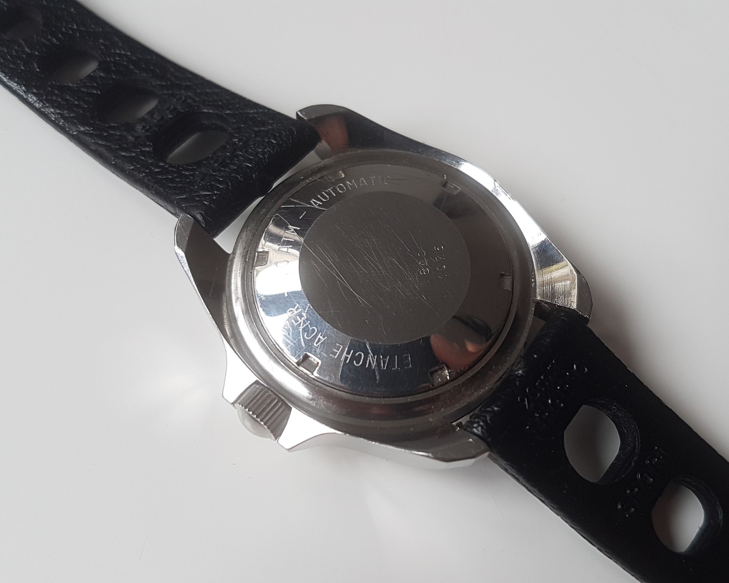

Thanks, Steve
833
1,564
case is ok
Yes Bassem, as I say the case itself was used by Heuer and others so looks OK, however the caseback is completely different as you can see. It may be that the dial is original but it doesn't look right to me. Either way it has been refinished beyond repair now, not just the lume plots sadly.

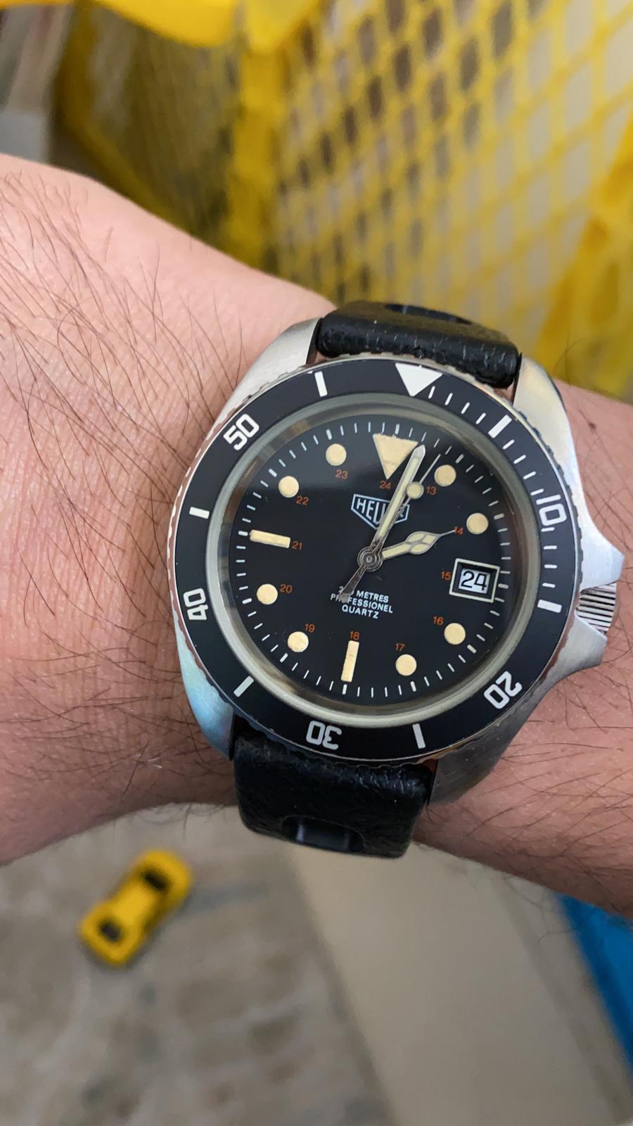

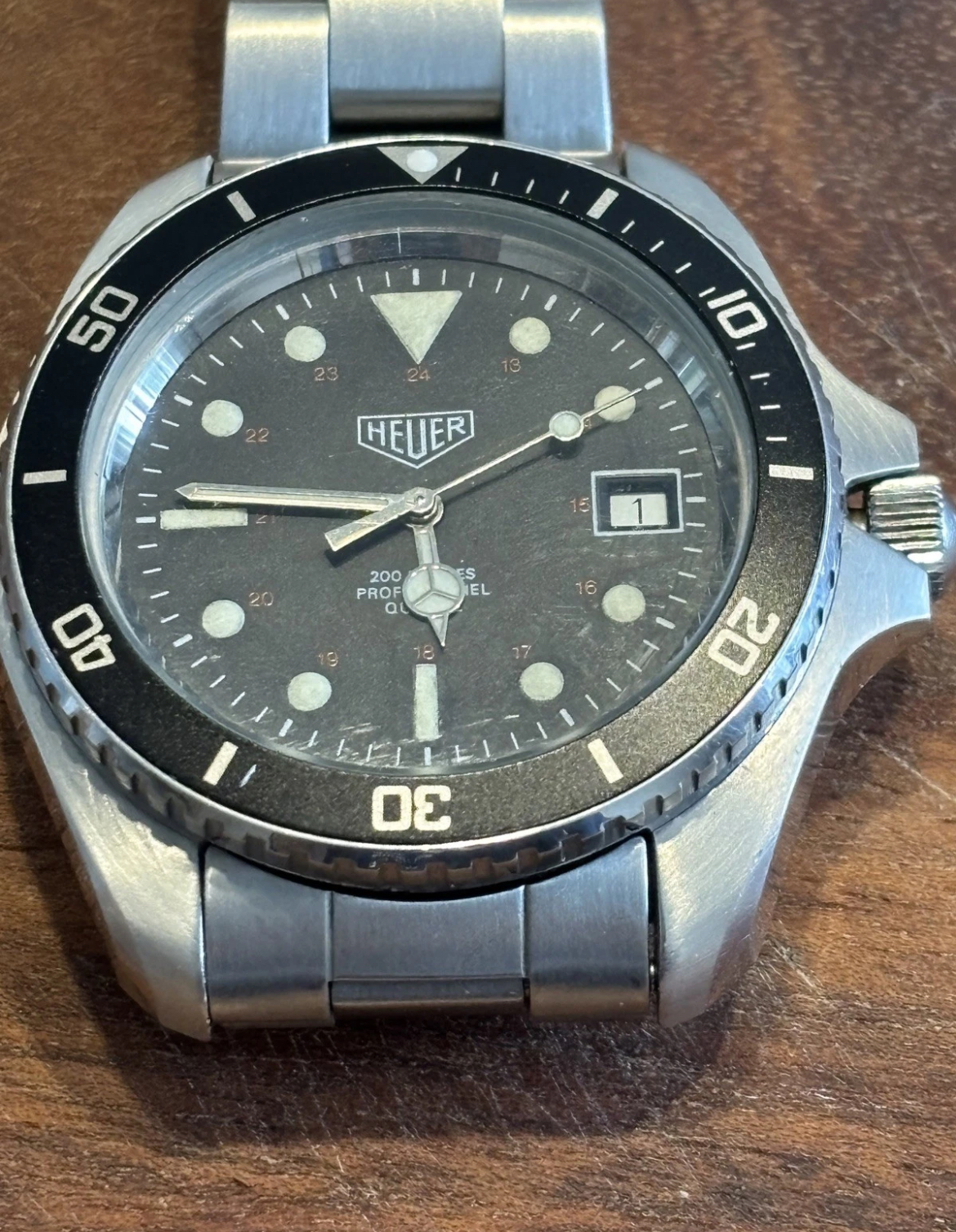

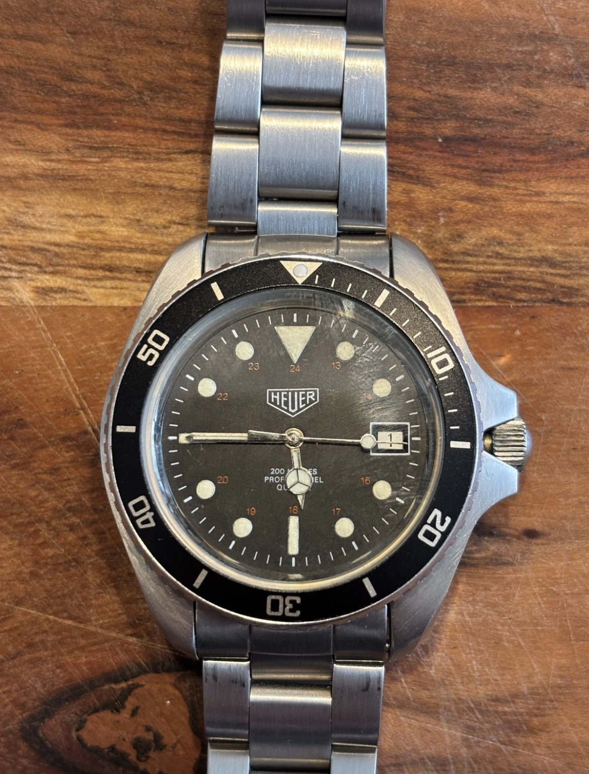

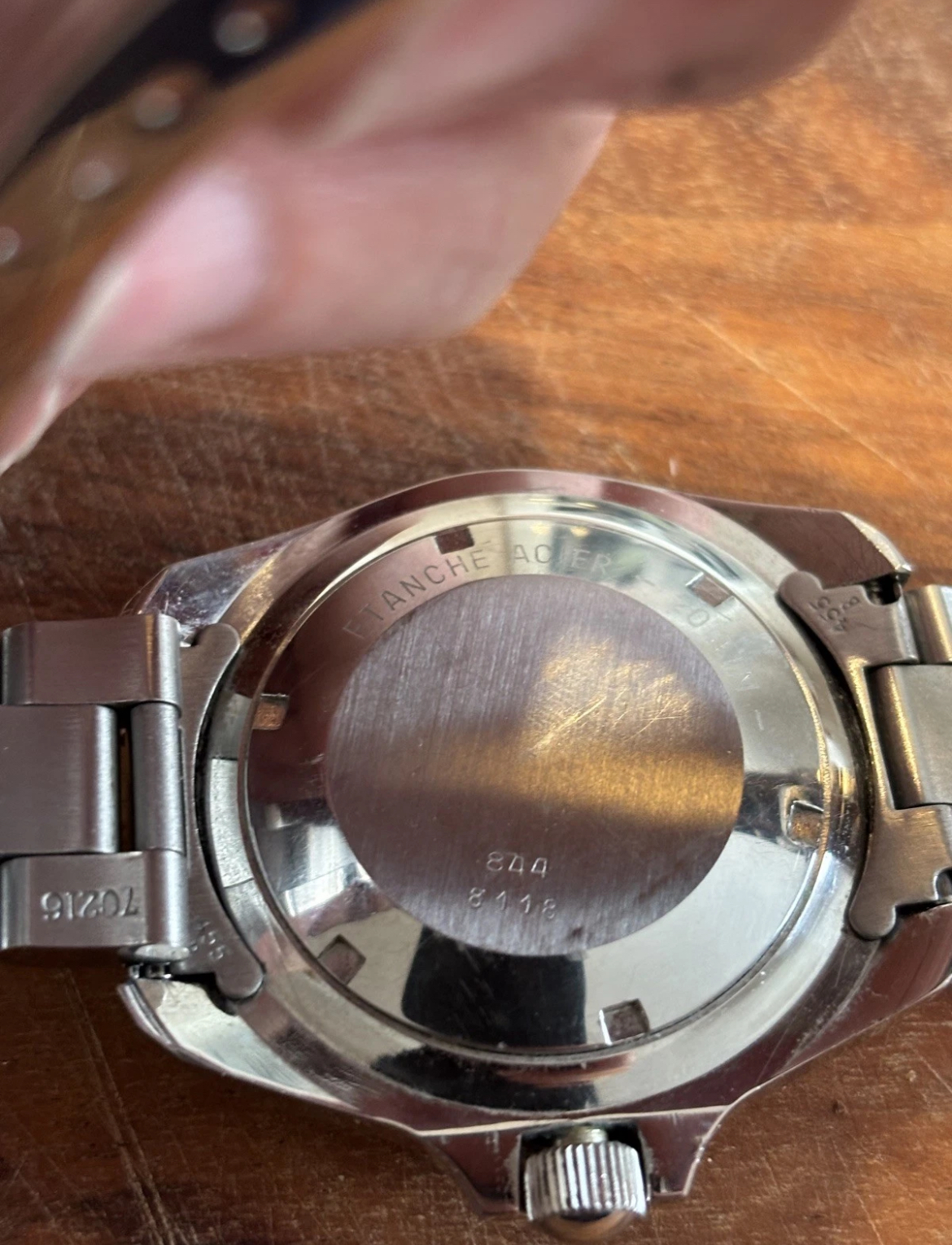

Resurrecting this thread to get some opinions on a 844 that I have just purchased.
@bristnj I would certainly appreciate your advise too please!
I've been having my doubts for a couple of reasons, the Heuer logo seems a little low down and perhaps slightly off centre compared to others I've seen.
I did also get it for a bit of a bargain compared to what others are selling for, although it is the quartz version so I know they don't sell for as much as the automatics.
Any help would be appreciated.

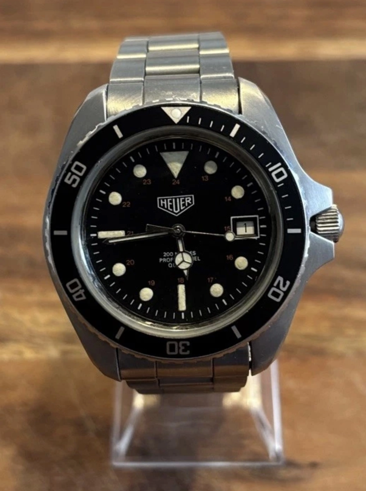

Generally - dial looks okay. The logo printing was not necessarily precise, and being a bit off center or even blotched isn't overly concerning. It looks like hands have been re-lumed, bezel insert replaced, and case back should be Ref. 8440, so maybe swapped out at some point. Later models when Heuer took over production went to 980.006. That being said, its a nice wearable piece.

I love it. Enjoy. I have two but I can’t post pics here today. You can check them on my insta @junglehour

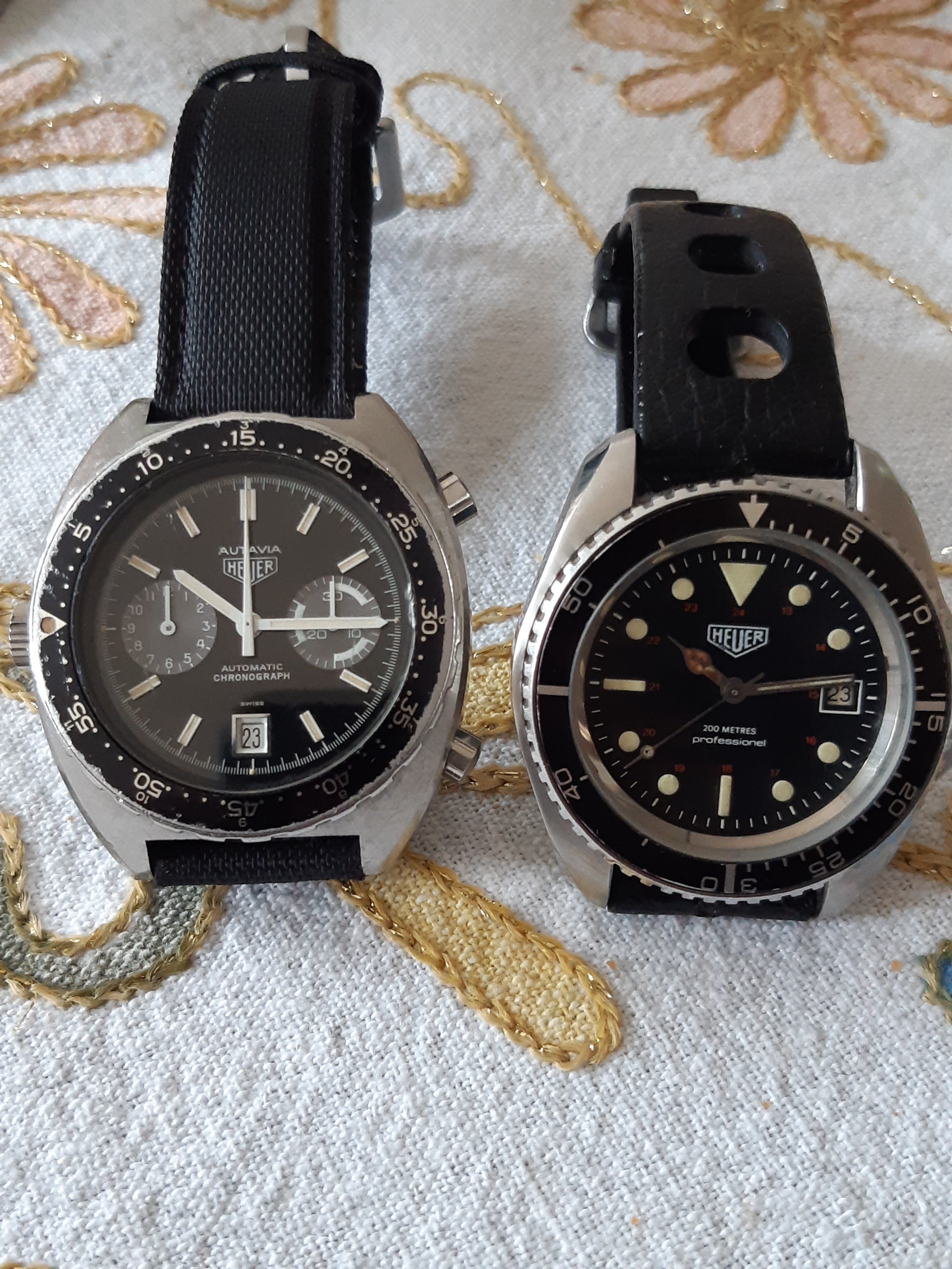

all fine,early taype dial, prototaype 844 ,i had one automatic FE cal.its come on tropical diving band.
