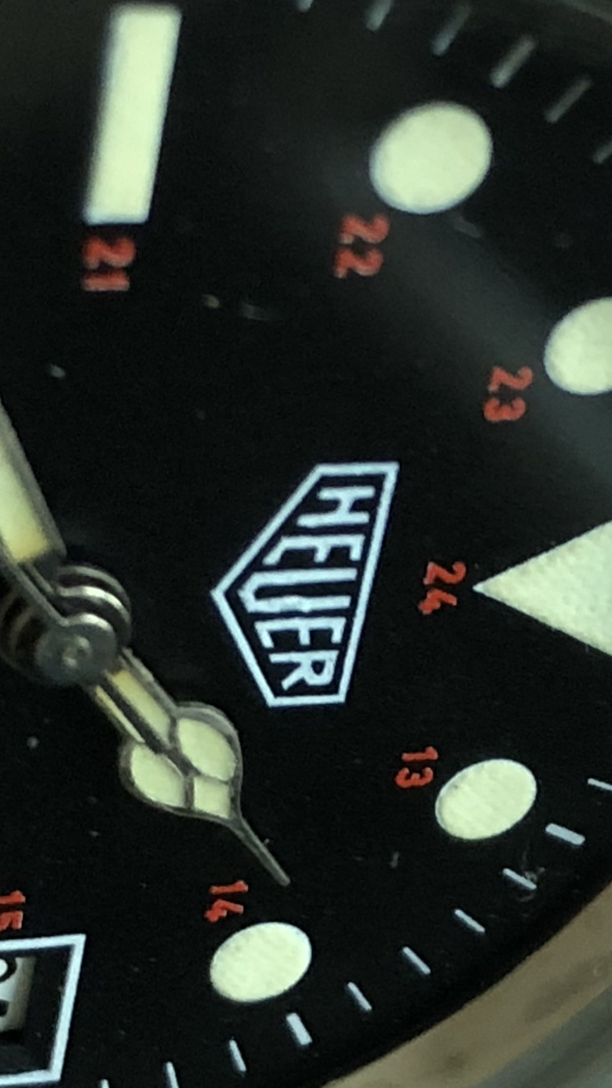

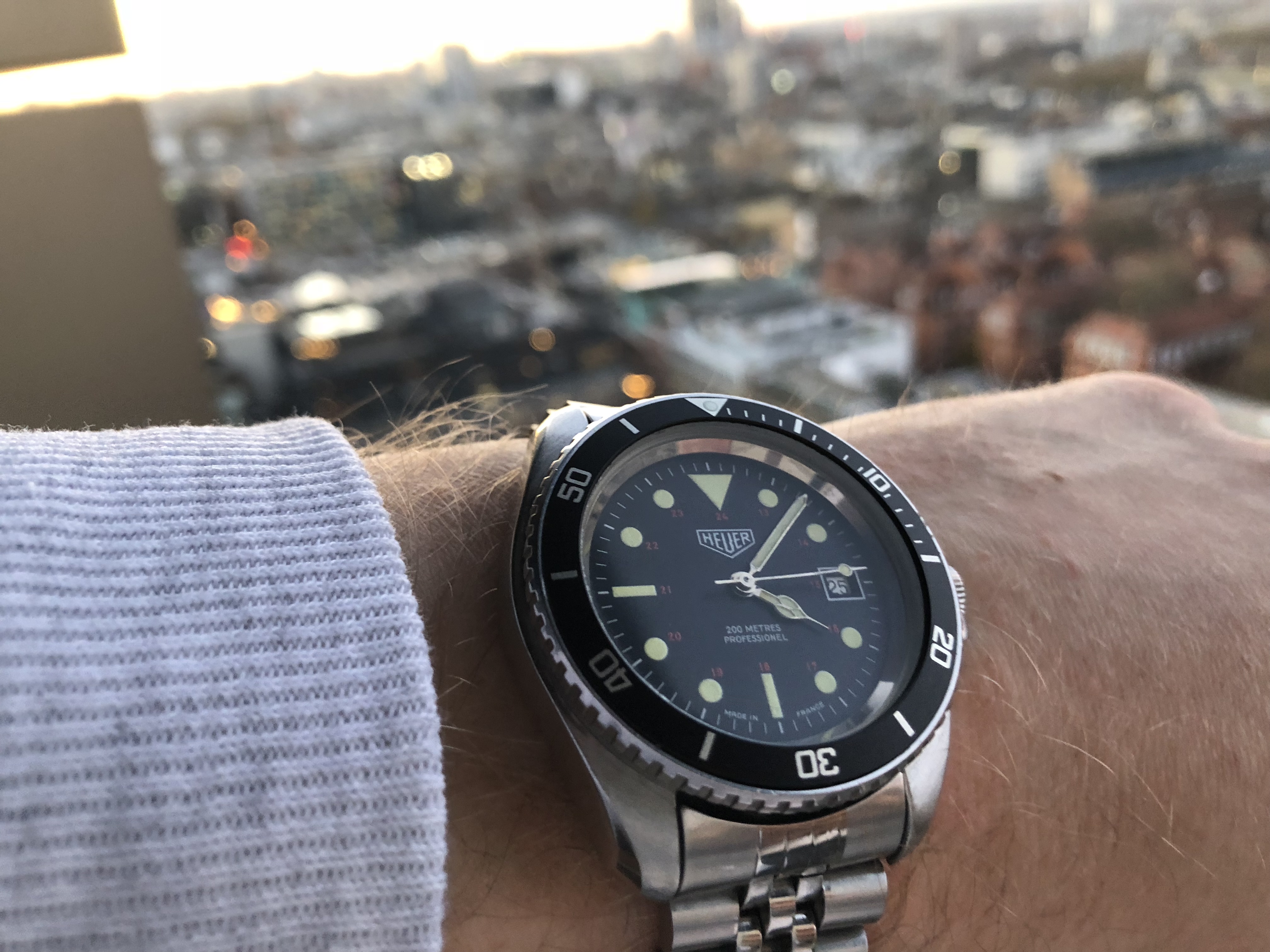

    Another redial query...I’m having all the luck at the moment...
    It’s a Heuer 844 Monnin. The “U” in the Heuer logo is a bit wonky.
    The watch seems right in every other way - hands, bezel, movement, consistent patina.
    But there are a few models which had the same dial...is it possible someone changed the logo...?

  3. bristnj Nov 24, 2017
    2,174
    32,079
    It's a bit difficult to truly ascertain based on the angle of the photo. Do you have a straight-on shot? Would like to see placement of "Professionel" (French spelling) and Made in France at bottom. In general the angles of the bottom of the E's to the U look right, but the overall logo does not look cleanly applied. Also, middle of the E's looks short. At the close-up shot it's though to see if it's truly ligit, but I have my doubts. Also, more shots would be helpful. Is the FE4611A movement signed G.Monnin or not signed? Case back has 844 and if so, what serial number? Shot of inside the case back.

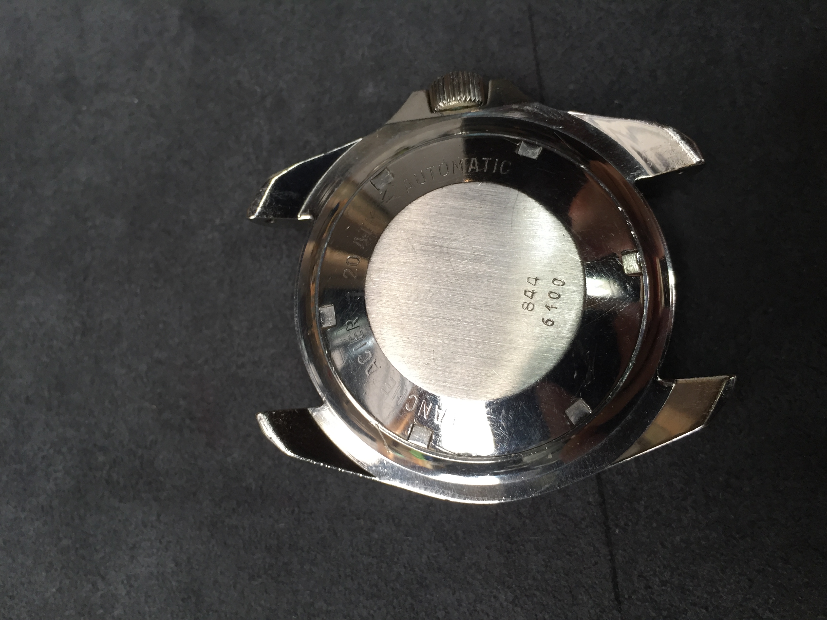

  5. keepschanging Nov 24, 2017
    391
    936
    More pics...
    0CE936C9-A1D1-4FA9-8367-393D42C014B9.jpeg AB405A00-0686-4485-8FFE-2C1841AD7195.jpeg

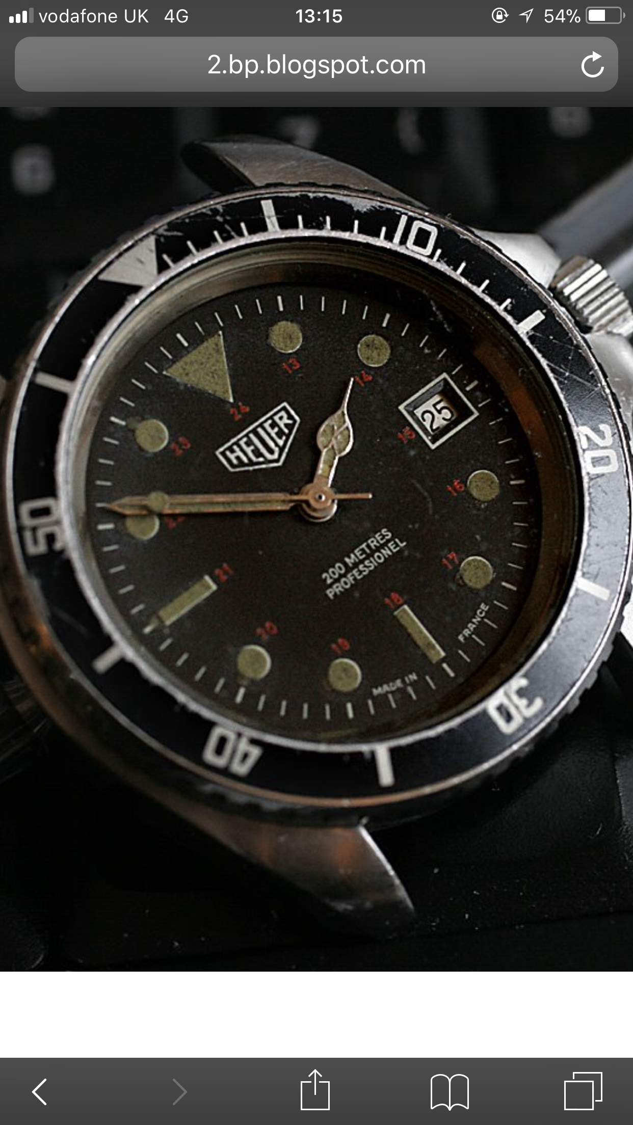

  6. keepschanging Nov 24, 2017
    391
    936
    This is the one online where the printing looks quite similar to mine

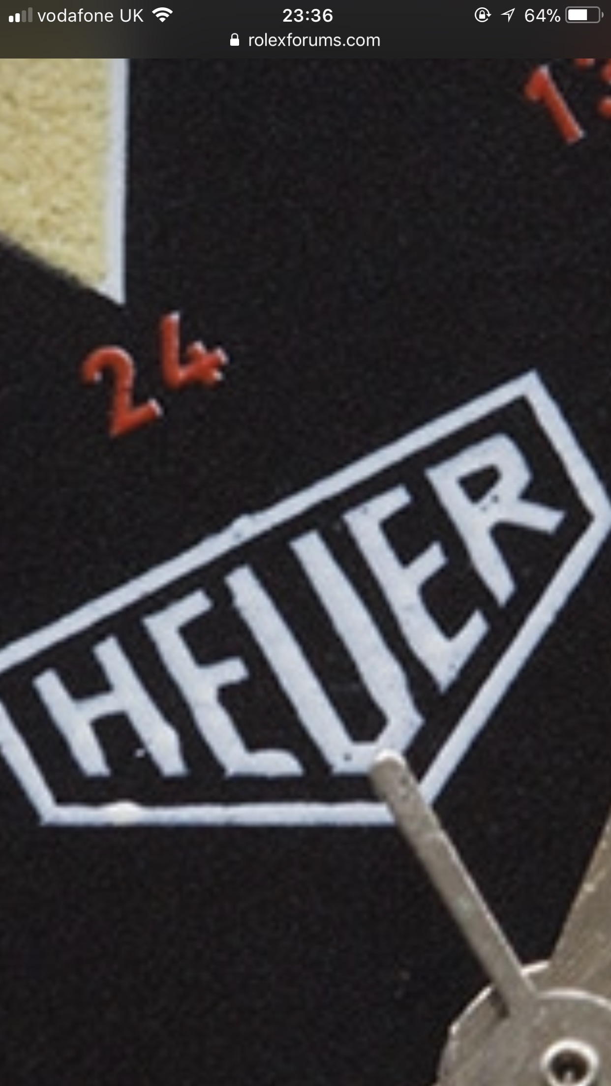

  9. keepschanging Nov 24, 2017
    391
    936
    Thanks, very much appreciated! I already bought...at huge price...but can return at my discretion.
    Have now heard back from two independent experts. Both say it’s legit. One gave this pic of his personal version which is even worse.
    So I’m actually getting convinced it’s legit...

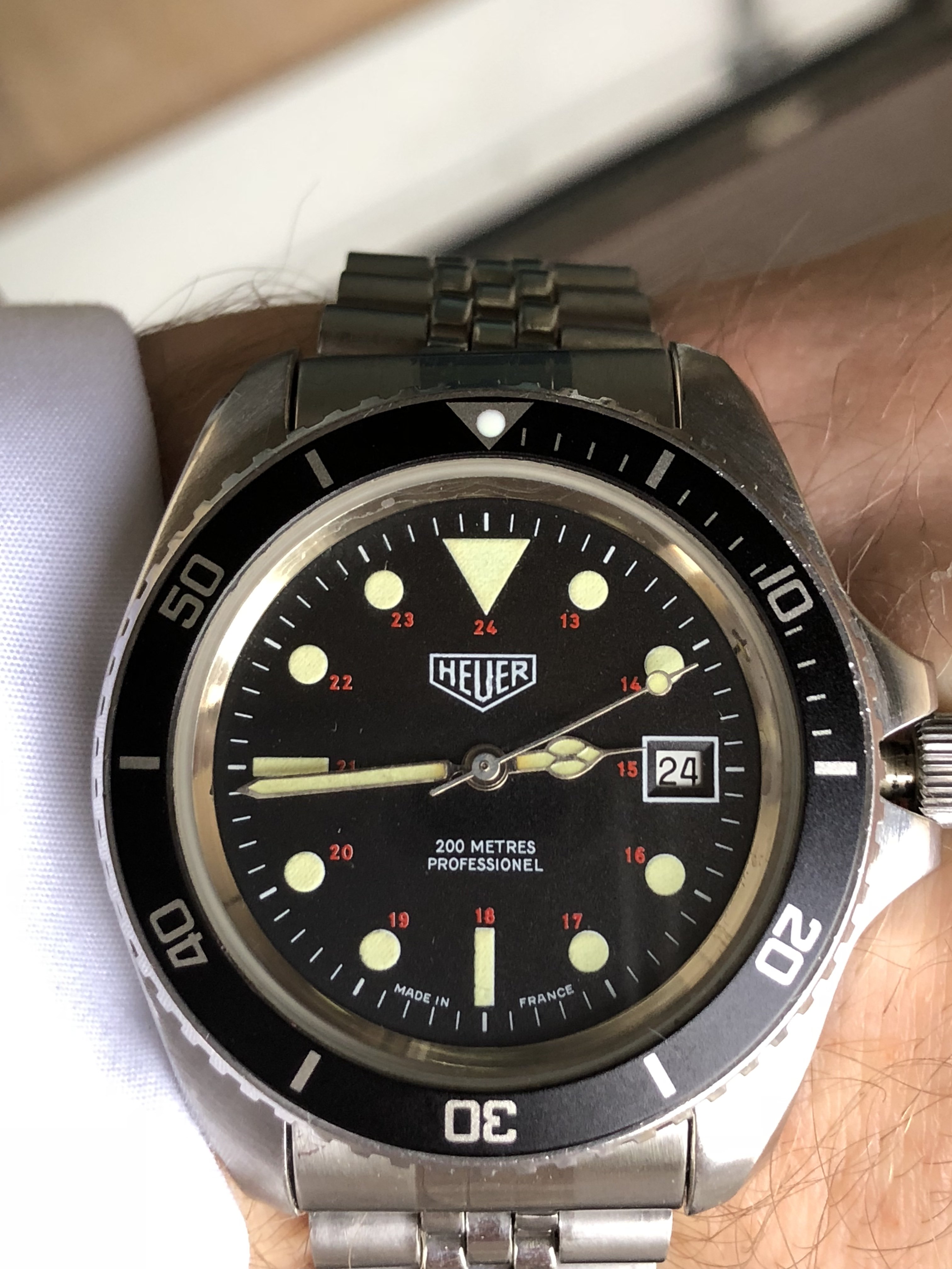

  11. bristnj Nov 24, 2017
    2,174
    32,079
    The consensus is it's real. This from two very highly regarded folks in the Heuer community. Here is another example of an authentic dial with a poor press that one shared with me. Also, one has seen/serviced this piece in person, and was 100% positive on its authenticity. So, from my vantage point, you have a winner.

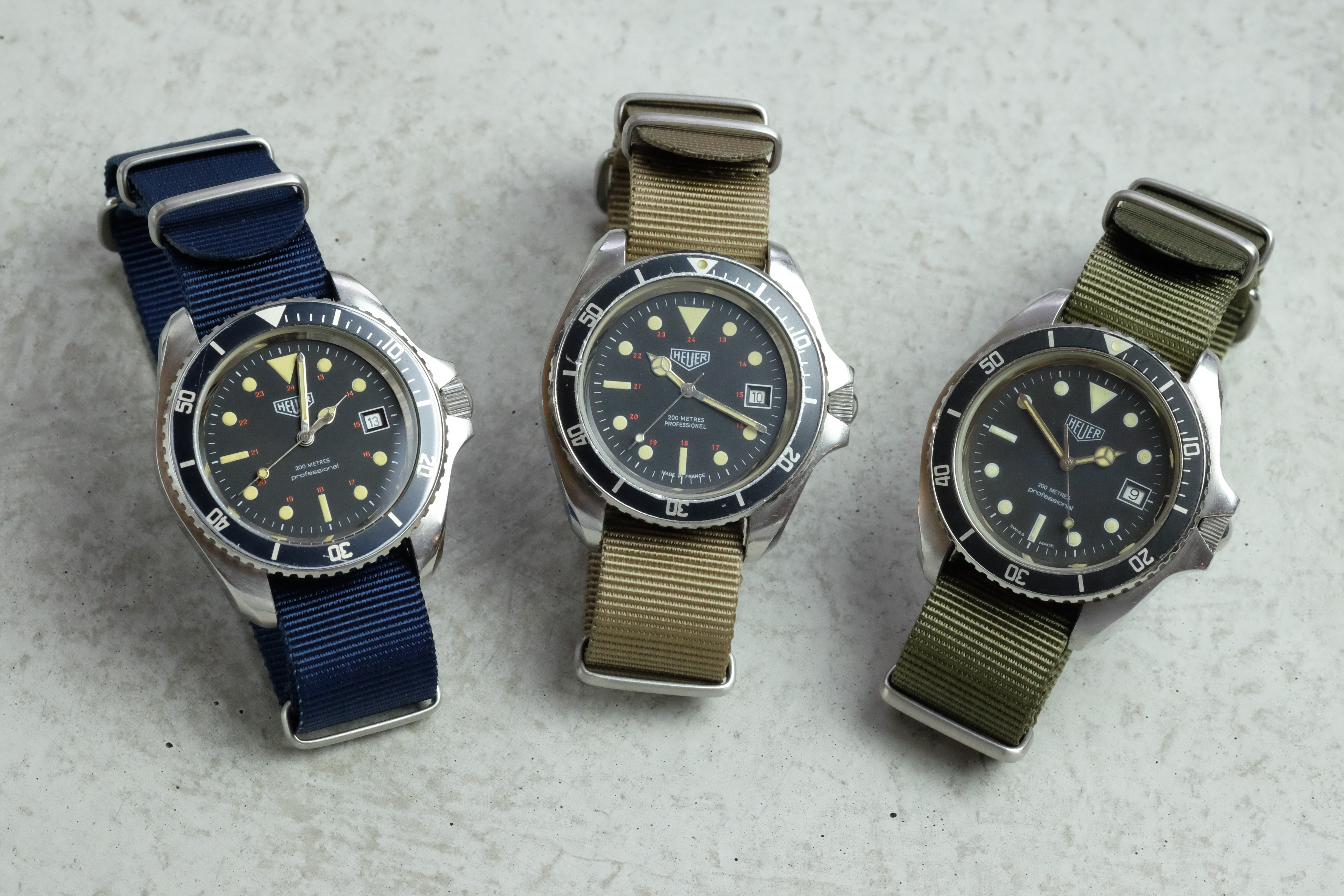

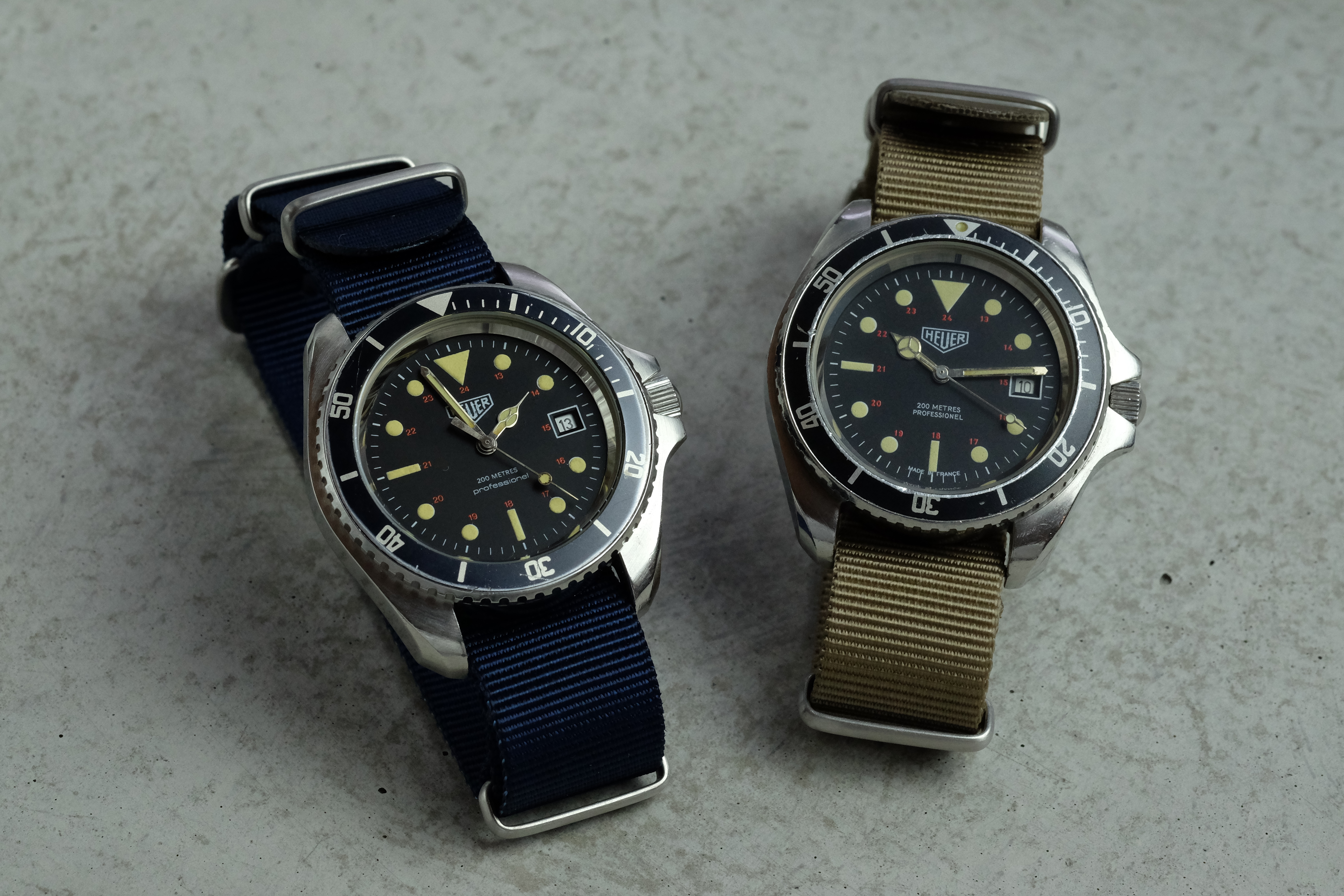

  18. Optimizer13 Nov 25, 2017
    1,312
    3,392
    I don't think its a redial. One of mine has a logo similar to that and I know for sure it was from the original owner. The other parts of the watch looked fine too.
    KingCrouchy, Kernkraft and bristnj like this.

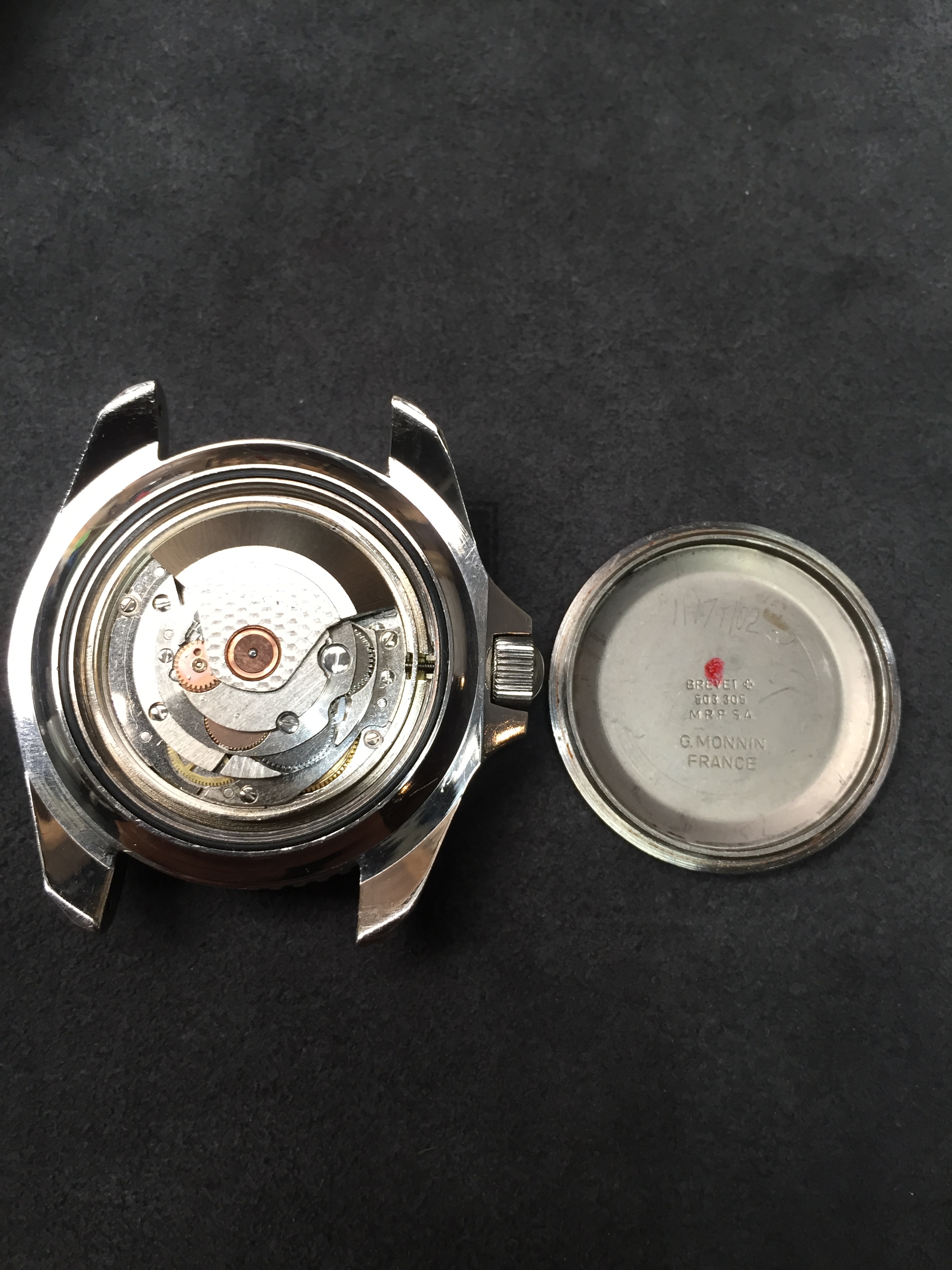

  20. bristnj Nov 25, 2017
    2,174
    32,079
    A bit more fun with the Monnin family. Here is my 844 transitional. Non-24/hr dial, G.Monnin Signed Rotor on FE4611A movement, Made in France dial, 844 on case back with high S/N.
