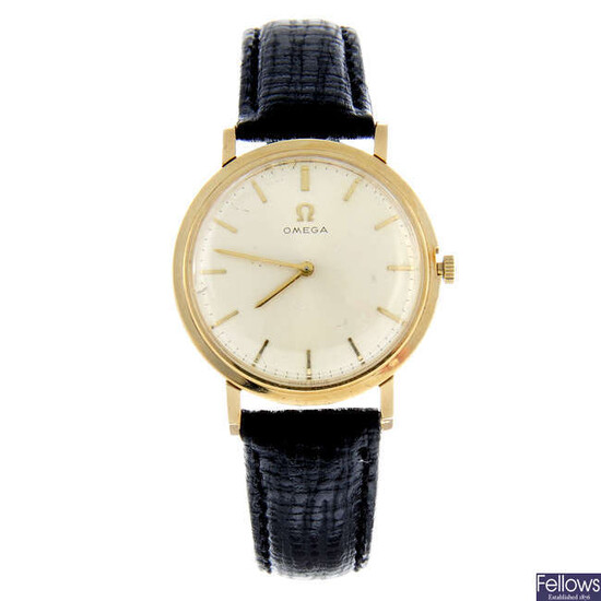

Hey Andrew. First I'm really sorry for your loss. If I'm right, you have something like that?
Yes: that's it!!
Can you tell me any more, or send me a link?
Thanks so much!
