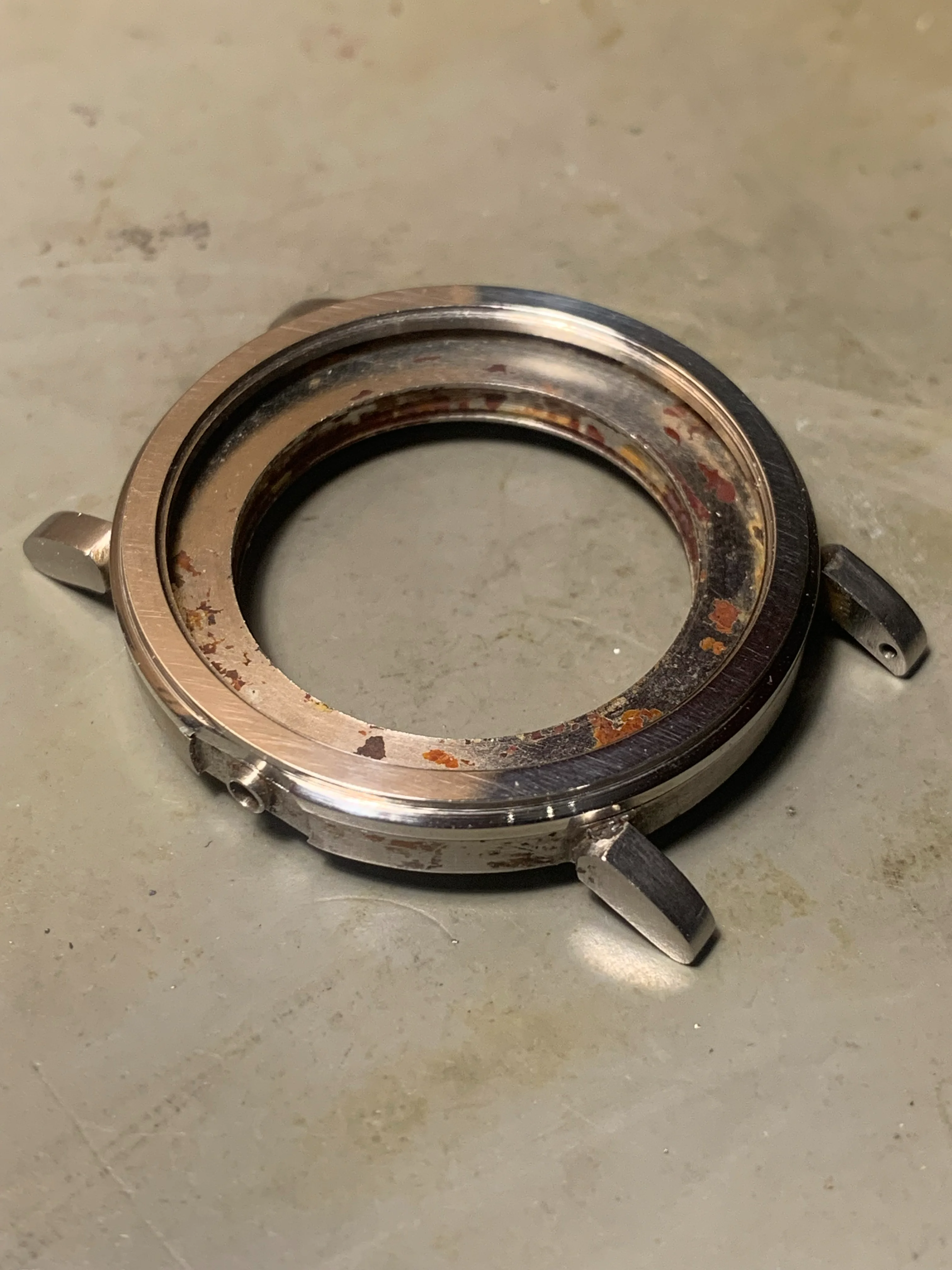

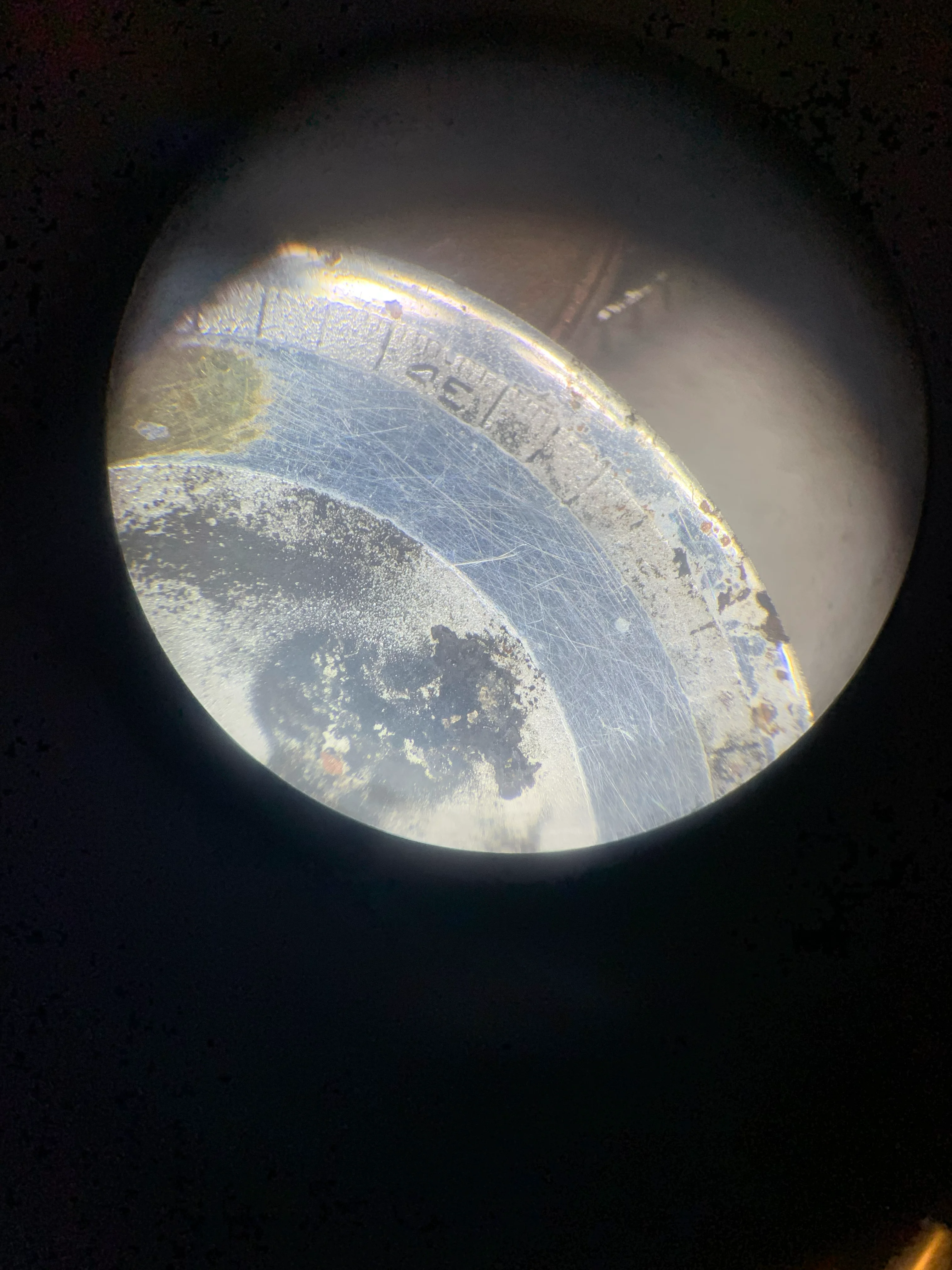

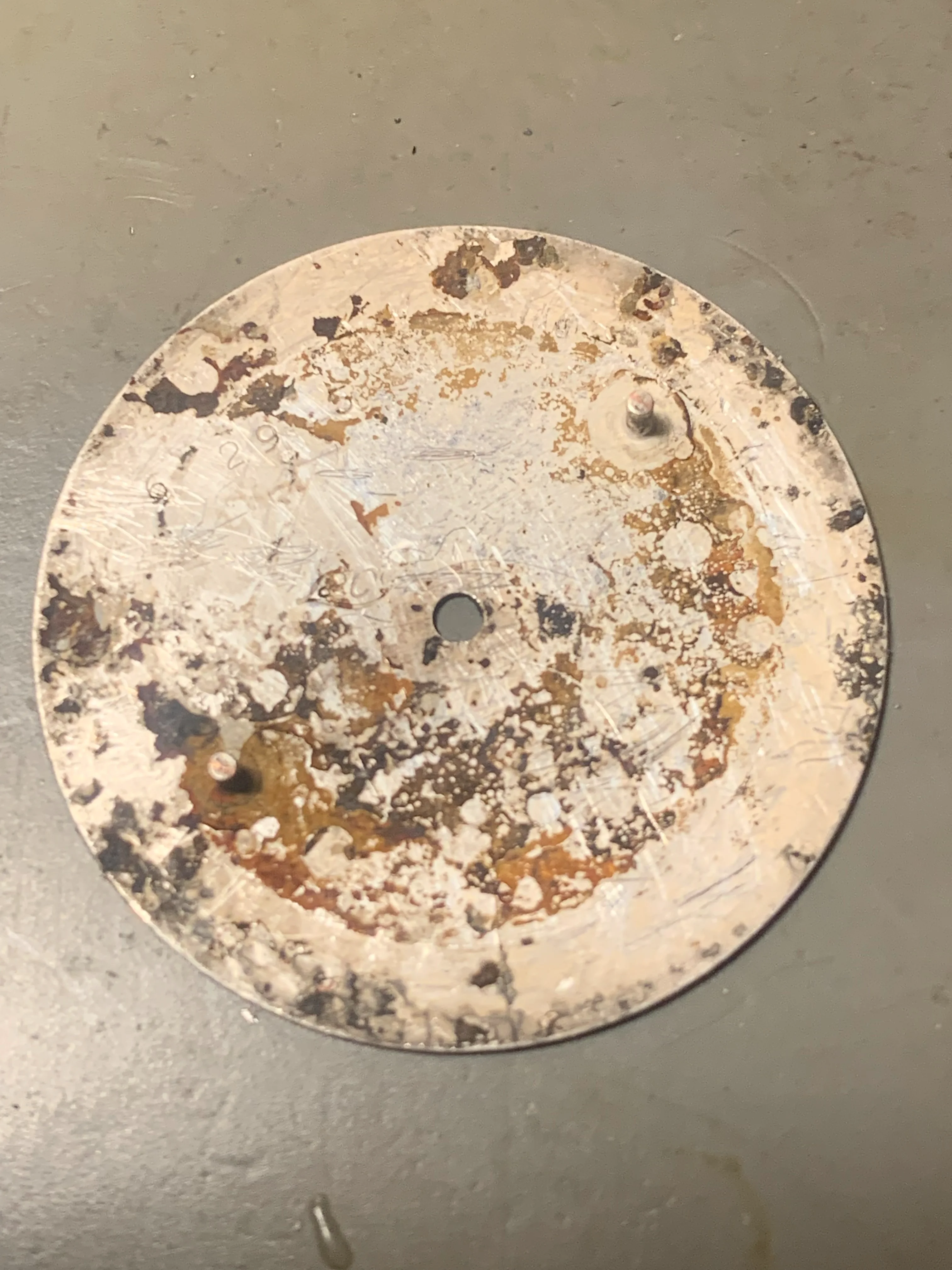

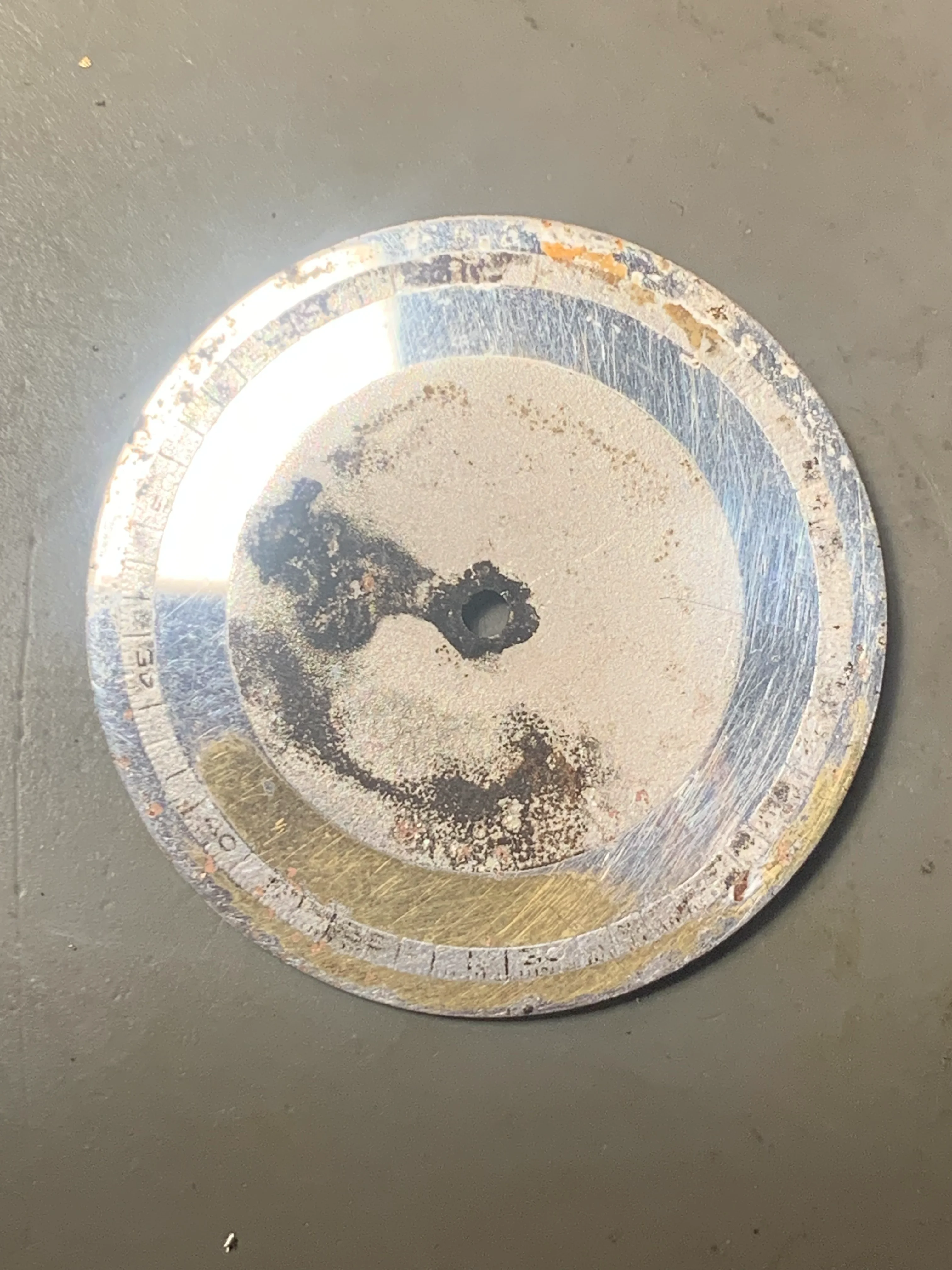

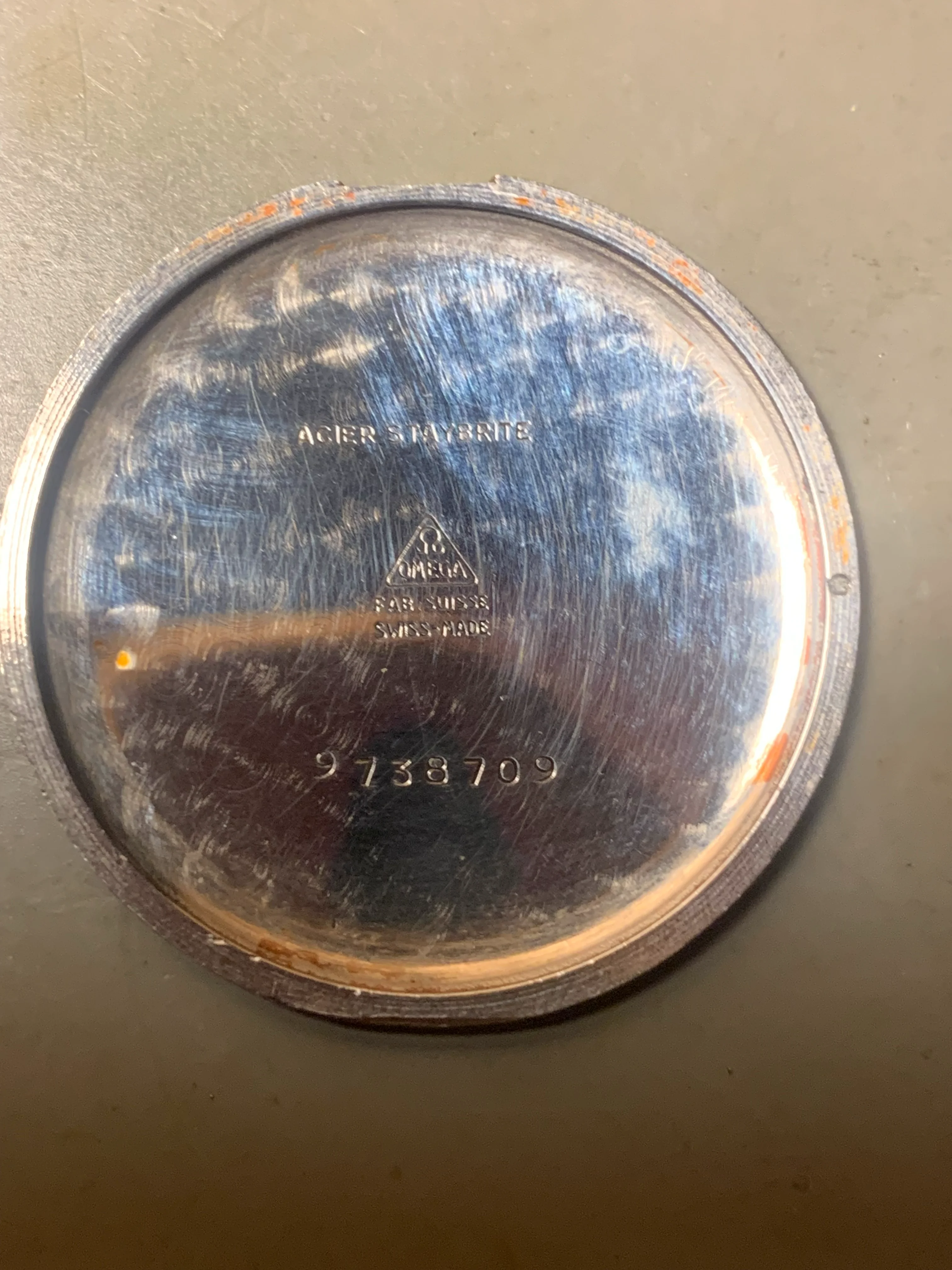

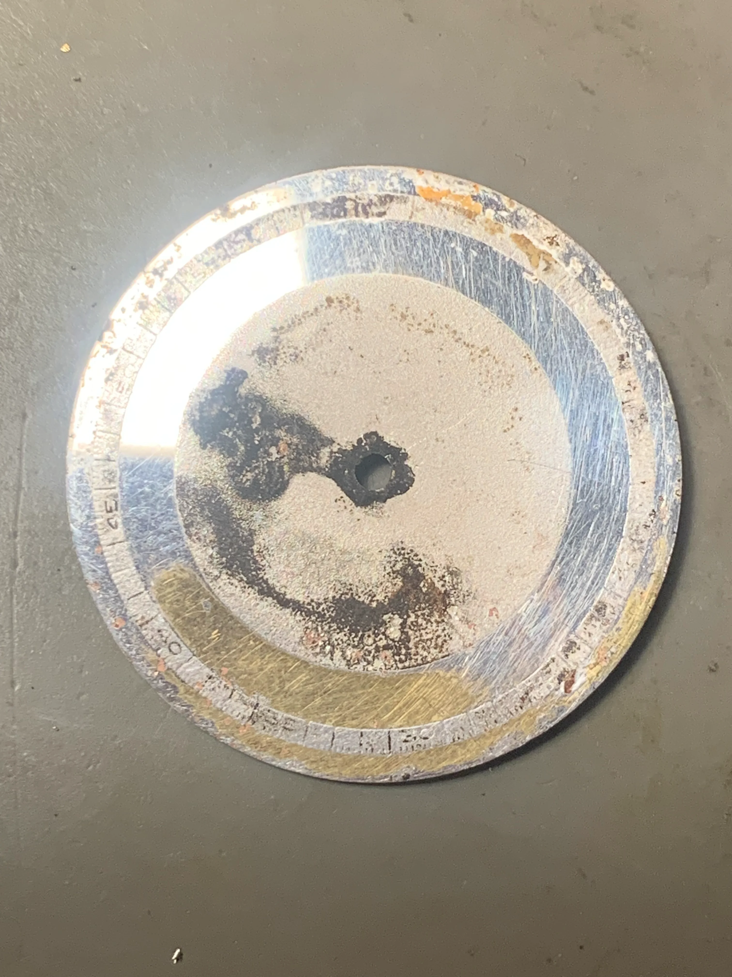

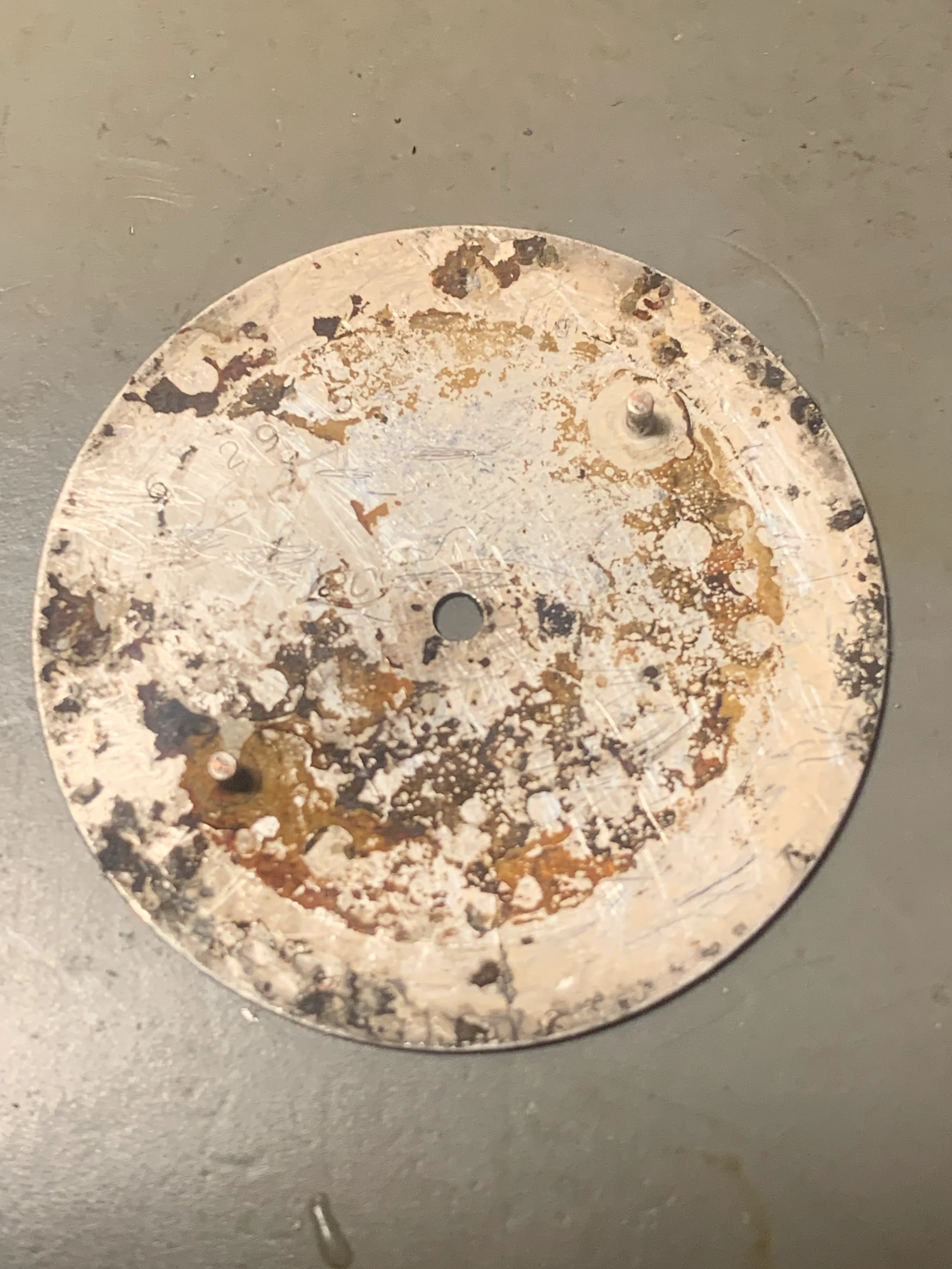

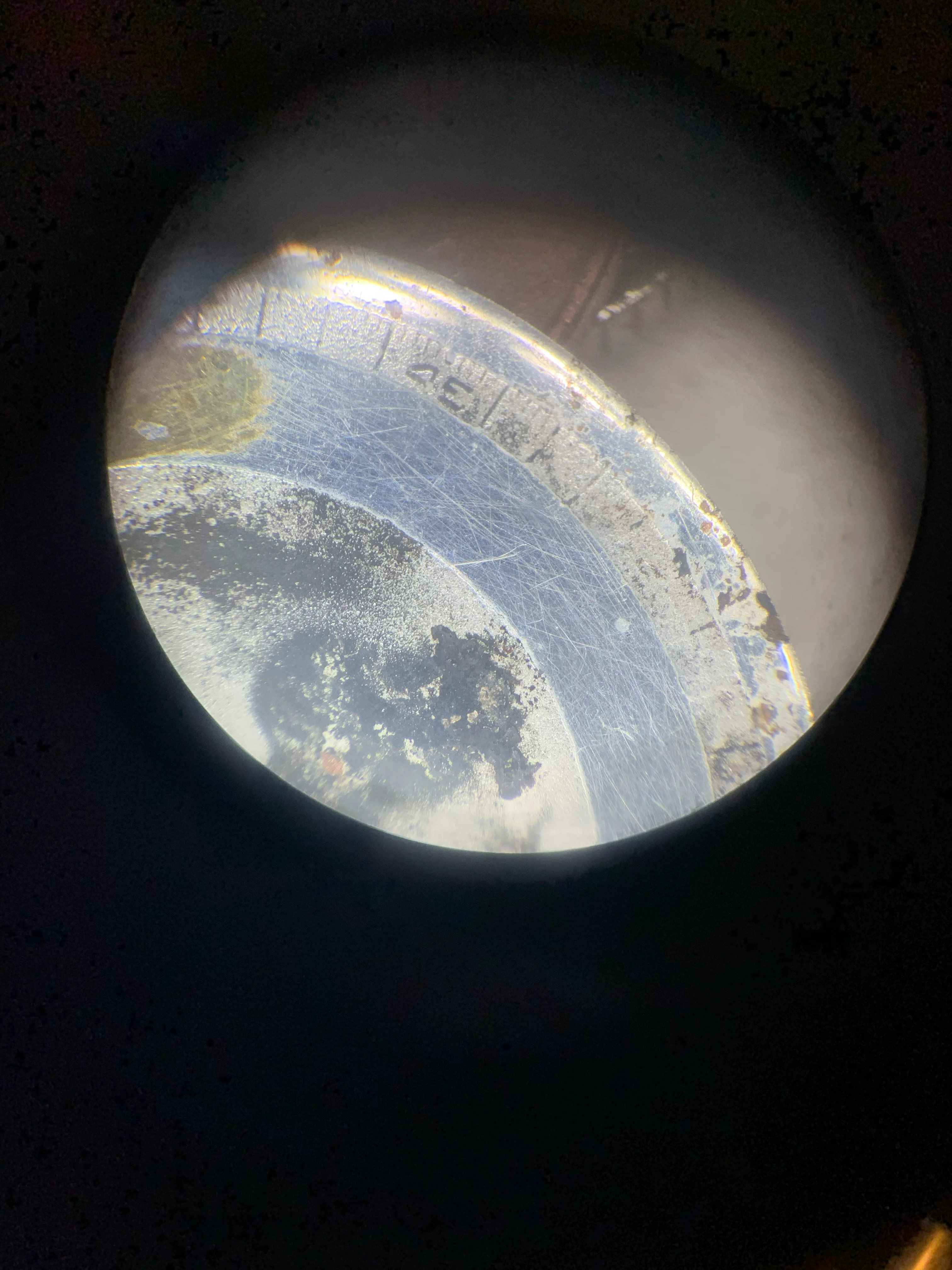

Hello, I am new to this forum, I wonder if anybody can help me see what the damaged dial on my Omega Medicus looked like when it was new.? From looking at this forum I think it is Model No. CK2015, is 35mm in diameter with a 23.4 sc movement. It seems to have a special dial, unlike others that I have seen online. It is unfortunately damaged by hard black corrosion products. The dial is made of silver with a Matt centre circle. I has a beautiful silver minutes ring also subdivided into fifths. The ring seems to stand proud of the surface could be stamped on or etched, but almost looks applied (see the the little notch between the numbers of the 45.) The dial has two areas of polished silver outside the minute ring and inside where I think the figures would have been printed. Intriguingly both these areas have evidence of gold plating. On the back of the dial are a curly L & C (Maybe Lemrich?) and the number 6 29 5.

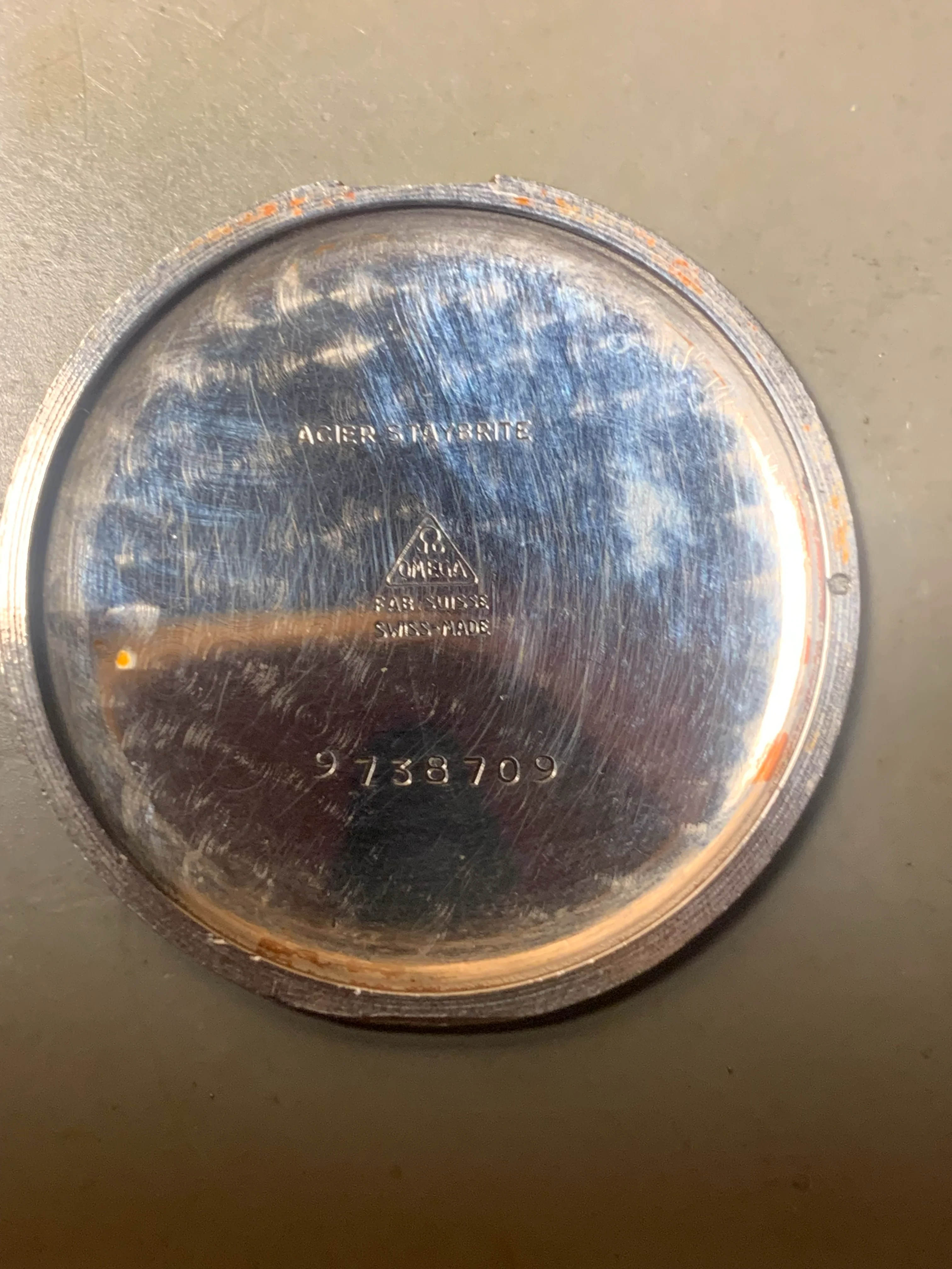

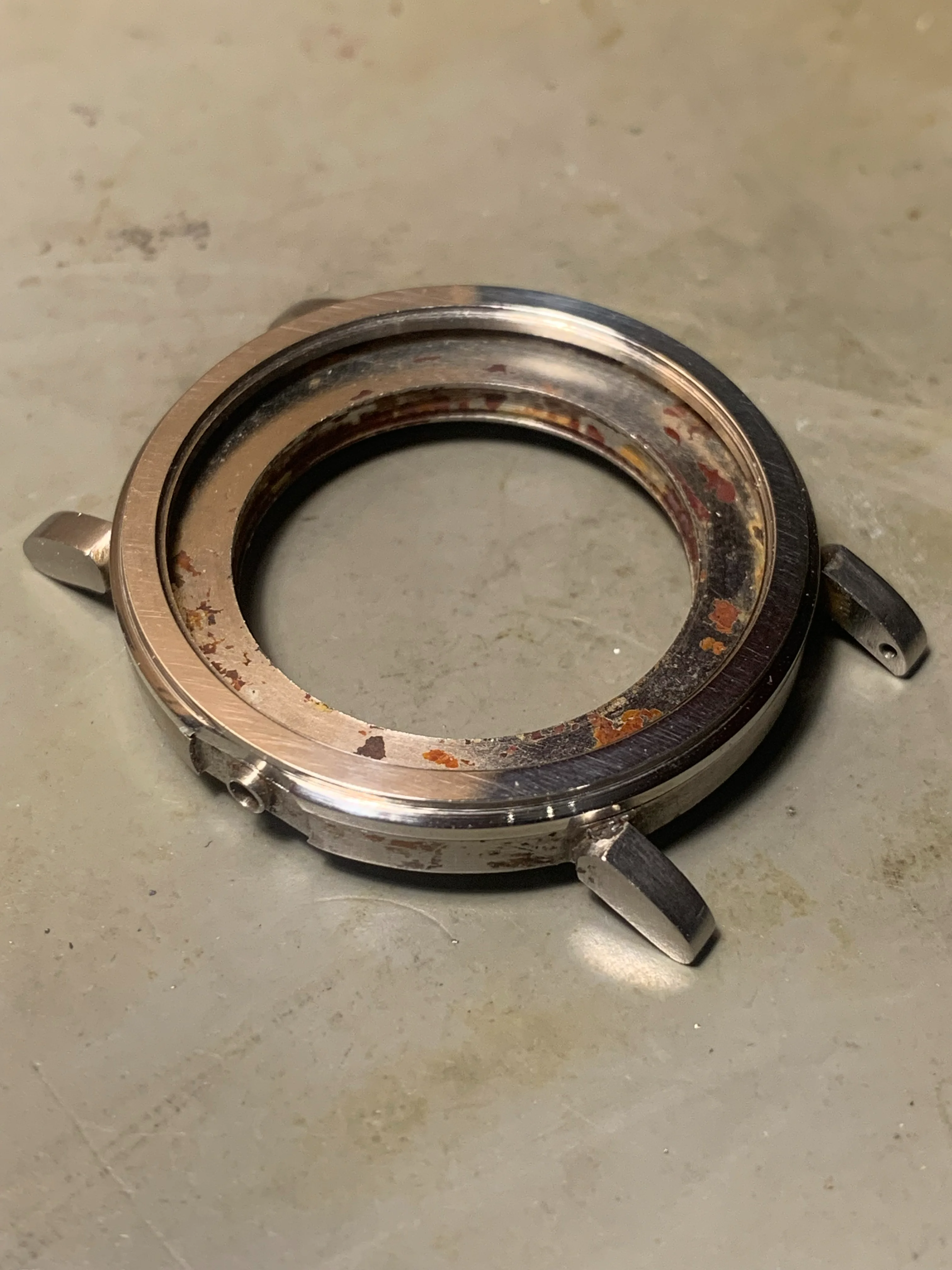

The case and back are stainless steel, the original stepped stainless bezel was broken into three pieces and seemed to have failed in a brittle way like cast iron. I have turned a new bezel from stainless. Interestingly the watch came with a mineral glass, I wondered if this was original? The movement number is 8852947 and caseback 9738709.
I would love to know what the dial would have originally looked like, I can't imagine it was matt silver all over . I would be eternally grateful if somebody could find the time to reply.

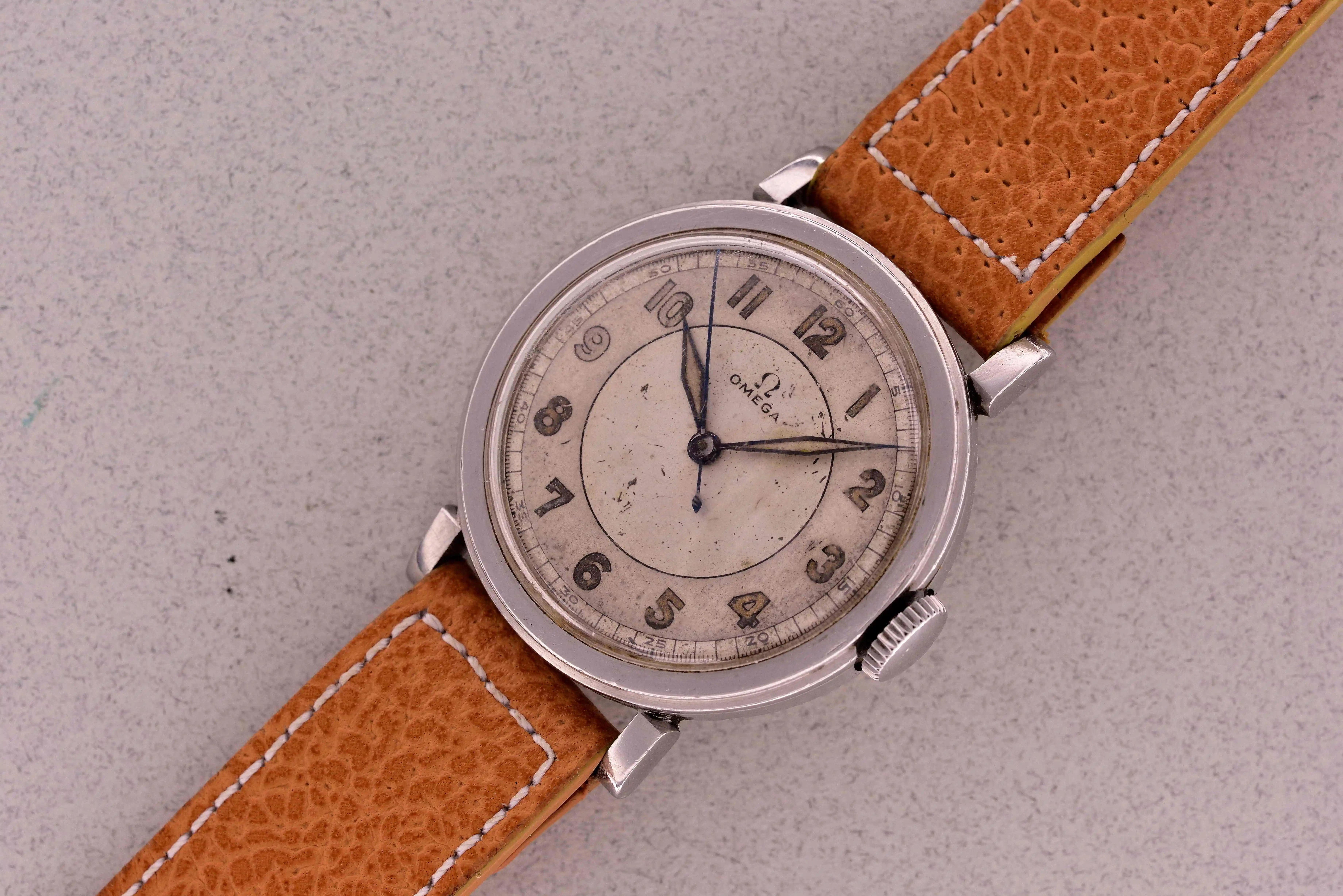

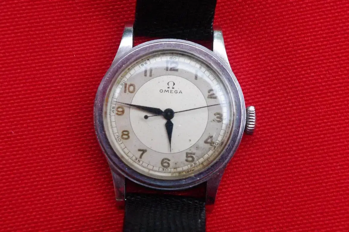

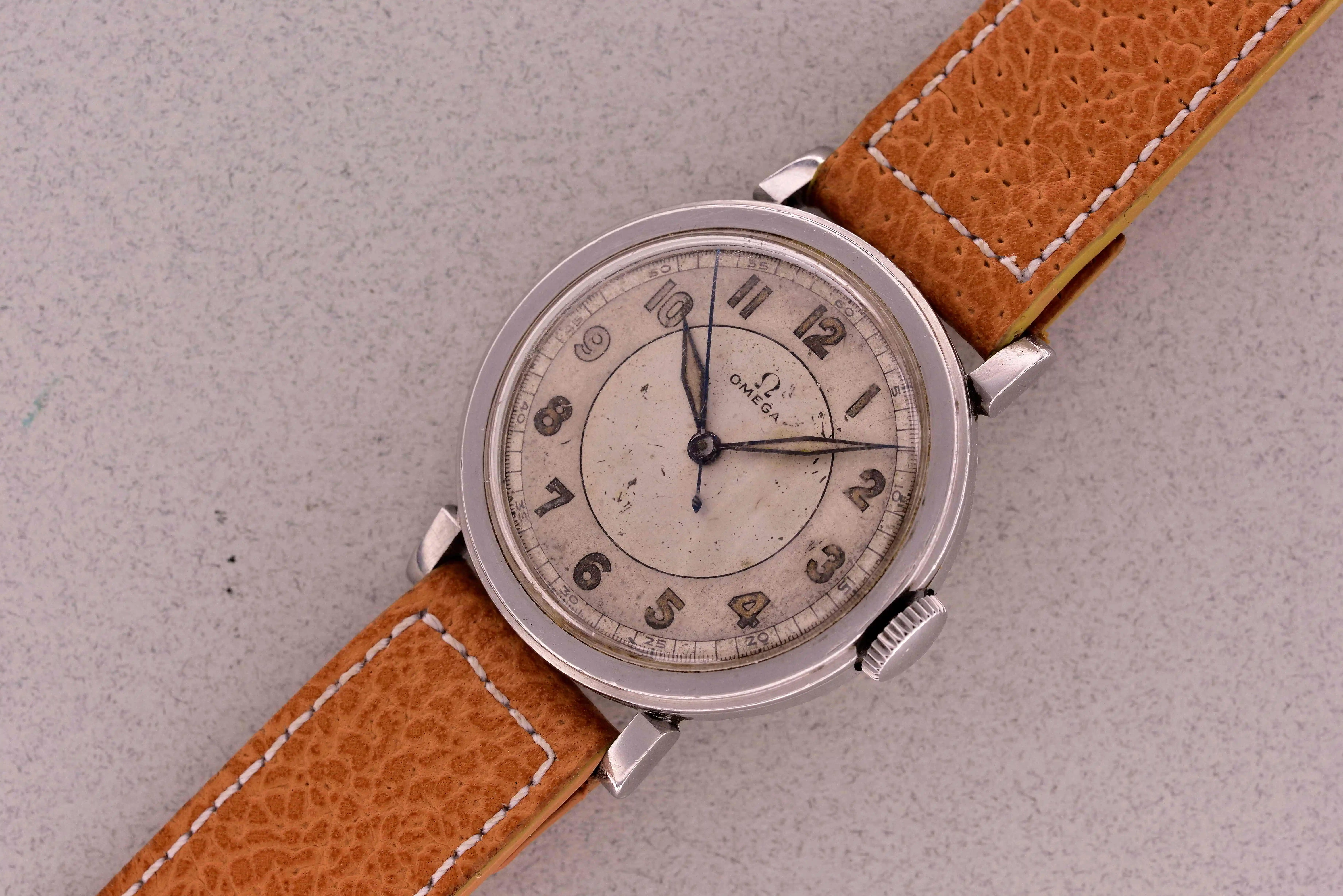

Difficult to say how it originally looked only based on those pictures. I would need to see it in real to find if the black area is indeed corrosion of the reamains of a center black coating.

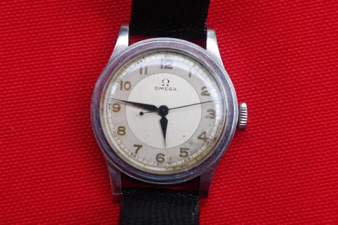

If it is corrosion, one guess is this layout (one of my 2015) :
The golden area is'nt the sign of a prior gold plating but the color of the copper plate, appearing where the white metal surface plating was worn out by some cleaning attempt.
3
Hello Tire-comedon, sorry about the delay in replying, thank you for sharing your knowledge. The dial is as I received it. On closer inspection, you are correct the "goldy" colour is under the white surface plating, being colour blind doesn't help! The black stains in the centre don't respond to any solvent, I think they are corrosion product from where the missing hands were. I am still intrigued by the raised minutes ring markings, I would love to know how that was done, also why was the white metal area polished? I guess I will be forced to compromise on a restored dial and loose some of the originality.
An additional question, do you think the mineral glass that came with the watch is original?

I think it used to be a galvanised dial, which is impossible to restore once damaged like yours.
