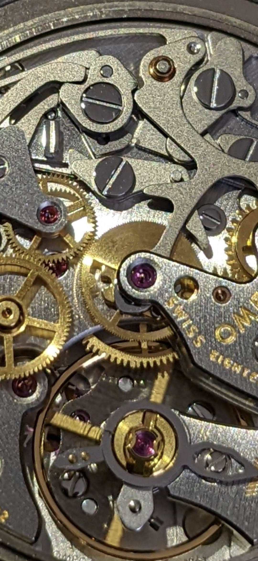

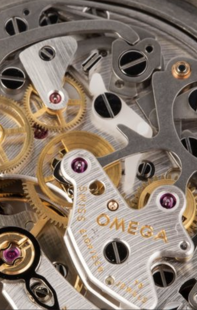

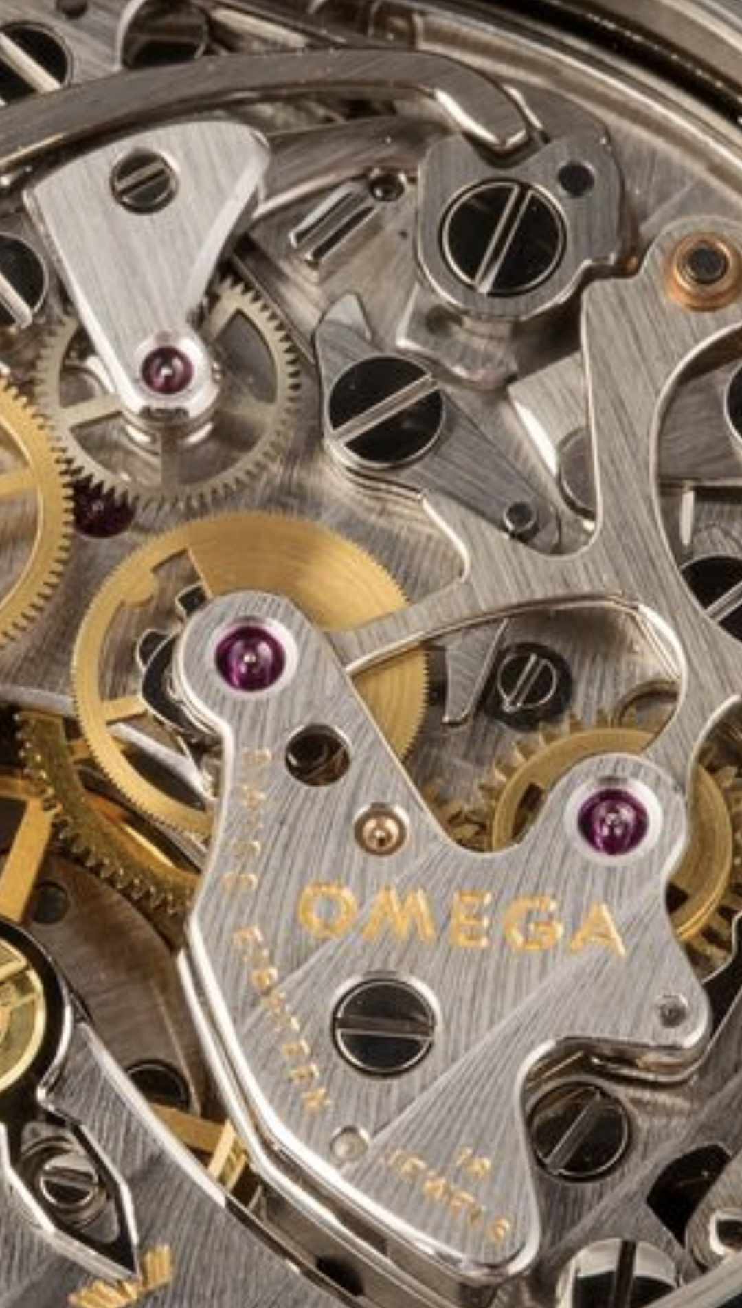

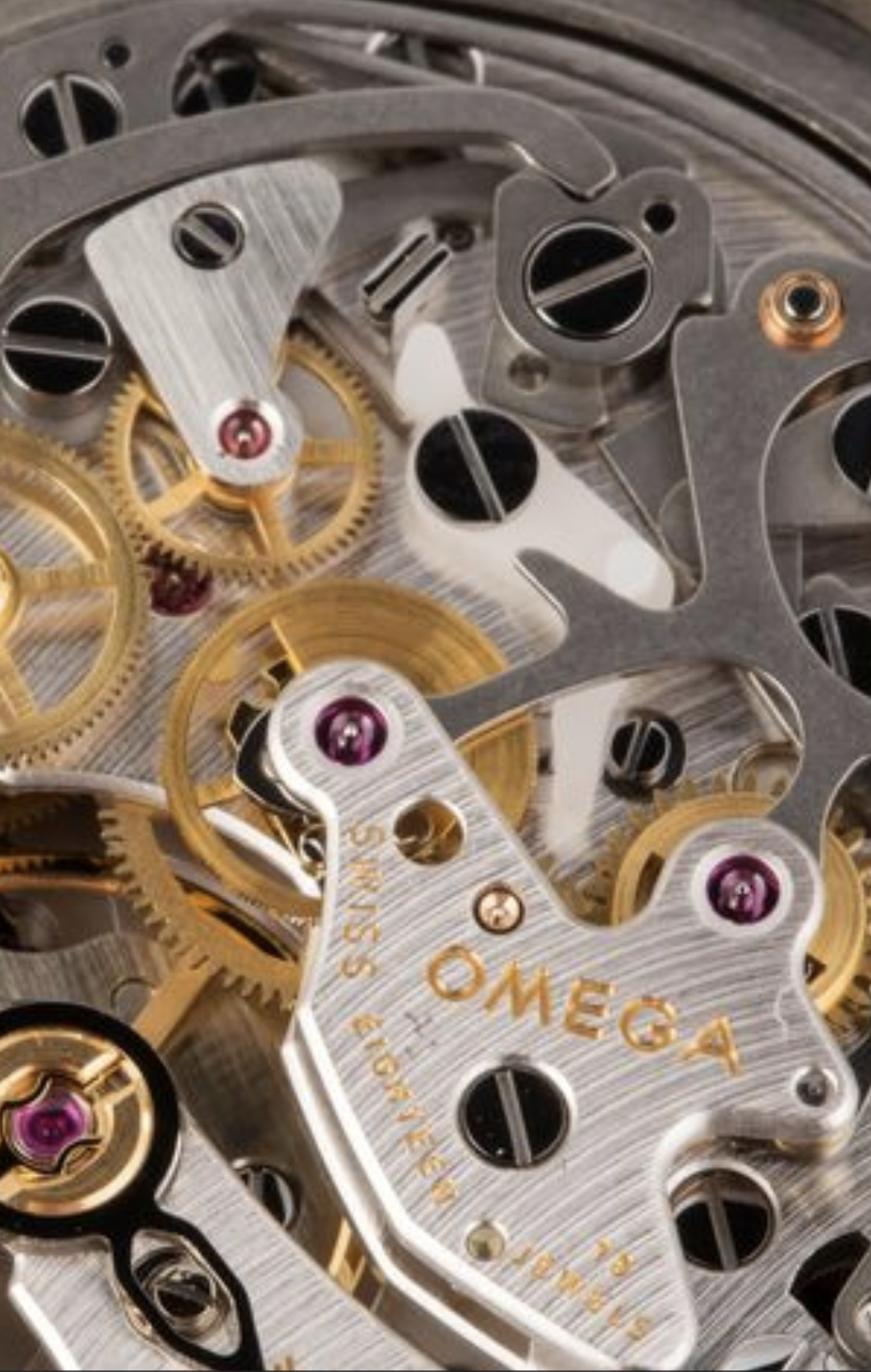

Here are some photos to show people the difference in the stopping levers that exist Incase it helps anyone -
The first picture is of a 1861 with the Delrin part (from the internet)

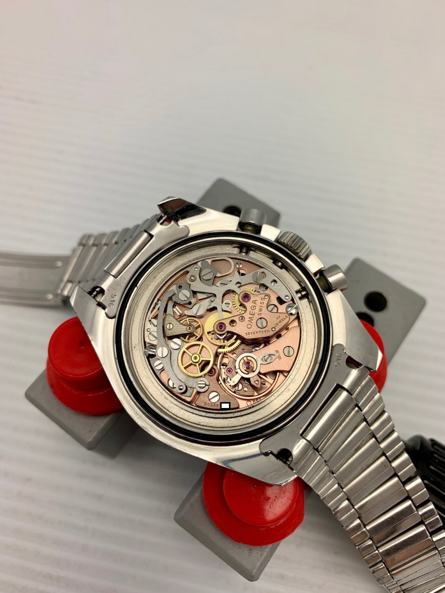

This next picture is of my 1861 (exactly the same as the movement above, it just looks a bit different due to lighting and my poor photography skills) which did have a Delrin lever but the Omega service center swapped it to a 861 metal part at my request because I was using an aftermarket display case back.

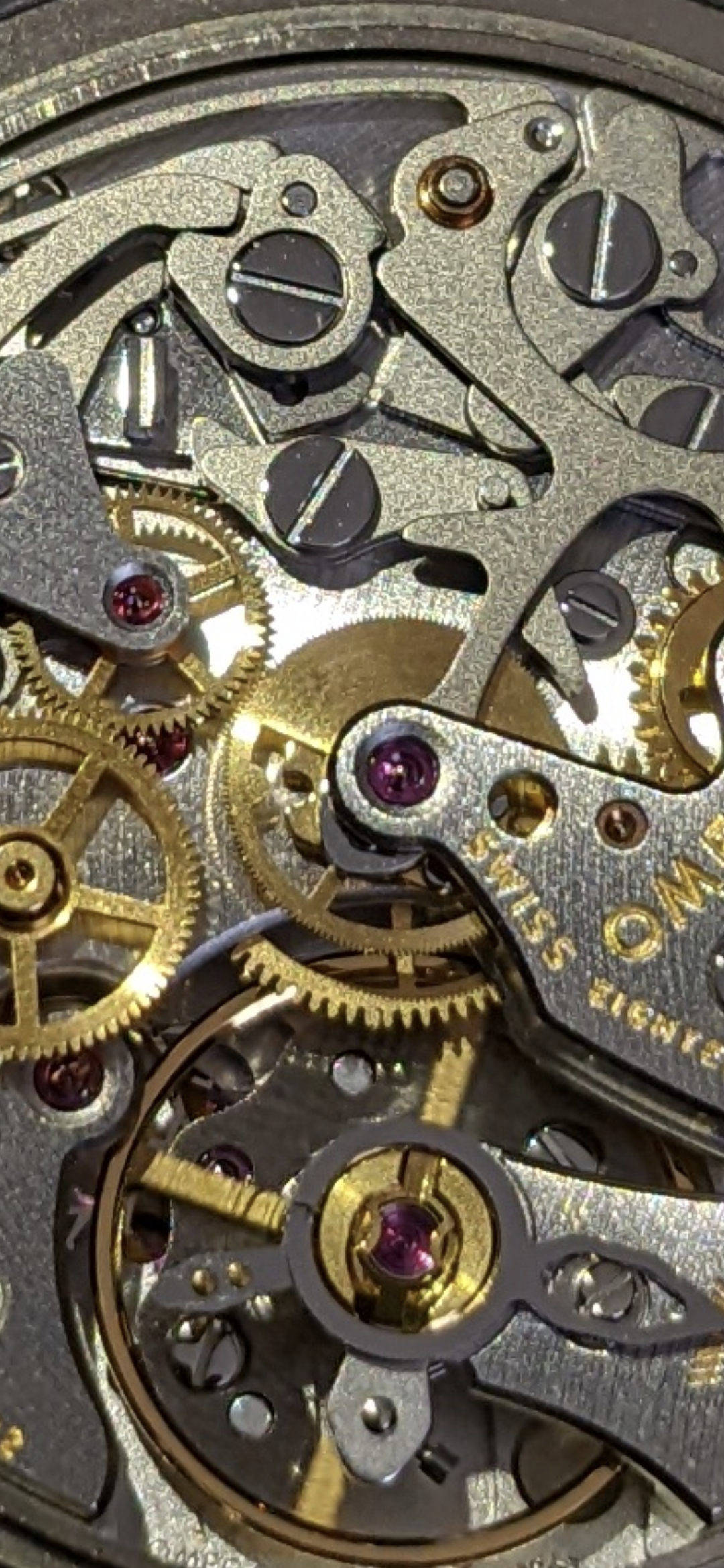

And this final picture is of a 1863 movement where you can see how the overall finish of the movement and the stopping lever both have a sort of "brushed" grain type finish to them with streak lines, which is different to the more "speckled" look the metal has on the 1861 movement.

Is the stopping lever actually difference in appearance between an 861, 1861 and 1863?
It's been a few years since I changed mine from Delrin to metal in my 1861 and helped a few people in this thread so my memory is a bit hazy.
All I really remember was the guy in the Omega service center said to me that they didn't have any 1863 levers currently but had an 861 one - because I was asking to compare the two in appearance before swapping out the Delrin so we ended up just putting the 861 part in there.
Is there actually a 1863 lever with a higher level of finishing/decoration like people keep saying?
Yes, both steel parts are decorated in the 1863.

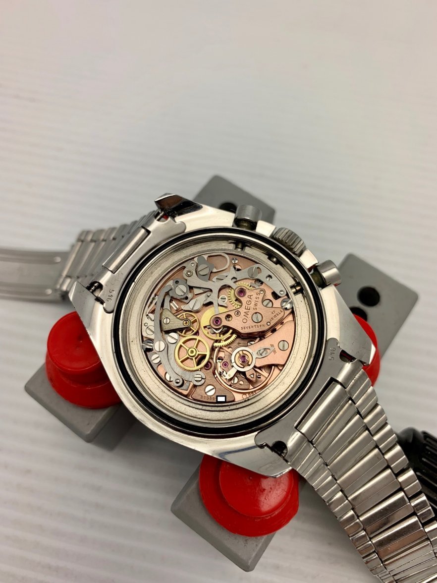

Thanks, I actually edited that post and decided to pull the back off my Speedmaster and take a photo to compare it to some movement photo's off the internet (above post).
Does it look like on mine (attached photo) they actually used the correct lever part to match the rest of the 1861 movement?

Can someone tell me if the plastic parts have already been swapped out for metal on this cal. 861? Thanks.
Looks to be steel Bob, you can see an oil stain which you wouldn't see on a delrin blocking lever.

Thanks, much appreciated.
