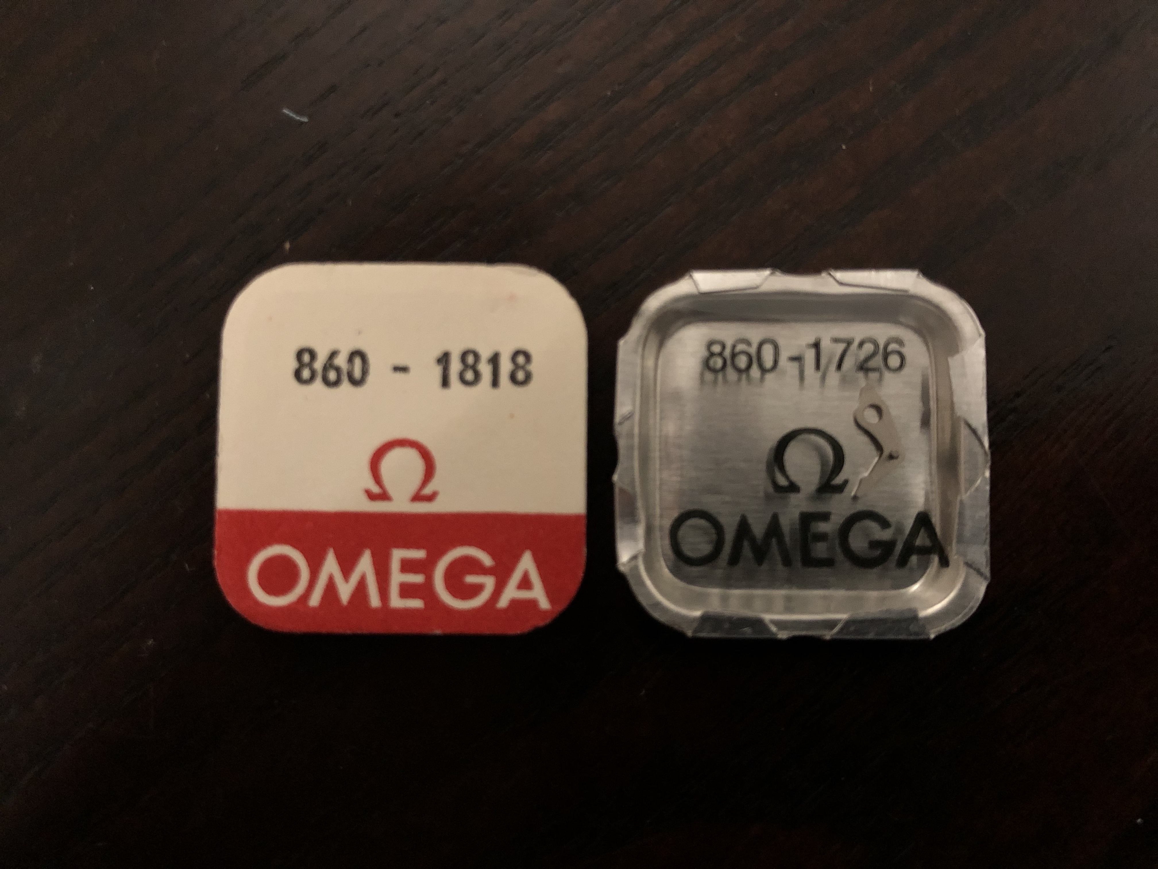

Thanks for the reply, Owlsu!
I had been able to find and order both the 860 blocking lever and blocking lever yoke as new old stock, so using the original parts (vs the 1863 parts) was definitely the plan. I went with the 860 parts thinking it would be cool to have part of the movement be linked back to the 60s/original non-321 movement (and because I actually hadn’t come across anywhere that sold/where I could easily buy the 1863 parts). Thanks for the heads up just the same! That is good to know that the NOS parts are better match for the modern Speedmaster—and that the swap may very well be straightforward.

Can someone actually confirm that these two metal parts (part 1818 and 1726) for the cal 860 (not 861) are drop in replacements for the delrin parts in the cal 1861? I too am going for an exhibition case back, don’t want the plastic but also don’t want the overly decorated 1863 parts.
Maybe @Archer can advise me?
30,265
78,114
Yes.
