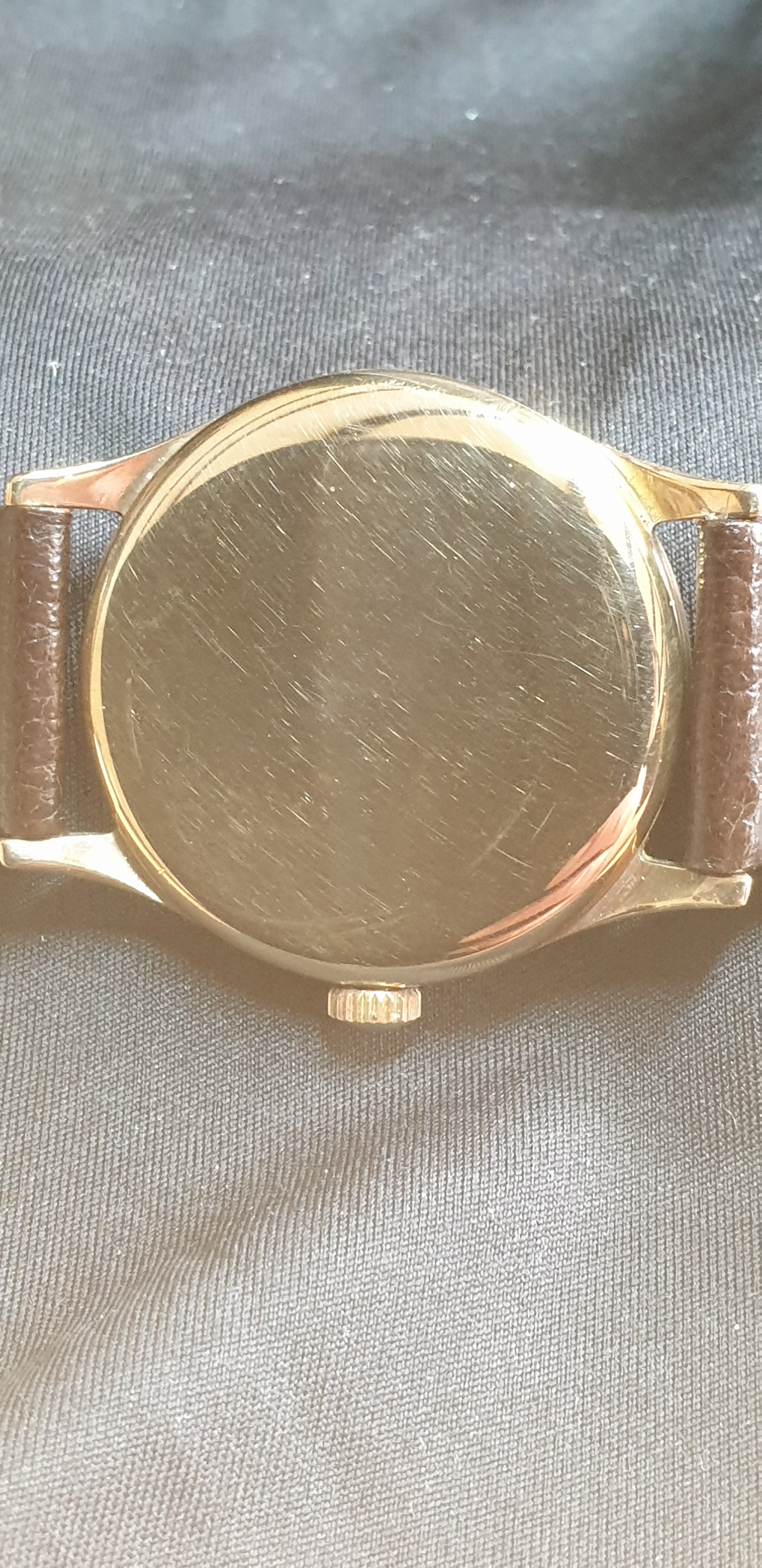

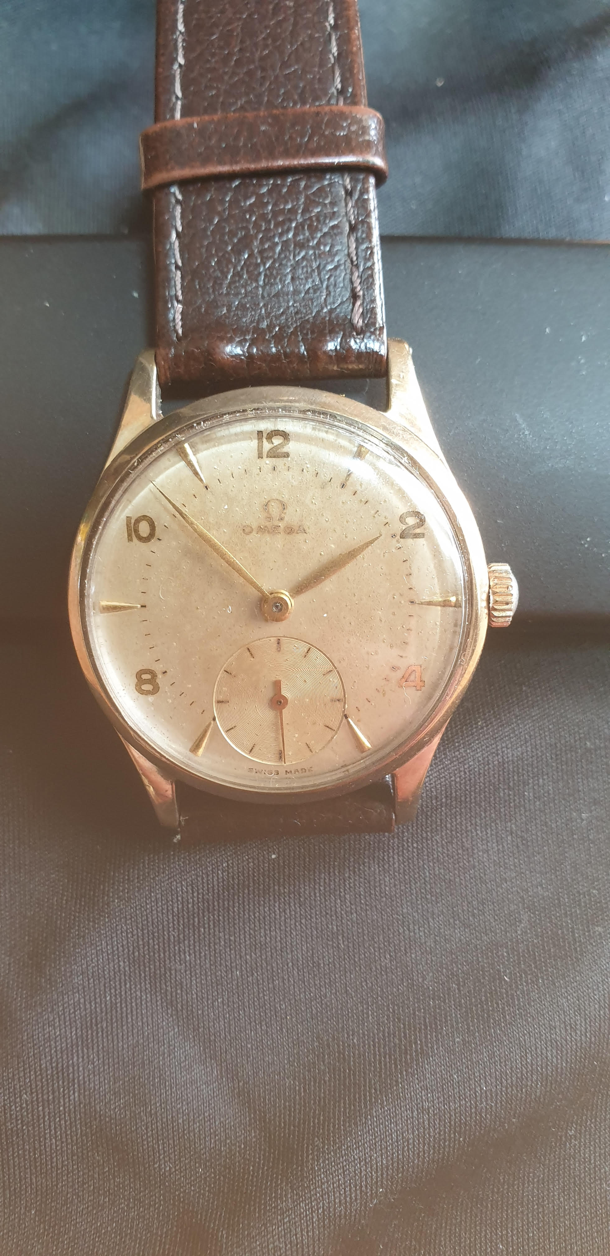

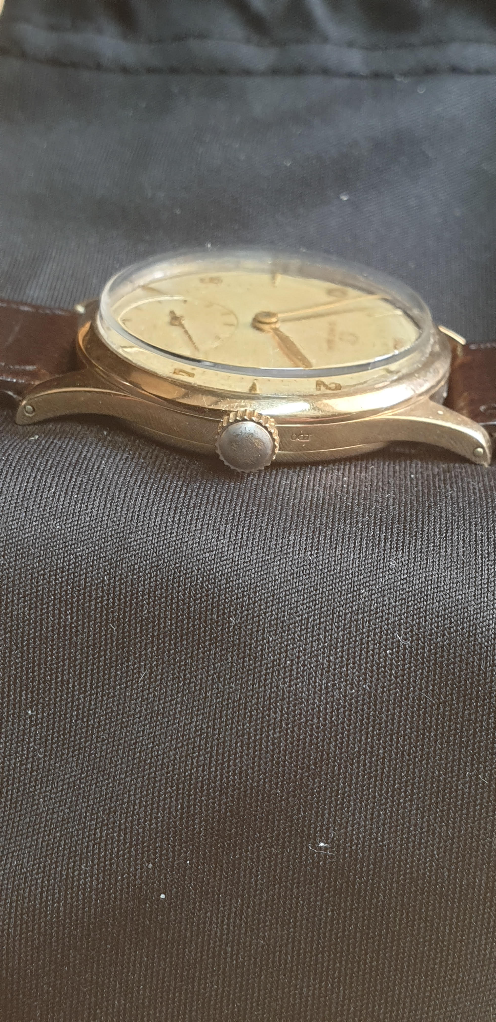

Hi,

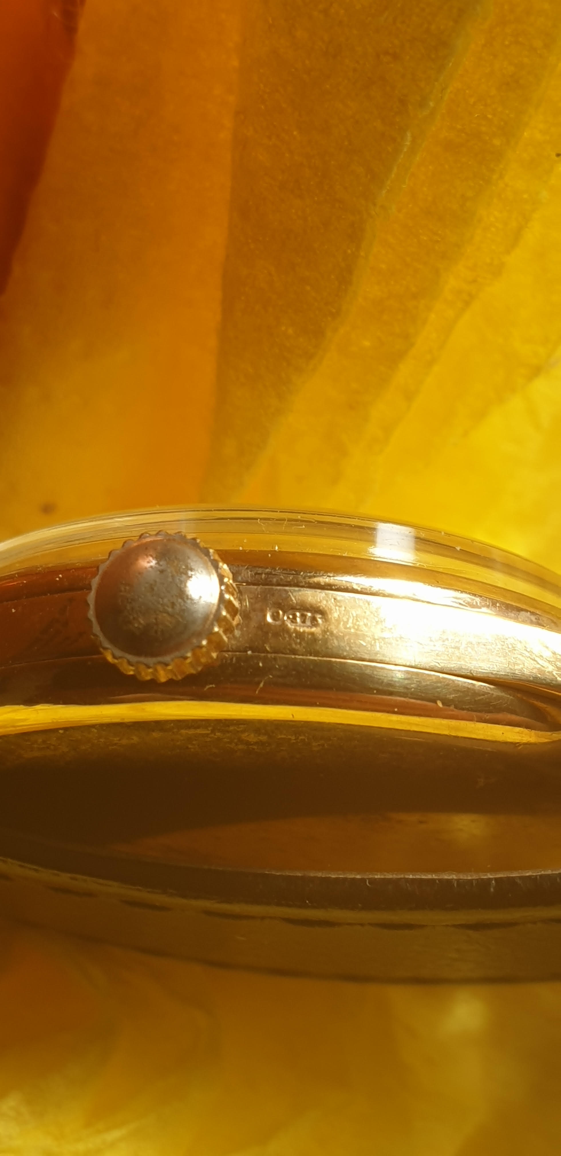

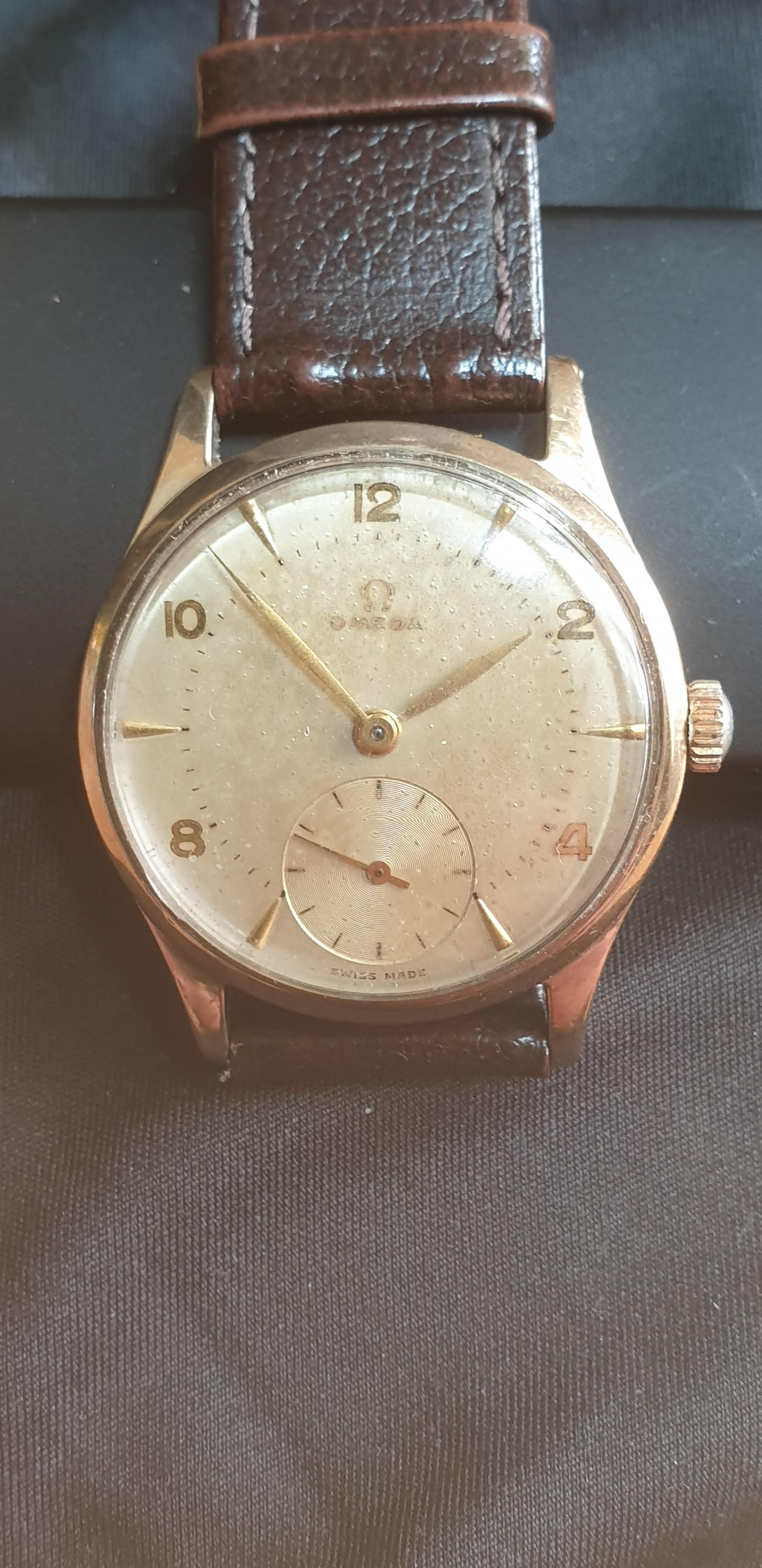

I was gifted an old gold Omega by my elderly uncle a couple of weeks ago and I'm trying to find out a bit more about it. I have posted the pictures below.
The case is marked "9.375" next to the crown, which I believe signifies it as 9ct. gold. The strap is obviously not original but I guess that's realtively unimportant.
The watch has a manual movement and is still in working order. The case diameter is 33.4mm and 10.4mm thick.
Can anyone help tell me what Omega this is or what period it's from please?

There is every chance is a Dennison cased UK market 13322 model. Not many (any?) Swiss made cases came in 9K so its bound to be local production and the marks look British. Dates from somewhere between 1946 to 1960. There will be a date letter on the inside of the caseback which will give you the exact date, the movement serial can be used too. It looks nice and original. It will have a version of the 30mm movement (later known as 26X)

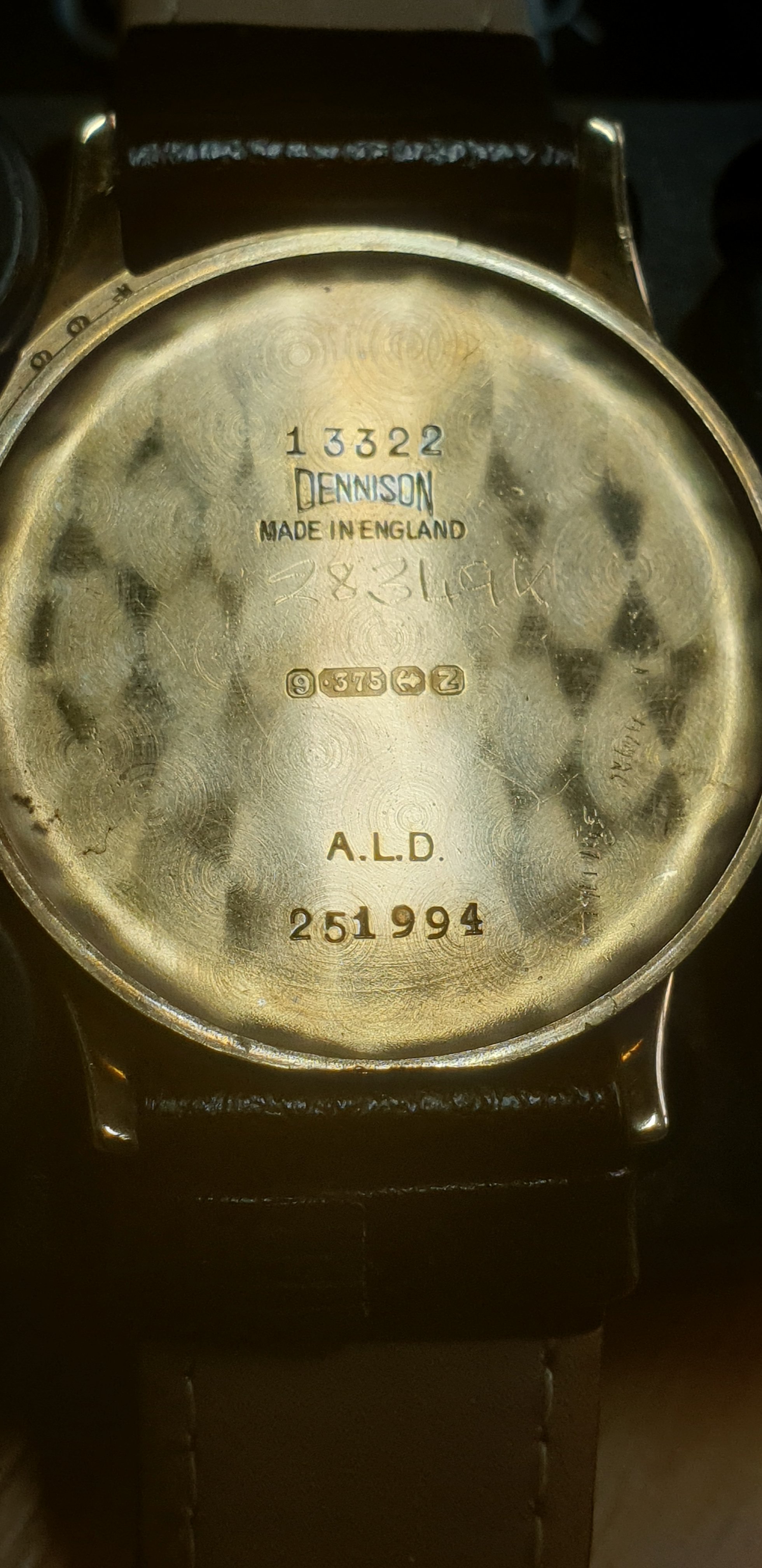

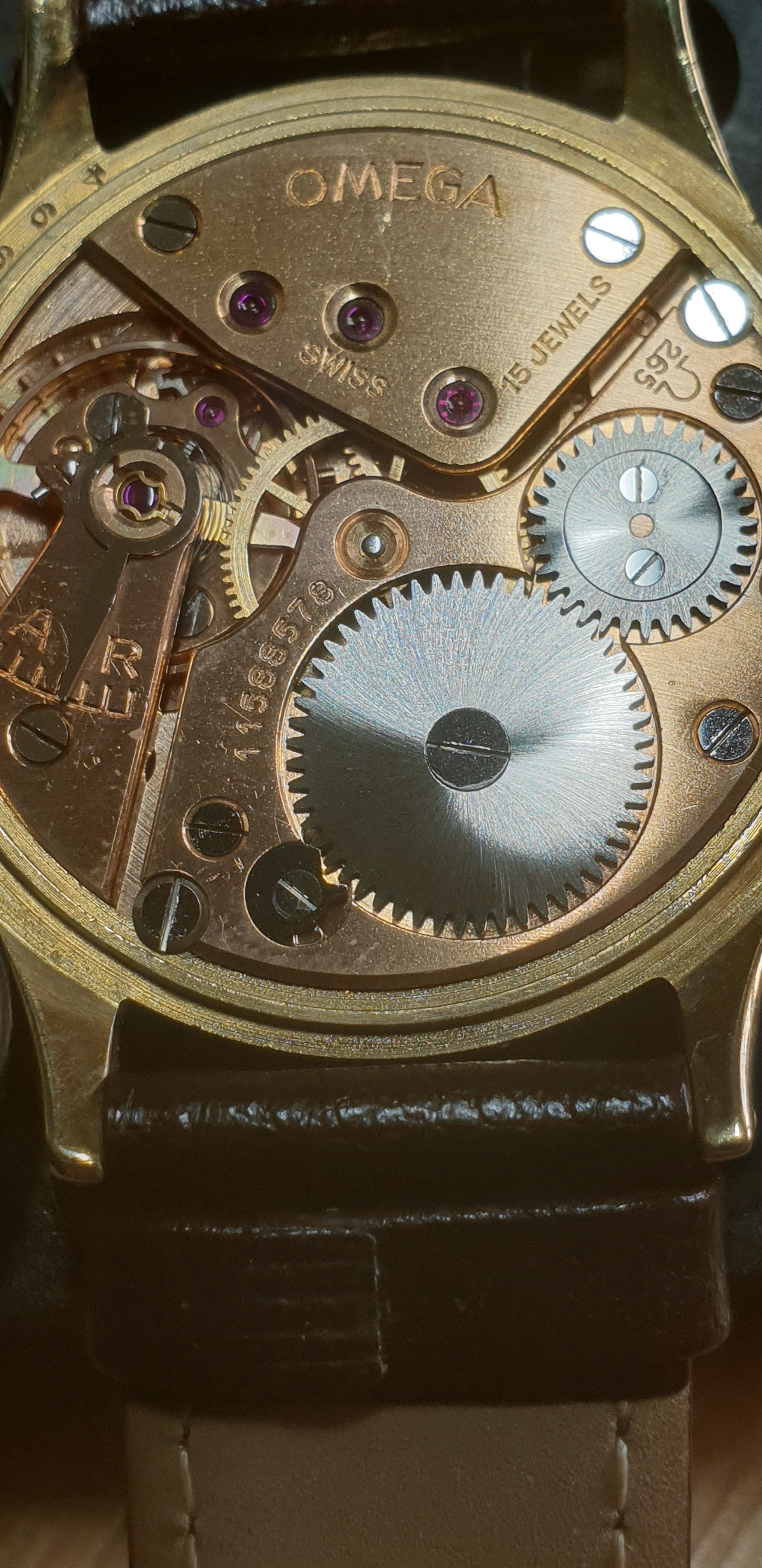

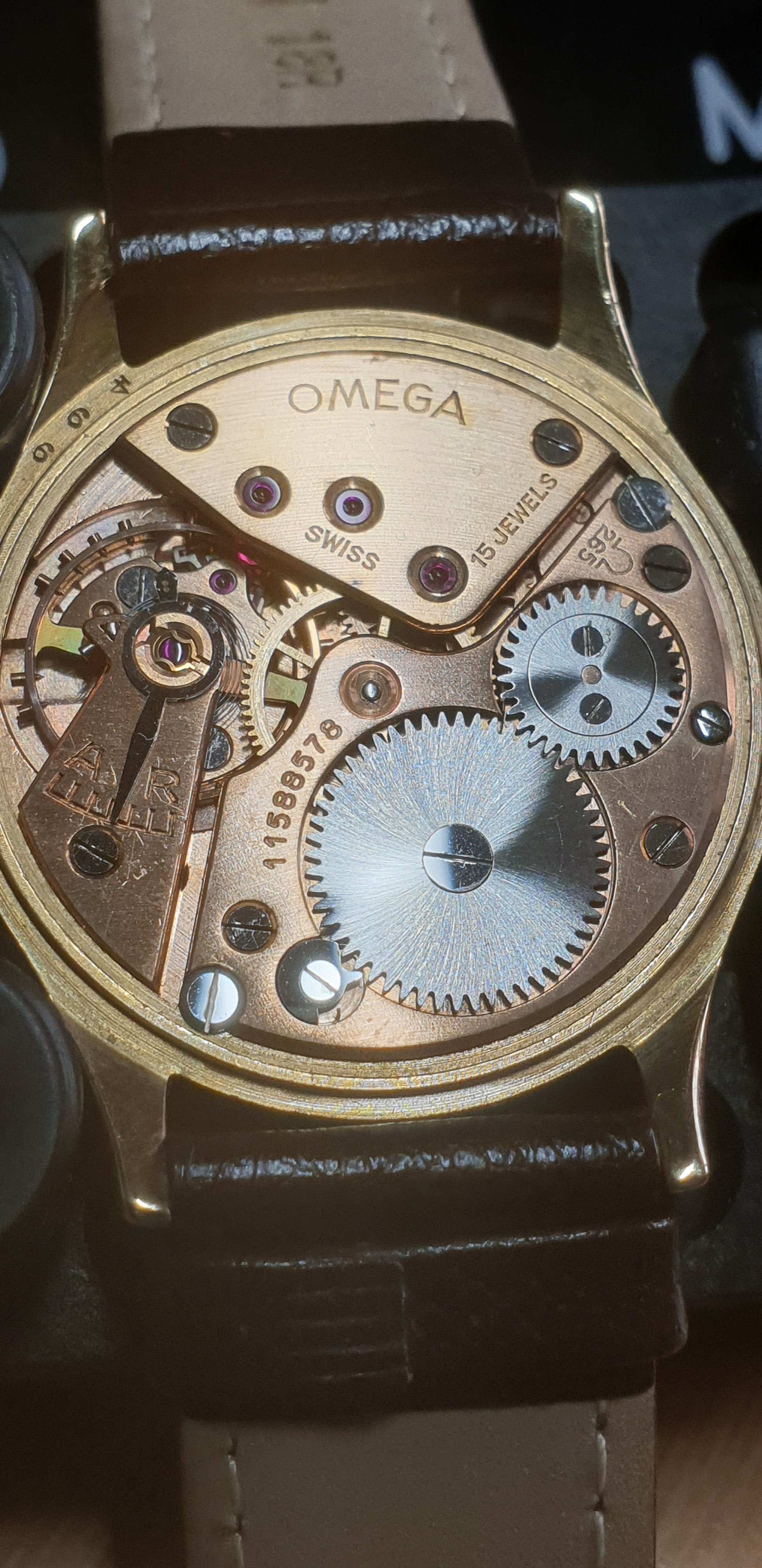

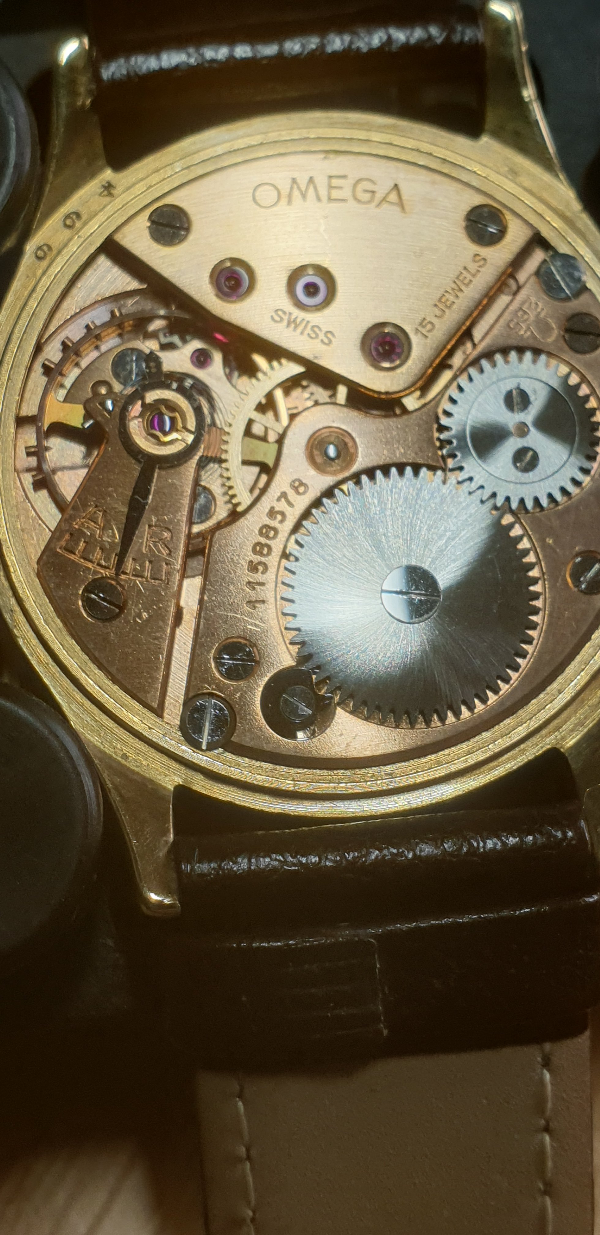

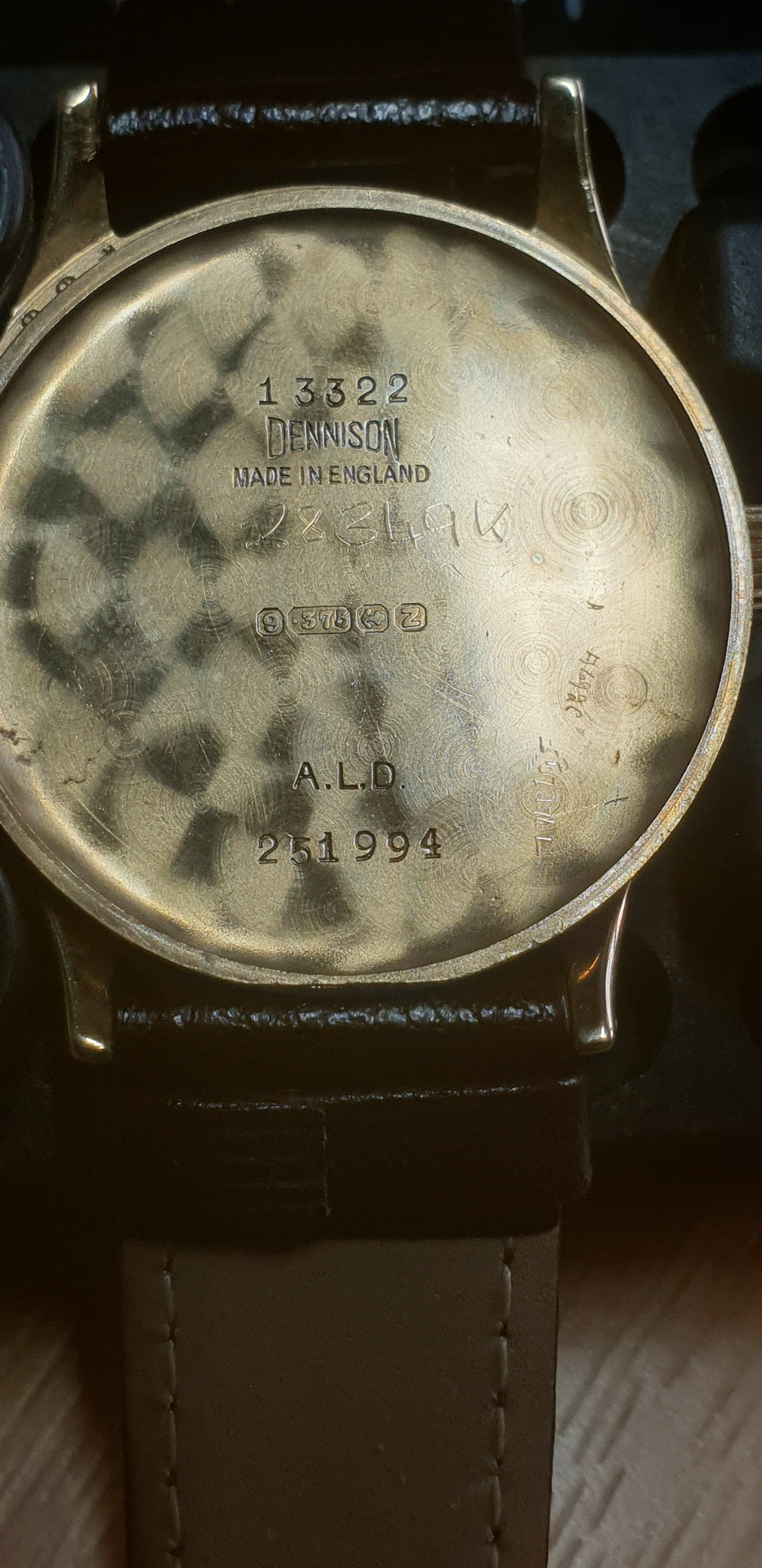

Got the back off - thatnks for the tips.
Here are the pics of the inside of the caseback and also the movement. As you guessed, it says Dennison. I think a quick check on the hallmark tells me it's from Birmingham 1949-50? I assume A.L.D. is Dennisons's marking? Unsure as to what all the other info is; serial number? Caliber 265?

Looks like I got it spot on. Yes as you say it has the Birmingham Z hallmark is for July 1949 to June 1950. It’s a nice thing in pretty good condition and seemingly all original. There isn’t much more you need really.

A lovely watch to remember your uncle by. The serial number on the movement dates it to the latter half of the 1940's. These movements were very robust so if you have it serviced regularly, it will serve you for many decades to come. There may be a mismatch between the hands and dial but not a big issue- something could have been changed over the 80+ year history of this watch.
