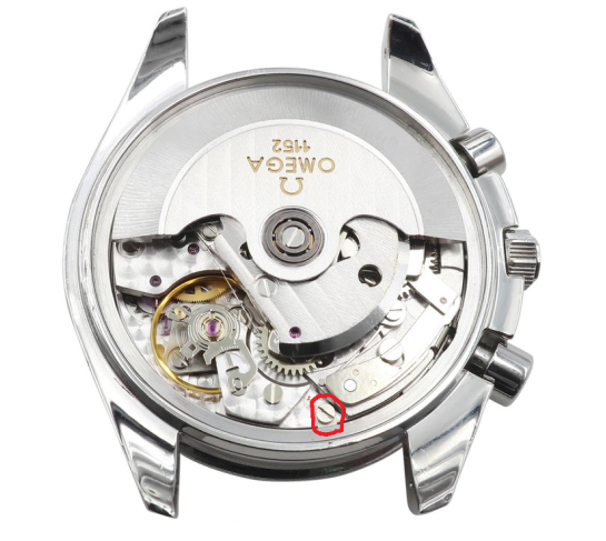

I recently acquired an speedmaster and the piece that holds the movement inside the case had been broken in half, I would like to buy a new one to replace the broken one but I have no idea what it is called or where to find one to order, I circled the part in the image below and I'd be grateful If someone could help me out here!

Case clamps/tabs are specific to the design of the movement and case, although many generic kits will do the job.
If you know exactly what you're doing, there are heaps of them available. An eBay example:
https://www.ebay.com.au/itm/171197749763
If you don't know what you're doing, take it to a watchmaker.

What is the number inside the case back?
37
theres a few but the first one listed is 175.004 and the number on the movement is 1151

You need case clamp - Omega part number 1060061. Google "Omega 1060061" and you should find some on eBay.

TYSM
