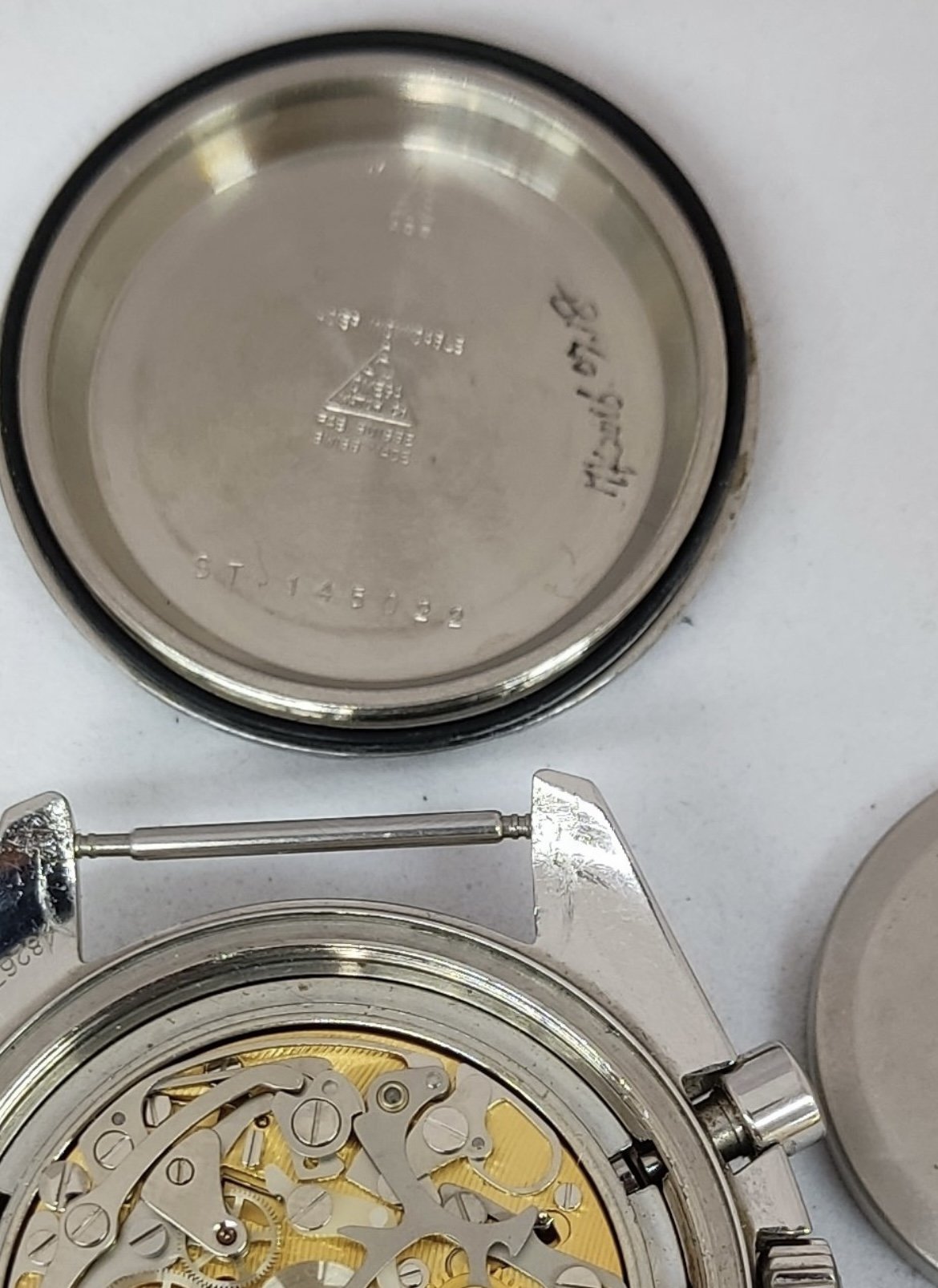

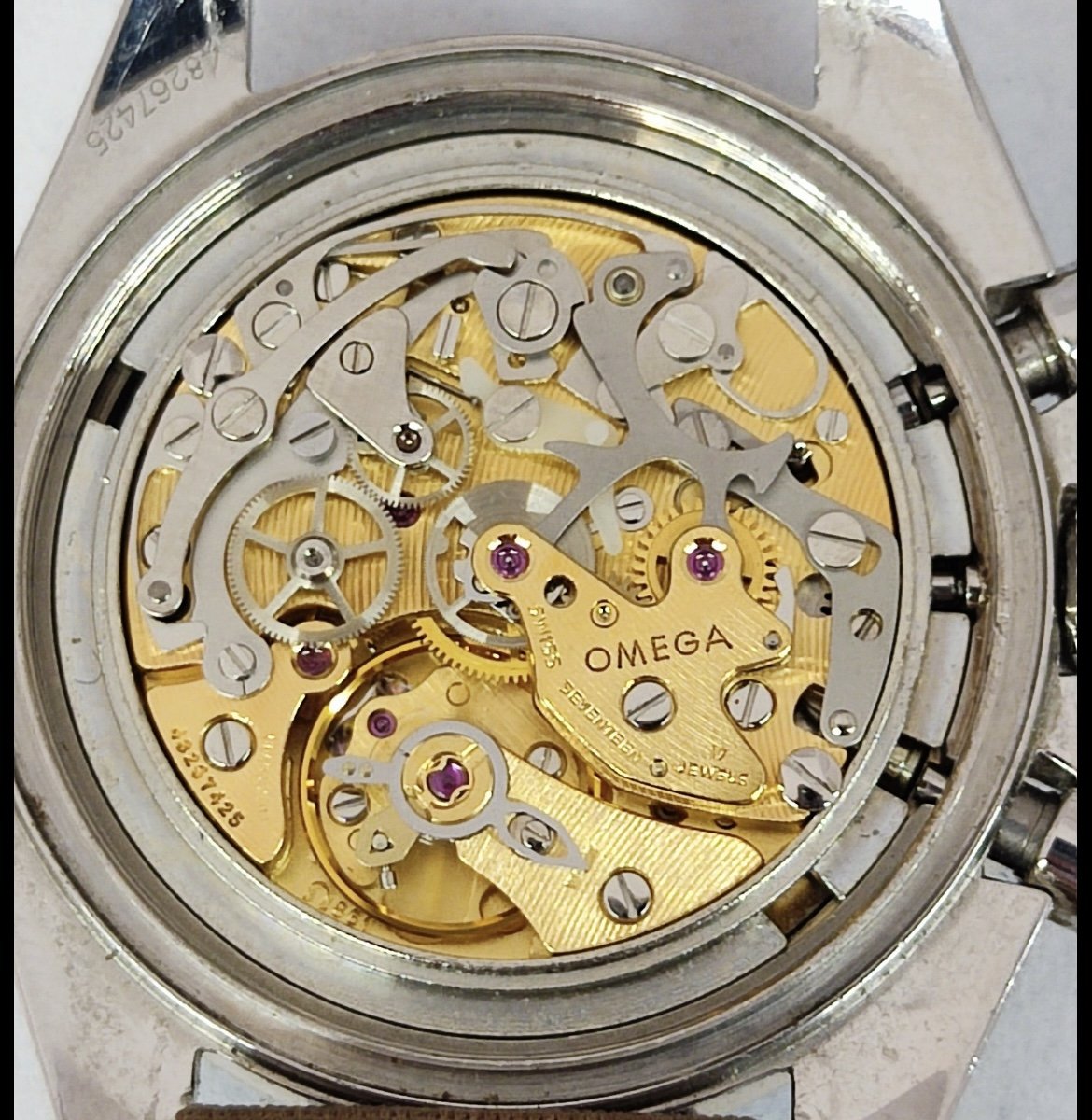

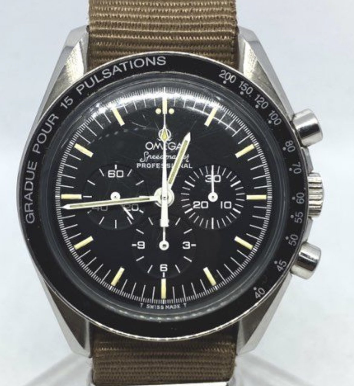

Hi all,
Am trying to identify this model am considering and whether it is original or not…
Any help is appreciated… so far for me the reference number does not look like it matches a 145.022 reference… but I might miss subtleties…
Don’t have much more info about the watch so far. I just got the pictures attached (as the seller is quite far from where I live)
Thanks a lot!
297
242

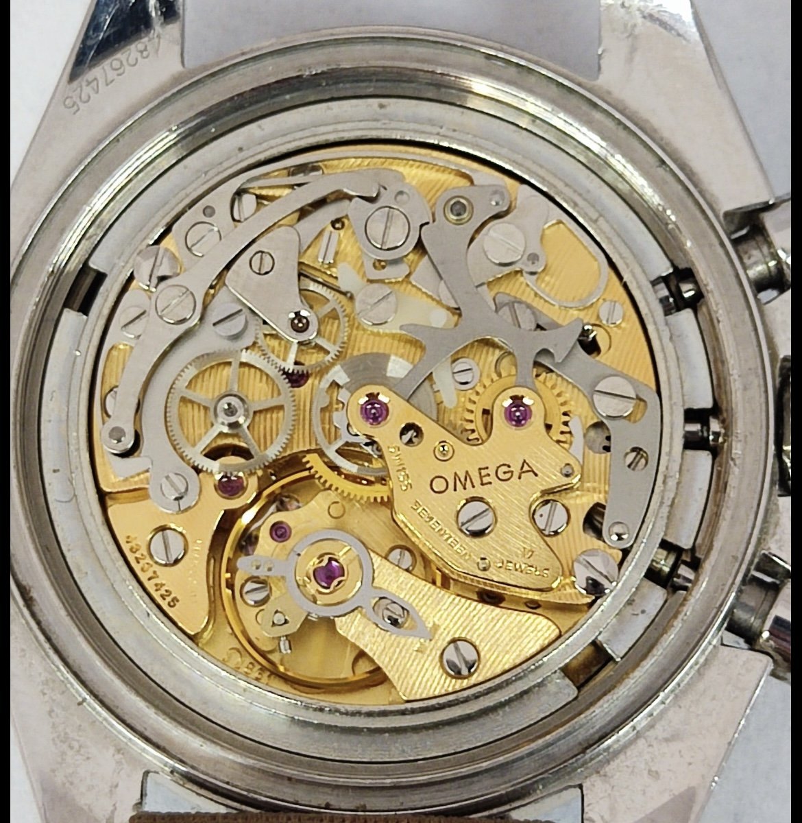

Because from guides I found online that reference (looks the same on movement and case, even though the second ‘8´ looks like a ´3´ on the movement ) corresponds to a ‘91 145.0022 model (3590-50).

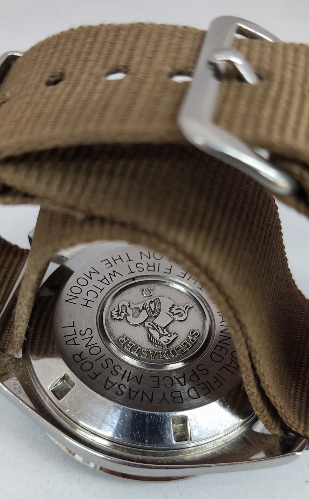

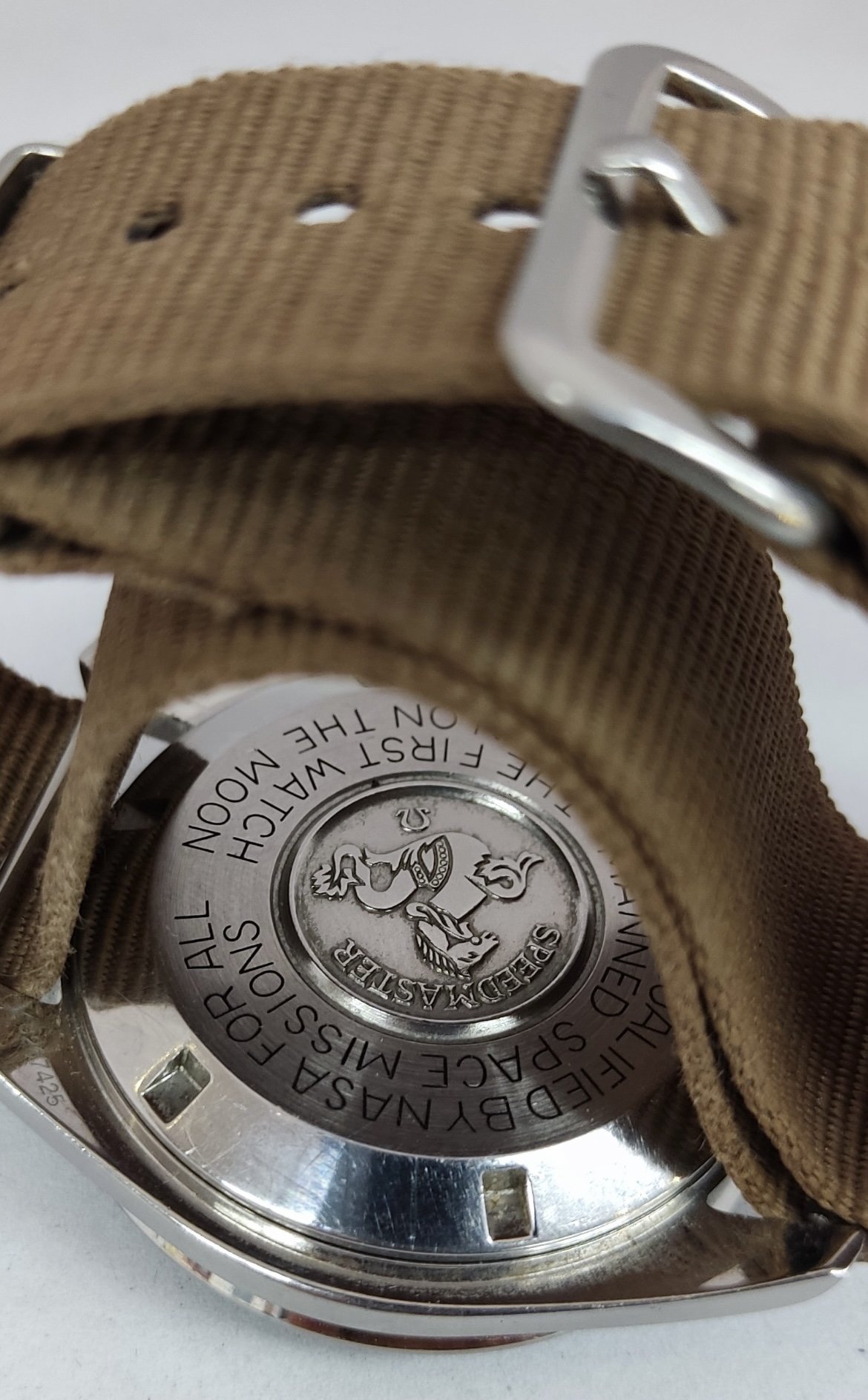

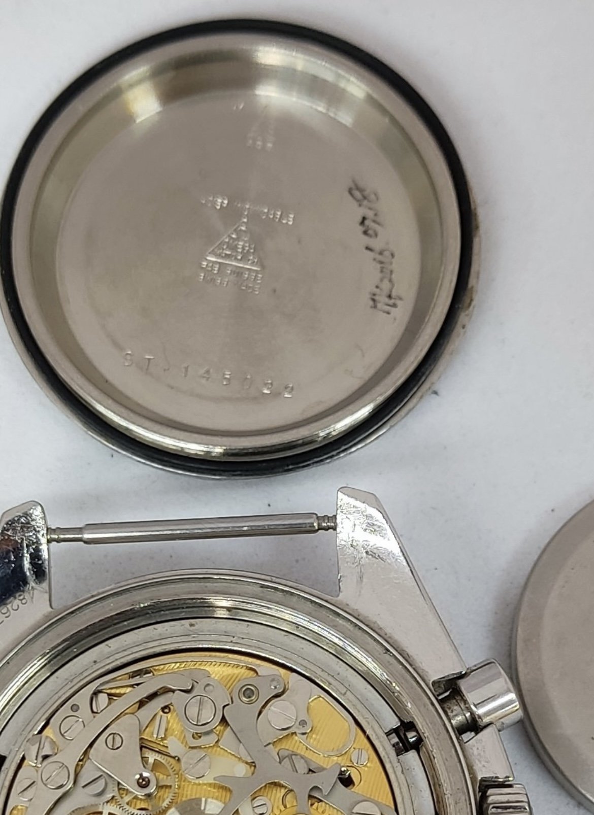

Here is also an additional of the case back:

It is either legit or franken. What makes you think it is not legit?
297
242
For a first I would have expected a « 145.0022 » on the case back and not « 145.022 » but am no pro…
297
242
But it’s a 145.022, not a 145.0022
Not according to the serial number…
18,330
27,698
Sigh…. Perhaps you should understand the relationship of 145.022 and 145.0022

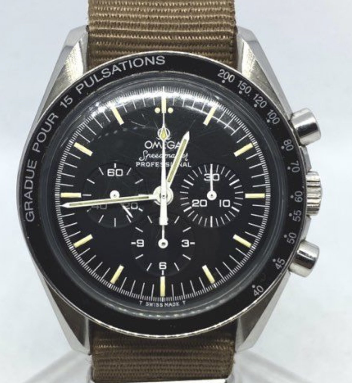

to everyone else looks like a late 80’s piece to me with a pulsation dial added. I didn’t check the serial. But the dial and caseback would be my guess from the fonts and other details.

This might answer part of the equation:
That is not the entire story..
There are watches from the late 80's marked 145.0022 till the mid 90's which was the internal part number for the case, while the reference was 145.022. Hence they are the same all it does is denote the time period that the watch left the factory for the 145.022 run, which was anything after 1980 into the 90's when Omega moved to the new reference system.

Then can we say with certainty that the case back does not correspond with the rest of the watch? Or is it only the dial that looks like an ´80s one on a ‘90s watch?
Since you apparently have a copy of MWO...
Also this has been answered at least 1 time already.
But serial number, caseback, and dial are all correct for an early 90's watch.
In fact as its a 18 jewel marked 17 jewel watch its puts it into a narrow range of watches that span from 1989 to early 1991. Which matches the speedmaster101 prediction.

Ok thanks a lot, am really a newbie with speedmasters… don’t want to end-up wearing a non-sense watch.
And from what info I also gathered it is a long S and R model with A.D.B. case, which seems specific. Any idea if that is then an interesting model and what is a faire value price for it?
261
195
I monitor the fake watch forums (know thy enemy) and there are no good speedmaster fakes. They don't have a movement which can handle the positions of the subdials. Basically you can spot a fake a mile away due to the spacing between the subdials. Your watch has correct spacing.
I don't know enough to know if the back case is original or not, but the dial and movement are real, assuming the watch can keep time and the chronograph works.

The question is not if this is a fake, the question is "Is this watch made up of parts that do not go together"
