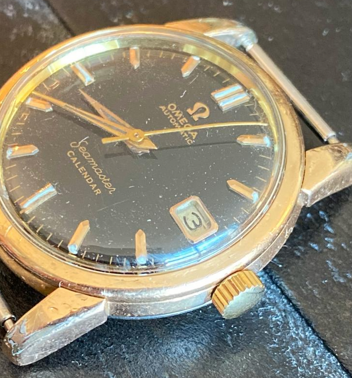

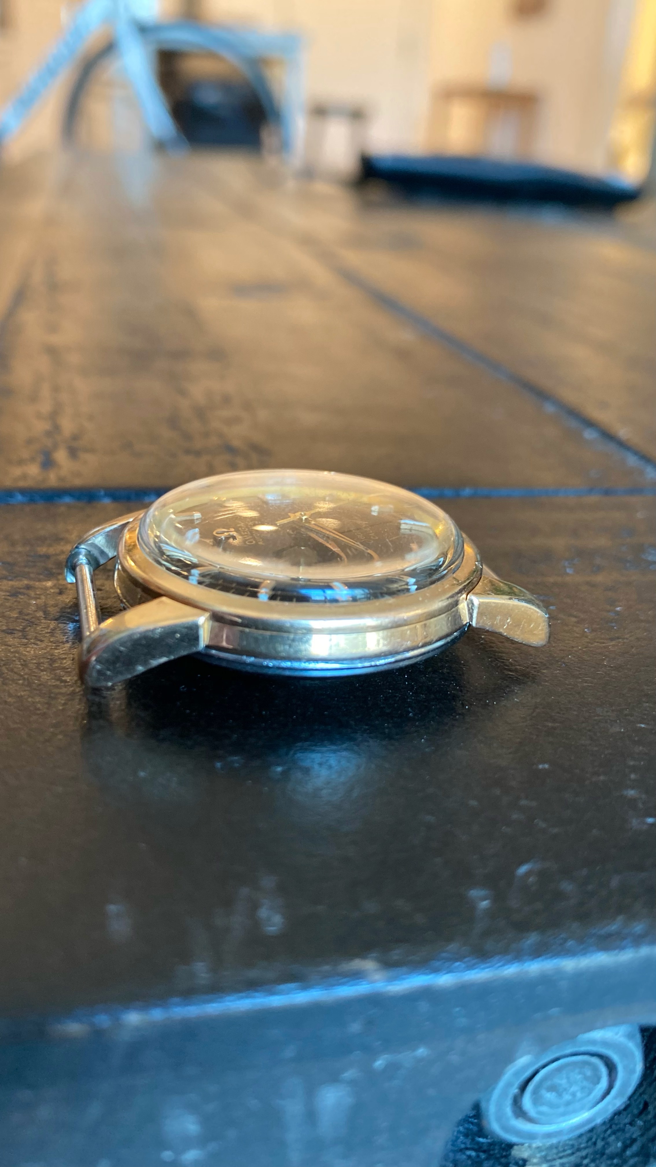

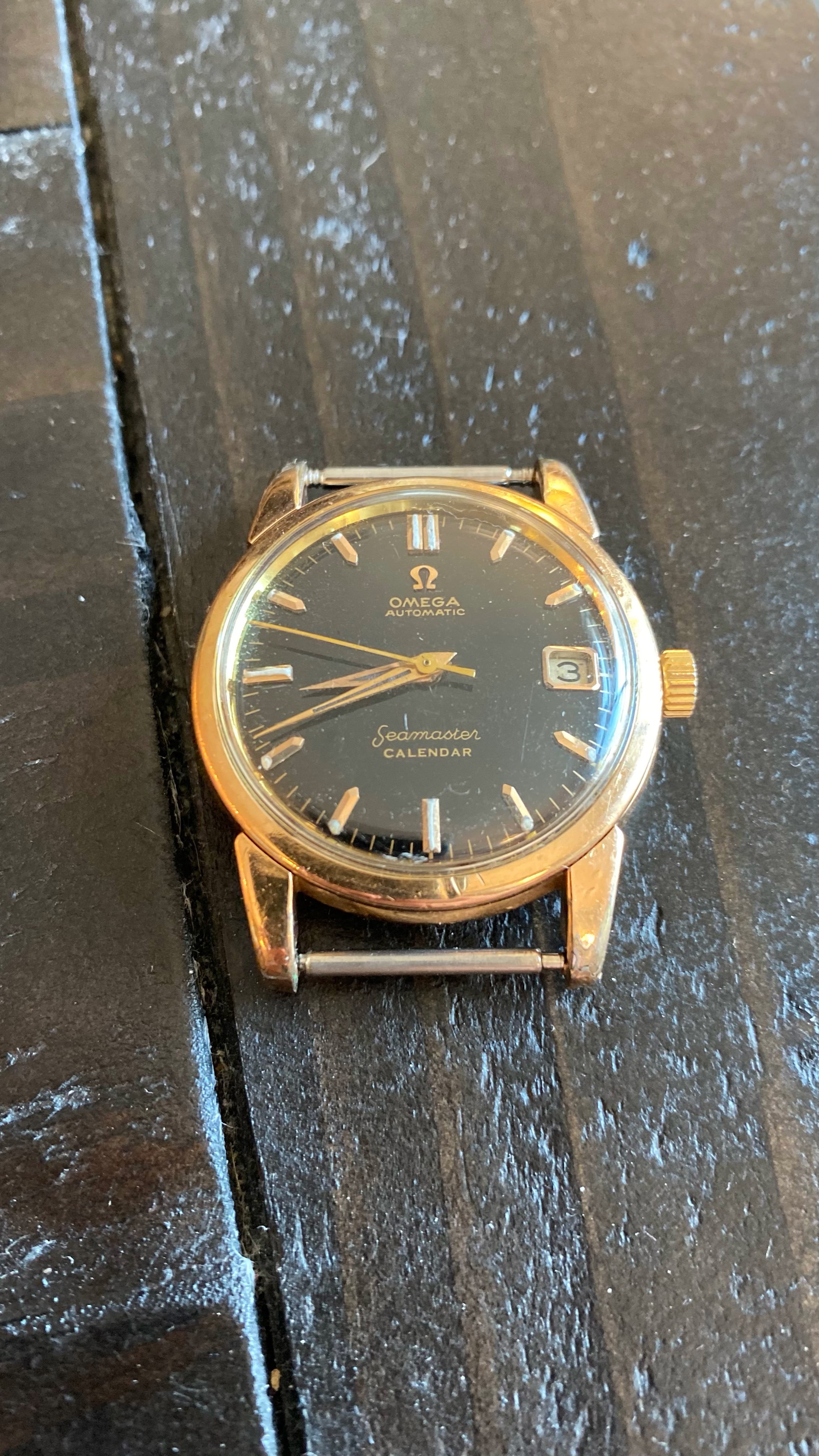

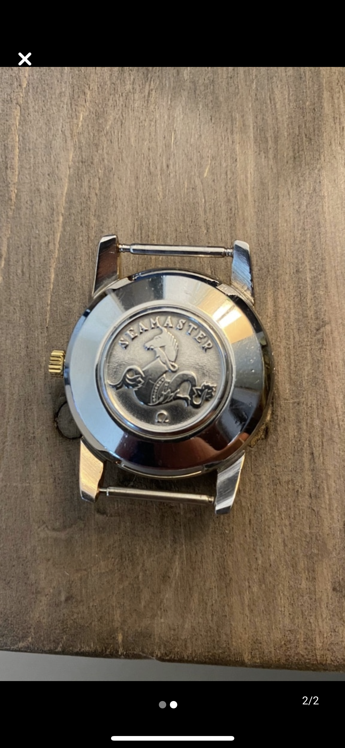

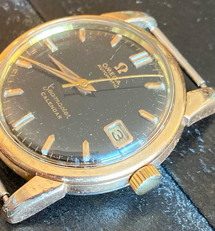

I've found a private seller selling an Omega Seamaster Calendar, I believe its from the 60s, no paperwork. They are asking $450 (US) for it and curious to get any input. I've attached the available photos and a video as well.

BTW it looks nice to me.

Older, mid-50s. 503 movement, perhaps. Early rotor. Crown may not be correct. Otherwise, looks good for the price. I have one myself but a different case with a not-as-nice dial.

The case is very beat up and worn and at the very least the dial has been rather poorly relumed.

I'll go out on a limb and say that the dial has been redone. The gloss finish doesn't match up with the case condition and the length of the minute markers + apparent missing "swiss made" are suspect as well.

Thank you everyone so much. The guy did say his grandfather had it restored before he passed and had taken it to both Korea and Vietnam but not much else to go off of.

I can help you assessing the probable market value of a genuine, "original" watch, but not a redialed one, sorry. It's a completely different market and one I don't partake in.
No offense meant at all, but the usual buyer for a redialed watch would rather spend $1000 on something he likes the pristine look of than he would spend $500 on something that has been looked after the last sixty years, but shows it age nonetheless.

I can't get past how badly beat up the cases is, hard to wear that much gold off a capped case.
Maybe the owner was an auto mechanic.

Actually, I thought that might be a service dial, seeing as how the 2627/353 service dials look very similar.

Is there a certain part # in the event that I want to replace the case?
I tried my best searching here, google, ebay, not much info out there that I can find with my limited knowledge

It should be a 2849 reference. However, I would strongly urge you not to buy this watch.

Am I dreaming or are there only three minute markers between 11 and 12?
