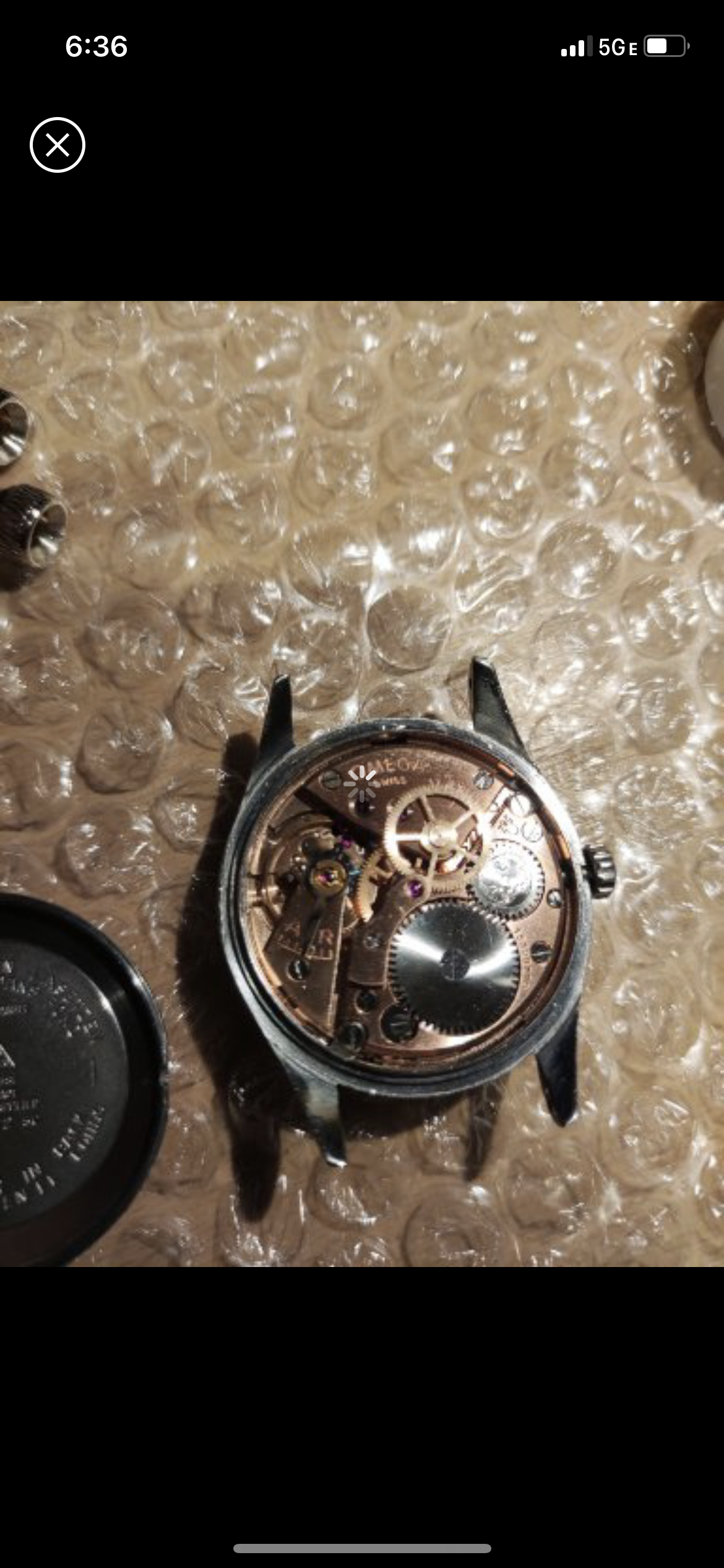

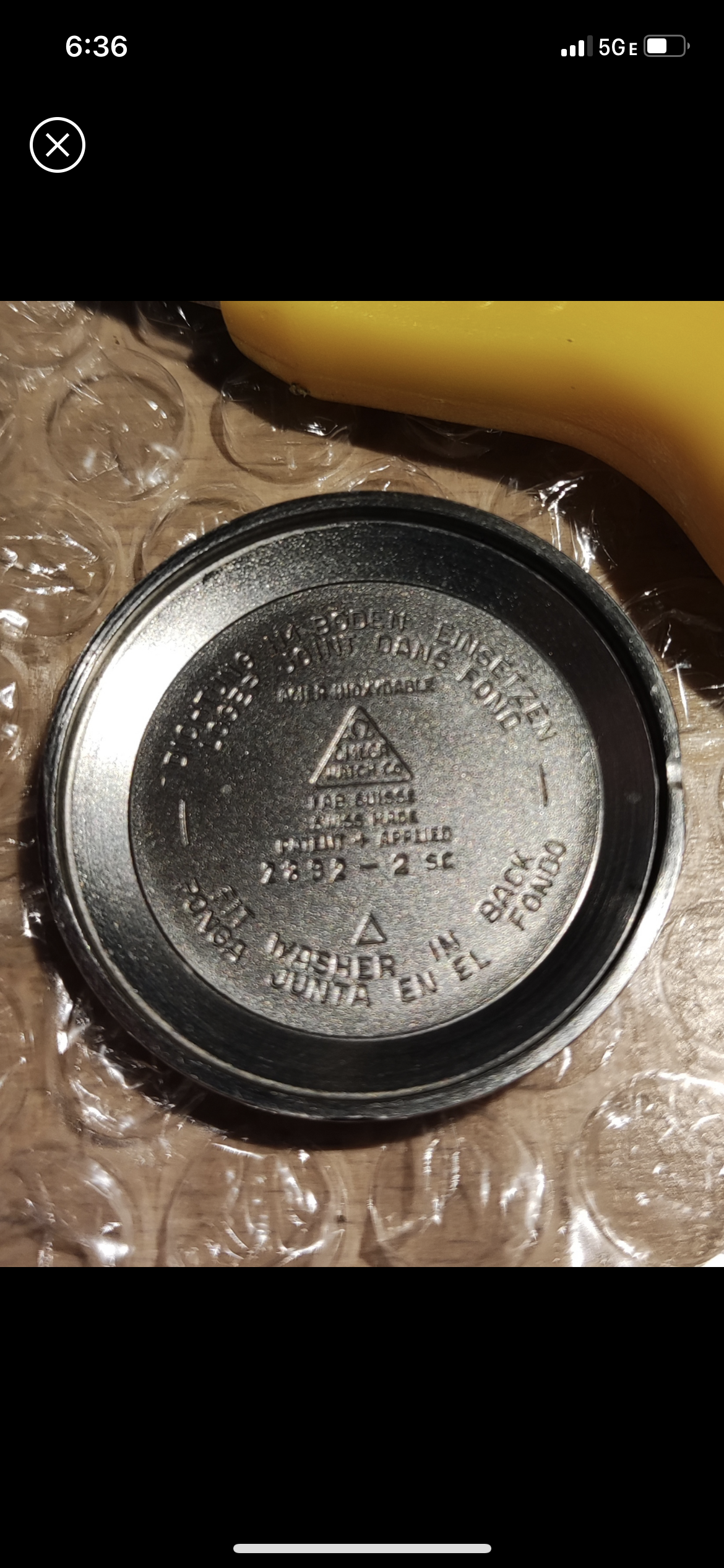

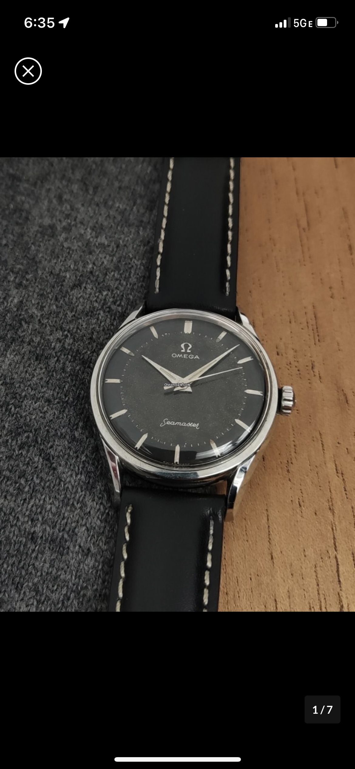

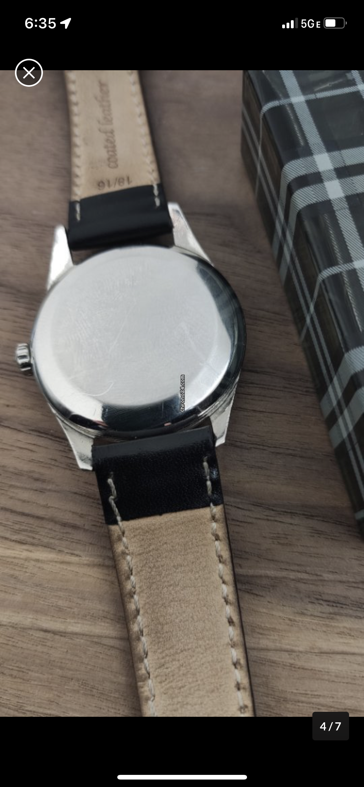

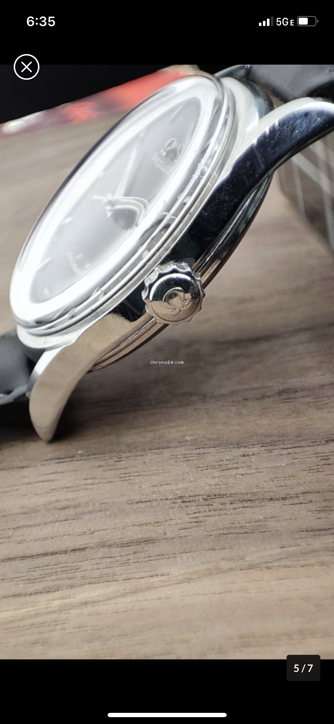

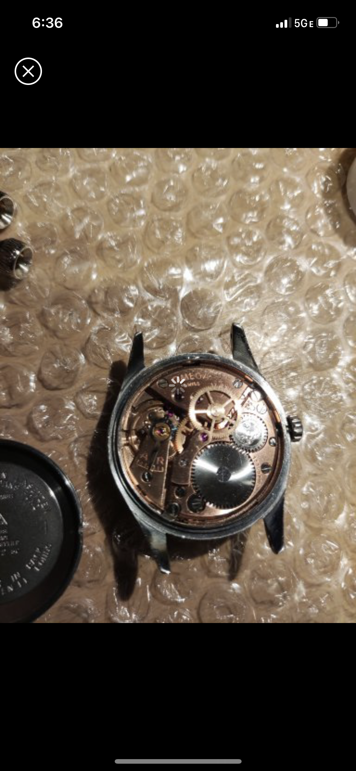

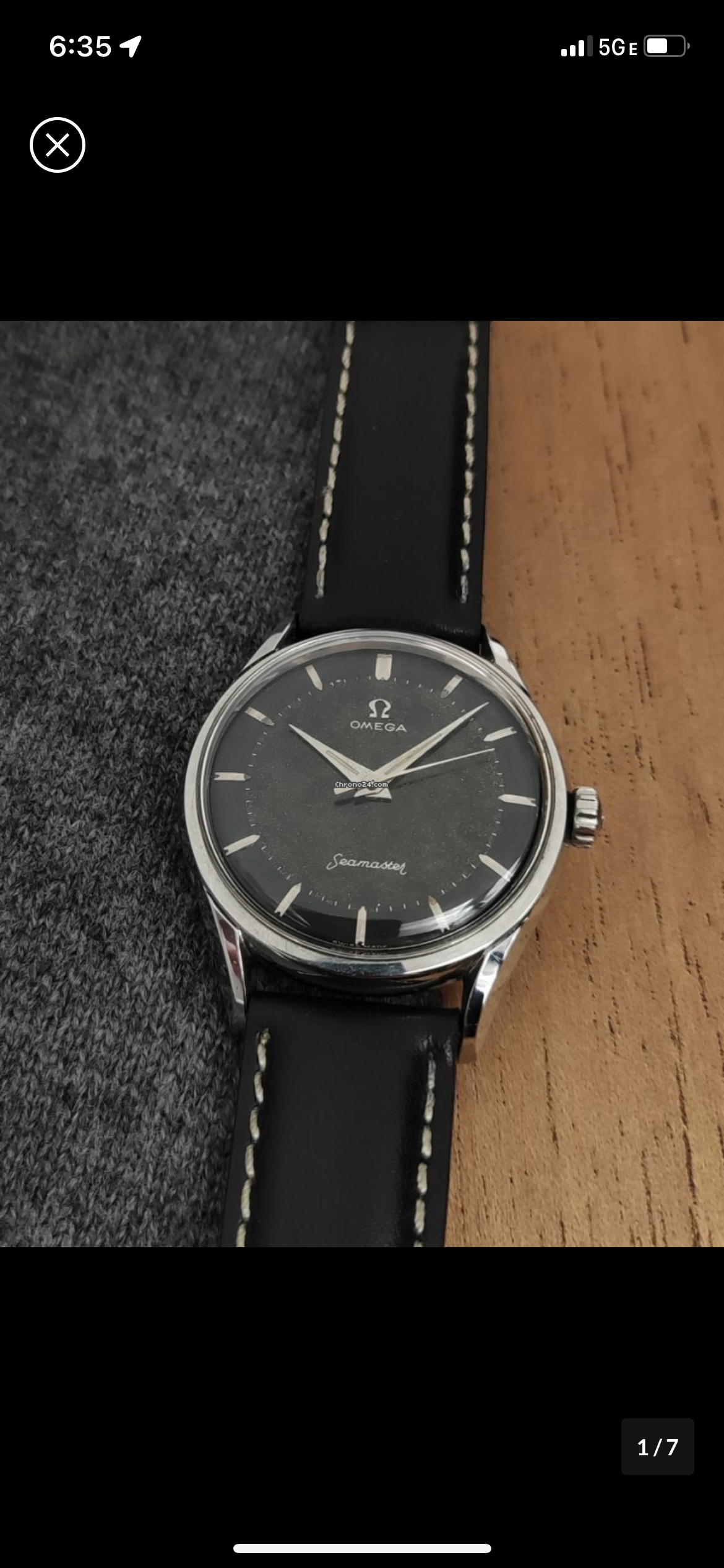

Hi all - I’m brand-new to this forum and pretty new to vintage watch collecting.
I love the look of the mid 50s Seamaster with black dial, silver hands, and no date.
This one is being offered for $900. I’ve verified the serial number on the movement as being from 1956.
I can see some marks on a few indices that could be a bad lume replacement or perhaps evidence of a redial. But it also has a patina, so I figure it’s not a redial.
Any advice?
Is $900 a fair price based on what you can see?
Thanks all!

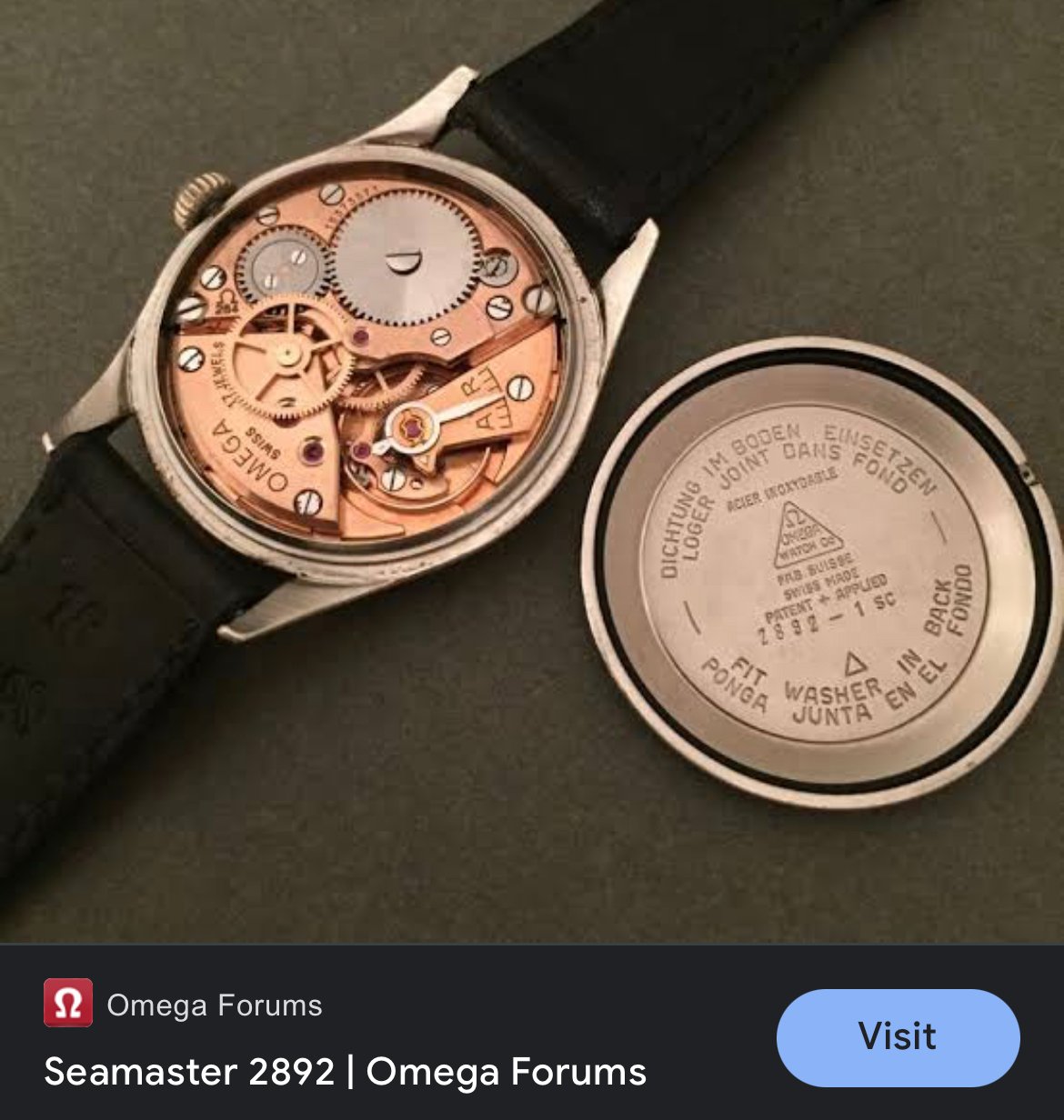

Something tells me that if I look up a ref 2892 it's not going to be a Seamaster.
Fair point. There seems to be some question about this, but the consensus in this thread seems to be yes, it is a Seamaster.

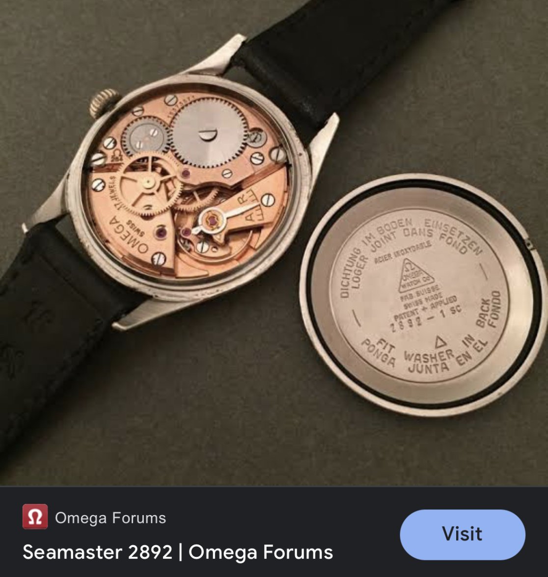

I looked up 2892 and a myriad of seamasters come up so it is a seamaster reference according to Dr Google.
Awesome. I guess you're good to go. 👍

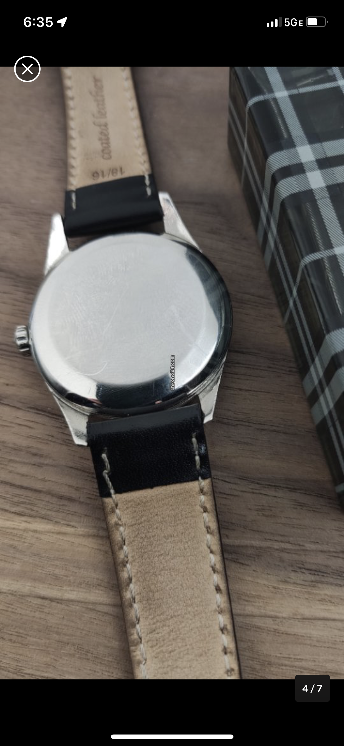

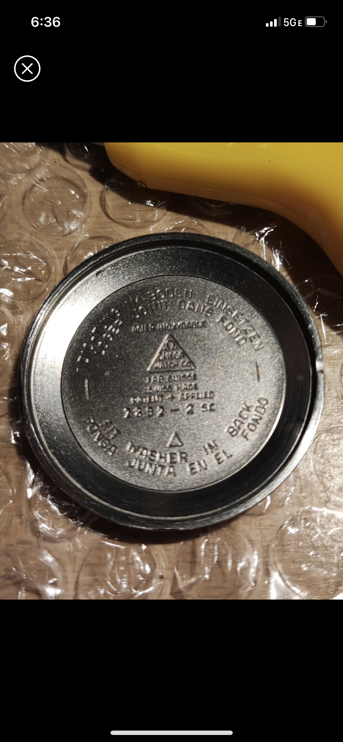

A Seamaster would have a screw-in case back.

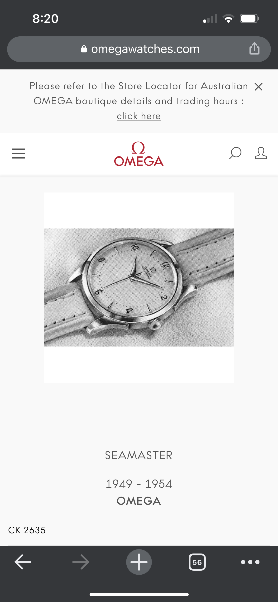

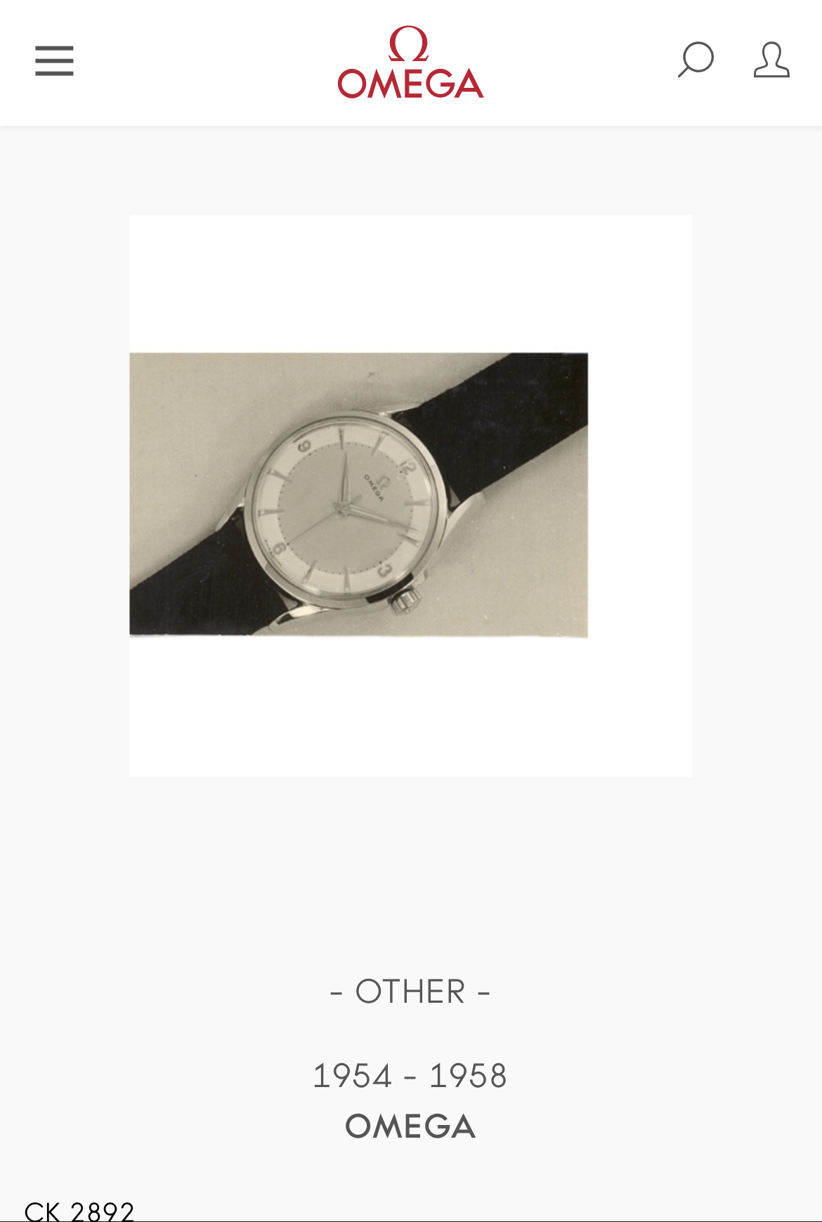

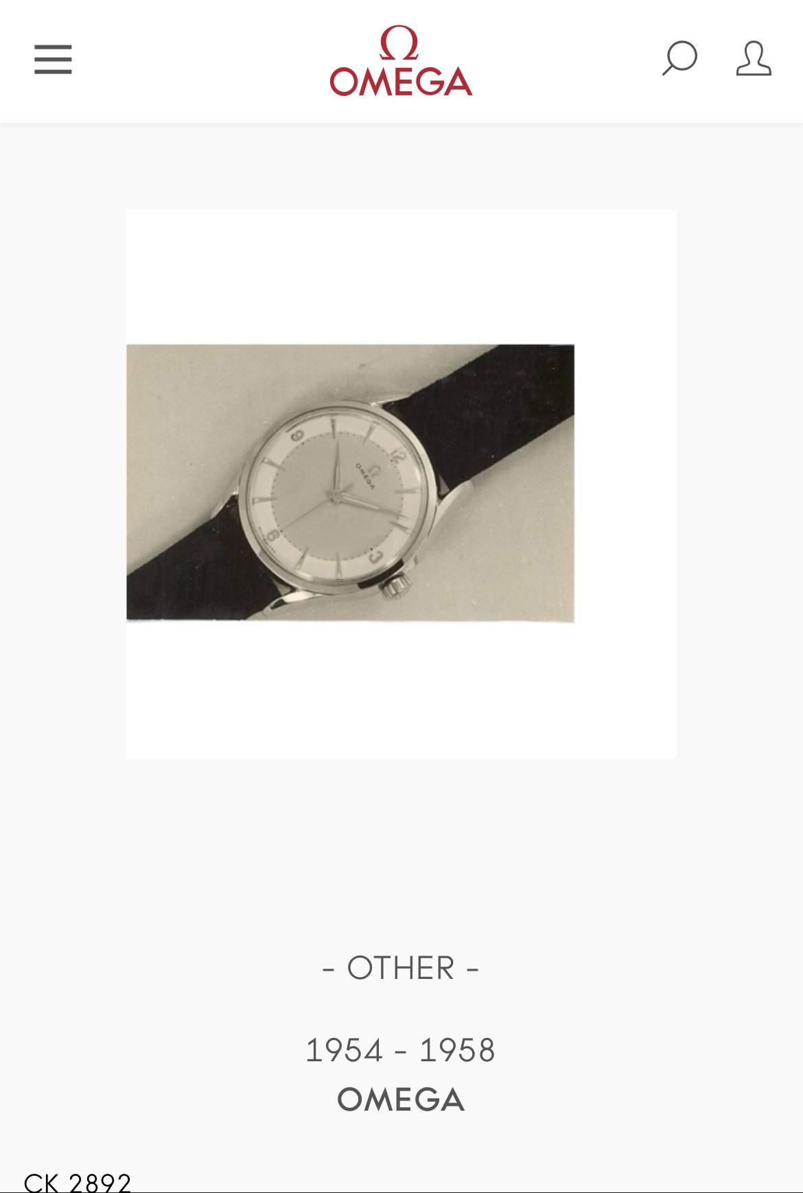

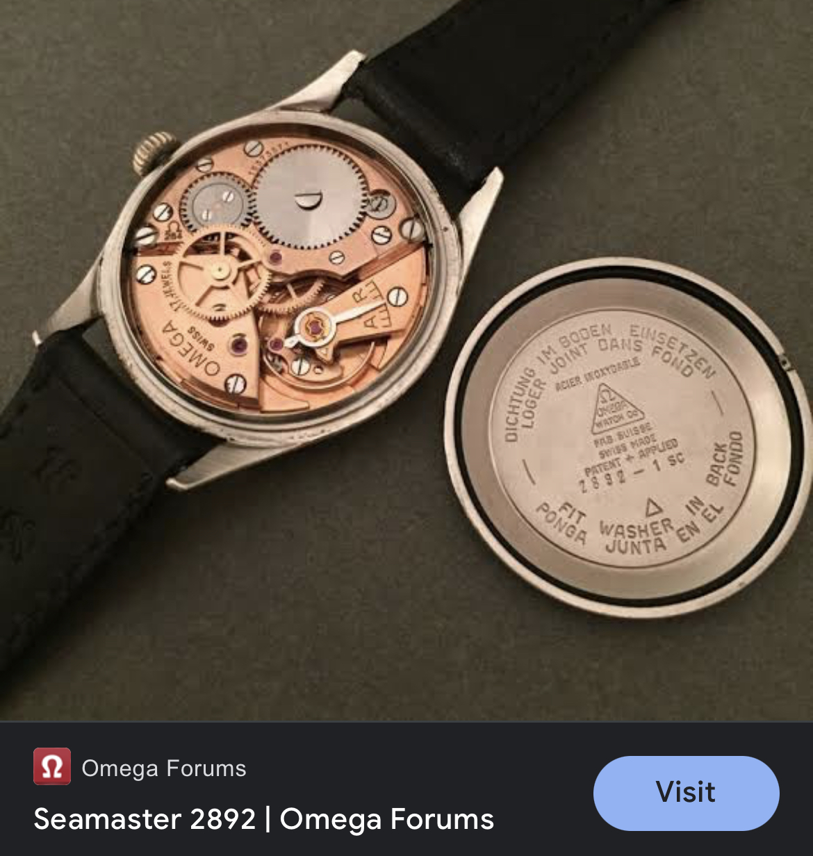

Google and this forum has this

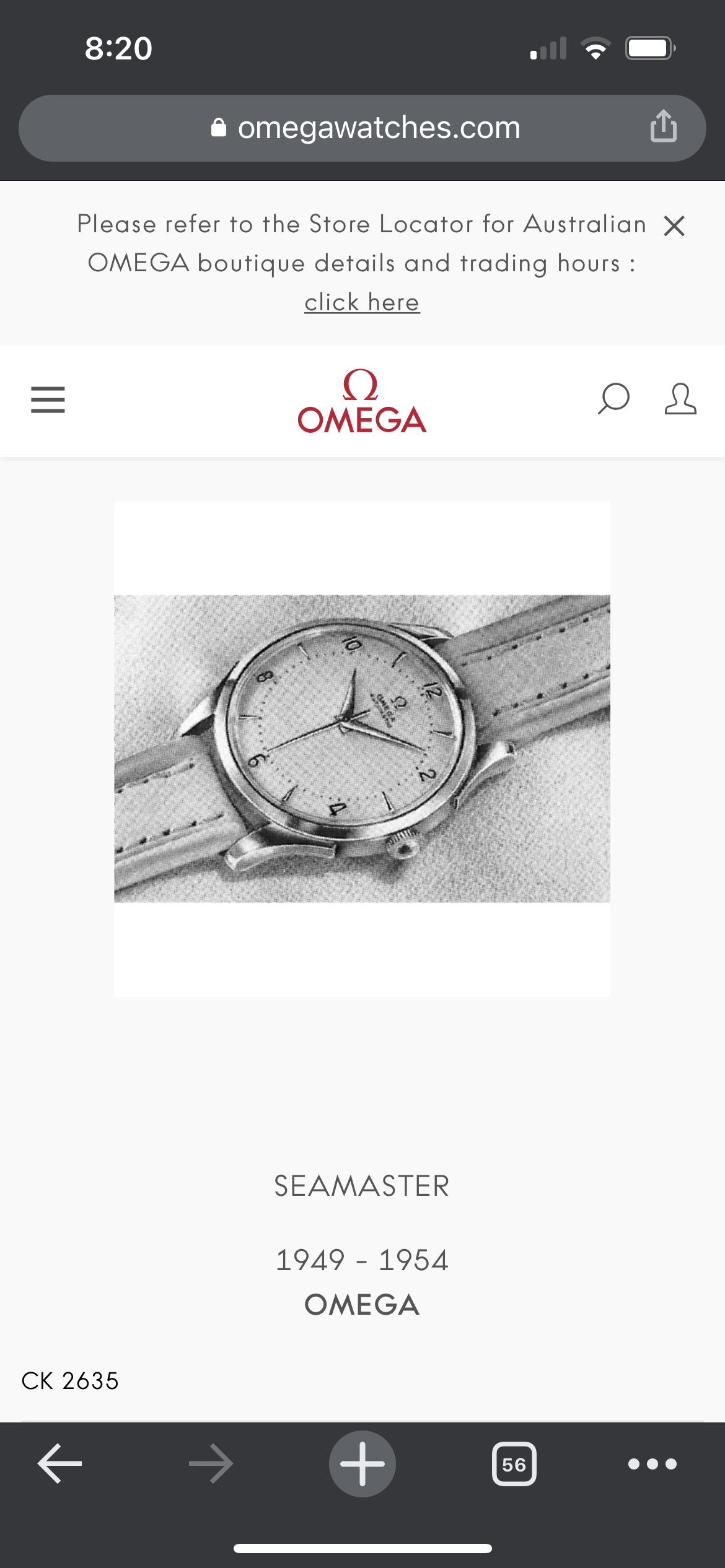

but omega has this.
I have a seamaster unbranded and omega clearly state it’s a seamaster so I don’t know. Here is my ref from omega.
‍♂️ Google it for yourself. I thought that too.
There are loads of Seamaster references with snap-backs. One of the most common Seamaster refs. from the fifties, the 2846, is one of those as is this one - the 2892/2891/2791/2792 come both with or without Seamaster branding.
@Josh2928, based on the patination (greyish inner part of the dial/black outer part) my best guess is that this one is correct. That particular two-tone way of aging is common on this reference.
