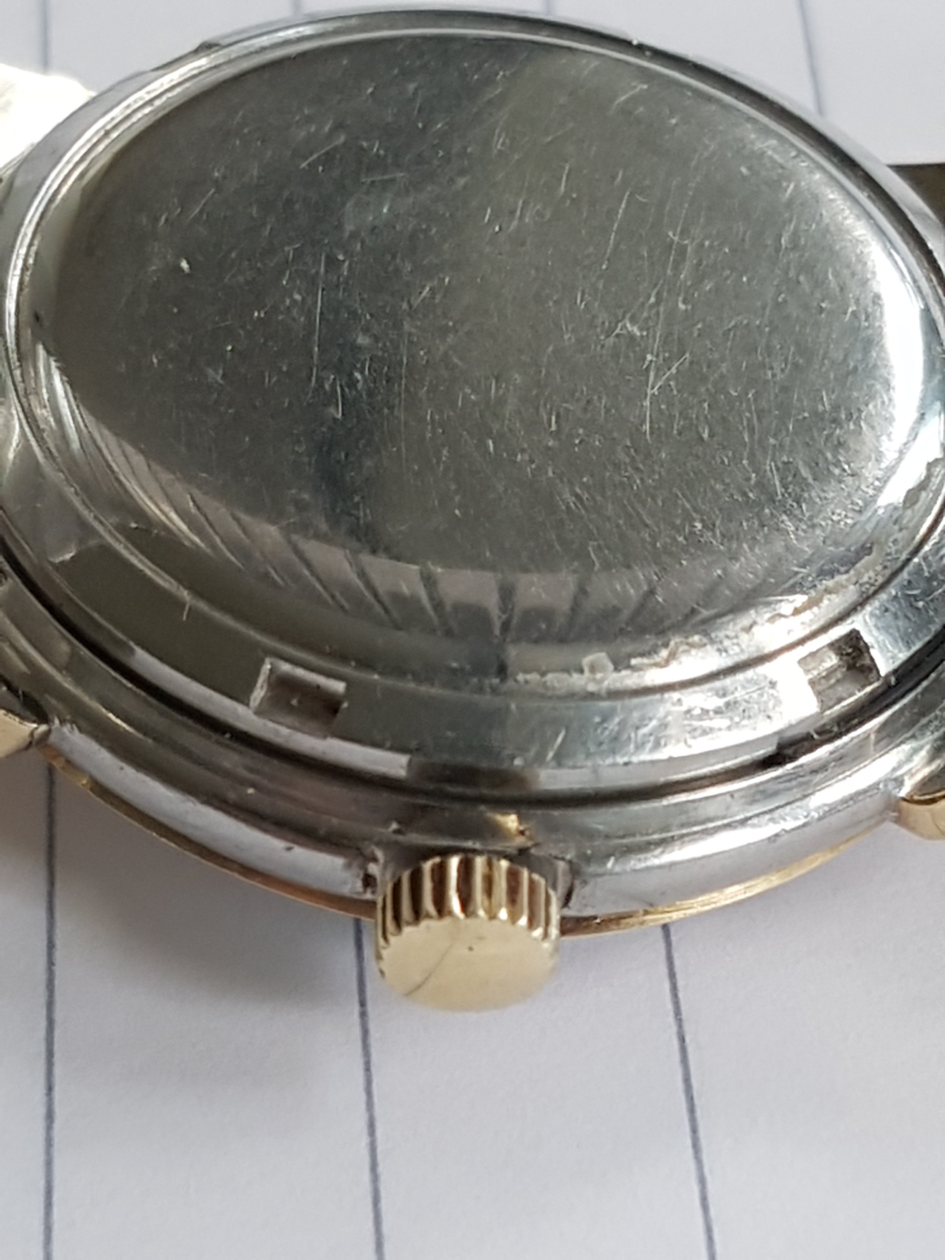

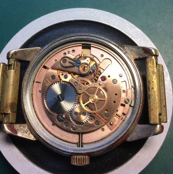

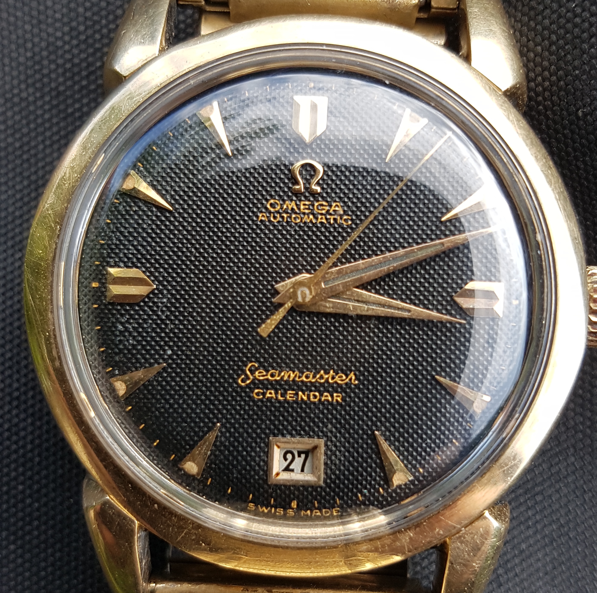

I did bought this watch from the son of the first owner here in sweden. I know that the watch is a model 2627-12C. It is black honeycomb dial and gold on metal and the glassring is in gold what I have been told, but I am not sure about that? I have also bee told that the size of the watch is 34 mm. Unfortunatly the rotor/bumper is missing on this watch. I wonder if someone can tell me little more about this watch and little about the estimated value as it is now, and if its worth to find a new rotor/bumper?
I don´t think that the crown is original?

Case is gold shell on steel. Good! Dial in nice shape and appears original. Good! Date at 6:00 calibre 355. Good! The base movement appears to be all there, and in decent shape. Good! Not just the ROTOR missing! The entire automatic wind system, gone! Not good! Value as is? You can imagine, the way it is. Value after restoration? About what it would cost to supply the missing parts, and restore it. Someone would need to cannibalize a complete running watch to fix this one up. Opinions on value after completed restoration........?

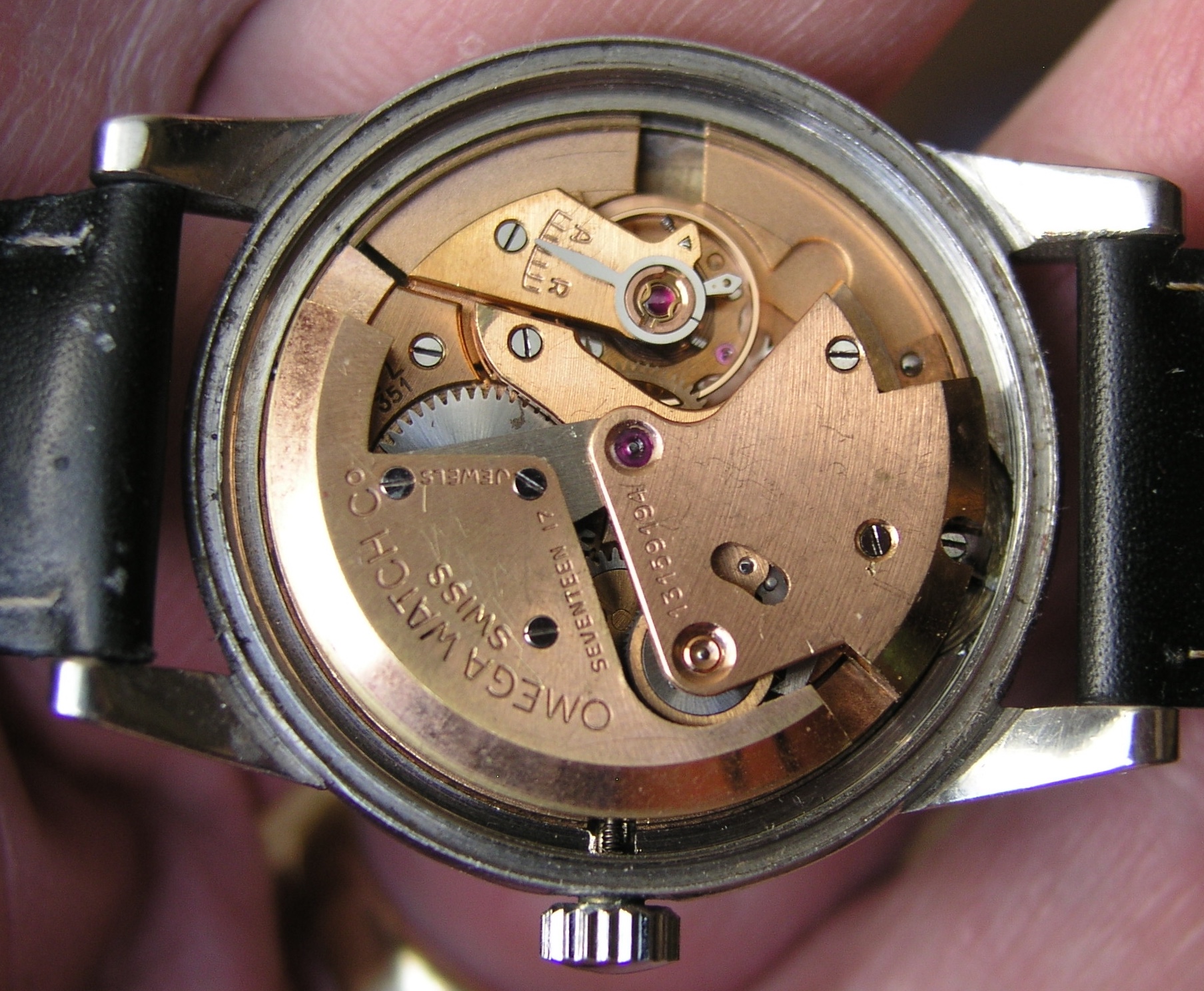

The included picture is of a calibre 351, basically the same movement without the calendar, but WITH all the auto wind system intact.

That looks to be a nice original black honeycomb dial perhaps that is where the value is in this piece

Thats a beautiful dial you have on the watch. I would get it down to a decent local watch repairer and start checking out the parts needed. There appears to be quite a few parts for this on the Bay. Even if you end up spending 4-5k Sek on the watch it’ll look stunning and something to keep for the future.
As mentioned previously as a parts watch it would be snapped up. I’d certainly be a buyer as I have a 355 and I would love to have that dial on my watch.
