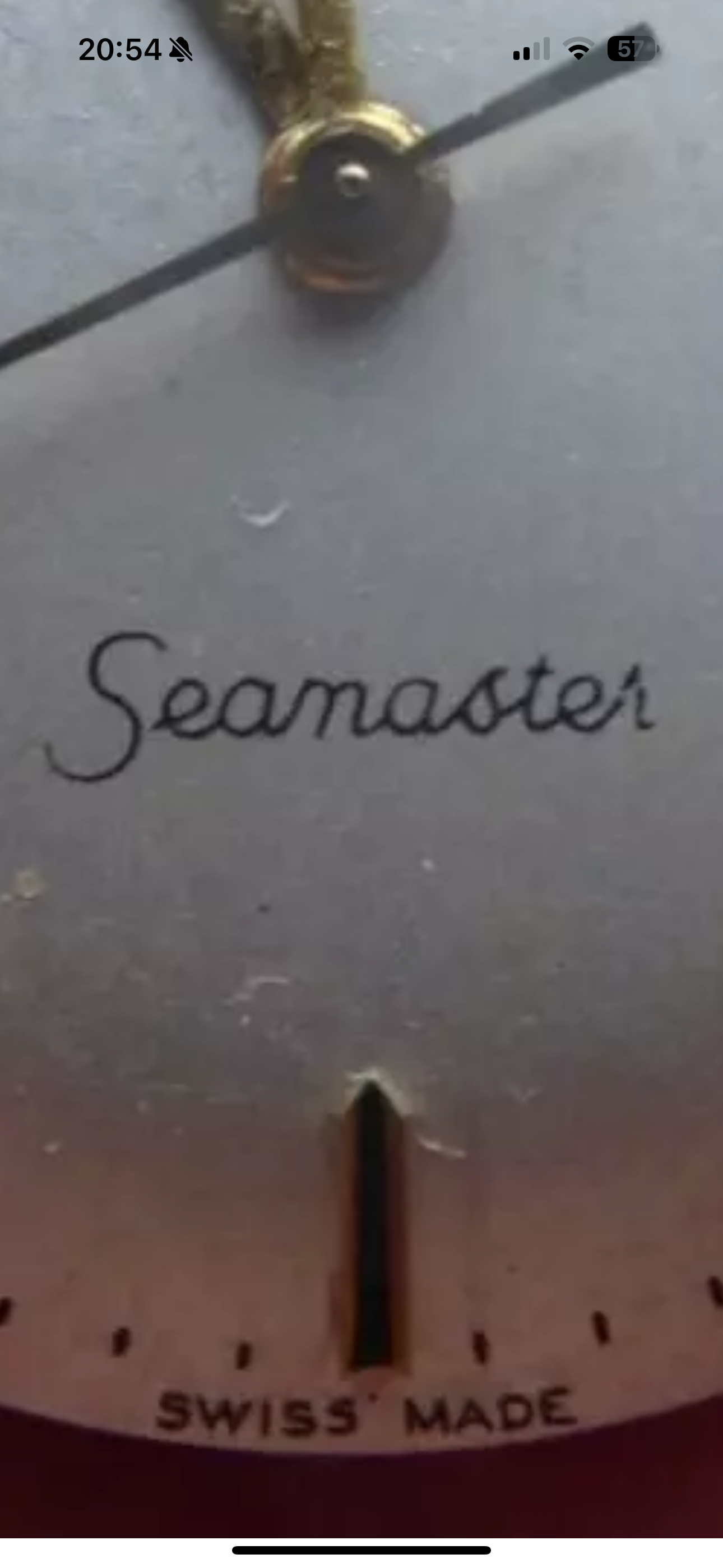

Hi all,
I’m a newbie watch restoration enthusiast and I’ve fallen in love with the vintage Omega Seamaster. I recently purchased a cal.565 version with a 24 jewel movement but upon examining the dial closely I became worried that the Seamaster signature looks different from the other versions I’ve seen. Am I right in suspecting the dial to be a fake?

I have a 166.010 with a 565 movement - does this help?

Thanks for your help all. The «S» in particular seems to be a dead giveaway, together with the mishapen «m». The «Swiss Made» seems to be very poorly executed as well.
Oh well, live and learn. The hunt continues…

It’s not fake, it’s been refinished. Still a deal breaker but there’s a significant difference.

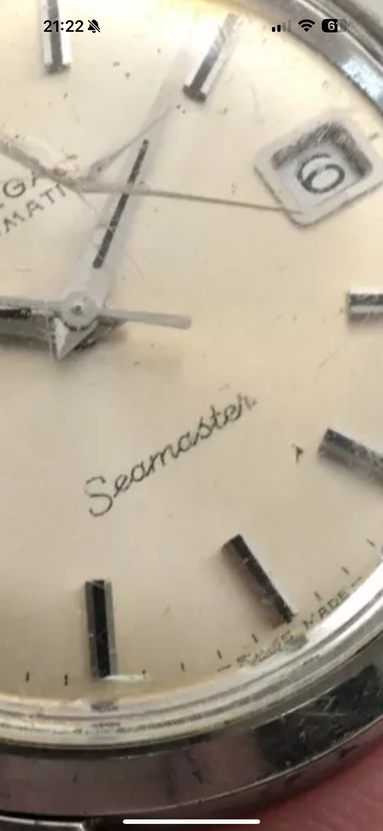

I found another Seamaster selling as a repair article (hence the scratched crystal). Perhaps this signature is authentic, or just a better repaint job?

That’s completely different to yours. From that single photo I’d say that’s an original dial.

It's always helpful to see the entire watch because signatures vary a bit from reference to reference, although OPs watch is clearly a poor re-dial regardless.

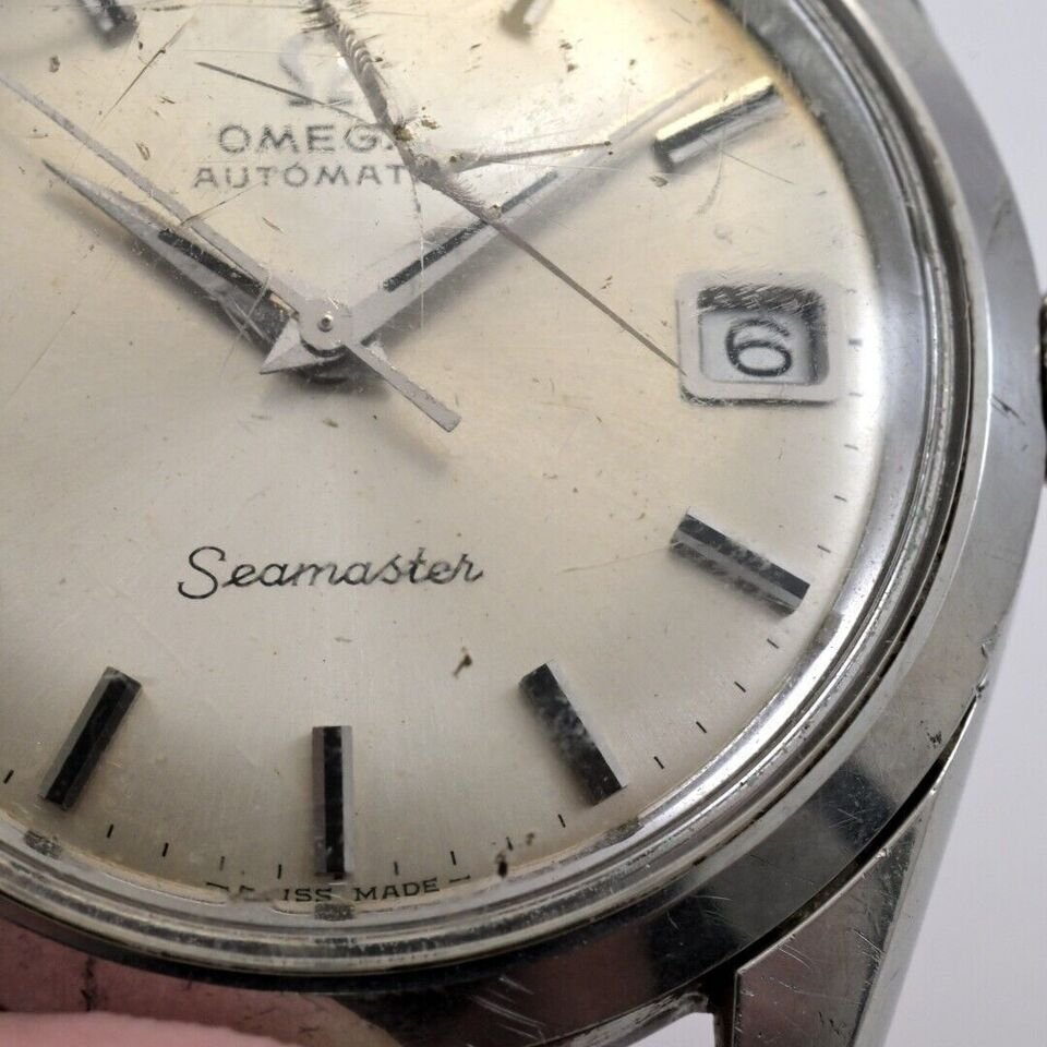

The damage to that dial can't be repaired.

From another picture of that same dial it seems that the damage is confined to the crystal, and the dial is (maybe) less damaged than it appears. The asking price for that watch is €489 though which seems very steep considering a) the pictures are hard to judge by, b) the watch does not run and the seller does not appear to know why, and c) the item is in Japan which will involve import duties and customs fees.
I have been tempted because I have a crystal that will fit that case, and it seems like an interesting fixer-upper challenge, but I am put off by the issues listed above.

There are a few marks on the dial but most of the damage is the crystal that is easily replaced.

As noted above, pictures of the whole watch will allow you to get you the best guidance from the members

Thanks for the help. I decided to pass on this as I feel the watch is overpriced for its condition, and I wasn’t able to get enough information out of the seller to ascertain how much more I would need to invest (in addition to a new crystal) in order to get it working.
