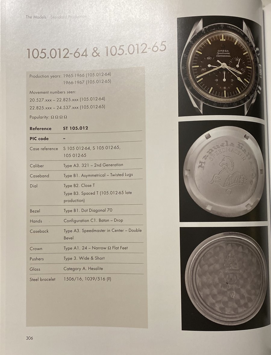

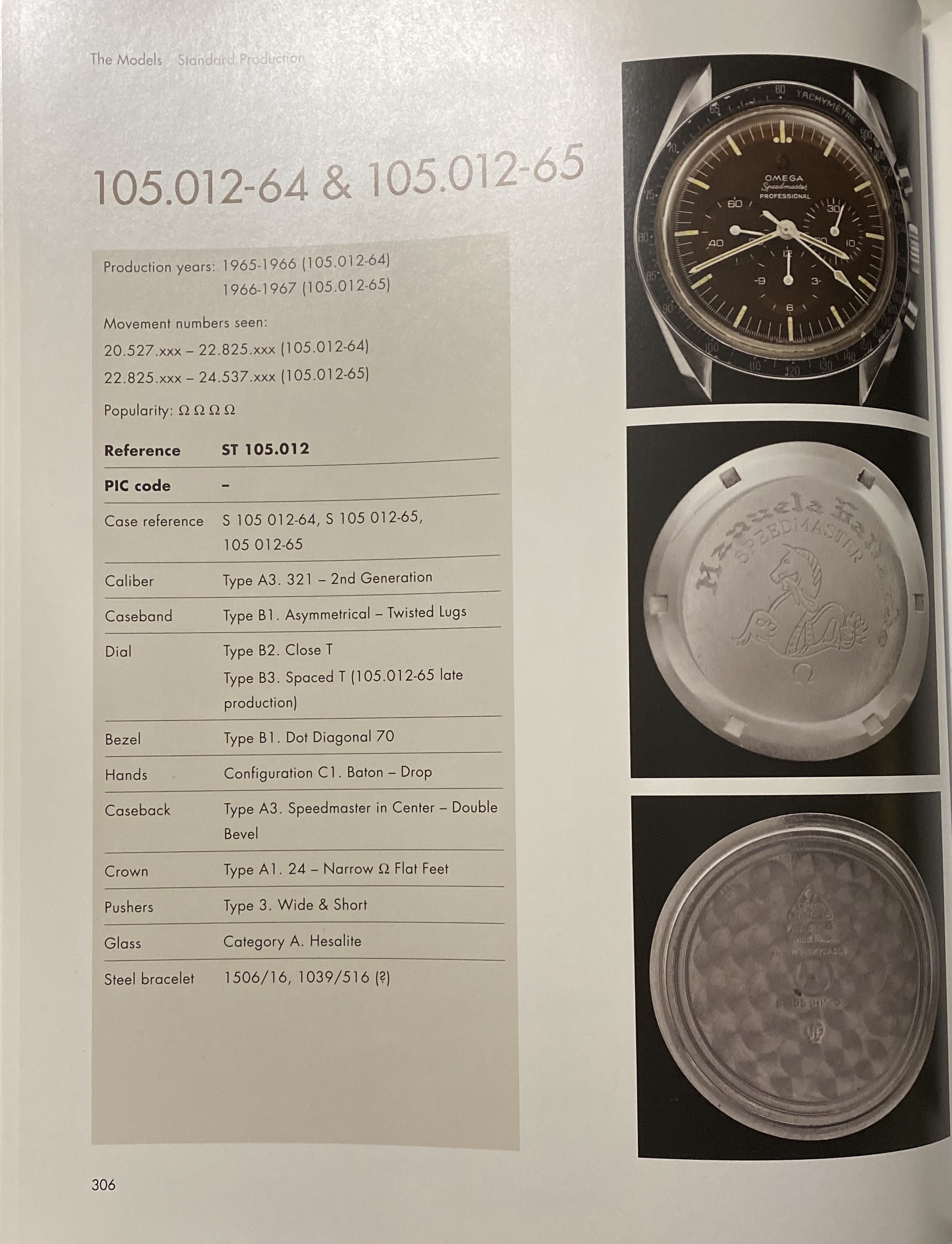

I think an EOA will say wether the watch is Franken or just a serviced watch. If the movement is a Speedmaster it is not Franken.
As an interesting aside to the wide spaced T dials, and movement numbers for the 105.012, I have an EOA for my 105.012-65 with a movement number(25,442,xxx)that is over 1 million outside the range in Moonwatch Only. It has a wide T dial.
You cannot rule out anomalies without investigation for a vintage Speedmaster, and don't believe everything you read!
An EOA will only say which reference the movement belongs to, the date it was produced, and where it was delivered to.
Everything beyond that is pure speculation.
It will not say whether this is or isn’t “Just a serviced watch.”
If you have a 105.012-65 with a wide spaced T dial I am sorry to say that you also own an “Assembled watch” that is incorrect.
The wide T dial simply did not exist in the double bevel caseback/pressure fit pusher era.
It only started appearing in 1967, mid way into the 105.012-66 reference’s run.
My observations are based on hard data and on (dozens of) actual watches that have passed through my hands and had extracts issued for.
I have yet to see/find a true untouched one owner 105.012-65 that came with the wide spaced T dial. When this day comes, my opinion might change. Until then, it remains.

Just playing devils advocate but how do you know that your watch is a -65? It could be a -66 with a caseback swap, assuming it otherwise checks out as a 105. That would also explain your serial but still be consistant with MWO and Sp101. As noted above, the extract doesn’t mention the year iteration.
That said there are straight anomaly watches out there.
1,344
1,971
This is probably correct, although the 105.012-66 still used the same pressure fit pusher case bands.
My watch could have had the caseback swapped at some point in its history? It appears coeval, and is correct in everyway but has a double beveled caseback. One would expect a 105.012-66 case back, but can you rule out a 105.012-65 caseback being used on a watch assembled in 1967? Omega has thrown up many anomalies, we can see the movement numbers are not strictly sequential, so parts are pulled up in batches from various suppliers to be assembled. These parts can easily transition from one assembly batch to another.
All watches are 'Assembled Watches'. I don't think many of them remain assembled by Omega after 50 years. They will have been assembled by who ever serviced them. Deciding what was done 50 years ago, and what was not with absolute certainty is a difficult task.
Just playing devils advocate but how do you know that your watch is a -65? It could be a -66 with a caseback swap, assuming it otherwise checks out as a 105. That would also explain your serial but he consistant with MWO and Sp101. As noted above, the extract doesn’t mention the year iteration.
This is quite possible. I introduced this example because the language of absolutes and labelling watches with parts replaced in service as Franken is annoying, and not helpful. Often no one can say for sure, it is all educated guesswork.
Ndgal called this watch ‘assembled’ but that is true of all watches. First by Omega from non sequential batches, allowing for some confusion for collectors. and then by whichever Tom dick or Harry serviced the watch during its lifetime.

Look, I love the Moonwatch Only book just as much as anybody else on this forum.
I also own the latest edition of the book and it is great!
Over the years, I have learned a ton from this book. But I was also able to make further observations that are not covered by the book based on my personal experience collecting (first and foremost) and buying & selling.
There are actually some sections of the book that are (surprisingly) extremely lacking of correct information.
Nobody is perfect, neither me or the book.

As I previously wrote. To me, a 105.012-64/65 reference with a wide-spaced T dial is incorrect.
I have had many 105.012-64/65/66 go through my hands. The majority of them were sourced from original owners or their families.
Pure, uncirculated watches that have never been messed with. I have yet to encounter one 105.012-64/65 that came with a wide-spaced T dial.
The earlier versions of the 321 PROFESSIONAL dials are in essence "Pre-professional" dials that had the PROFESSIONAL print and the T's added later. (this is why it is common to see print/spacing/ink inconsistencies in the way the PROFESSIONAL print is applied on these dials).
Examples:
The wide-spaced T dials are the ones where the entire dial print (including PROFESSIONAL and T SWISS MADE T) was applied at the same time.
