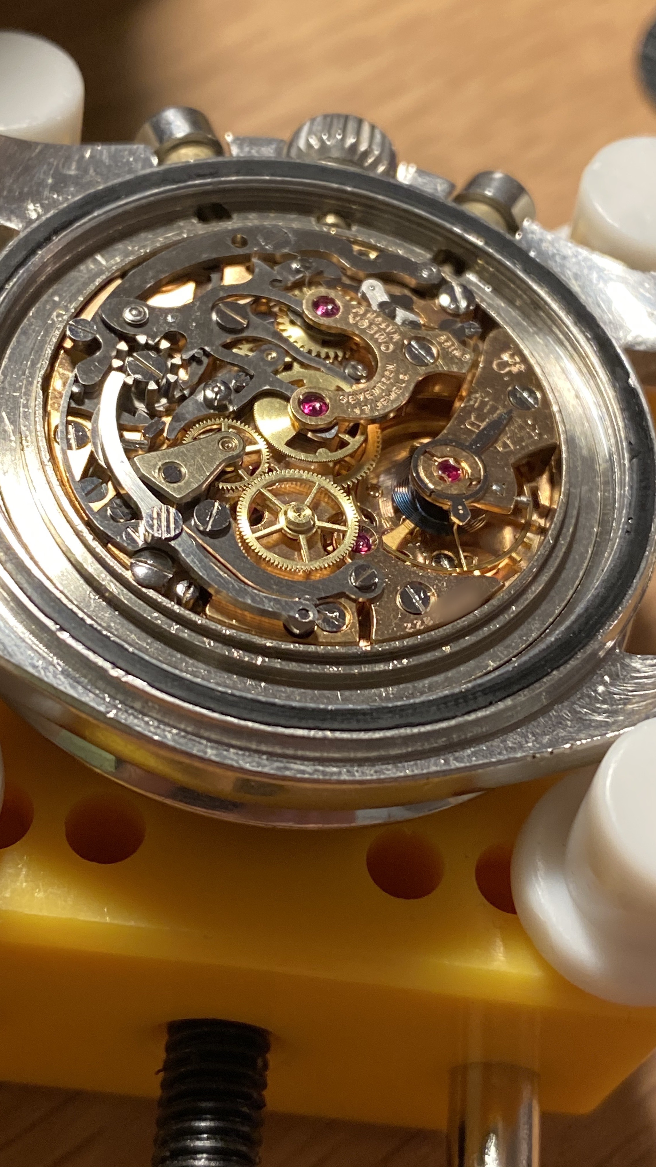

I don't disagree with anything said above, but here's a wild hypothetical just to illustrate my point. I don't know why I'm even saying this since it's unlikely as hell, but what if he cracks it open and shows us a 26M serial? Then could everything be correct except for the caseback, including the sweep hand? OK, I realize it's still a franken even with just a replaced case-back. Yes, I also see the wonky and mismatched lume, I agree it's most likely to be a put-together, and I wouldn't buy it. But we're still missing pieces of the puzzle, that's all I'm saying.
145.012 and 105.012 don´t share the same mid-case. This has the mid-case, pushers and caseback of a 105.012. IF there is a 26M serial in this watch, then not just the caseback would have been exchanged but the whole case i.e. mid-case, caseback, pushers, crown.
You're right, it was a bad example, I forgot about the pushers and mid-case. It's late (not really), I've had a double Scotch (really). You win.

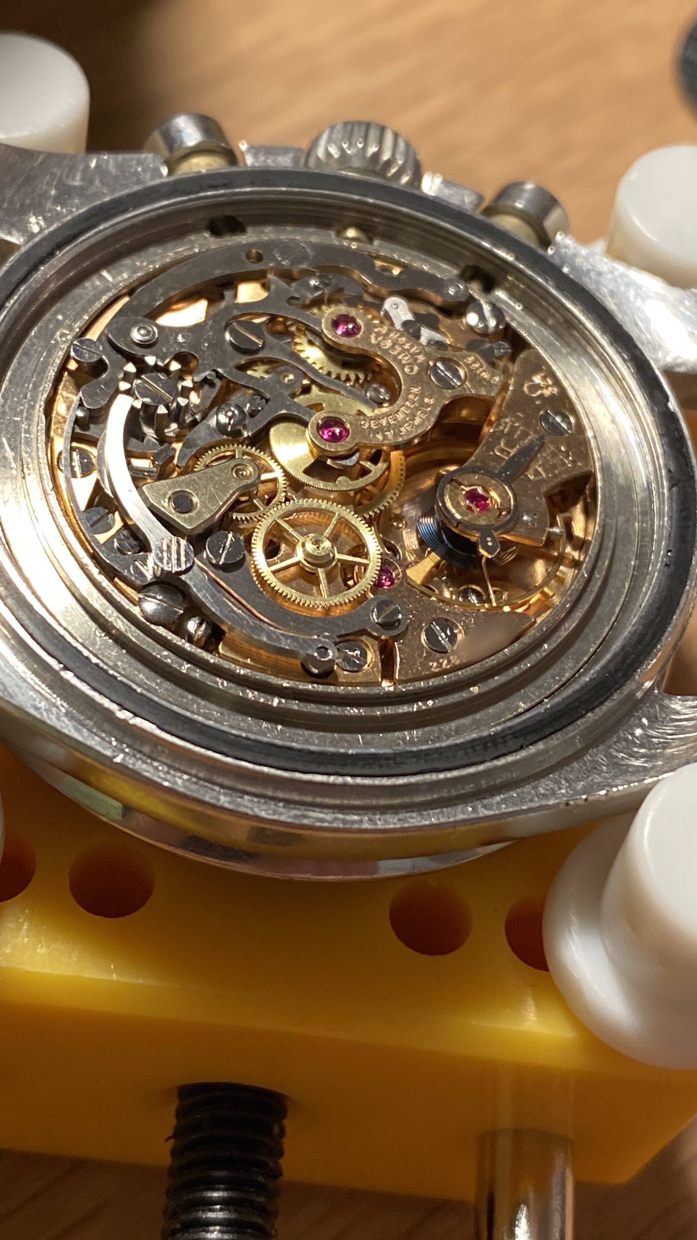

@Luca.P - You are correct sir! I’m finally checking emails and this site before bed and went thru a roller coaster ride of emotions honestly. I do appreciate the honest critical dialogue though. Let’s see if I get any sleep after checking this thread! I have some fun camera gear, but a family as well so I’m not cracking anything open tonight, but I did take a pic of the movement earlier because I just needed to see it. It’s a 228xxxxxx number inside, with a case back of 105.012-64 engraved and the HF insignia.
Forgive the poor PS scrubbing of the last few numbers too-it’s late and I’m only on my phone.

According to Speedmaster101 that is a correct serial for your watch, congratulations!
