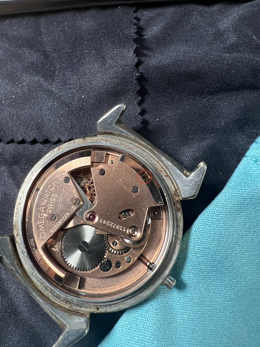

I already asked this question in my thread about the crystal replacement but I thought I'd start a fresh thread as I'm kind of stuck. For a quick refresher: I'm working on a Seamaster case ref. 14350 its in really rough shape overall so I'm trying my hand at a diy crystal replacement.

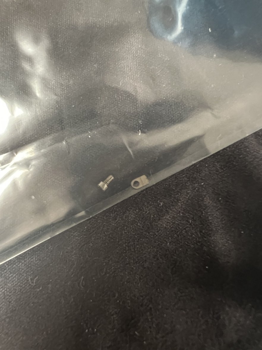

I've successfully removed the stem and one screw and tab (case clamp?). But the movement is still stuck tight in the case. I'm tried gently prying it near where the screw and tab was inserted but I'm hesitant to pull harder than I have.
Can anyone give me tips? Are there additional screws holding the movement to the case or do I need to rotate the whole movement or something similar? I've attached a couple photos, the location of the screw I removed in circled in red.

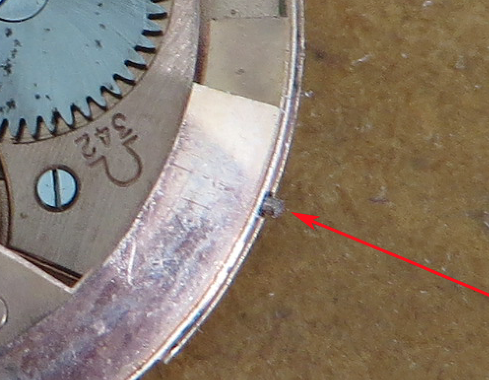

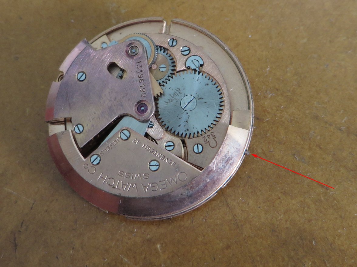

There is a pin on the other side of the movement that fits into a notch in the case.
Try applying a bit more upward pressure.
If all else fails take it to a professional.
3,012
4,778
I accidentally etched out this pin on a broken screw. At least was a practice watch. The pin was somewhat gone to start with. These can often be hard to see.

Thank you! Am I supposed to move the pin or something? Or is the pin just part of the assembly that holds the movement in the case?
13,491
31,809
Yes.
