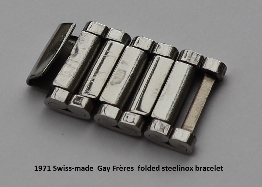

Reviving this topic as it's something interesting & practical for those who want to shorten a folded metal bracelet without screws, without U-plugs, without pins ( whether or not arrowed with the direction to push the pins out between the links ).
I went for option 1. Ease open the centre links and re-fold them.
Indeed it is a whole other story with folded metal bracelets which come without neither pins, screws nor U-plug-slides to remove links.
An example are the late 1960s & early 1970s Gay Frères folded metal bracelets for which we need to bend an inner centre link open in order to shorten the metal bracelet by getting a few links out... and then re-fold the centre link.
Done extremely careful with a kitchen knife... here's a photo of the links I removed:
