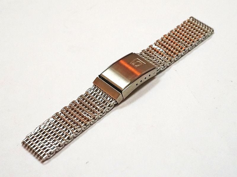

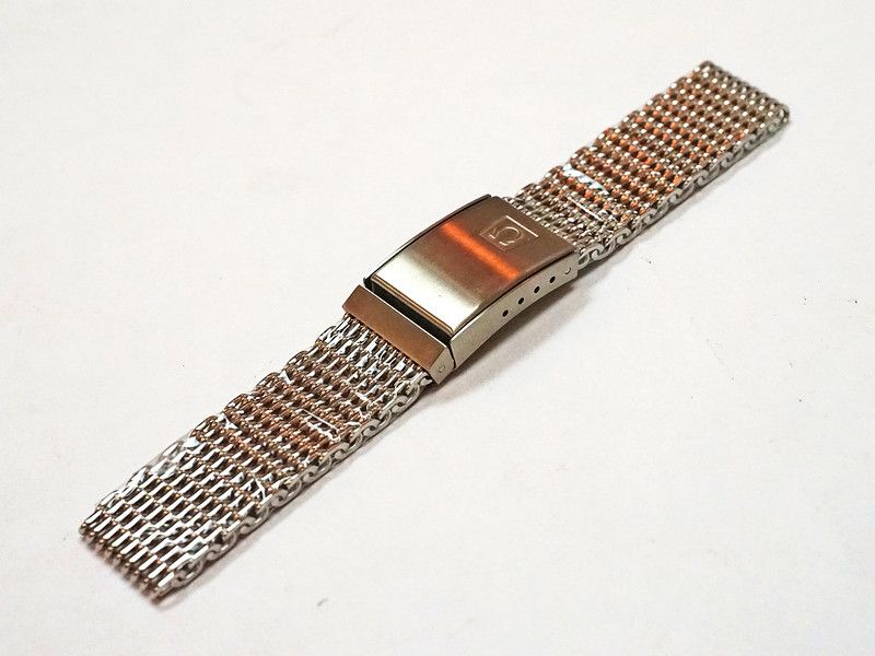

If it's like the bracelet below, it's a pain in the ass to "adjust." Most people use a Dremel tool with a cutoff wheel to remove links.
Correct.
The only "adjustment" is to move the bracelet end to one of the five holes in the clasp. If it still can't be fitted correctly the offending coils need to be cut from either end of the bracelet.

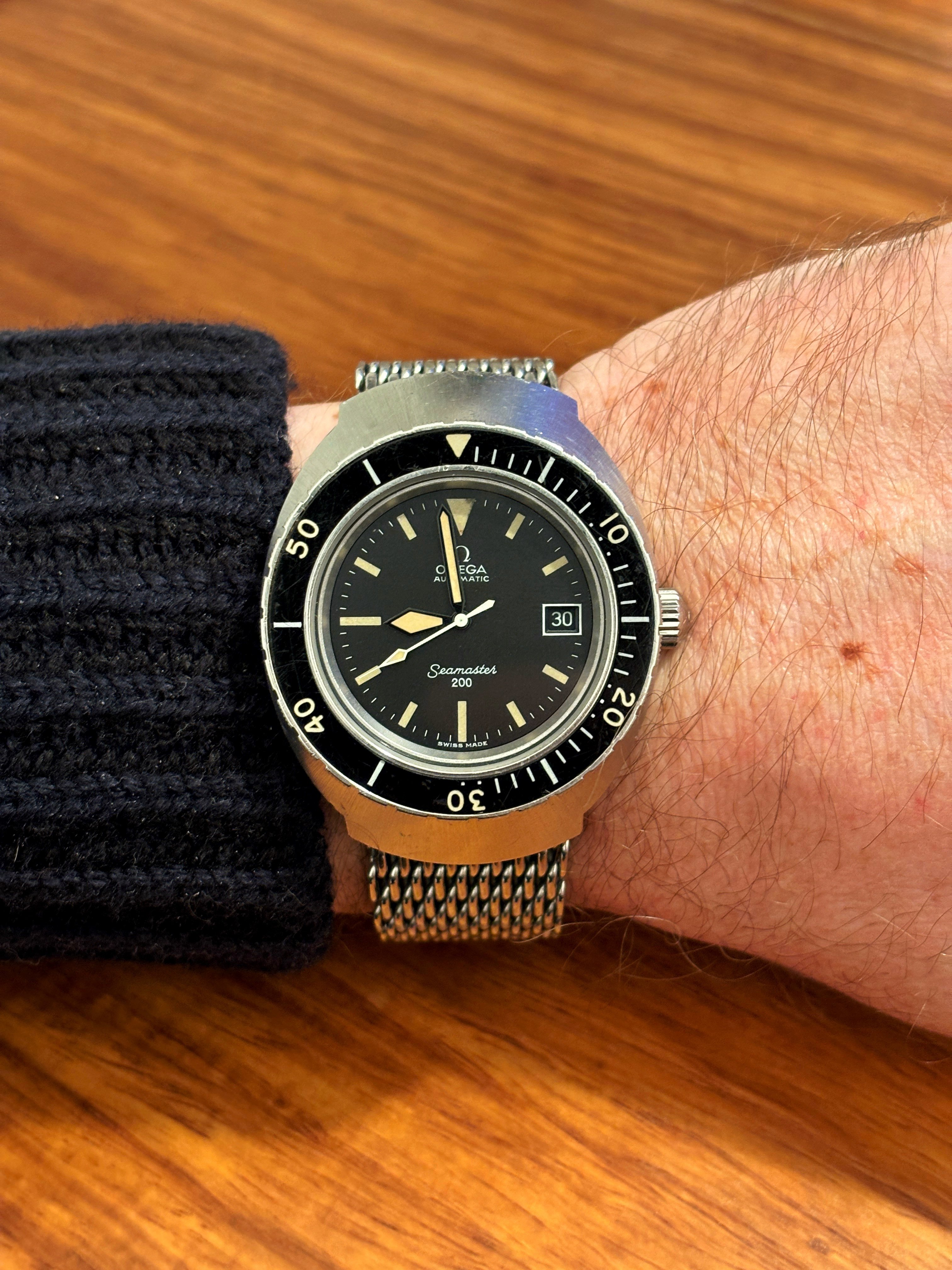

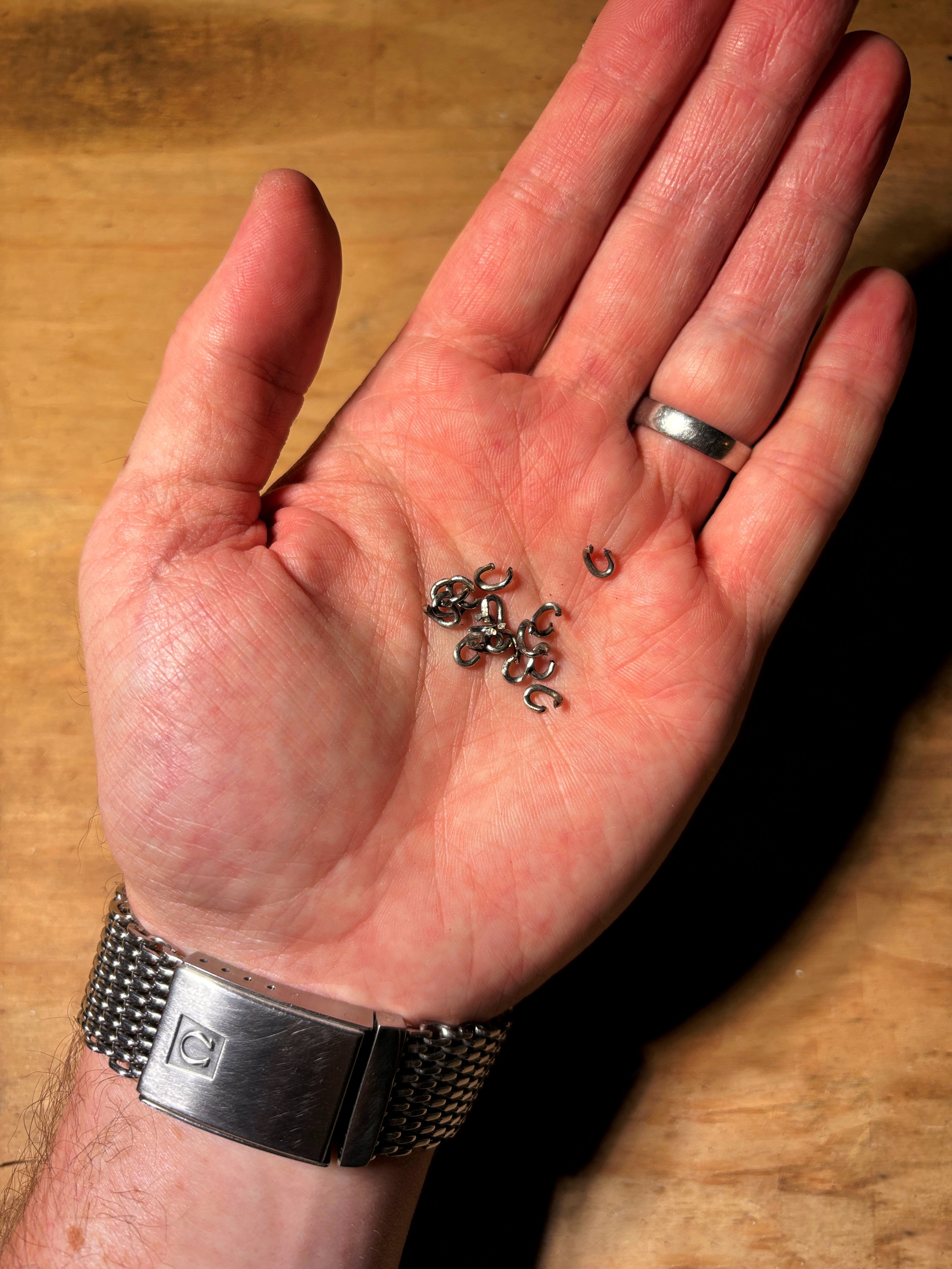

Probably an obvious point, but ensure all the end loops are aligned as near to perfect as you can get them, so the spring bar isn't being pinched. Otherwise it may not expand fully and risks popping off.
I flared mine out very slightly to snugly full the lug gap, but I swim with mine so I'm probably more paranoid than most.
225
495
Nice work! Glad to hear fingers still in one piece
