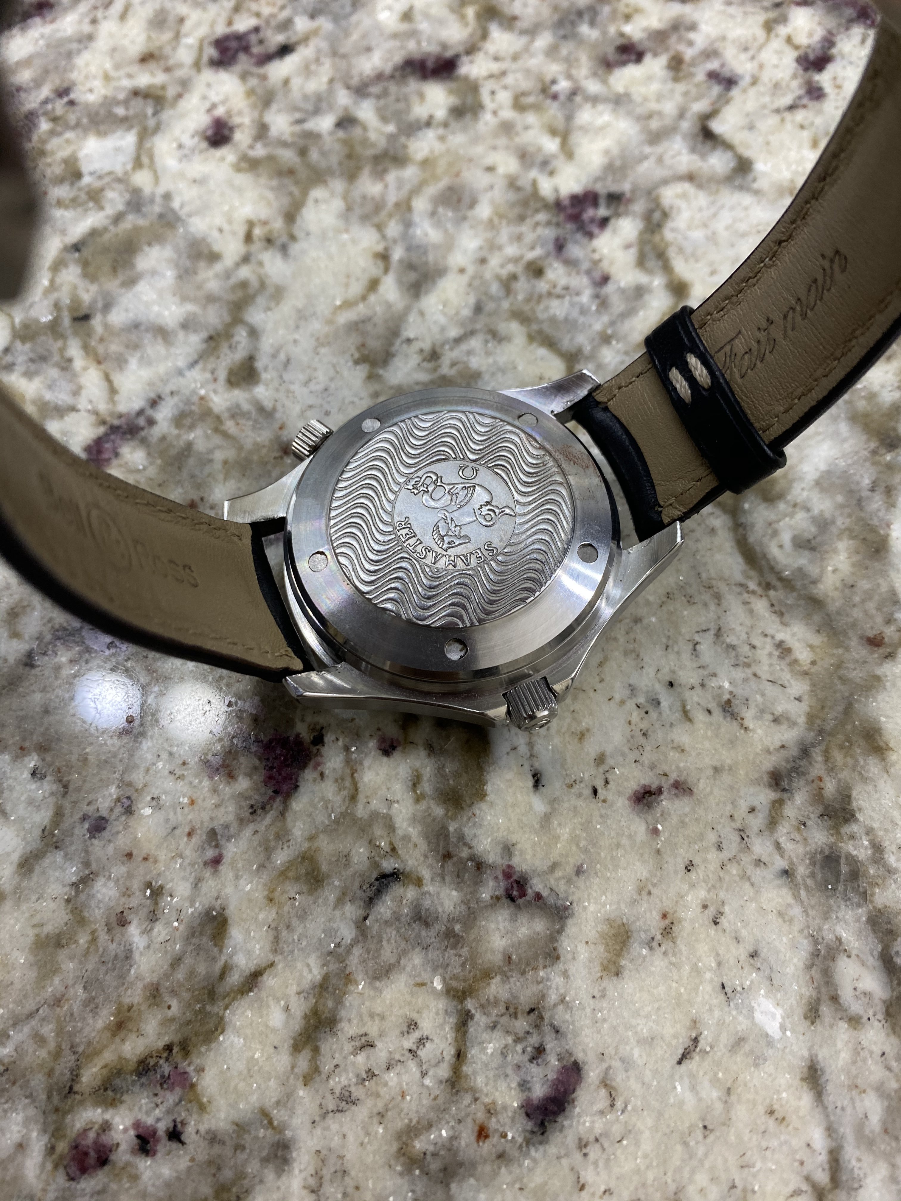

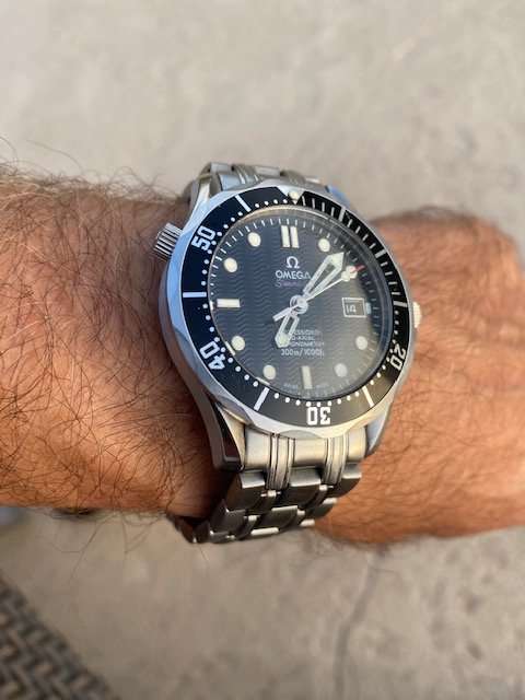

My son purchased this watch off of Poshmark (USA) which gets sent to Posh HQ for evaluation. It was naked so no papers, etc.. Posh does not open the caseback to look at the movement. They approve it as authentic based off of logo, material, etc.. My son received a card from them which said it was genuine. He accepted it due to that. The Seller was paid. Now that I have received it, I am seeing some things that are not looking right to me.

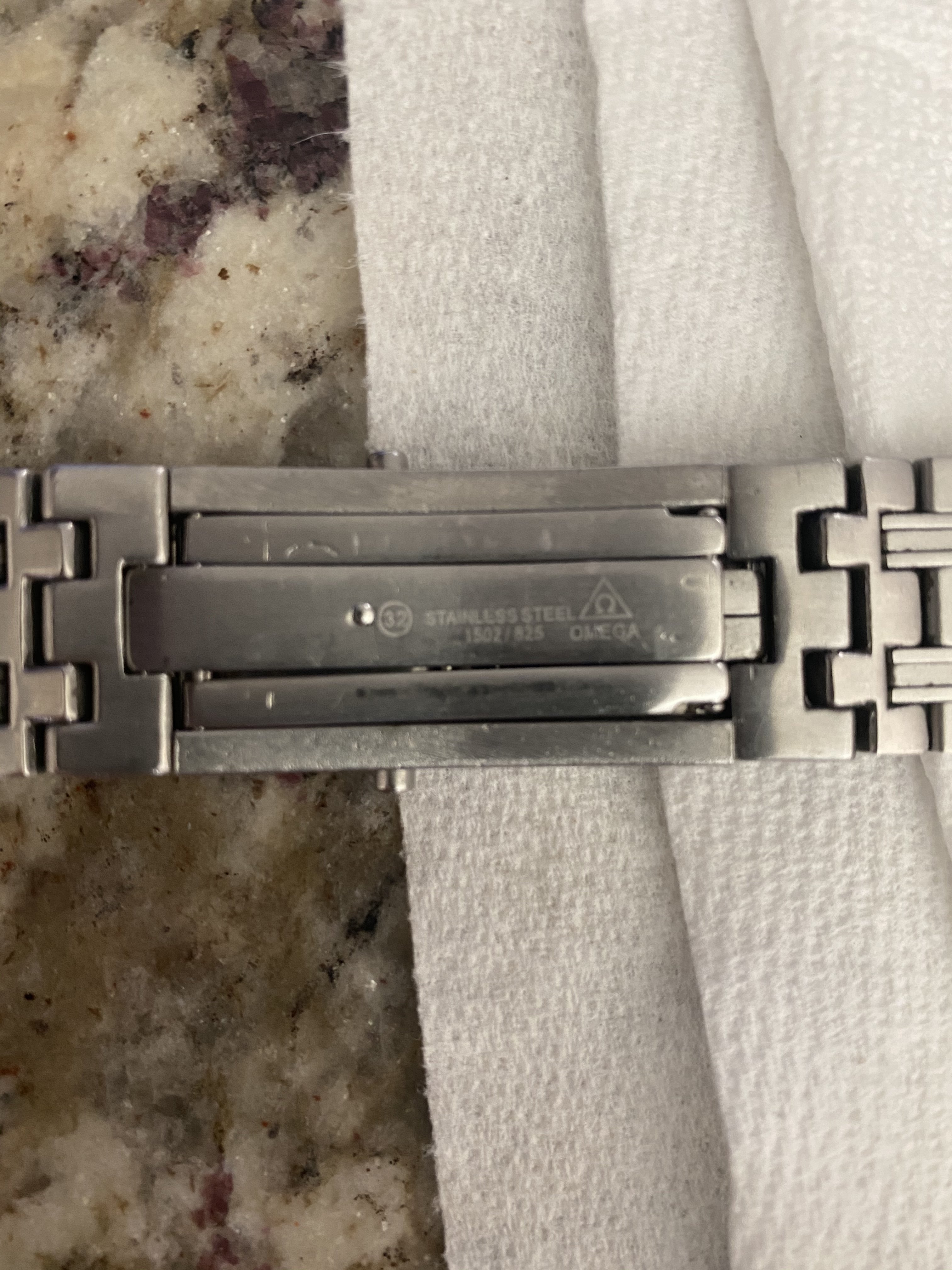

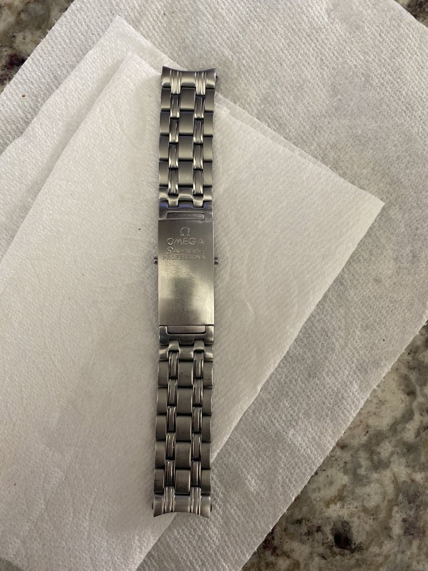

Can a watch maker on this forum look at the pictures and tell me if this is genuine or a replica? I can add a pic of the bracelet. I removed it because the clasp was a little bent and not very secure. He didn't spend a ton on it but it's his hard earned money he used to buy me a gift.
I can send this back to Posh for them to re-evaluate, and if they feel it's fake, they'll refund the money. I want to use, either an email from a Jeweler (PM me and i'll give you my email address), or some pointers to provide them to consider. I have to send it back tomorrow or lose the chance to get a refund so I can't take it somewhere... not enough time.

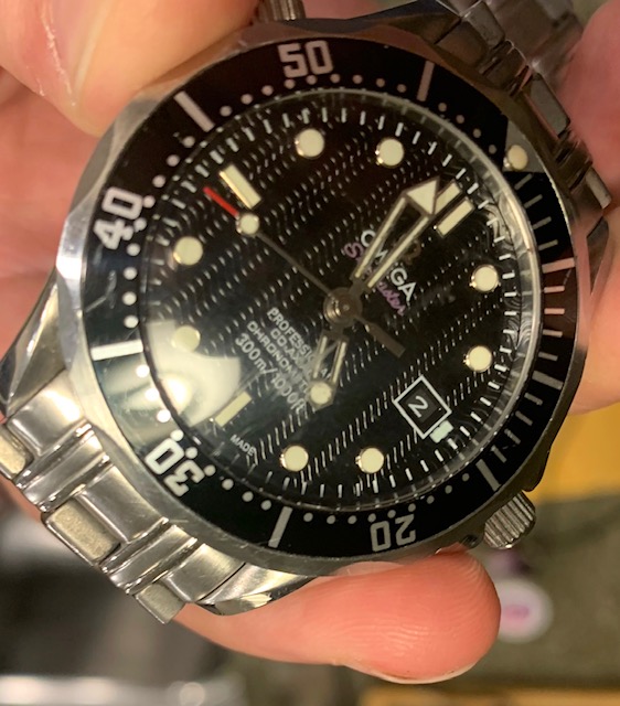

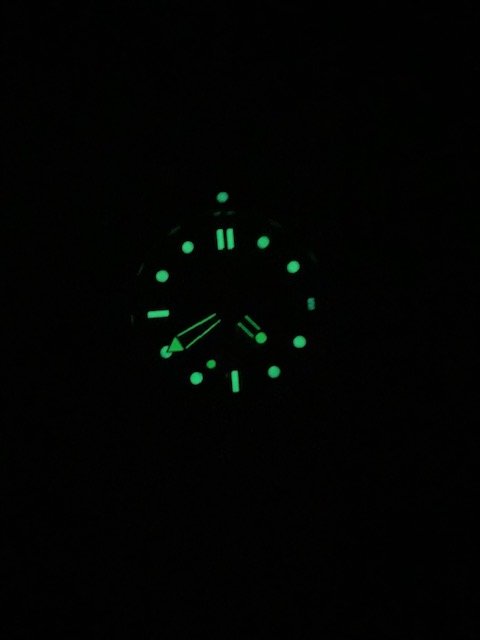

You'll need to post better pictures. From the ones you've posted, however, it looks like the helium escape valve is lined up with the 10 o'clock marker and the lume pip on the bezel looks wrong–so my guess is that it's a fake.

That's what I saw. The PIP is raised and the escapement is above the 10.

That pic was one in the direct sunlight. The other pic is not as exaggerated of a wave reflection. I can see the difference without that sunlight beaming off of the dial though.

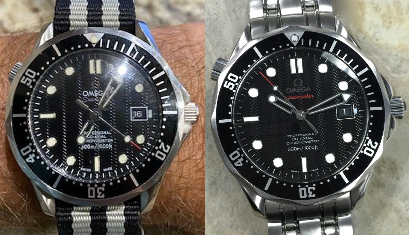

Second hand is misshapen, bezel isn’t even close to lined up with the ridges around the perimeter and the case contours look wonky. I’m not even close to an expert but that watch would give me pause.

The hour hand is too short ... on the second generation model, which this one pretends to be, Omega used a longer one.

This watch seems off. Wrong seconds hand, and the minute and hour hands are the short ones from the first generation. I would not buy this

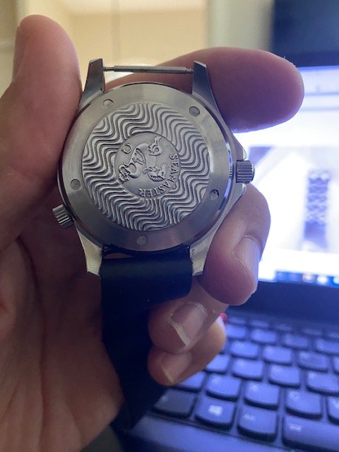

There’s so many variations of the Seamaster I can’t tell. I believe that is the 36mm caseback as well. Not the 41mm

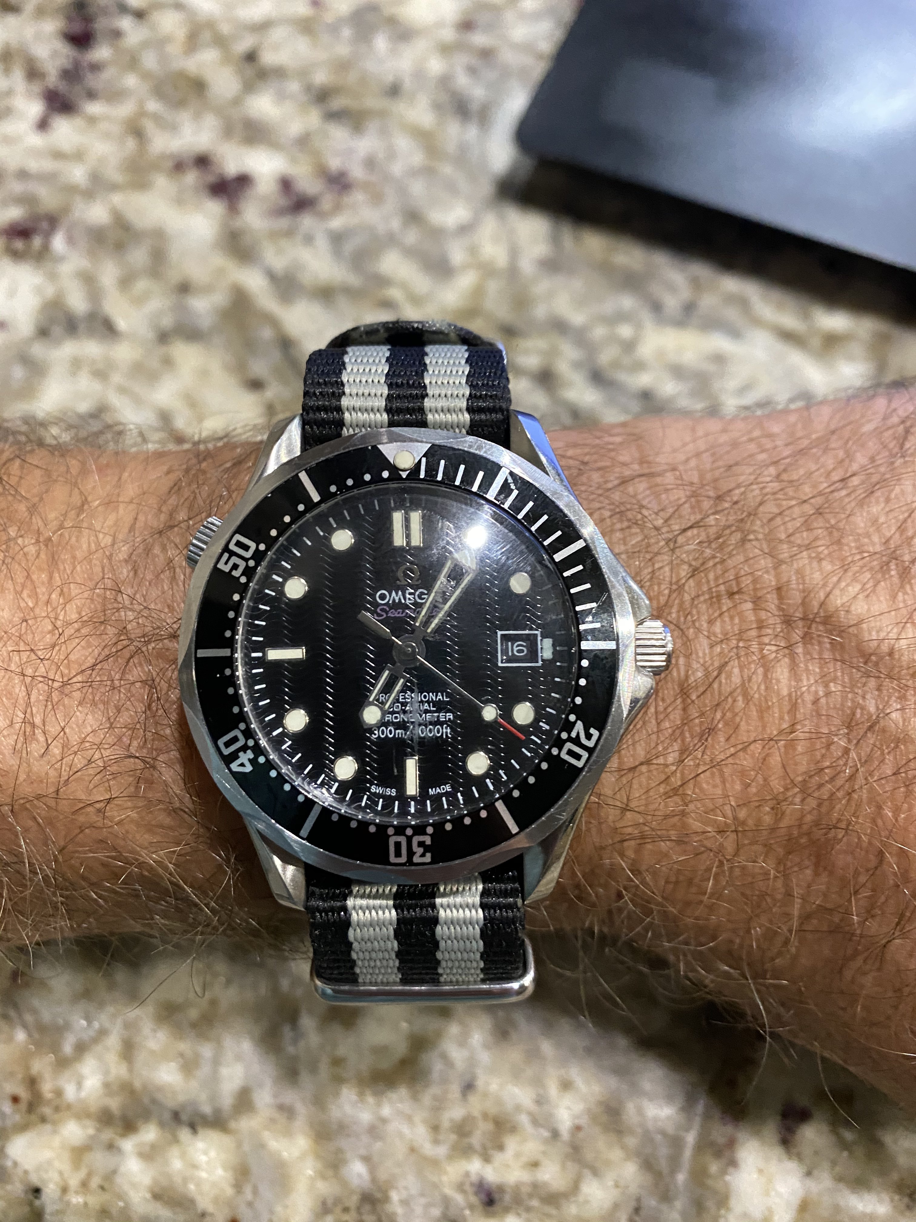

The side by side picture with a genuine one is a good start...print that out and send it with all the other comments noted so far. It's not genuine, and seeing it next to a real one makes every detail jump out and kick your eyeballs!

When's the last time you've seen an applied Omega logo but printed OMEGA? It's either both applied or both printed. The 3 o'clock lume plot doesn't even have a border... and that's before we get to the fact that it doesn't have a serial number

No one has mentioned the most obvious tell that I noticed, so I’ll mention it - the real one has a raised metal OMEGA and the Seamaster is in red. The fake one has OMEGA printed and the Seamaster is in silver. Also note the thickness of the lower text.
this one doesn’t even attack to look correct, IMO. I’d pull the back off and show the seller the movement - no way it is even close to looking Close to correct.
