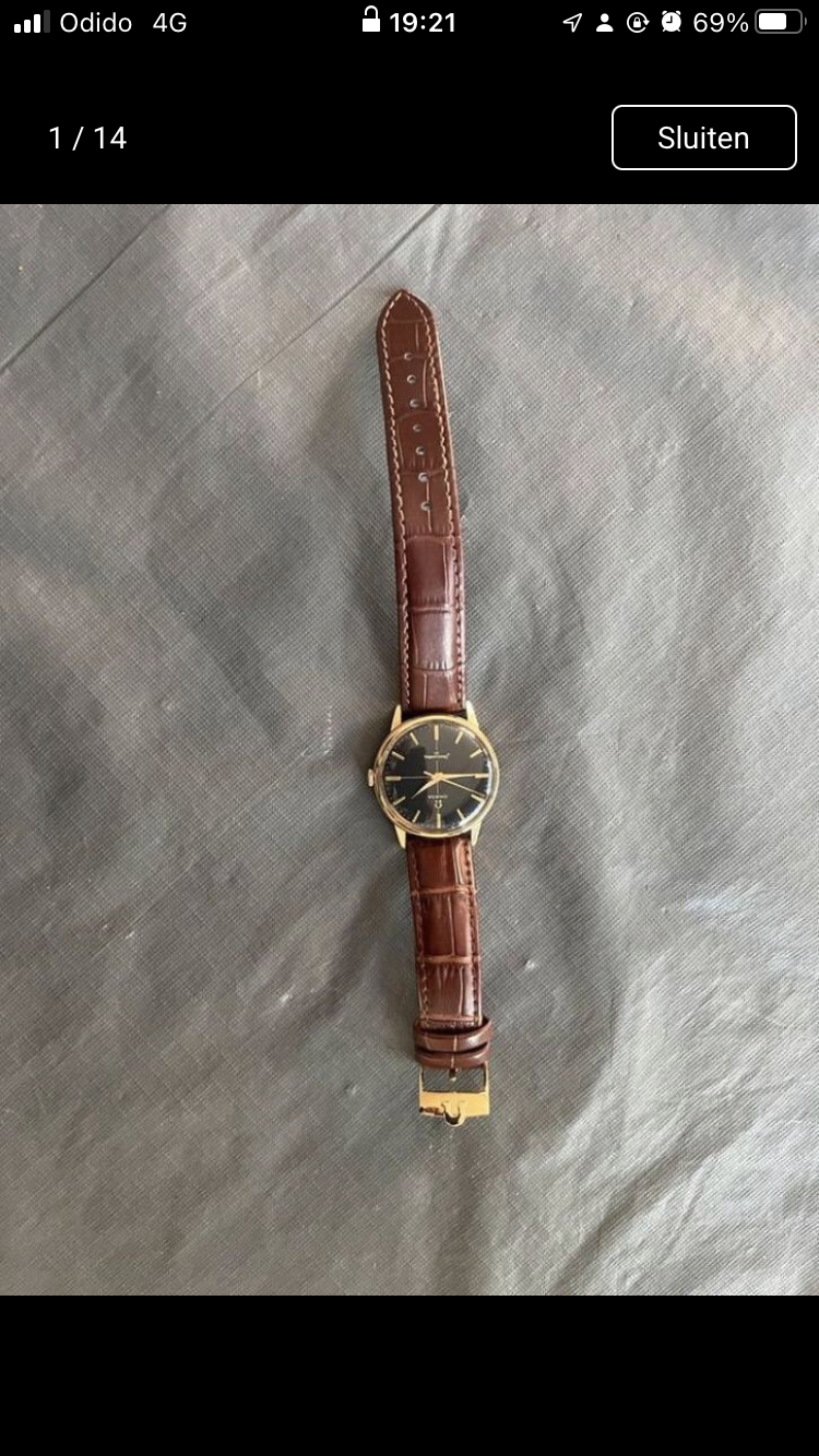

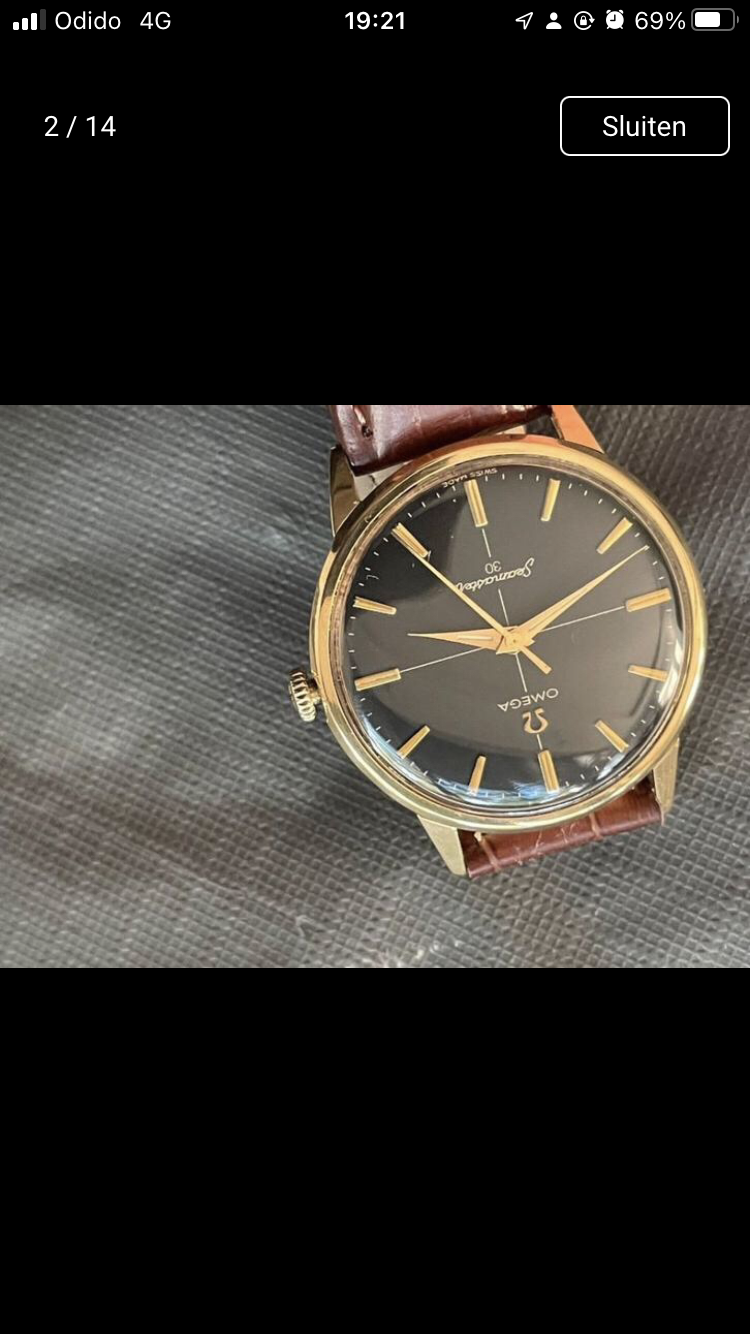

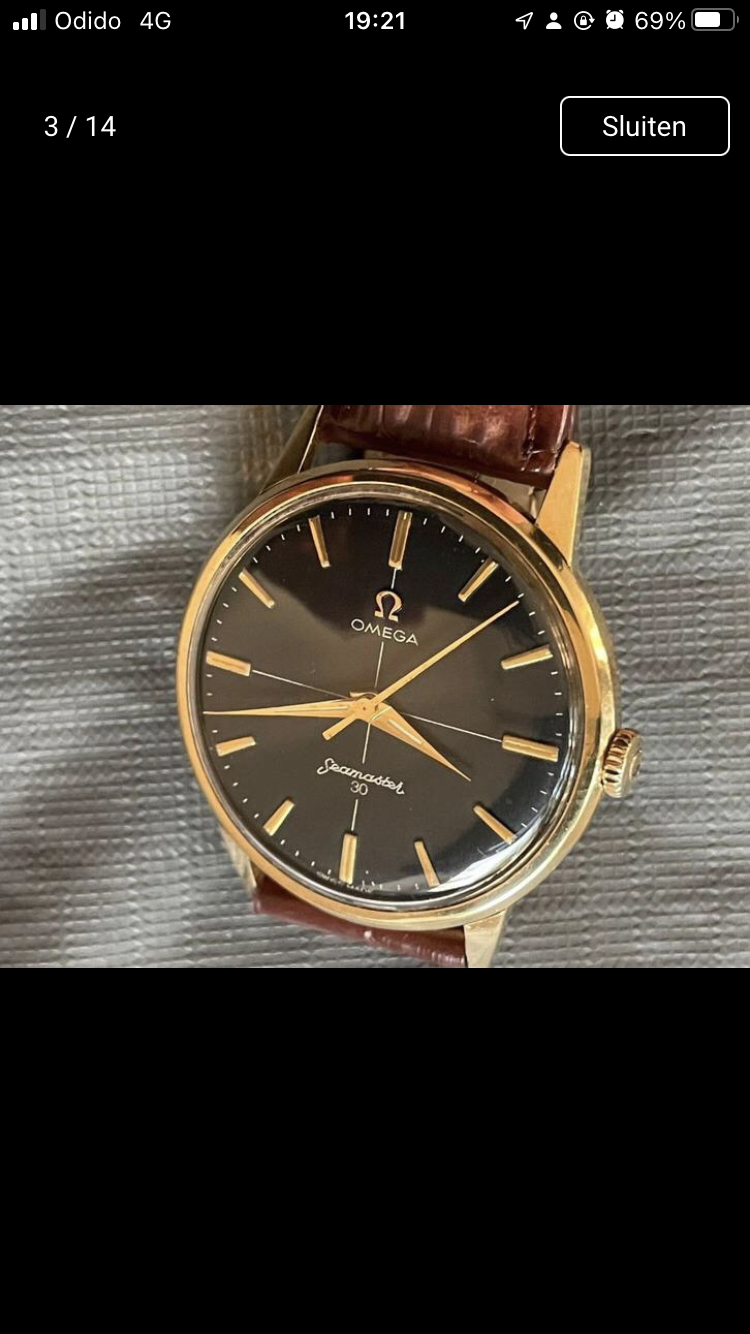

Hi all,

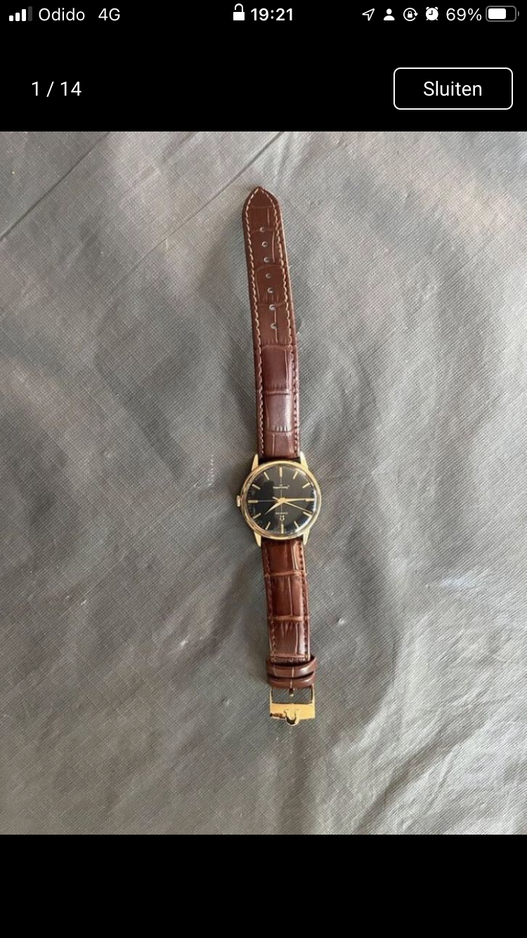

trying to go for my second omega watch and found this one on this Dutch website we have (kind of Ebay). The guy selling it is only asking 375 but to me it looks too good for that price comparing to others. Says it鈥檚 been his dads and that he inherited it. If I drive there this weekend, and it鈥檚 actually this watch on the pics that I can take home, should I? The number 131 010 does not tell me anything when looking it up on google. What do you guys think? Hope you can help me out! 馃榿
9,287
77,404
Probably helpful for OF members if you post photos rather than links. I鈥檓 sure you鈥檒l get more feedback that way.
24,810
55,147

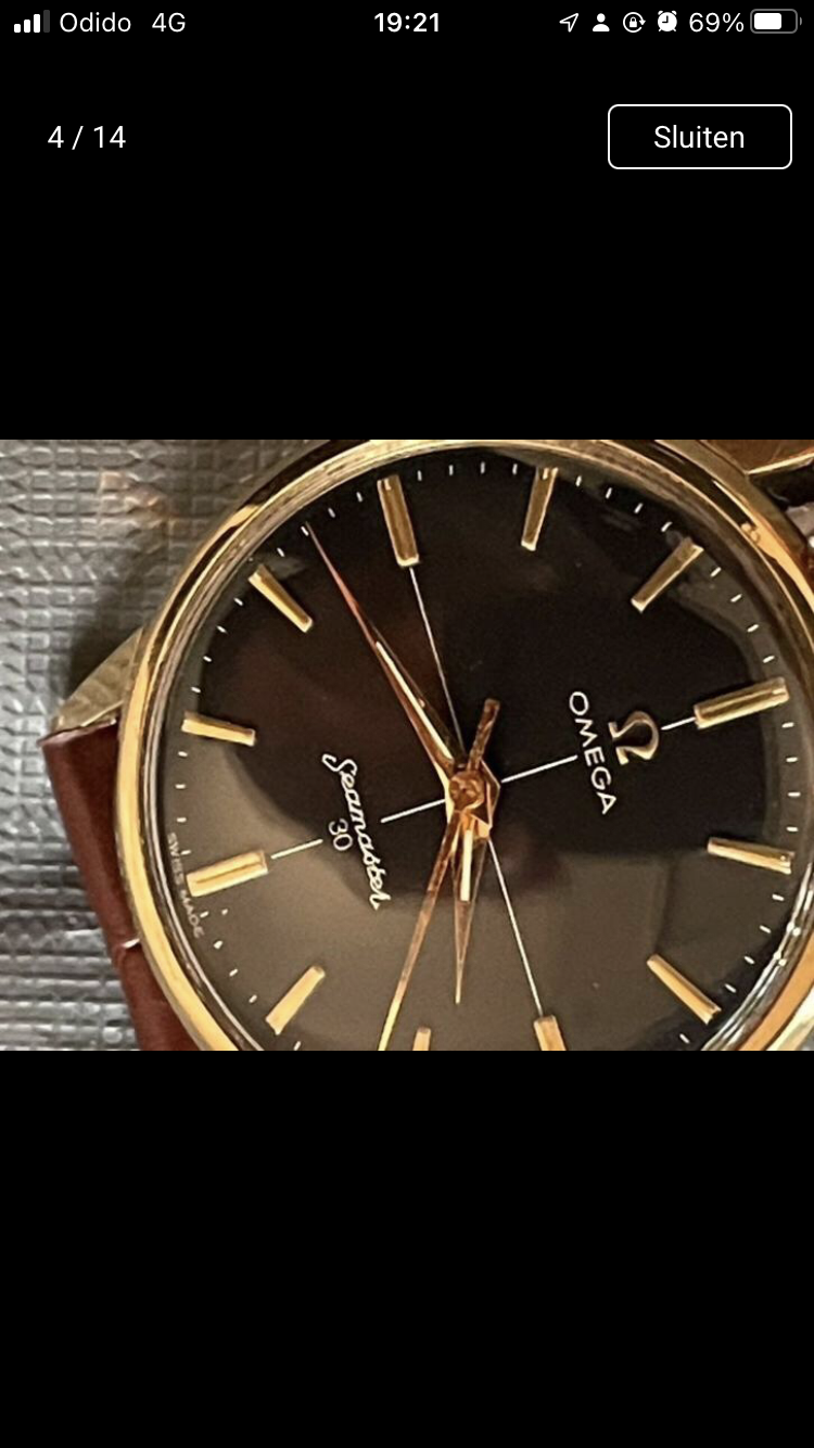

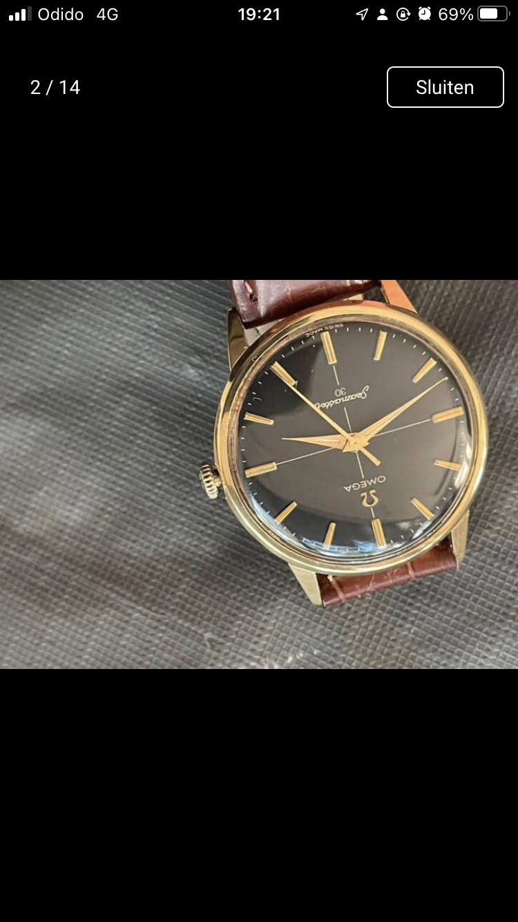

The dial looks repainted, but the 18k case is worth far more than a few hundred dollars, so it sounds like a scam to me. He probably stole those photos from somewhere.
3
Thanks Dan! The drive is not too far, so if I would go over there and will actually be able to take it home should I? No other signs to you that it might be a Franken watch? Stamps on the inside for example? I鈥檓 not an expert, as you could tell
10,075
57,426

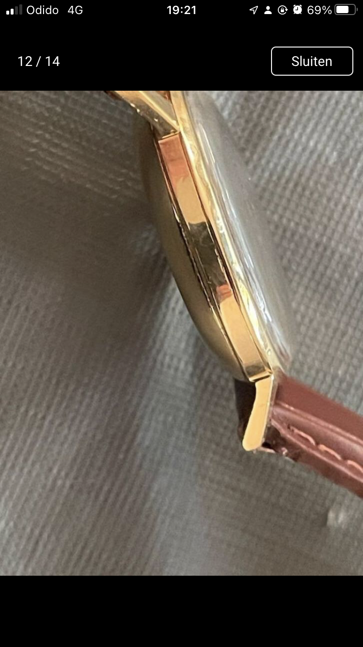

Dan, are you sure that it鈥檚 not gold capped in spite of what the case back says? When I zoom in on the photos of the back of the lugs, that looks like stainless steel around the edges near the tips of the lugs.
24,810
55,147
The back of the lugs do look funny, but I also seem to see what appears to be a hallmark on the back of lug at lower left in the image. I'm not sure what to say based on those photos.
10,075
57,426
Understood. The more I study that photo, the more I鈥檓 convinced that it鈥檚 gold capped and that the whole listing is suspect. I also agree with you that the dial has been refinished. I think that I鈥檇 walk away.
13,533
23,476
The watch itself is poor. The redial is terrible.
The best outcome here is that it鈥檚 a genuine listing and you buy some scrap gold for less than spot price. The watch is crap.
I also think although on first glance it appears solid gold, the lugs suggest capped.
To me, the potential upside isn鈥檛 worth the time/effort so I wouldn鈥檛 give it any more of my time.
2,342
1,467

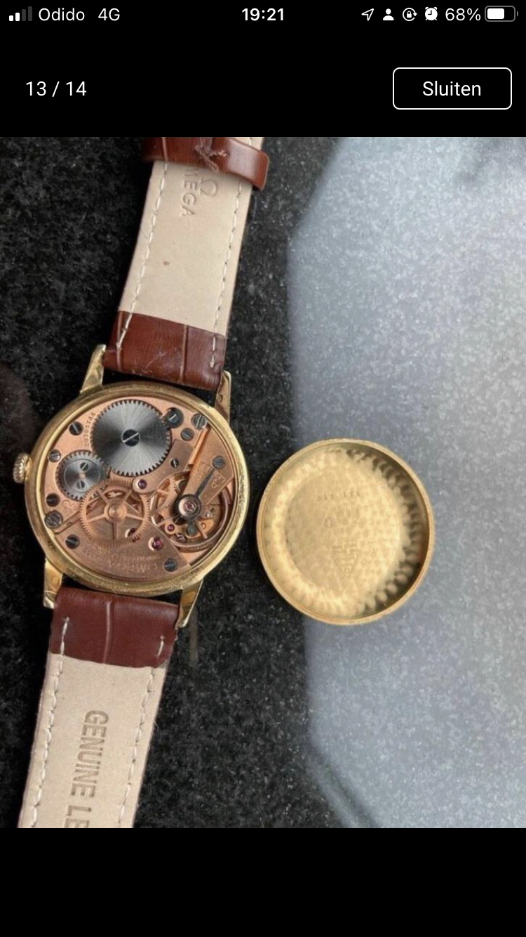

Reference number looks like 131.010 and no watch like that shows up in a search. It鈥檚 a Geneve model with cal. 601
I can see the Omega triangle in the first image, but not the stamped name which is odd. It should easily be seen
price is way too low
13,533
23,476

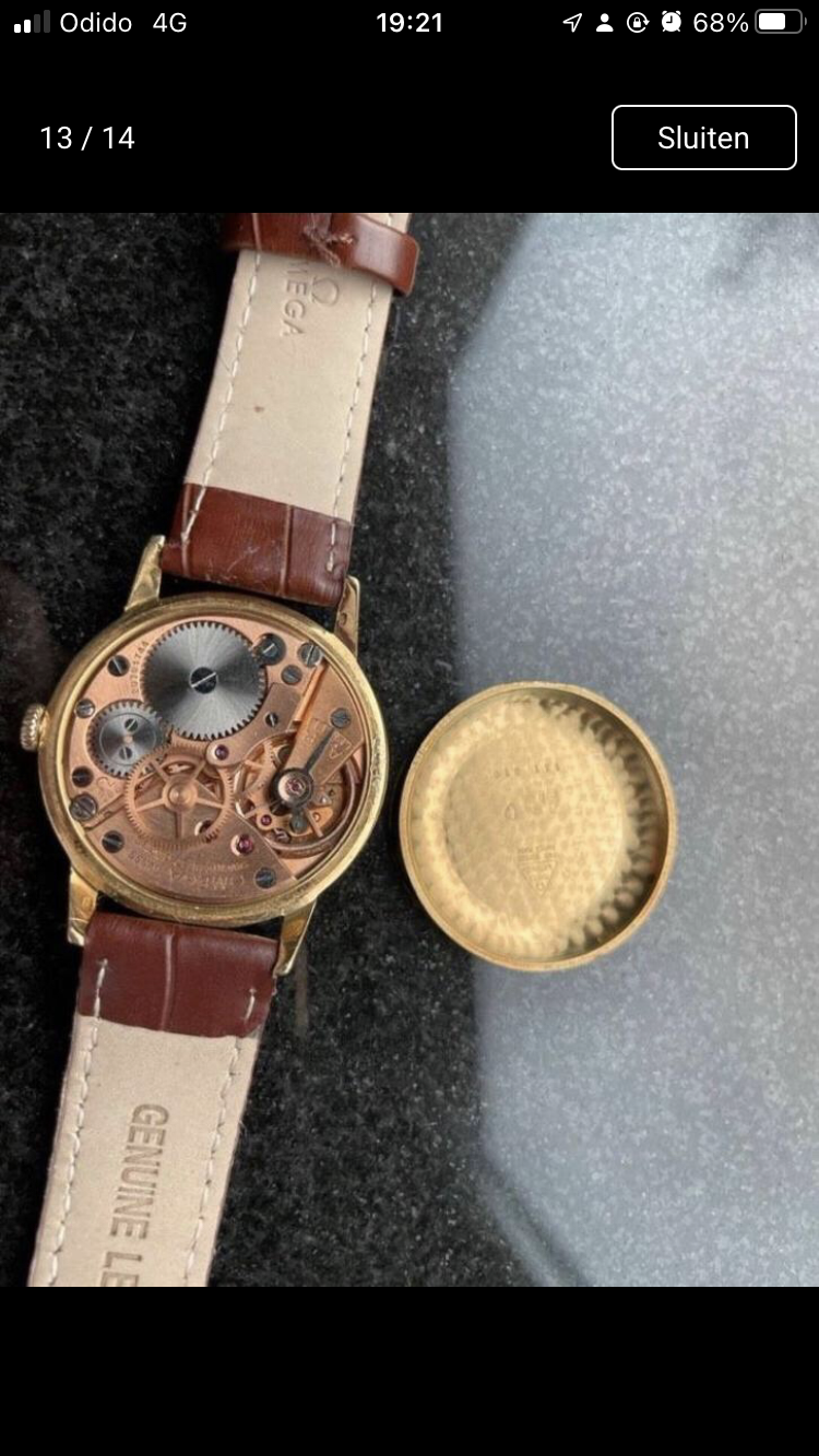

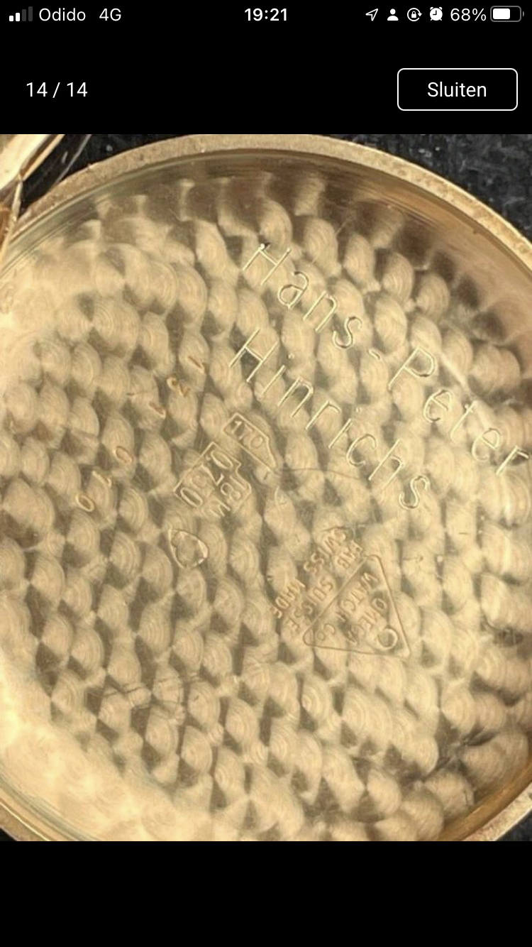

Just a follow up, the actual caseback is clearly 18ct gold, although I still have doubts about the case, although what looks like worn gold cap on the tips of the lugs could be reflection.
As above though, it鈥檚 not worth owning as a watch as the dial is a terrible redial. You鈥檇 be buying it hoping it鈥檚 not a scam, to scrap in the case. Still not worth the hassle/risk imo
