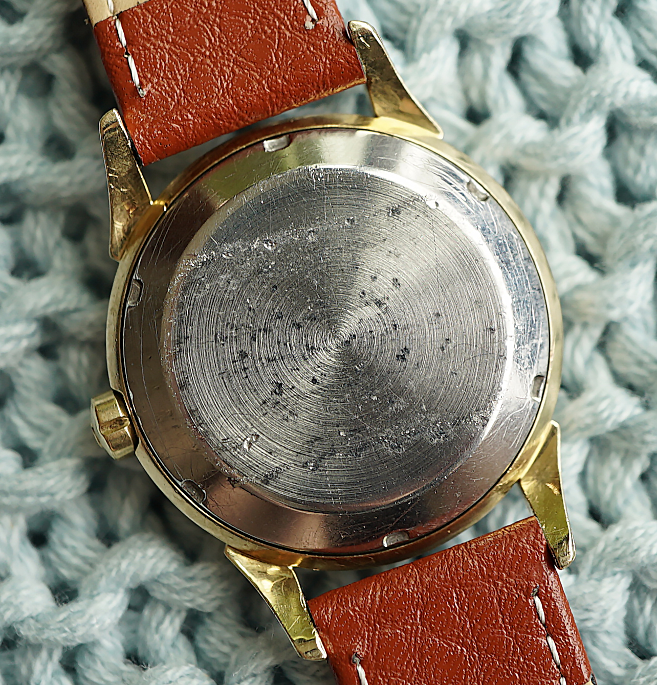

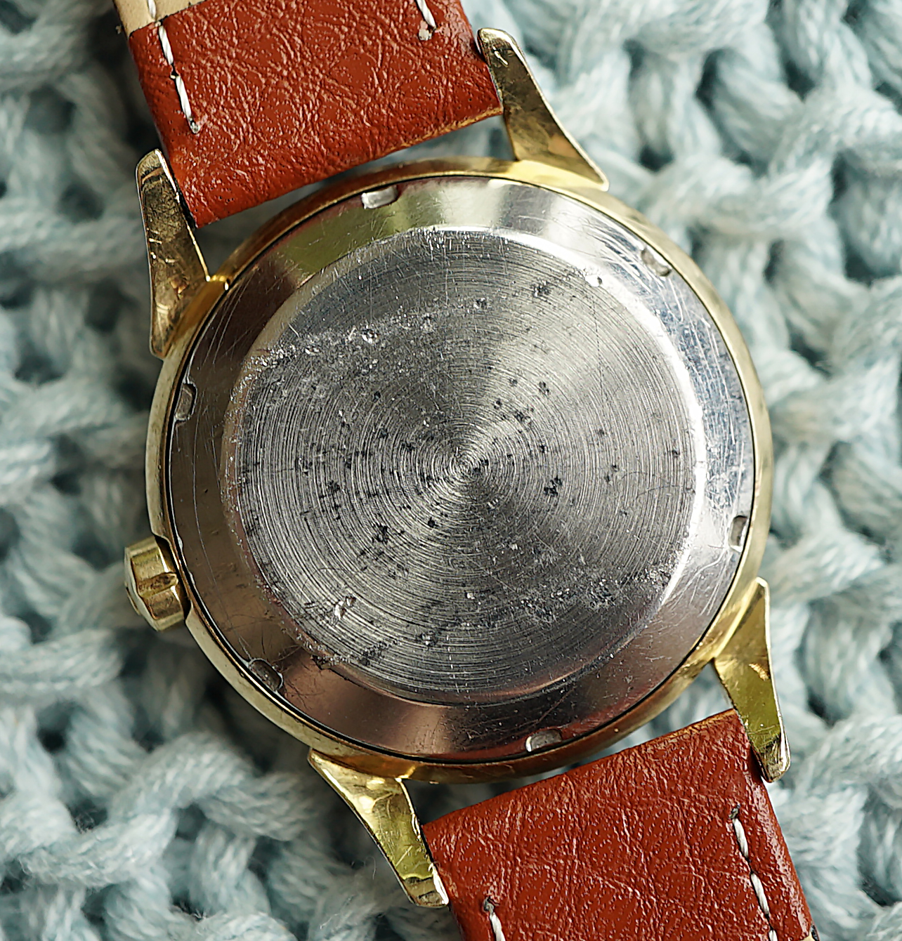

Besides the "pitting" on the caseback, the watch seems to be in good condition. I am not so familiar with these cases but the dial seems to be in excellent condition. What´s the size of the case? And how much is asked for the watch?

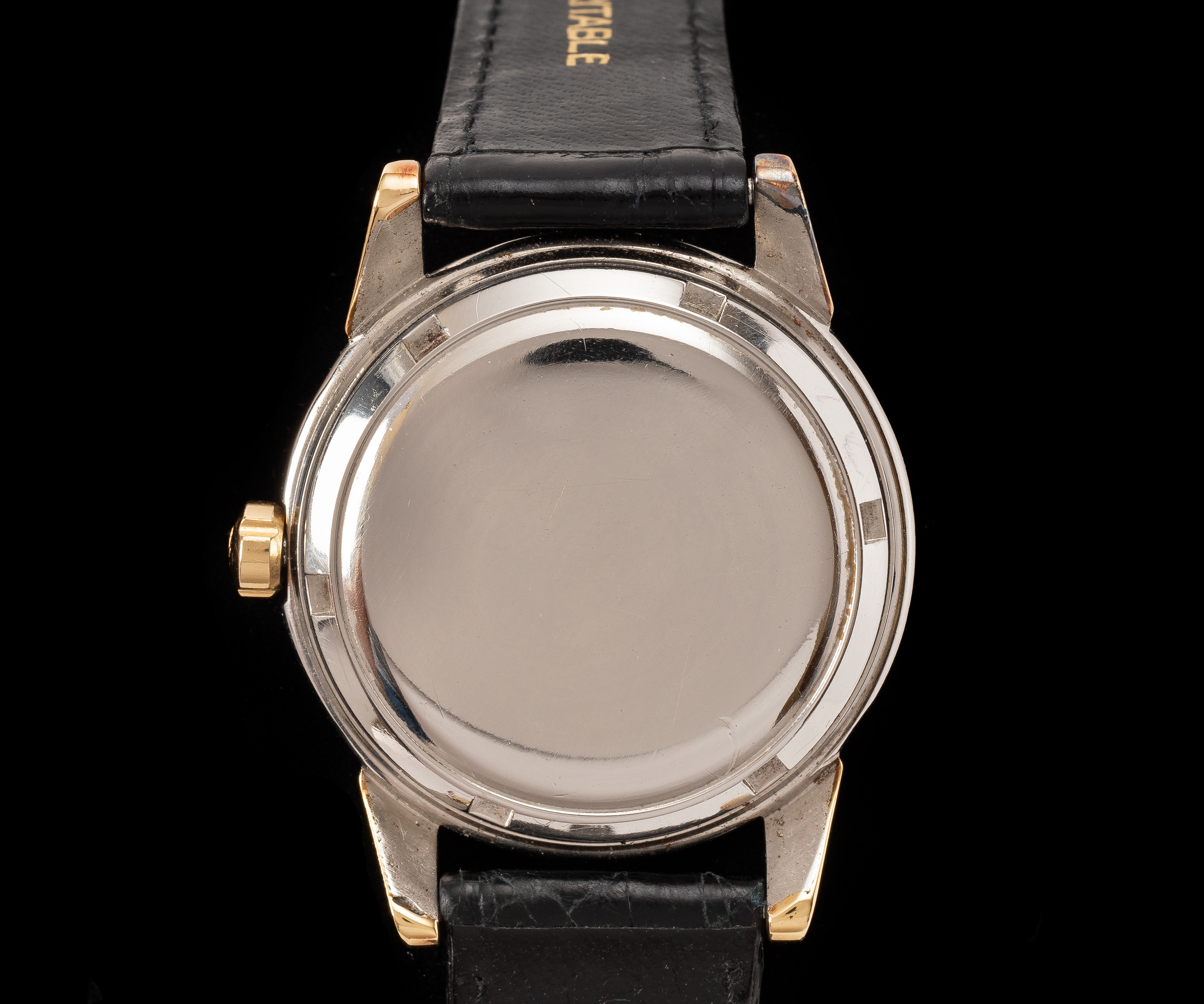

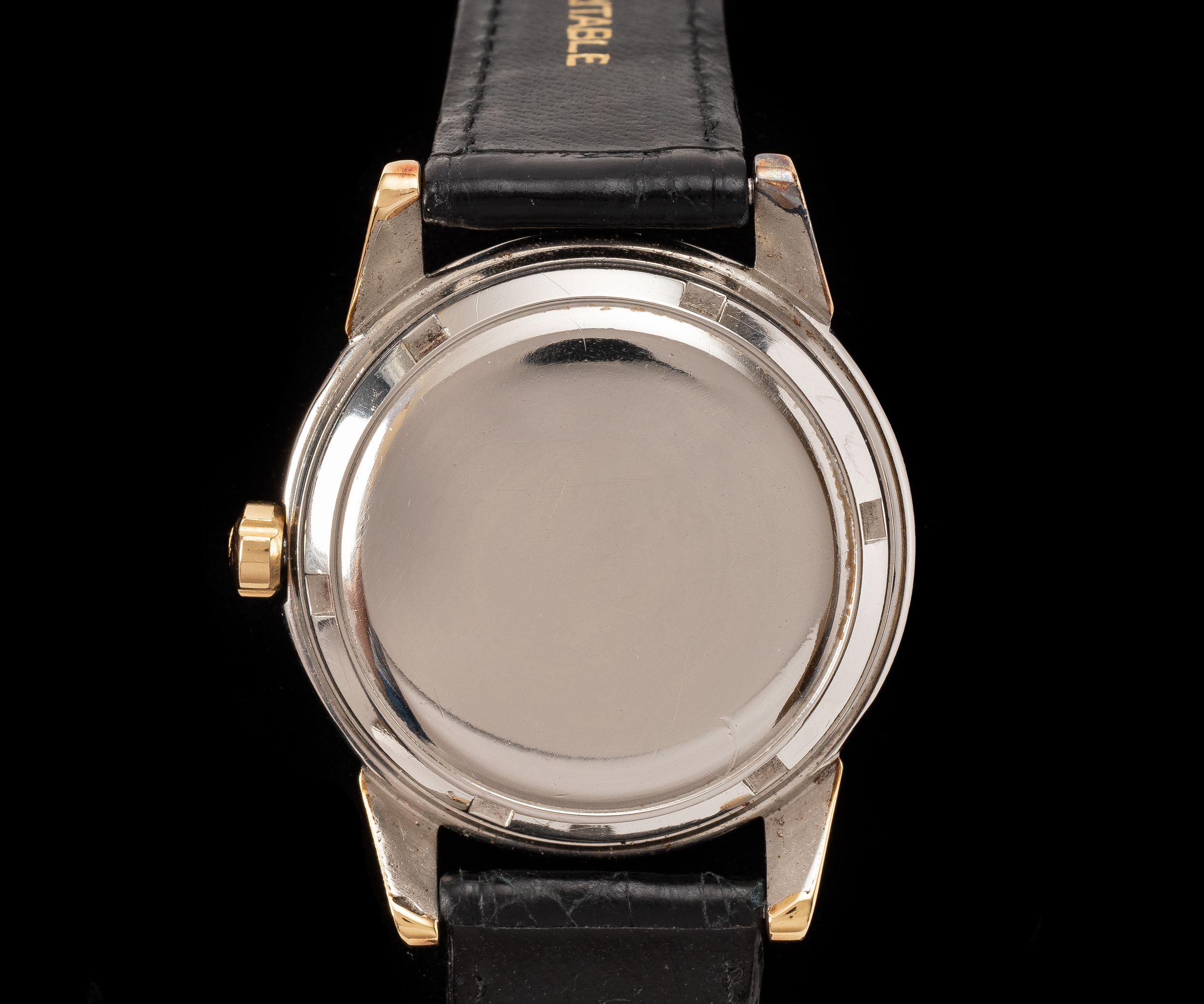

It is normal with a steel caseback when the case is gold filled. Here is picture of a Seamaster (gold capped) with a steel back...

Thanks for your asistance. Right, I forgot to ask about the "damage/pitting" on the caseback.

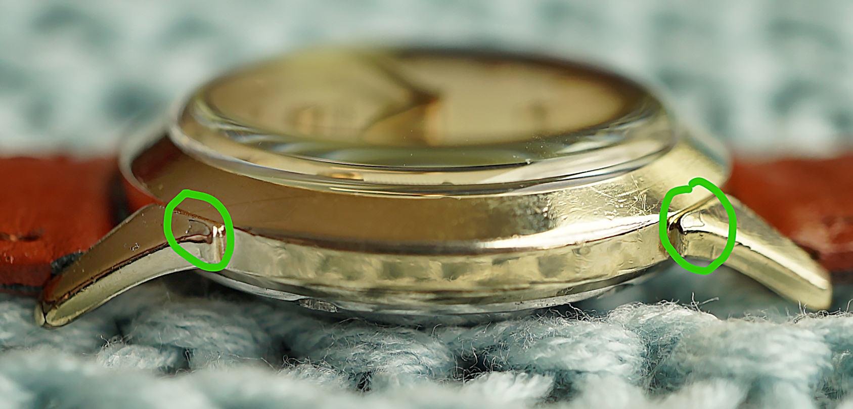

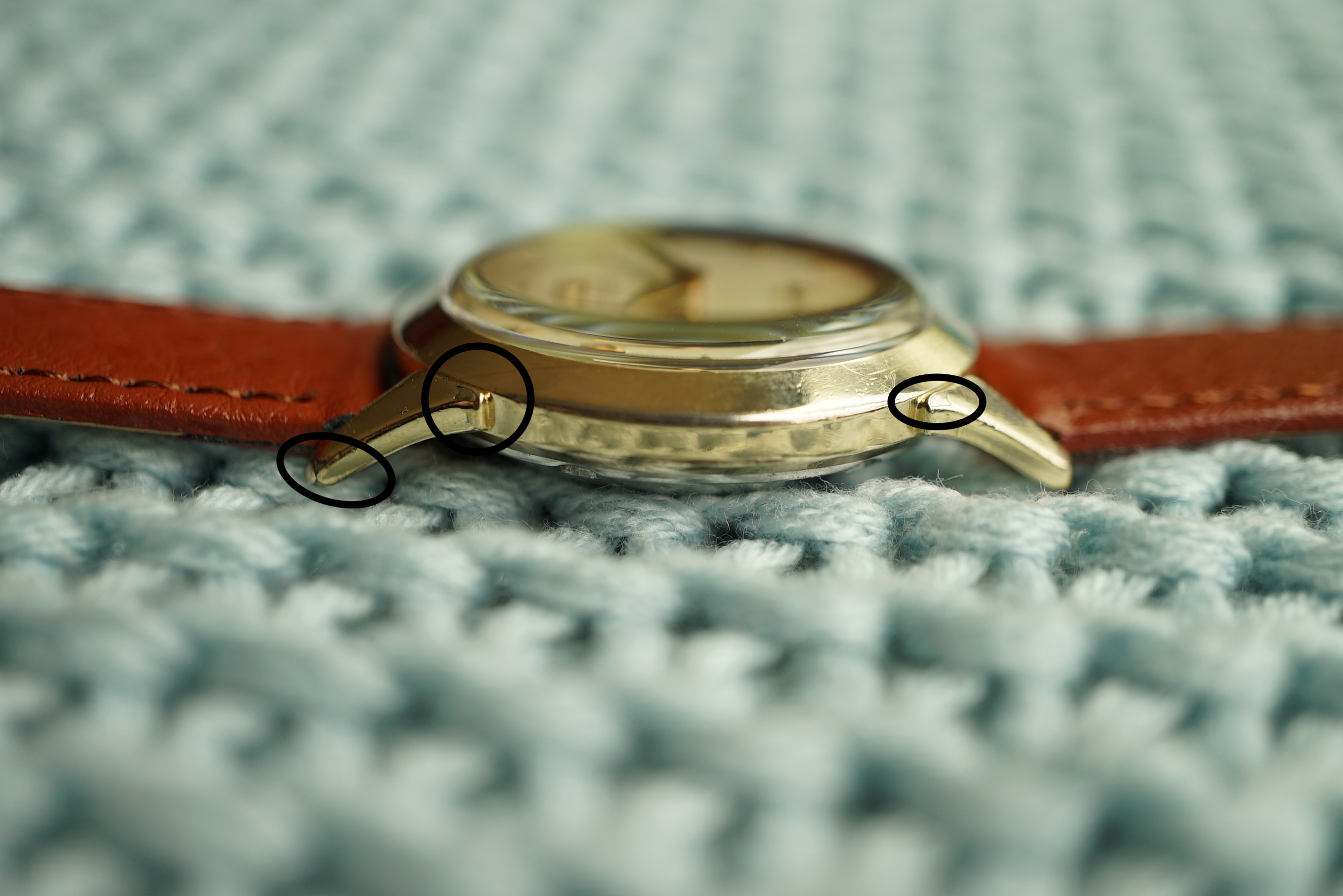

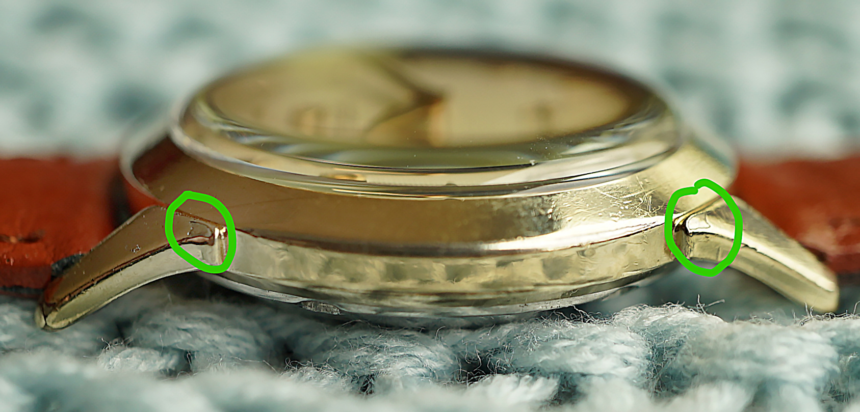

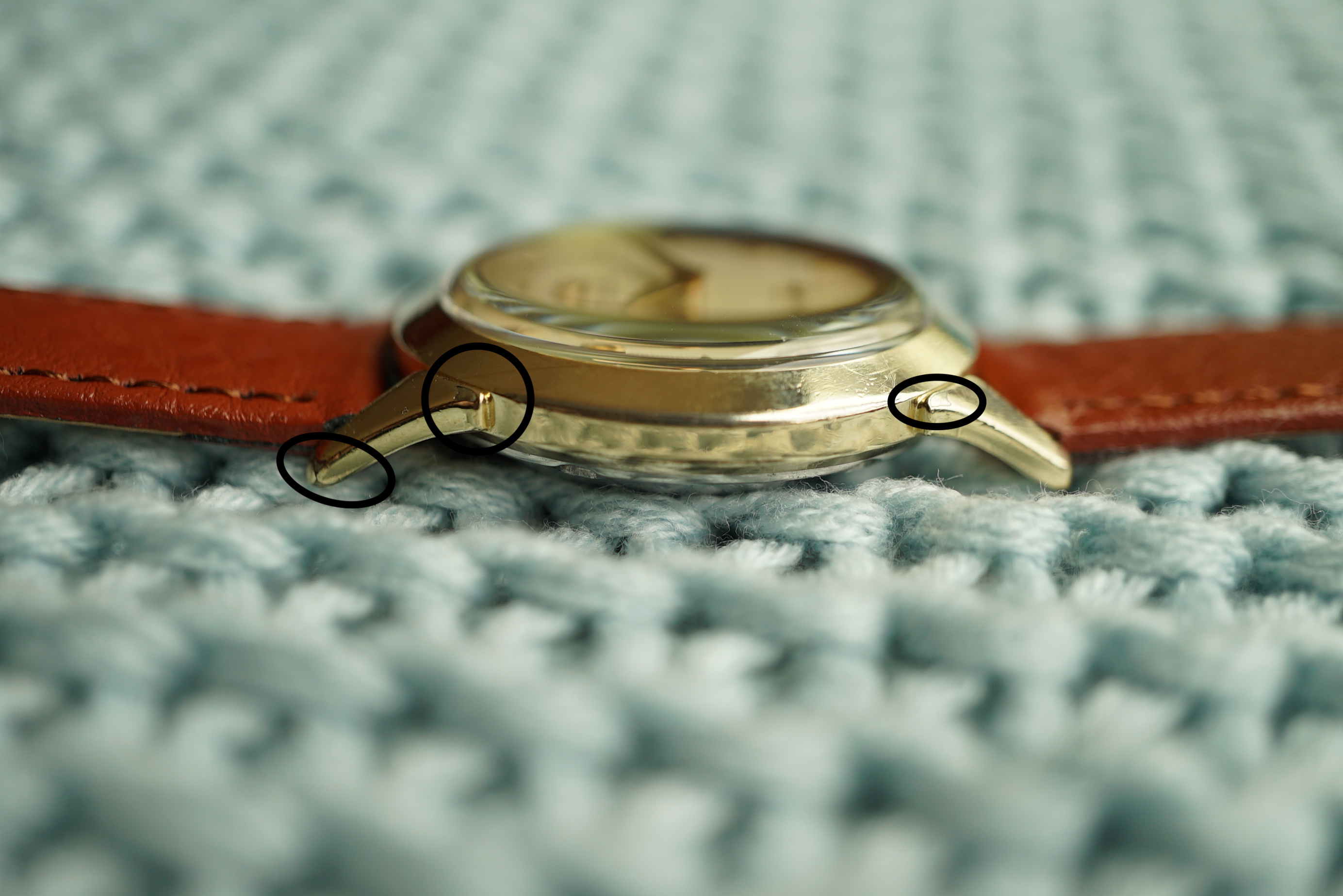

I don't think that is gold filled, it looks plated to me and its a bit hard to tell but it looks like the plate has gone in a few places, particularly one lug (top opposite crown) where brassing is very evident. If my suspicions are correct then this isn't actually in very good condition, though the dial is undeniably nice. Why does the seller think it is 14K gold filled? If it doesn't say so on the case then he is likely just guessing: gold filled wouldn't wear through like that. and the inside of the case would be bare steel rather than gold colour.
The damage on the back is Nato rash.
I have circled the areas I think are plate damage AKA brassing:

Sorry, my bad, I didn't see you had an attached picture for the brassing.
I agree with you, some damages and it´s plated. I post an enhanced picture of the caseback. I stand corrected, the case is not in good conditon.

Thank you, padders and Maskelyne. I simply passed it off as lighting; now I know I have to scrutinize these carefully. Greatly appreciate your advices.

I wouldn´t hesitate to wear it and buy it at a fair price. The damages are not so severe in my opinion. I love these waffle dials. It looks like a 34 mm case but I am not sure.
