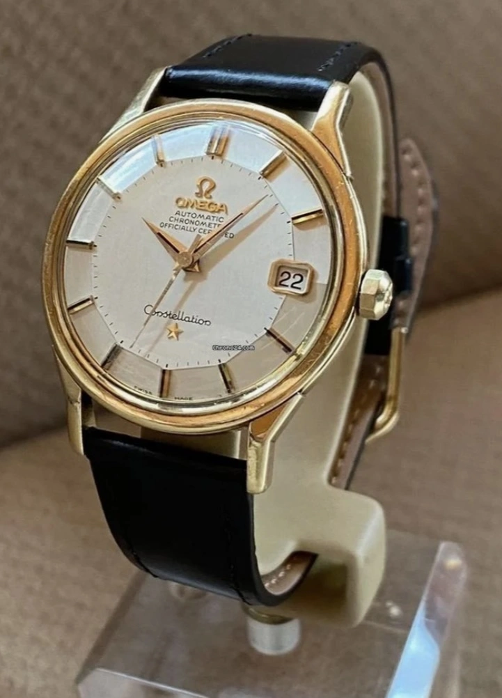

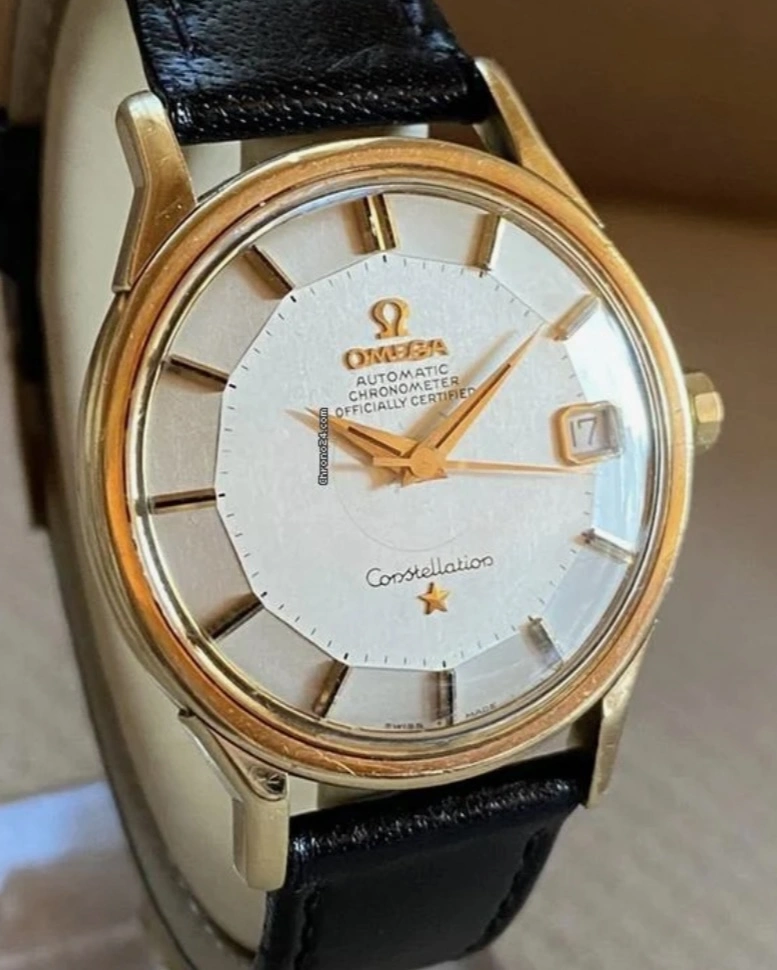

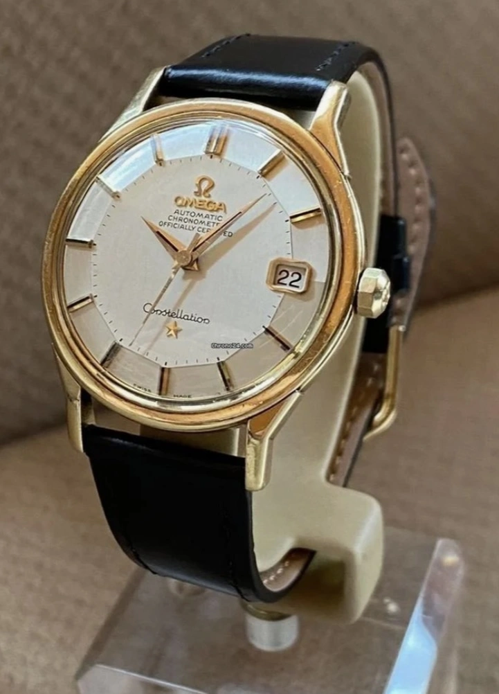

Hi! I am on the hunt for my first Omega Constellation Pie Pan and saw the below advert. This would be my first vintage watch. The owner stated that the watch is all original, except for the glass (replaced) and the buckle. At first the advert referenced a 561 caliber, but after I pointed out that the photo’s showed a 564, he changed it. Do you have any advice on how I could establish whether this watch is genuine?

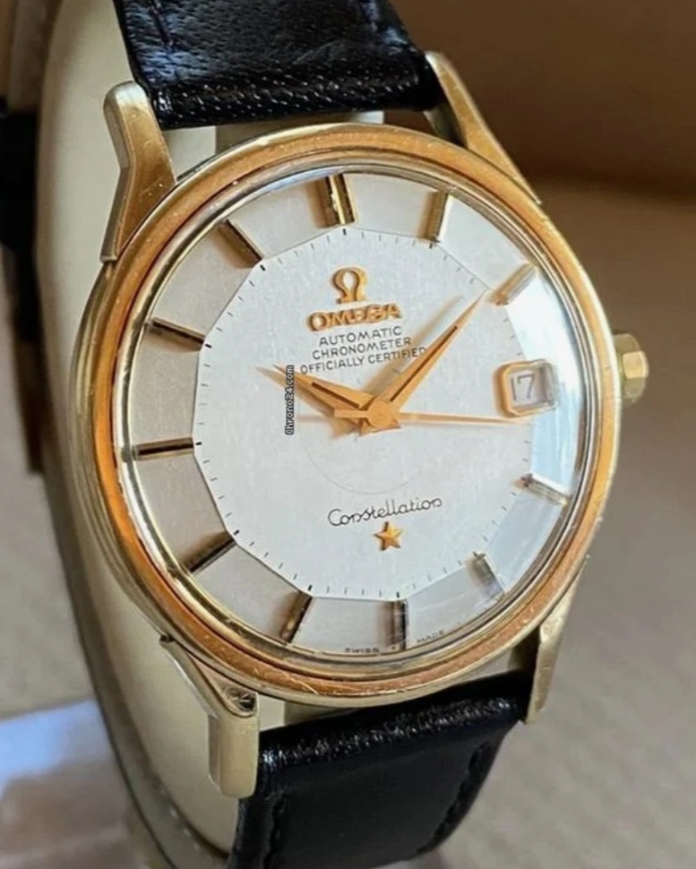

The first thing that jumps out is the polishing. This example is way too polished. The dog leg lugs need to retain sharper edges, otherwise you lose the attractiveness of the model straight away. So just that means a pass.

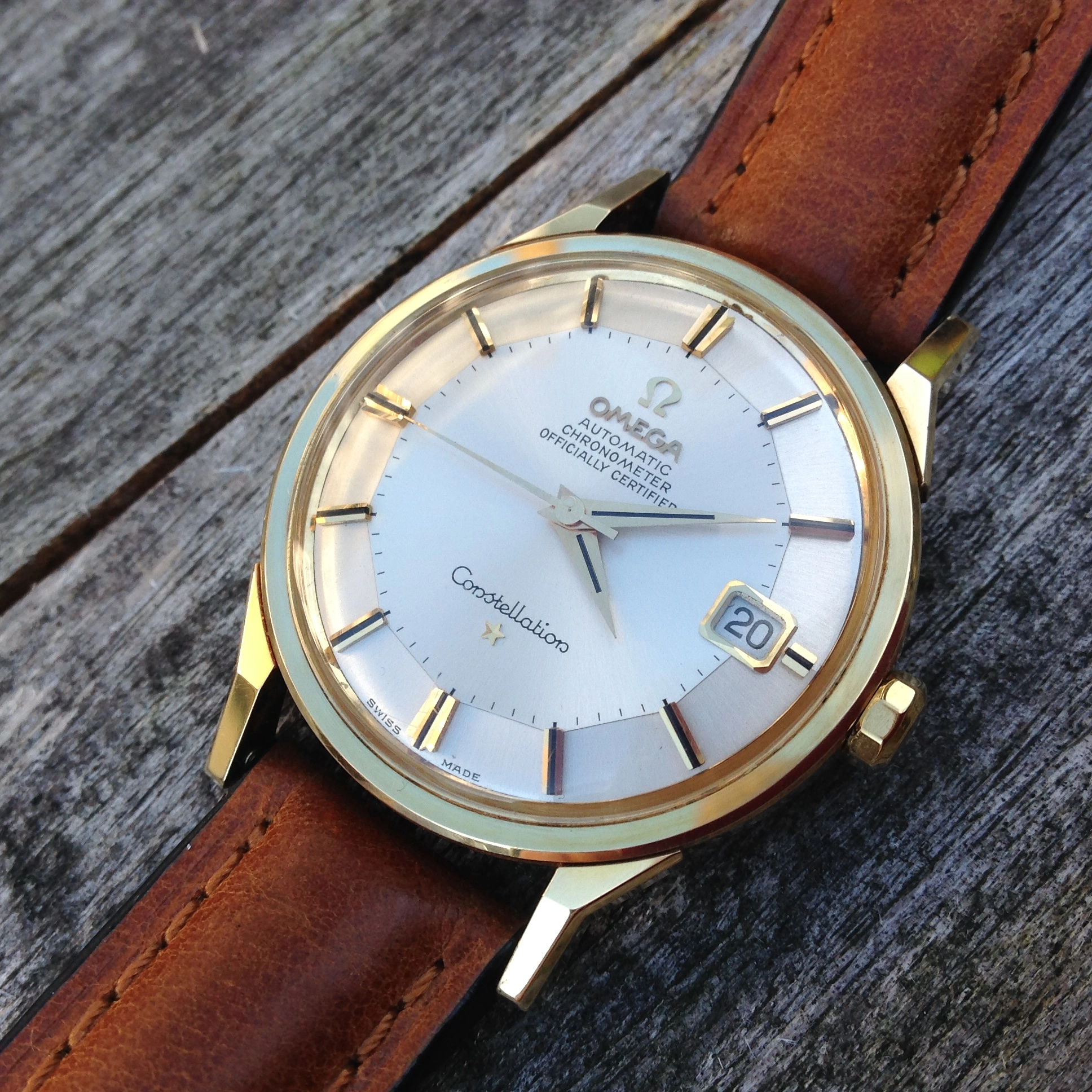

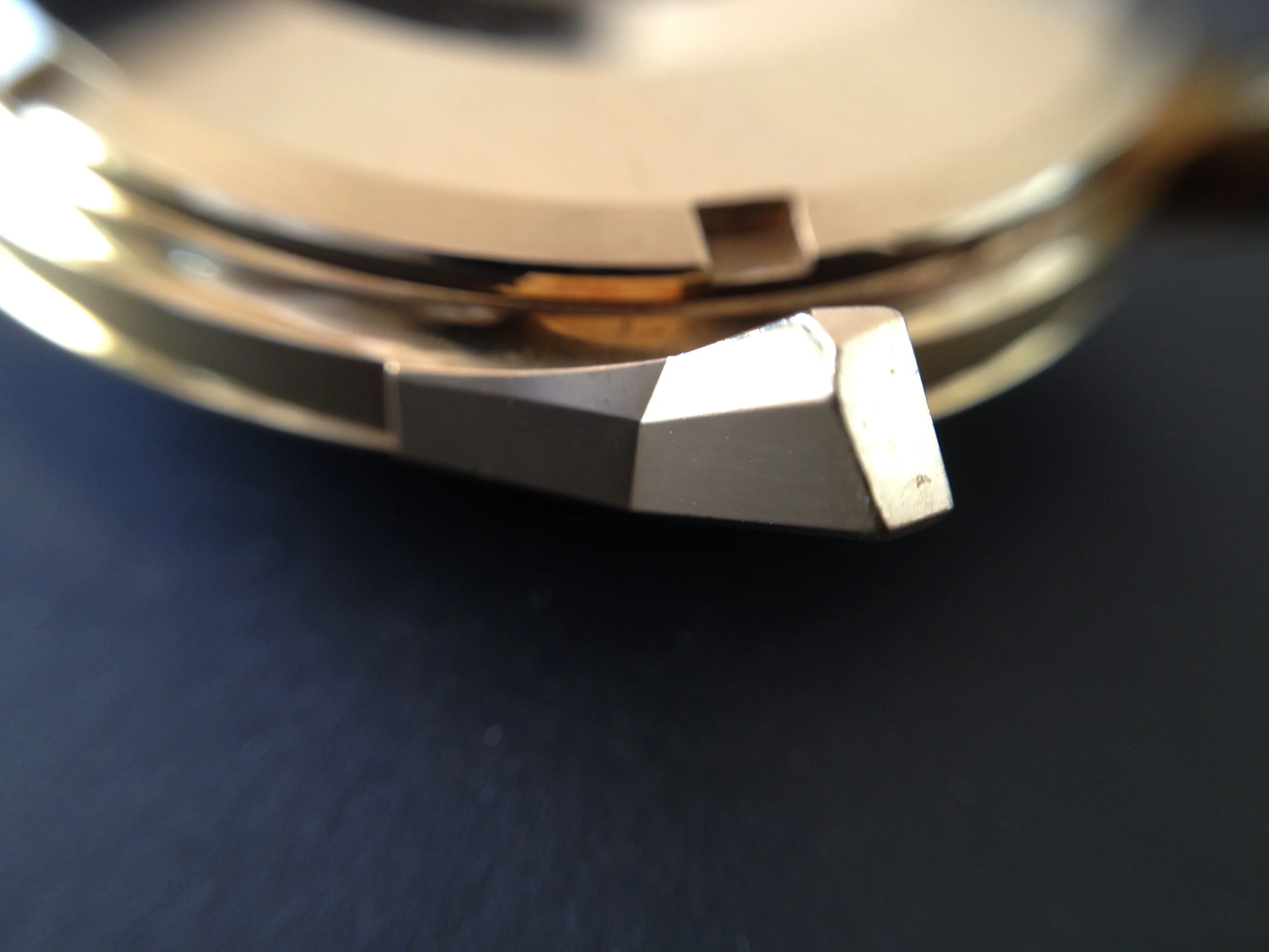

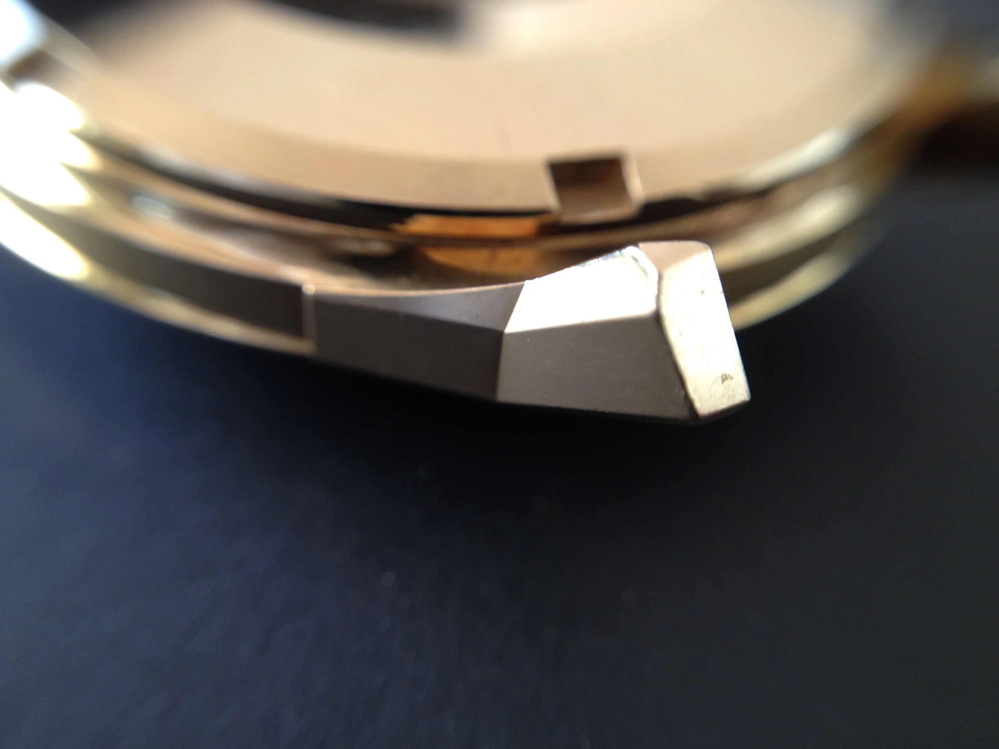

As you’re new to this parish - and to save time - I’ll post some pics.
The watch is significantly over polished.
€2,970 would be an ambitious price for a good 14k dogleg pie pan - in this case it is probably twice the value.

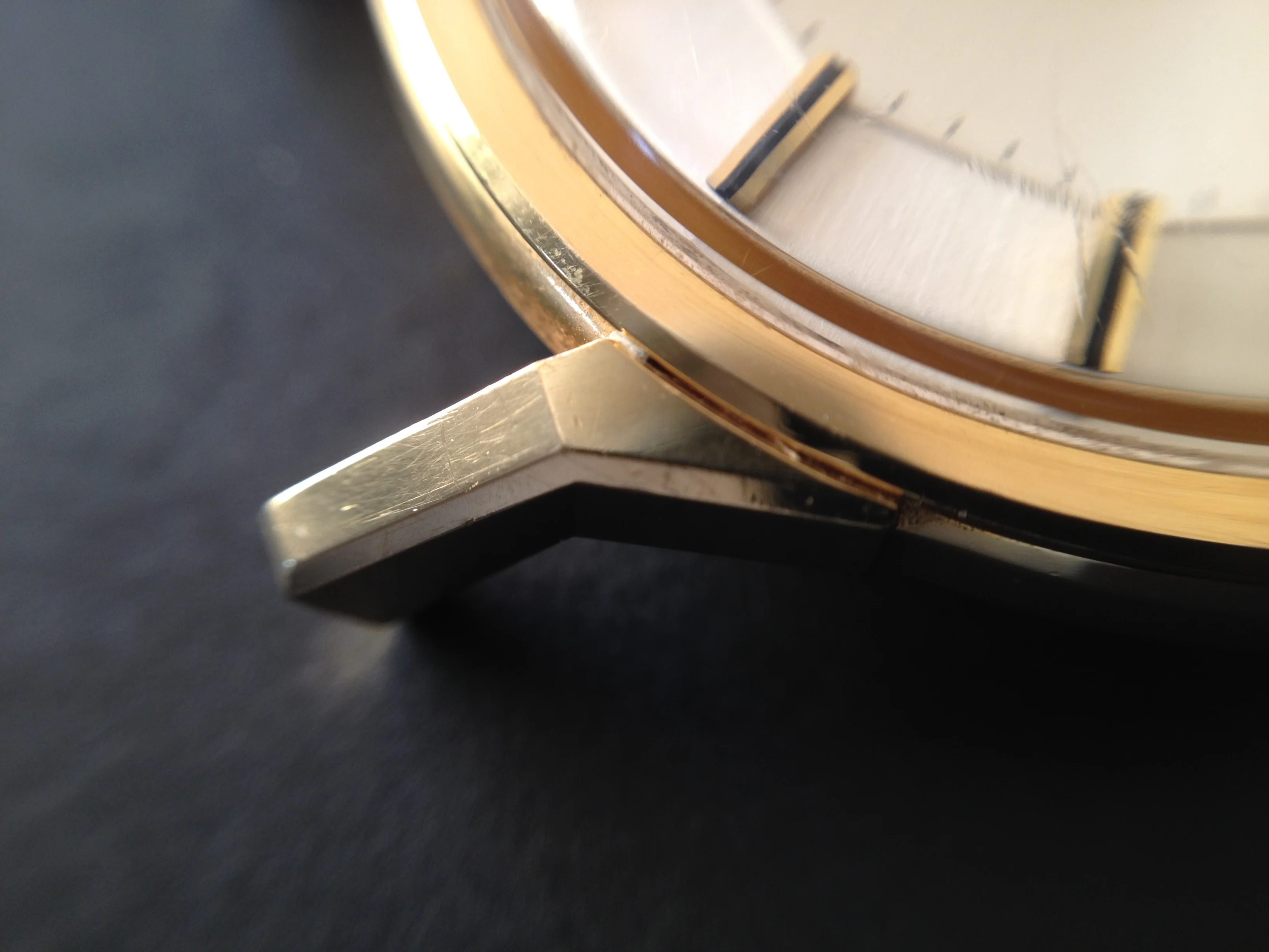

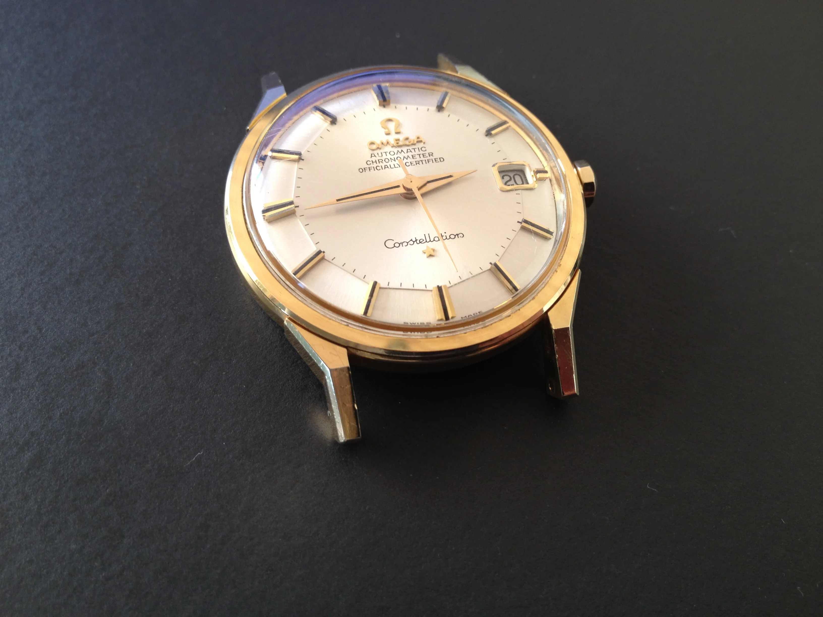

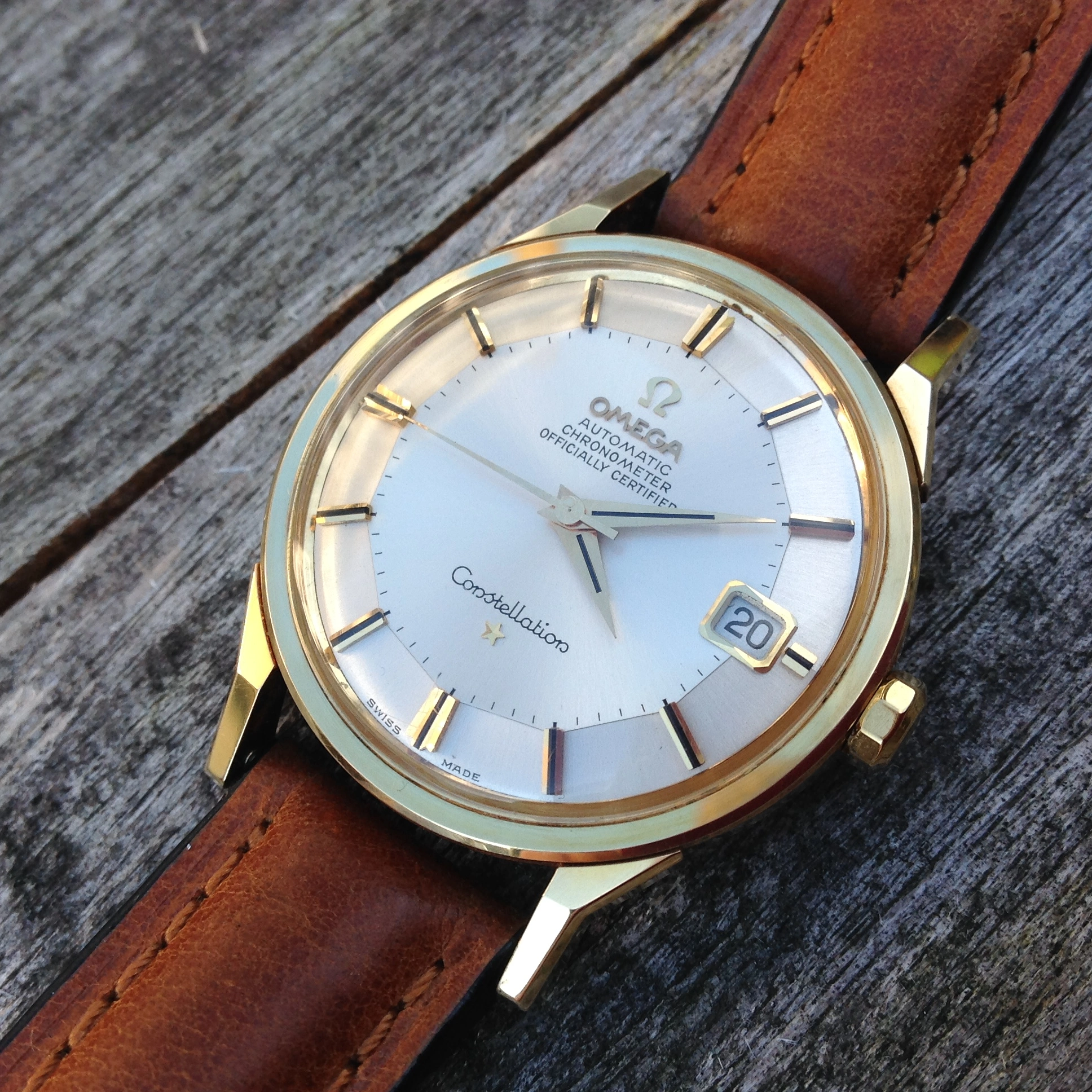

For reference.
This is what the lugs on a gold dogleg should look like.
