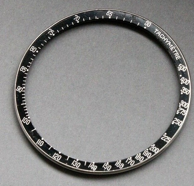

I have to say that this one was a quite tricky one and that OP did a good job having doubts.
At first glance it looks just fine but now I see that font and placements are not good at all.
Also, it explains the overlap of black part looking from reverse view. The black front is clearly to wide.
On original bezel some parts of the digits are printed actually on the chamfer...
Good job raising your concerns here anyway..

thanks again guys. I spoke with the seller and he apologised adding that he will investigate.

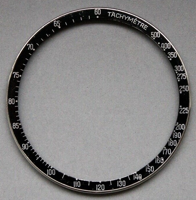

From another seller, I got the following pict. Any opinion? I don't see any warning sign, but yet, I'm not an expert.
1,610
2,722
Don't want to give this thread whiplash, but @speedyoscar would you mind telling us the seller that is (presumably) selling the counterfeit bezel as the genuine article? If this seller is intentionally trying to scam others I think it would be best for everyone on this forum to avoid them.
761
1,738
The one above looks legit. There is slight variation on how close the numbers are to the edge on DON bezels. The fonts and location of the dots are always the same of course. It may, however have been touched up a little on top. It's hard to tell. The first one posted is fake.

From the OP's post on another thread I wrote about the first DON insert.
"At first glance the insert looks good, but, the more I look at it, I wonder...
Am I seeing things.... the font looks a little heavy, the numbers 60 and 65 are usually right near the edge, the word tachymetre doesn't seem to be centered but more to the inside, the number "2" doesn't look quite right... what is the seller asking?
So, guys, have I lost it..."
So... I'm not crazy

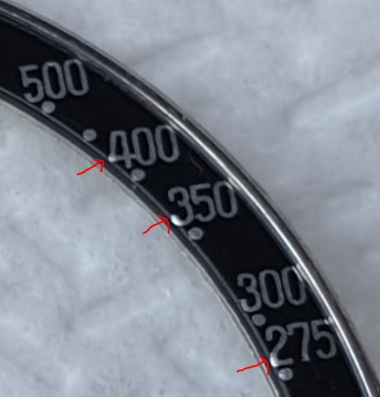

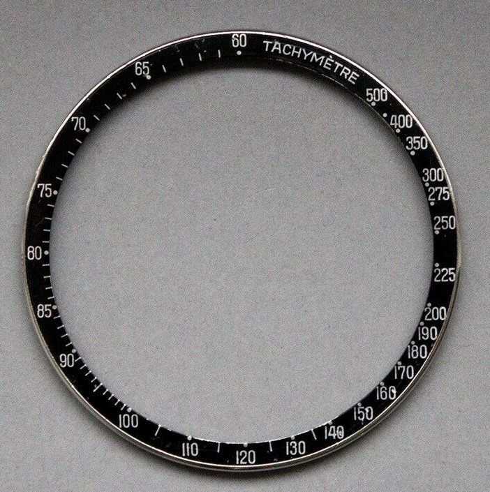

Hi everyone, probably this question has already been answered. I noticed that some DON bezel has thicker fonts. Are they genuine?
The one below (which I'm studying/evaluating) seems correct to me, the only doubt is the font-thickness.
13,555
23,503
The thickness of the fonts alone can't identify a fake imo.
There are at least two variations with genuine, vintage DoN bezels, one with a fine print and one with a slightly thicker, ever so slightly less precise print.
The one in @speedyoscar pic looks genuine to me.
looks good to me as well. I find that sometimes the photo can also distort the font thickness more than it appears in real life.
