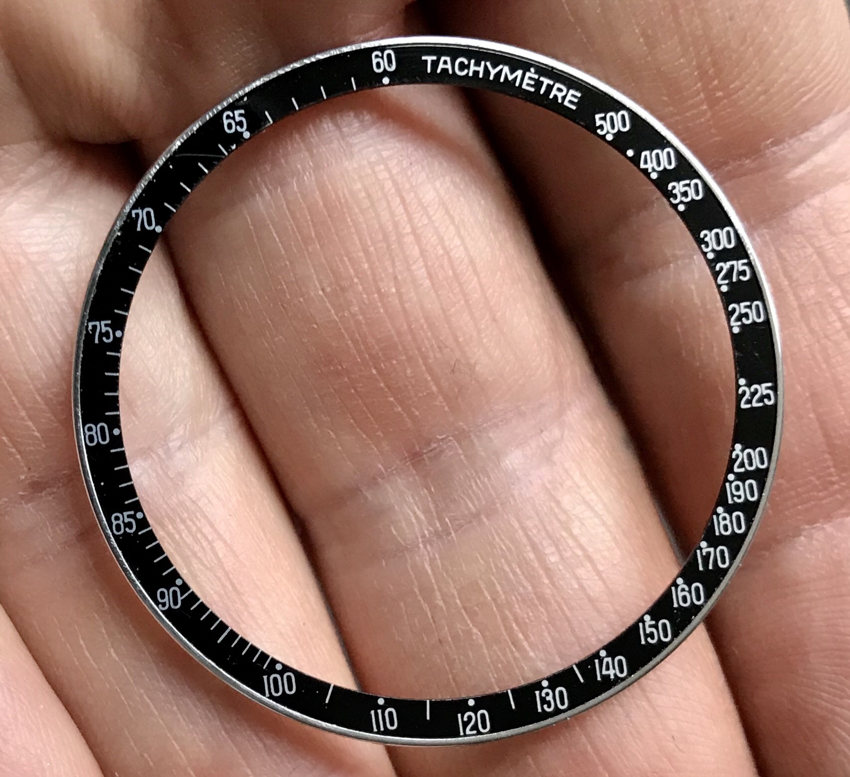

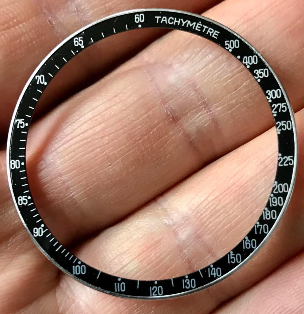

Hi everyone,
I'm evaluating a DON bezel to buy (picture below). Of course is an expensive item. I'd like to know if it looks correct for you.
Thx in advance
2,298
3,157
Looks genuine from my humble knowledge but wait for the pros! 馃槈

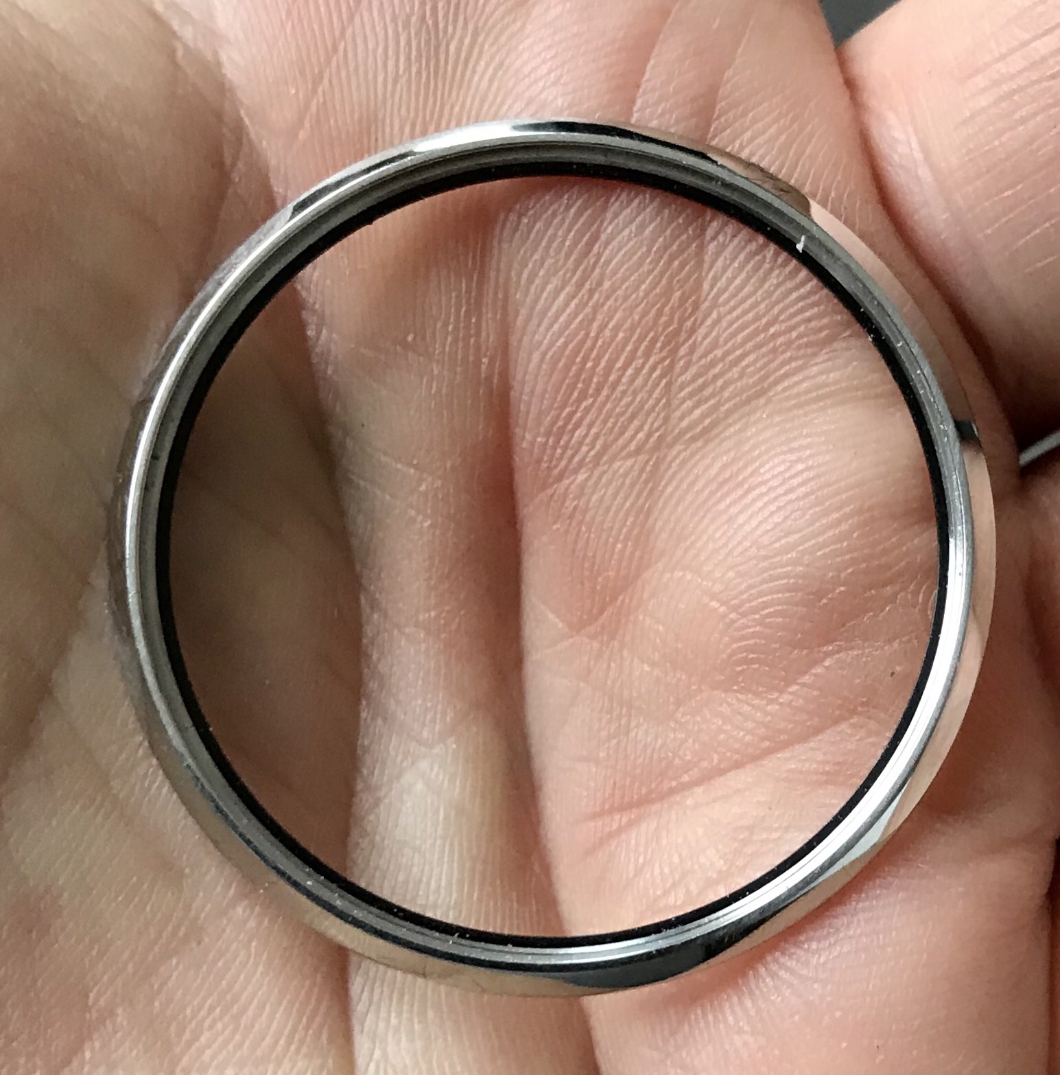

is it normal that insert sticks out from the metal bezel (from the back)?

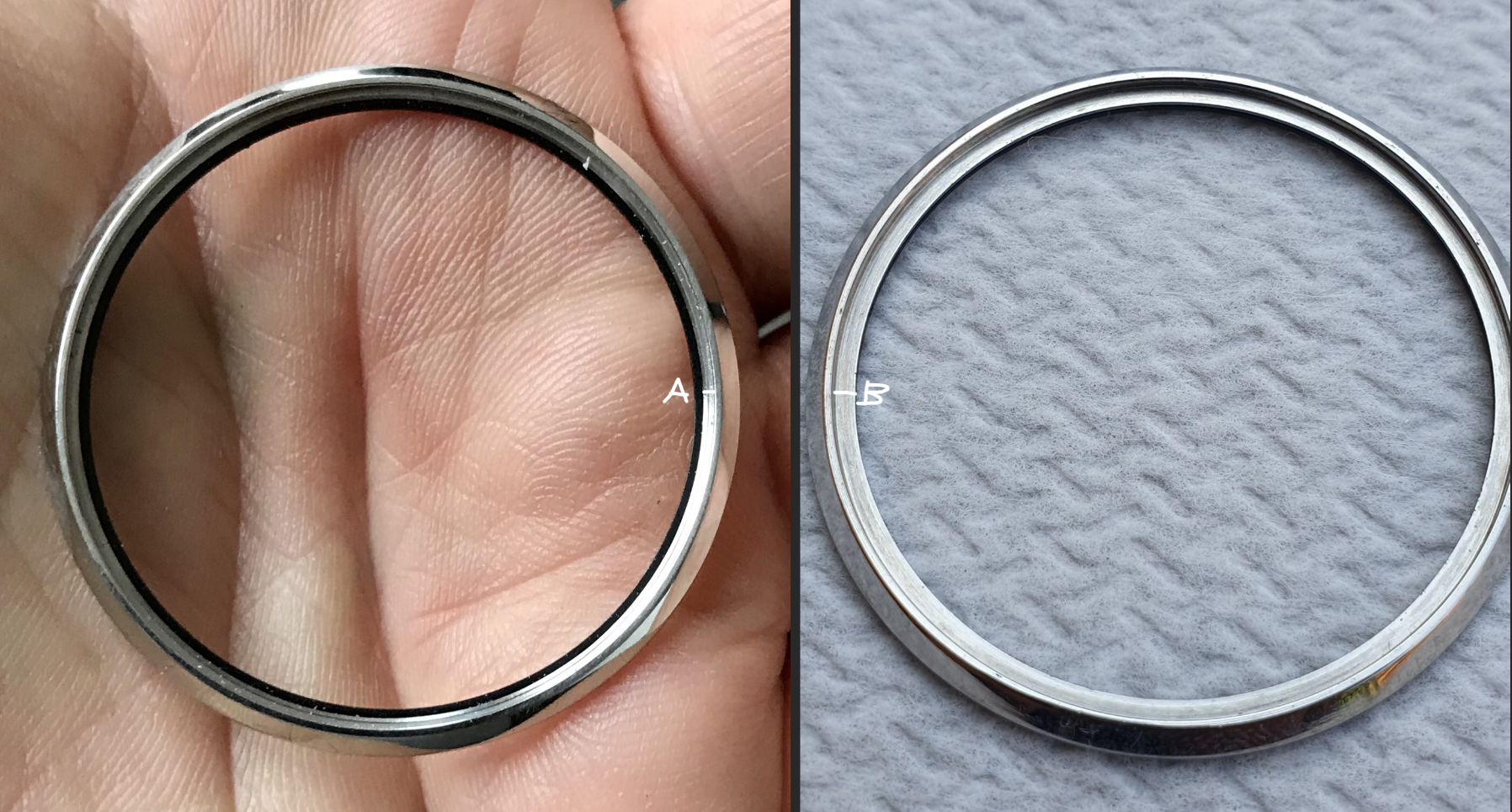

you can compare with my pictures here 馃榾
https://omegaforums.net/threads/fs-do90-bezel-for-speedmaster-mint-reduced.118074/
Looks genuine to me, nice, except for the scratched edge in the upper left corner.
The black part sticking out depends on what angle you take photo from.

thanks for the answer. I don't think is the angle. If you see the pict 2 (back side) the insert sticks out all around. Yours (in the link) looks different from the back

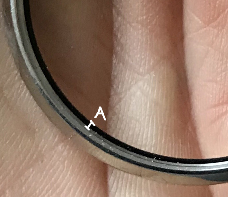

It looks like the metal ring is smaller. I used a Kapka's image (B) as comparison:

When I look at the distances between numbers and dots and the thikness of the font itself, I have strong doubts this one is authentic.
150, 160 blend together with the dot, position of the dot over 170 is off left overthe "7", distance beween "60" and dot below is to narrow, generall dots and numbers are too narrow and font is too thick.
Just to mention whatt I can see ad hoc compared to 3 DONs I justed pulled out to compare.
Be careful. And I personally wouldn't offer a DON in this condition for 1700. If I had no idea what I'm offering, then maybe for 300, but having an idea and 1700...well.
I urge you, Go check thoroughly against authentic DON-Bezels first and then against repros.
