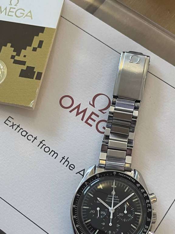

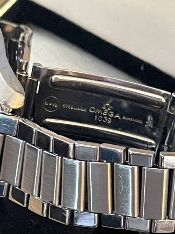

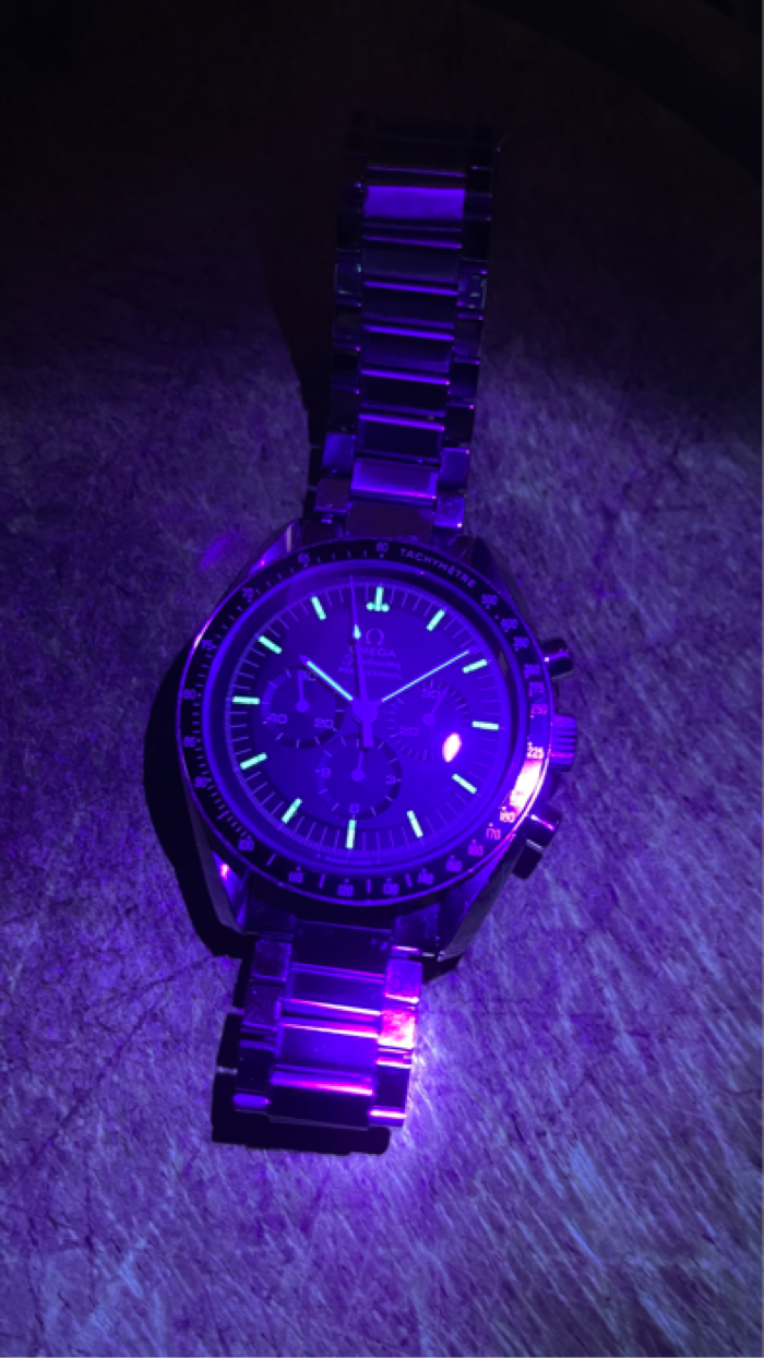

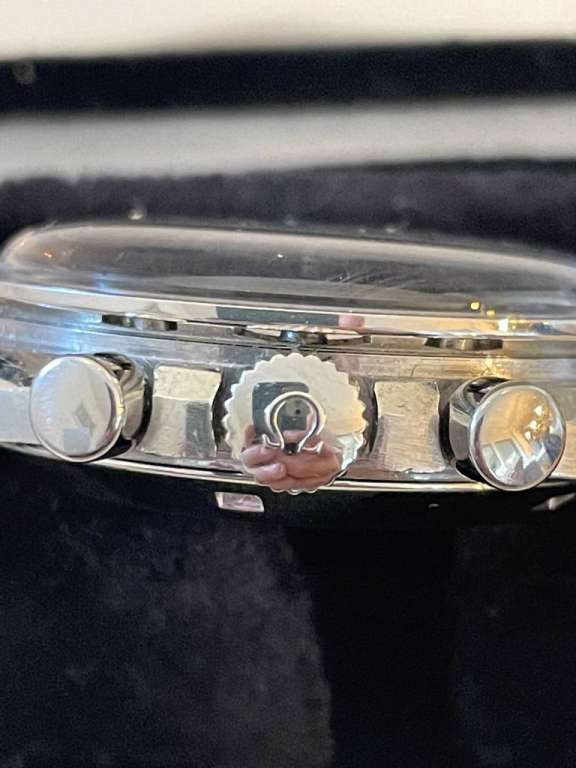

after owning one brand new Aqua Terra as well as a beautiful seamaster from 59 it is now time to get my long awaited Speedmaster. I've been looking around for a while now and stumbled uppon an offer for a premoon Speedmaster yesterday.
Seller wants 5'181 € but I have some doubts on the watch.
It comes with original box, blank warranty card in very good state as well as a register extract from omega.
The bezel has unfortunately been replaced with what I would think is a late 70 one so that is something I'll have to replace. From what I've seen prices for an old bezel range in the 1000-2000€.
The pusher are also not original but that bothers me less.

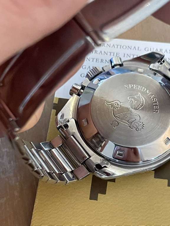

Case back engraving seems a little deep to be original but I am not qualified enough to confirm that.
Based on the pictures would you say this is a good buy ? If so could you direct me to which bezel would be the most accurate to be fitted on this watch ?
Thank you all !

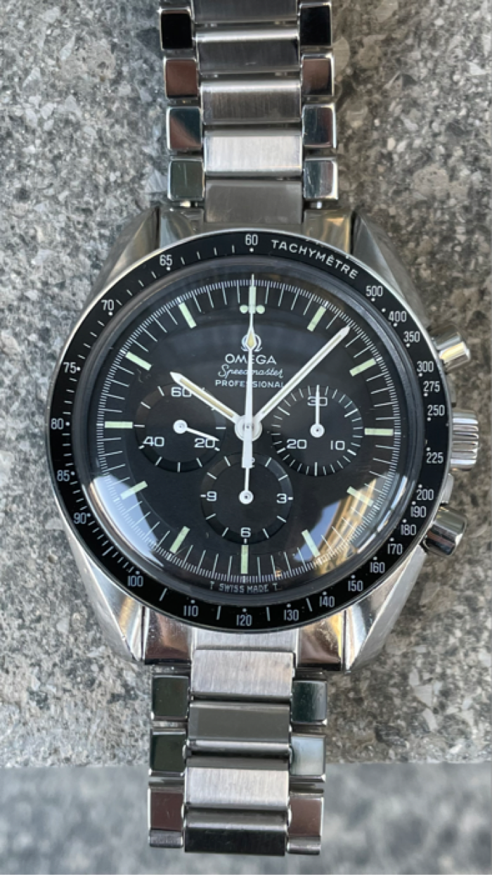

Hello - looks like a nice piece. You’ve identified the biggest flaw which is the bezel. The dial appears to be a step dial with nicely matching hands. The case also looks sharp as does the bracelet.
As for price, a nice condition ‘69 with a DON bezel recently sold for $9K on one of the boards, so I think you have that nailed as well.

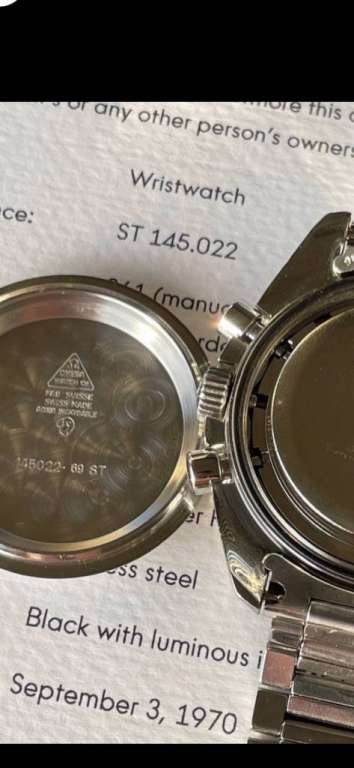

I would have to ask, I've got a bit of it on the following picture but he blurred the rest
Seems to be 30.59.1xxxx
24,836
55,256
This would probably have had a DNN or perhaps error bezel.

The price isn't crazy, especially with the bracelet, but I think you will have to judge for yourself how much you like the watch. TBH, I really can't get a good sense of the dial and case from those photos.
2,318
5,713
Hey @SickBuzzle
I would say pass on this example, and here are the reasons why:
1) It has a service bezel from the 1990's. By the serial number, this example should have a 220 Error DNN bezel. Price for a nice one of those is over $1,000 (and they are not easy to find).
2) It has service pushers.
3) The case has been polished.
4) The dial (although in great shape) has the Greener lume which is indeed correct for this period. However, not favorable with most collectors.

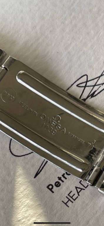

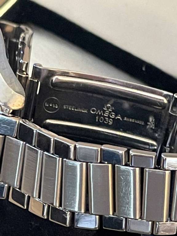

5) The bracelet is a mess. It is not a fully original 1039. If you look closely at the non-springy bracelet links you'll notice that they are solid (from an earlier 7077) and not folded like a true 1039 should be. Also if you look at the width of the last link where it meets the end links you'll see that it is 18mm (if not smaller). Also notice that a few of the solid links have the divots on the front (they should be on the back side of the link) which means that this is a bracelet that has been put together from scraps of other bracelets, and it has been amateurishly over polished. so if you thought this watch might be a great deal because it comes with a 1039/516's, then you should factor the value of the bracelet right out.
There are much better buys at this price range, especially if you figure the additional cost of a bezel (should you ever care to make it "all original" again).
I'd wait for an all correct and attractive example of a 145.022-69 to 145.022-74 (step dial) if I were you.
