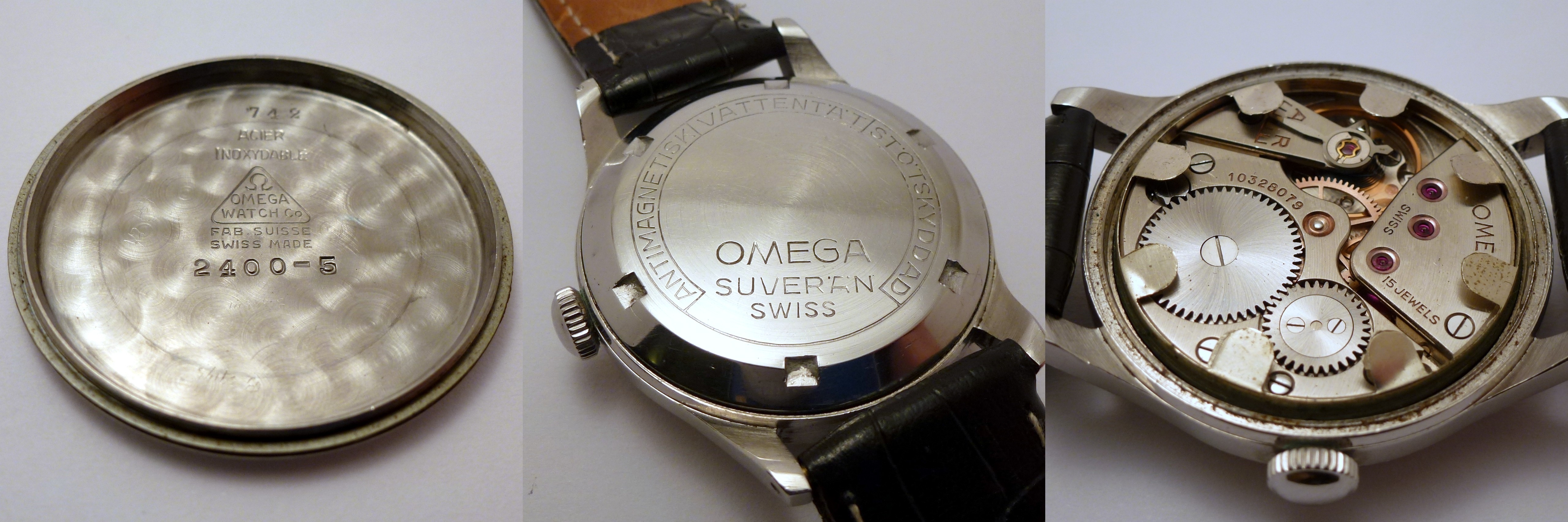

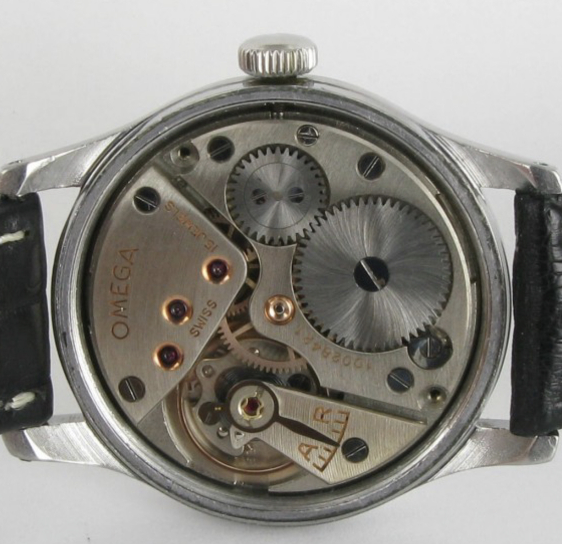

I have a paper that came along with it. It says the work number is 10028421 ref.2400-1 caliber 30t2pc.
In regards to the extract of the archives.. it costs 120 swissfrancs... damn expensive!
That is within the range of Suveräns, I believe.

It's a 70+ year old watch, so don't feel to anxious about not knowing the entire history of the watch; for all we know the dial, hands etc. could have been swapped at some point 😉

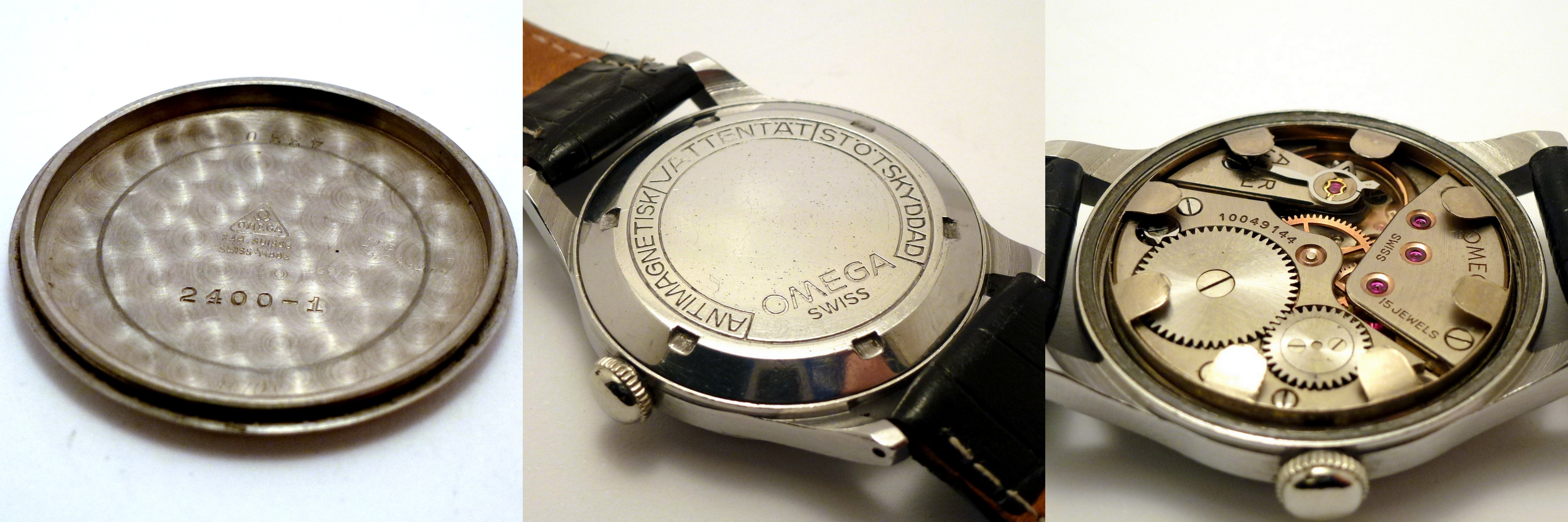

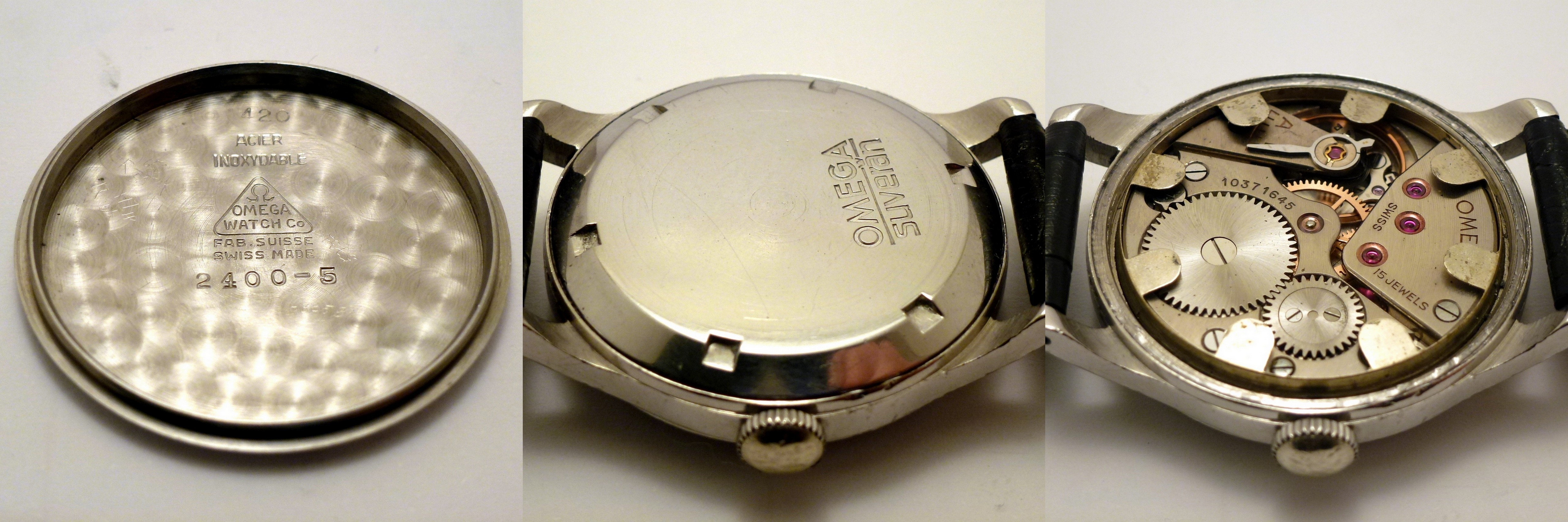

Could it be a 2383 with a fake case back?????

It is all original Suverän, with the non Suverän marked caseback. Correct dial and hands for a Suverän.
The prices differe a lot depending on the dial and condition, many are asking insane prices, does not mean they get them!
