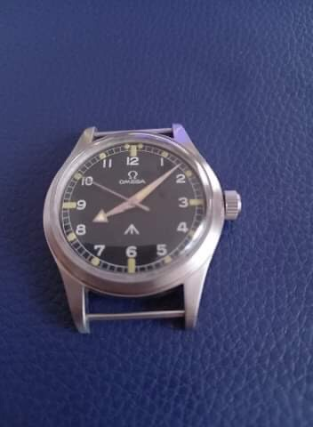

Hey guys. I am brand new to vintage watches and was hoping someone could point me in right direction. I am looking at this watch to buy. I would be grateful if someone could tell me if its the real deal and what should be looking to pay for it

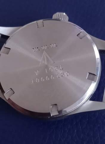

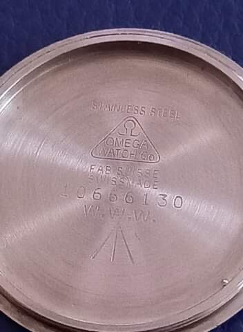

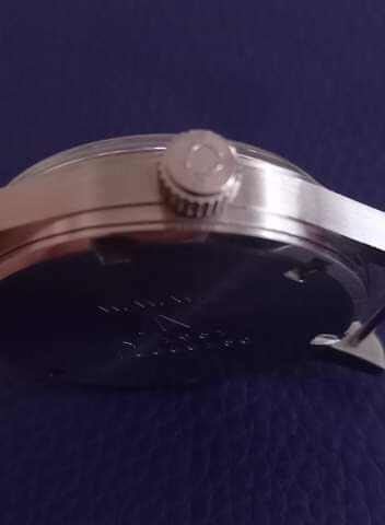

A bit early for Laser engraving of the outside case back..... Fantasy put together.

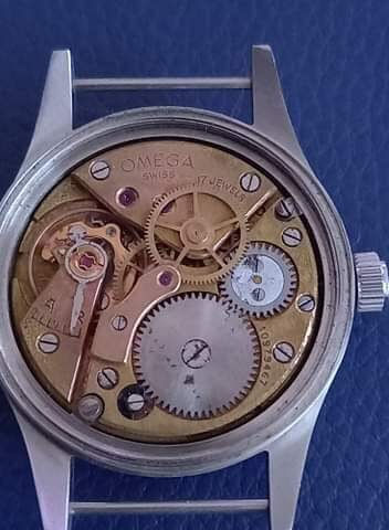

Thank you for the reply - what should be looking at paying for it? I have also notice it doesn't have a movement number?

It's a fake. Why would you buy it? It's good for a movement only

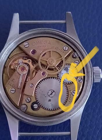

Caliber number is under the balance

Fake, the Omega W.W.W. has seconds at six. Movement is a 26x series Omega, the rest are all fake parts.
and it has a movement number (see below). If you mean the caliber reference, this will be visible behind the balance wheel.

welcome to OF, unfortunately its a fake
I would suggest spending some time reading posts in here for a while, then you would have a better idea what to look out for

It’s what we call a newbie trap. Walk away slowly don’t make eye contact....
3
Thank you all. I will listen and walk away from it
