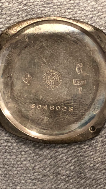

My dear Father passed away on Saturday, after an amazing 94 years, he was a kinder transport orphan from Vienna, and one of the only possessions that he managed to keep from the clutches of the murdering Nazi's was his Omega watch...

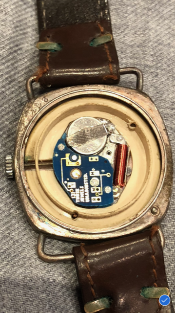

I won't go into the full details right now, but Dad wore his watch daily until probably the early 90's, when it stopped working. Unbeknown to me, my dear Sister, assisted my Dad in getting his watch repaired, I only discovered this last night when I opened the case....
I would be hugely grateful in any advice and assistance you could offer in my quest to find a suitable expert/watchmaker to return my most treasured Omega to its original spec.

Sorry to hear about your father passing. Well, whoever the watchmaker was that serviced it, replaced the original movement with a quartz movement. Either the movement was completely shot, or the watchmaker was lazy and took the easy way out and stuck a quartz movement in it. It may take some time to find a donor movement from the correct period.

This sort of conversion was a common thing - often an option given to customers who didn't want to spend the money to properly repair the original movement.

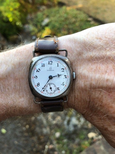

You will have to determine what the original movement was, find one, then get it running properly. But before you do that make sure that the watchmaker who did the conversion didn't glue the dial to the quartz movement. If they did it will be a challenge to get the quartz movement removed without damaging the dial - on the good side of things it appears that it might be an enamel dial, and they can take more in the way of solvents (to help release the glue) than a painted dial would.

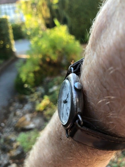

Looks like a silver case. Don't polish it, the tarnish won't damage it.
If you decide to wear it regularly, some of the tarnish will wear off & the whole watch will look amazing. I like the way silver tarnishes & then wears off naturally.
Reading the title again, I can see you knew that. Good luck.

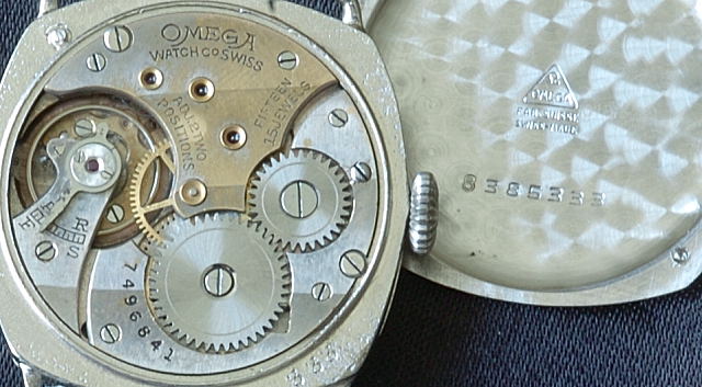

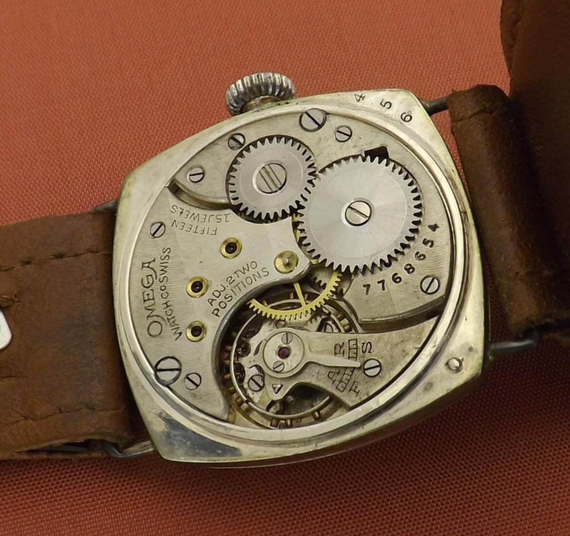

On to the watch... I’m guessing something like this should be inside:

Thank you, for some reason my pics seem to split my text up, so you probably didn't see that I know Simon Freese well, and send all of my 60's and 70's Omega's to him.. My question was who is the expert/go to Guy for 1920/30's

Thanks Al, yes it is an enamel dial. As mentioned in my replies above (maybe I didn't articulate my needs very well this am) I am not new to Omega's and have several Ed Whites and various others etc... What I have zero knowledge of, is 1920/30's pieces, and who the right person to speak to would be. Simon Freese or STS normally service my Omega's, maybe I should have just given them a call straight away.

So sorry to hear about your dad Rob. I know it’s not sudden, or unexpected, but still rubbish.
Thanks Chris, your thoughts are greatly appreciated in such a sad time, and you are right we have known this was slowly coming for a while now.. and 94 is a fantastic innings !
Yes thats is exactly the type of movement I am probably looking for, but am hoping that someone will tell me, that the only person to speak to about this era of Omega's is.....
