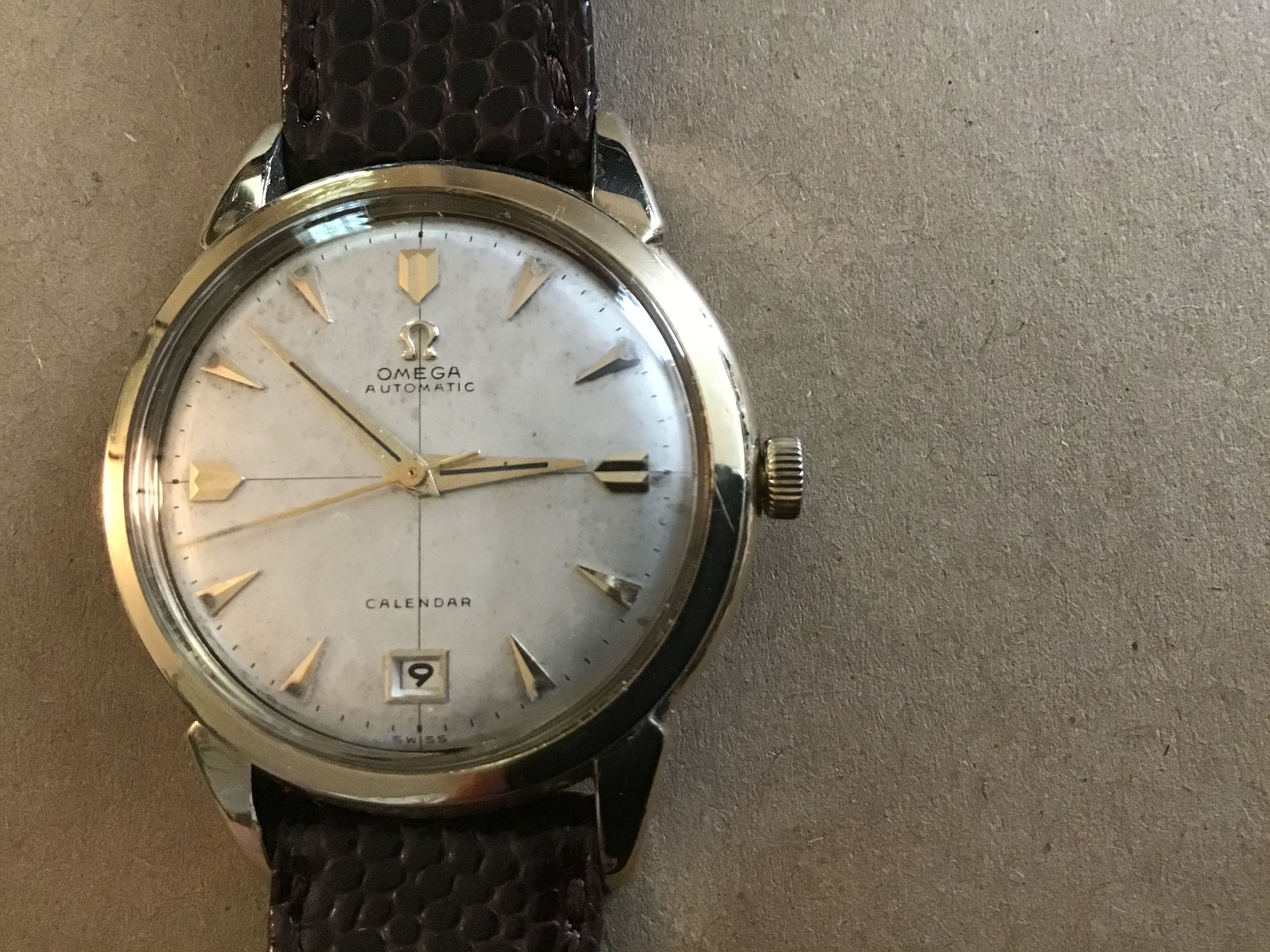

Greetings....needing expertise on this one. I only have these 2 pics currently. Has anyone seen these with no
Seamaster script but calendar script only? Is it even a Seamaster? Sorry, I’m nowhere close In order to get the case back off to do any investigation.....and being rather inexperienced, I would still need some help!
Thank you for your advice and opinions.
2,816
6,951

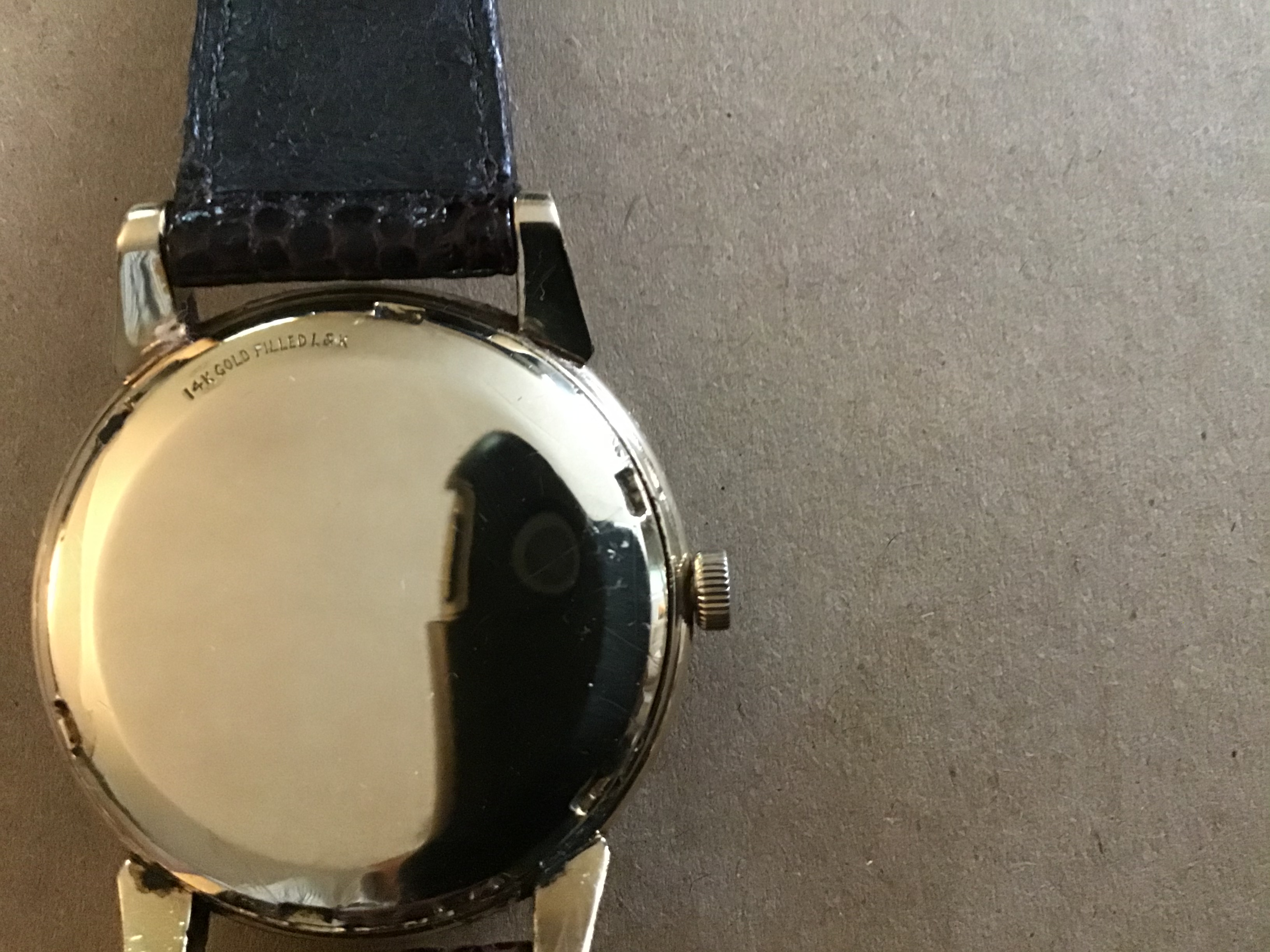

It’s a redial. I’m also confused by the case back as usually these gold capped 2627 references have steel case backs. Wrong crown too. I suspect it’s pieced together.
10,804
16,814
That caseback suggests local, probably USA manufacture.
