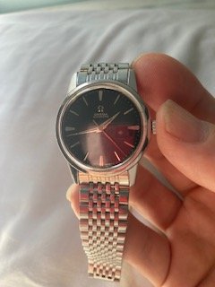

Can I have some advice on this vintage pre-Seamaster?
89
41

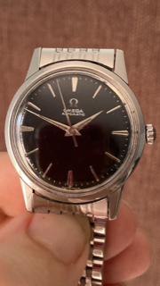

Hello, fellow Omega enthusiasts!

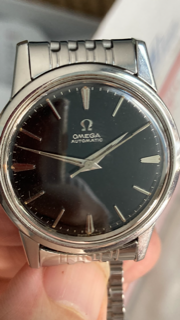

I just bought a Seamaster without the text on the dial (1958, Caliber Ω 470). I understand that these are getting pretty rare?
My dad always had a vintage Omega that I admired, and I'm happy to have discovered the joys of horology.
I purchased this one (offered $750 and the offer was accepted!). There are more pics on the eBay listing I provided, and I list the details below from the seller (who is a private collector).
I would appreciate any opinions, or thoughts if this was a good purchase decision. Much appreciated.
I do feel very good about it. I hope I made a good decision, as I'm still very much learning. Thank you in advance!

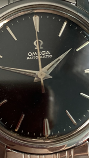

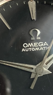

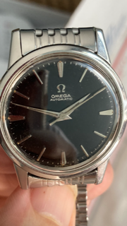

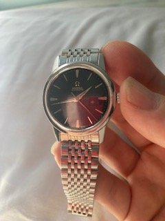

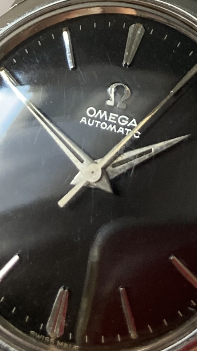

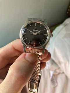

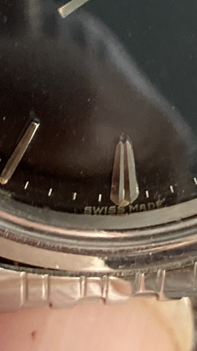

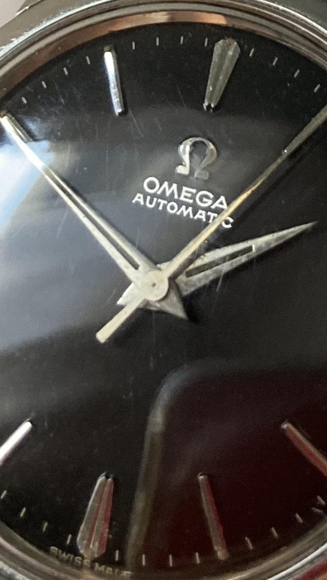

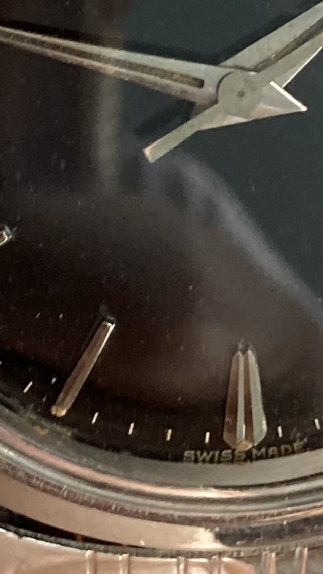

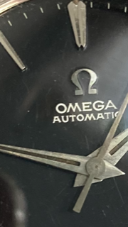

The dial could be ok, which is unusual, I'd need to see more photos. The case is too far gone for me, personally.
Edit: After a closer look, the dial appears to be repainted.

Someone can correct me, but I don’t think a watch from the 50s can really by a “pre-Seamaster” since that model was introduced in 1948.
It’s just an unmarked Seamaster dial (or repainted incorrectly, as someone suggested).

Yes, thanks everyone for looking and helping with this. I tried to cancel the order by writing the seller this morning at 5 am. At 11:30 am he told me he shipped it this morning so he can't cancel it now. Also, about the radium he says, "No radium." I think this is an admission that he knows it is not an original dial as described on the ebay listing. I guess when it was repainted they changed out the radium luminous? If its authentic and original it must have radium if dated from the late 50's, I assume.

Assuming it's a redail, would you say it's very nicely done, a good job? I know it significantly affects the value, but if nicely done can give life back to a watch. What would be a fair price range for this watch? Is $750 too much now? Looks like the radium was removed when it was redone so the watch might make for a nice daily wearer if the price is right. Maybe I can negotiate a better price since the listing was not correct. Or just return it. Trying to decide. Now I need a geiger counter since to test the watch (he says No radium). 😀

Yes I think 750 too much with repainted dial. I would return it

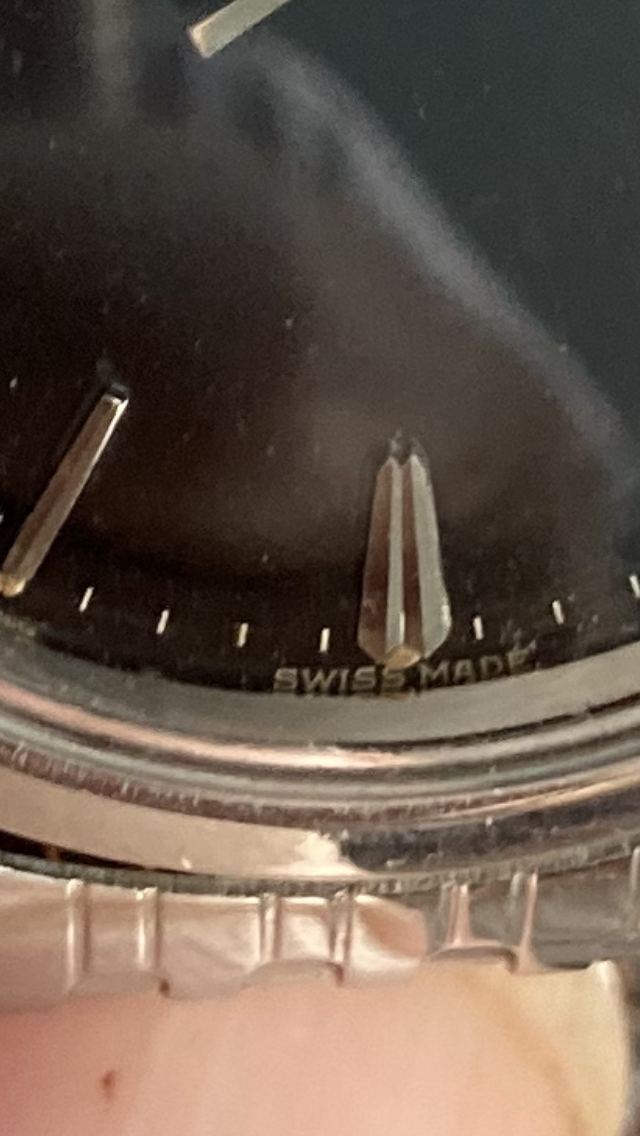

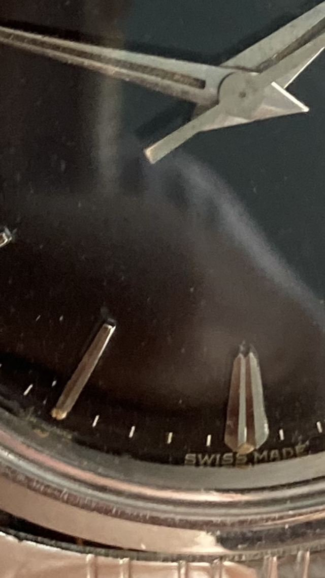

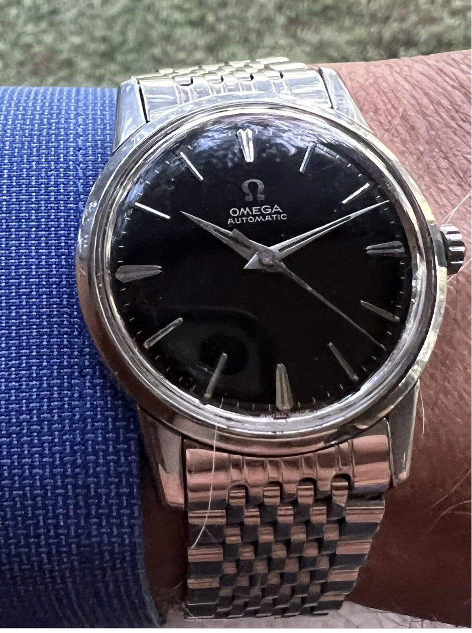

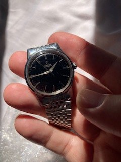

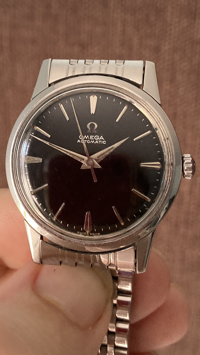

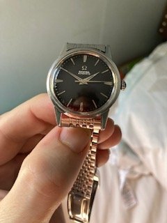

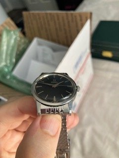

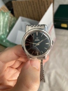

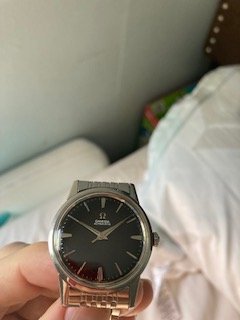

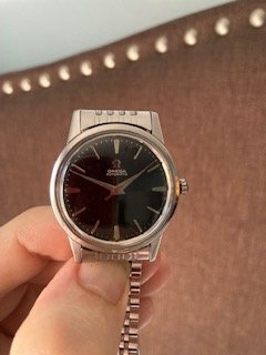

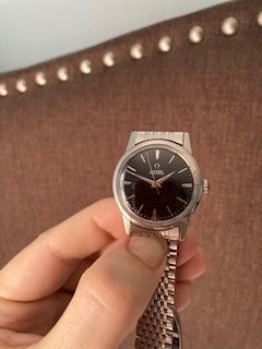

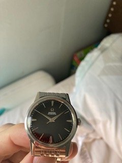

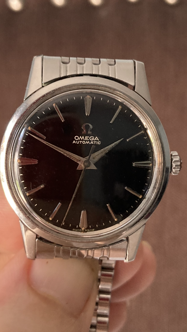

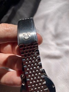

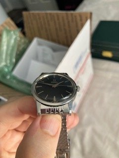

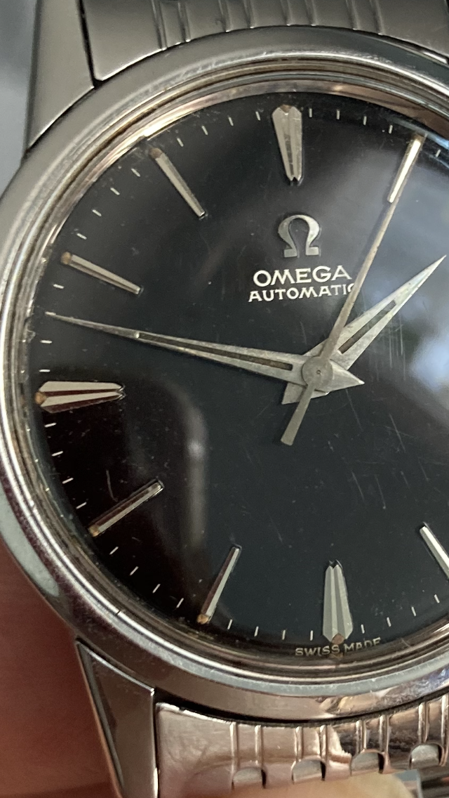

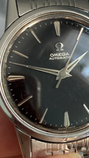

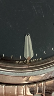

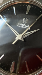

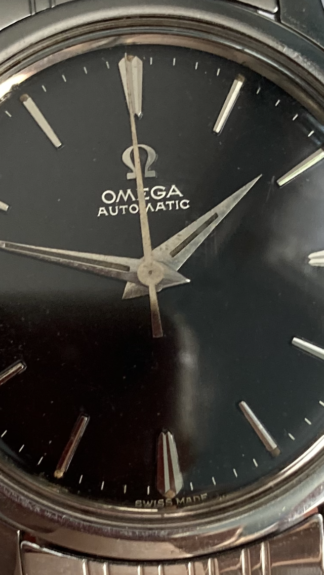

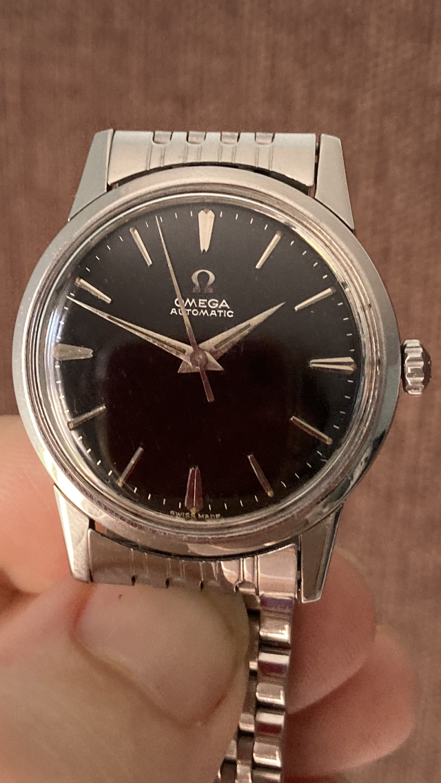

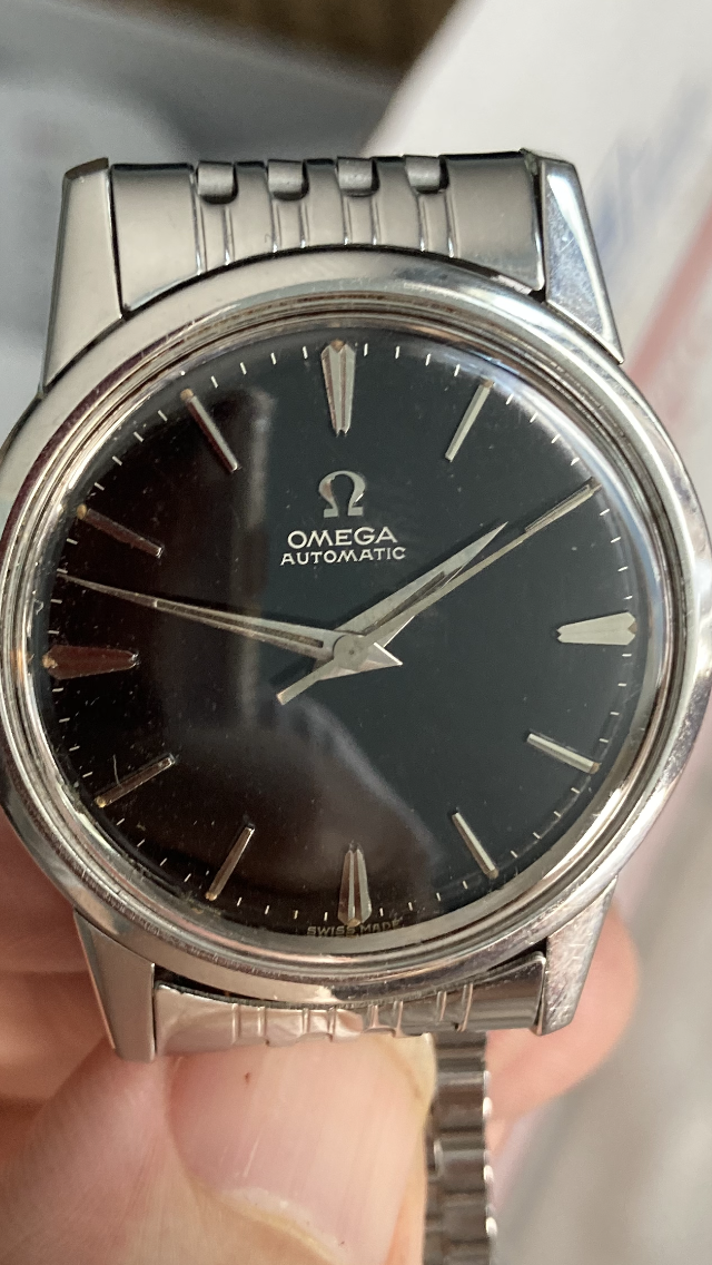

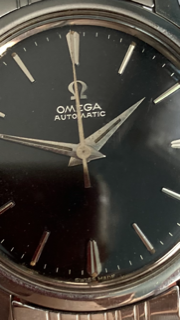

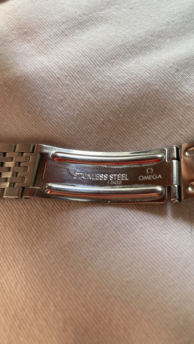

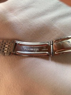

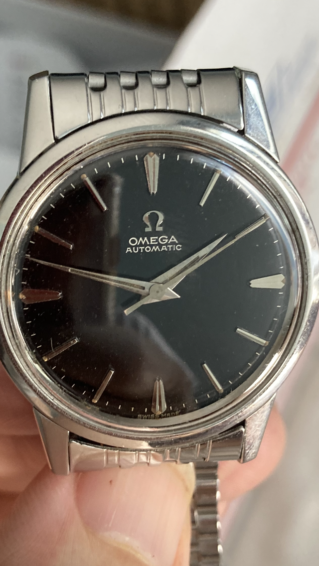

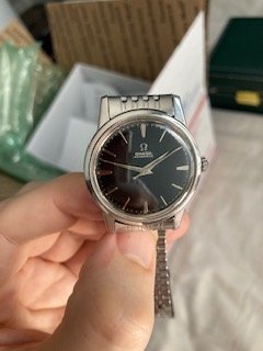

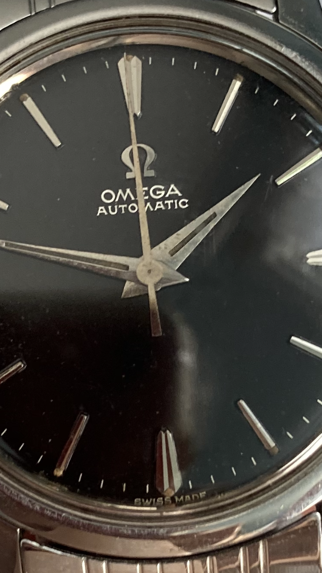

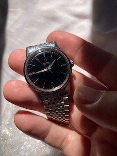

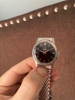

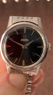

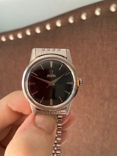

I got the watch today. I feels like and looks like a very nice watch. The dail is in too good of a condition to be original, though, but appears to be a well-done refinishing job. The bracelet does feel fake. I had trouble getting good pics with my phone camera but tried to take several to post here. I checked for radium with my GC and sure enough, that part is authentic and confirmed-- making it a pre-62 Omega without a doubt; the lume is gone so no glowing but the radium is quite active. 😀 Hopefully, some of these pictures are helpful. I am going to request a return. Thank you everyone for your educational assistance in my watch-learning journey.

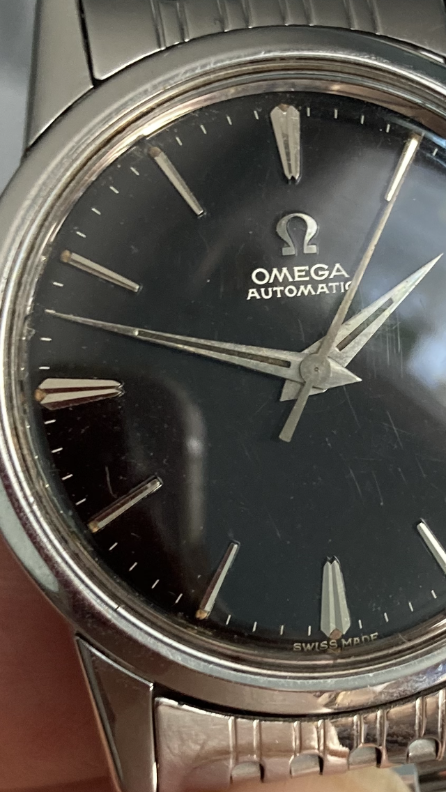

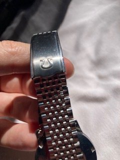

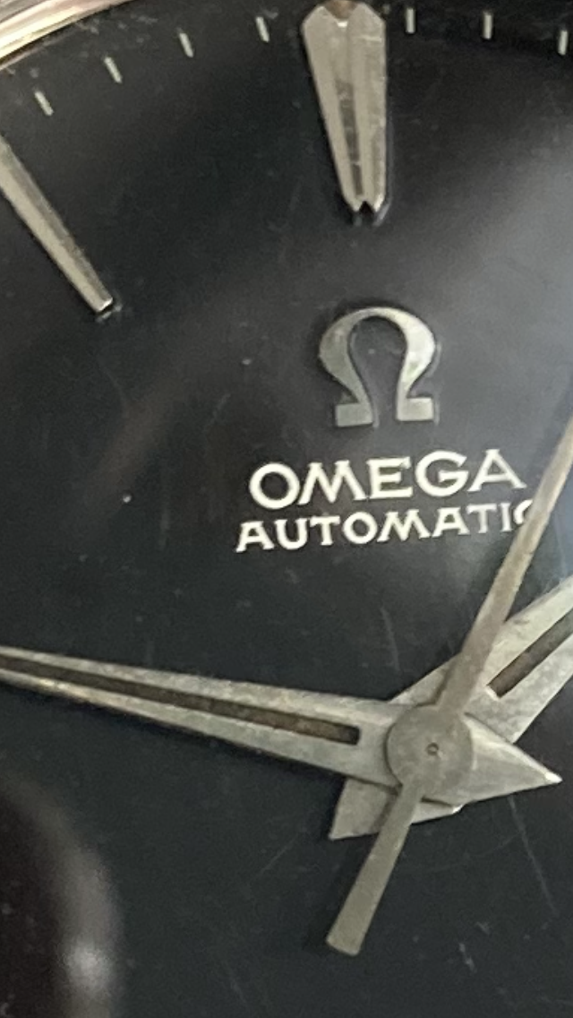

The bracelet is certainly fake but I think the dial might be original.
Have you got one front on, focussed picture of the dial?
4,857
12,285

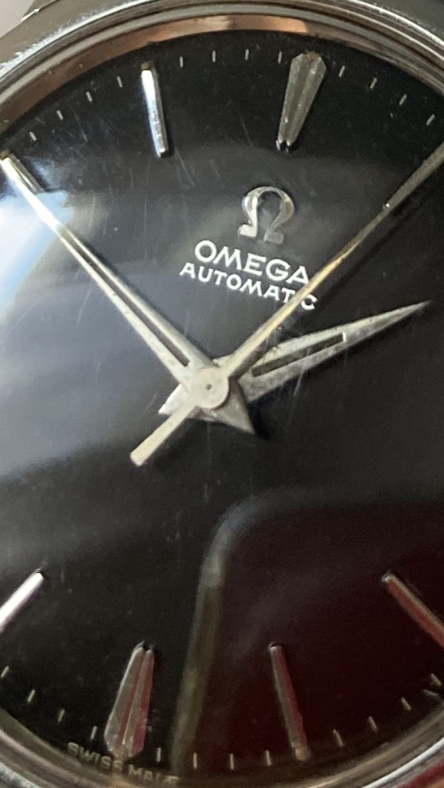

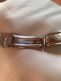

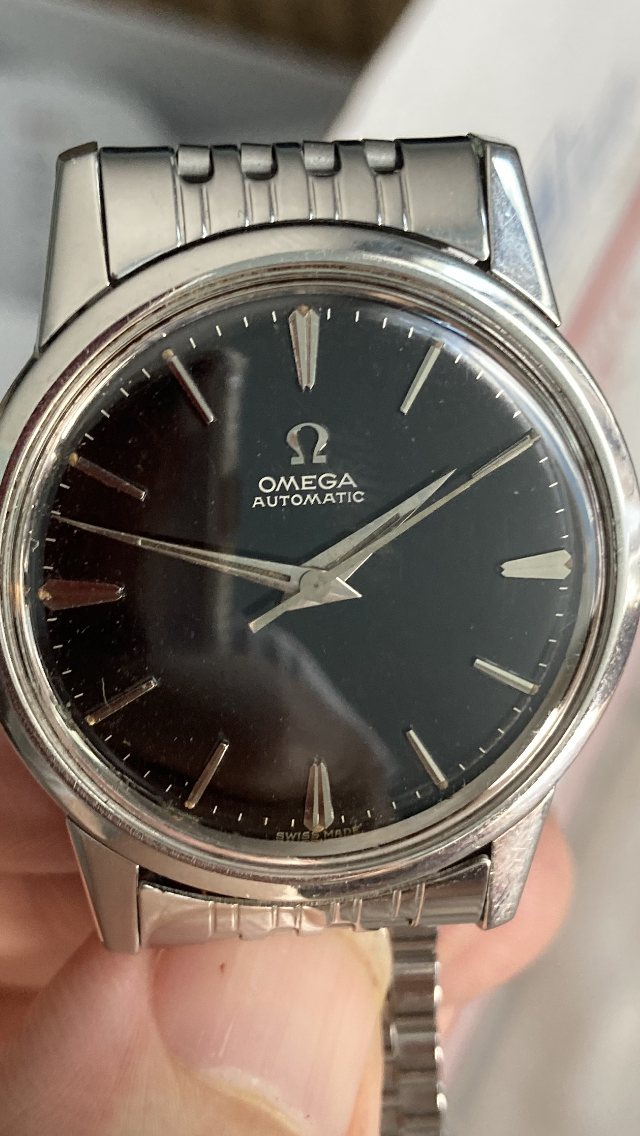

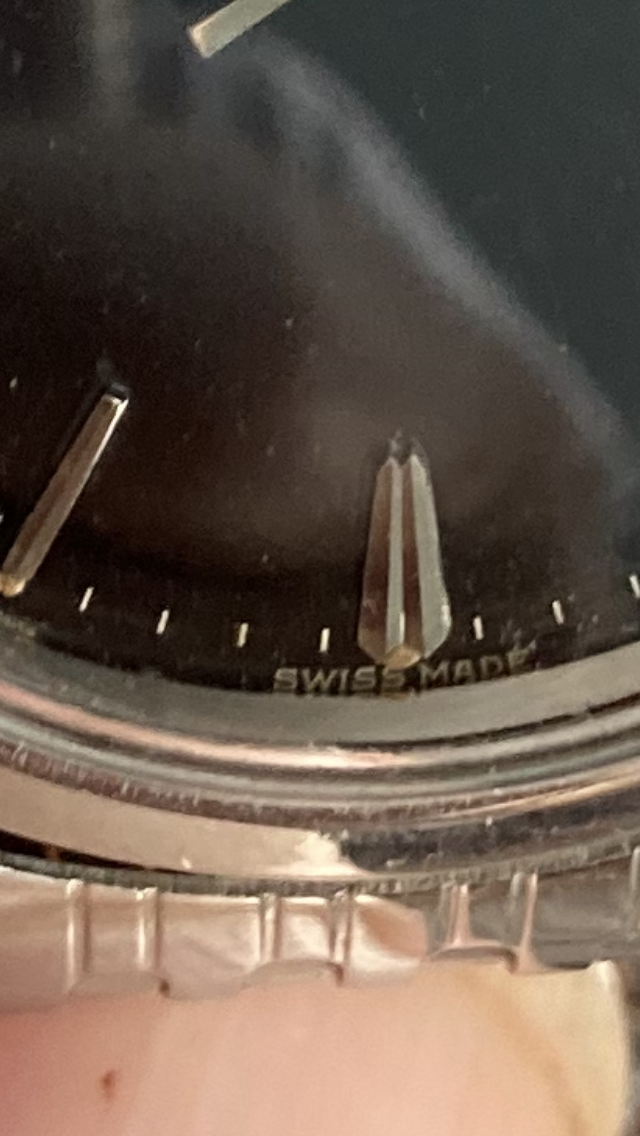

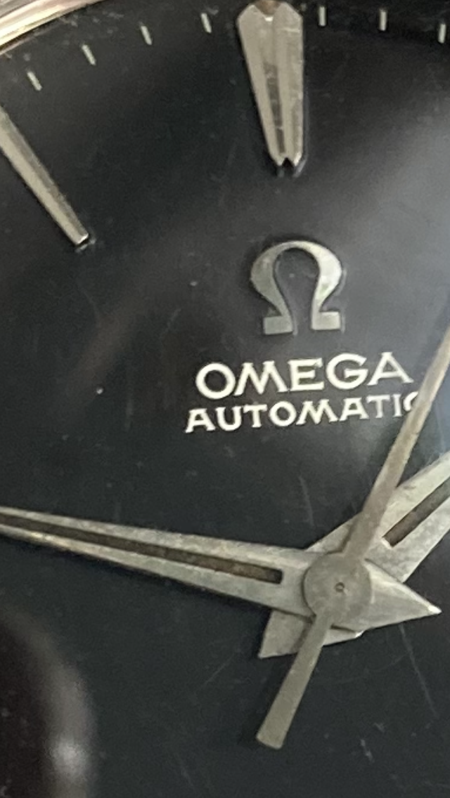

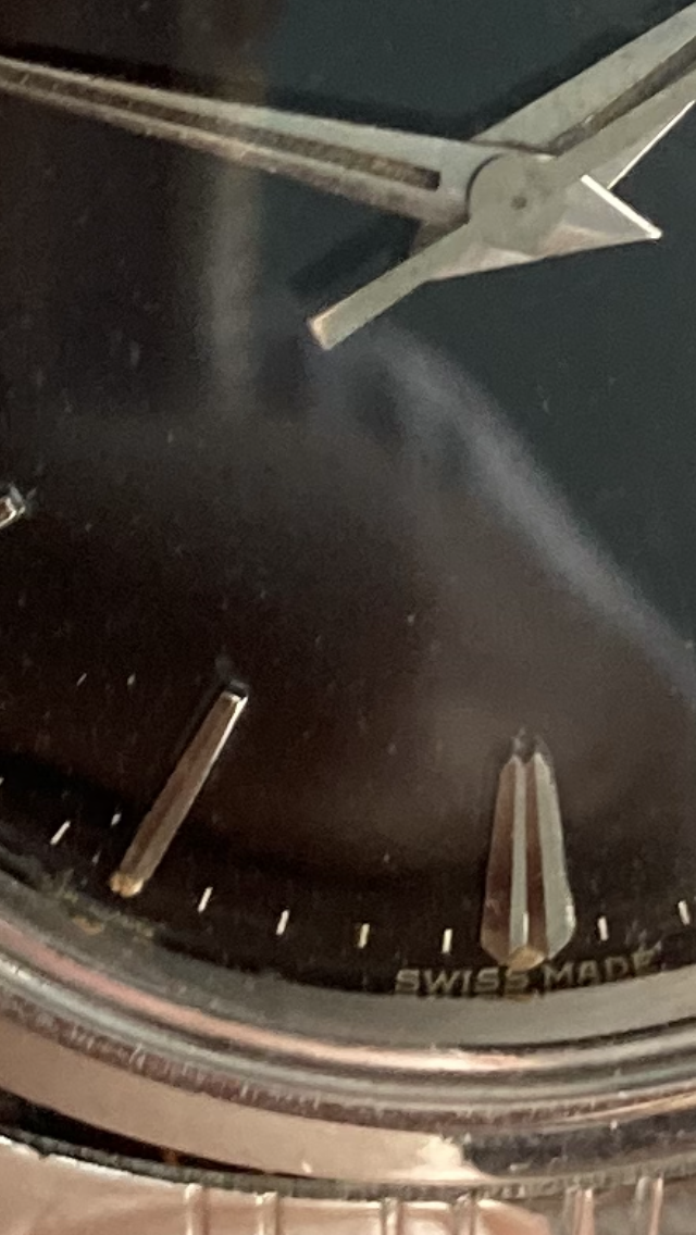

How do you conclude the bracelet is fake from those photos? I don't see any red flags in the low res images. I suspect it is original. If @Giovanni2023 has not handled a vintage bracelet before, it may seem fake because they are so lightweight. The image @Dan S shared pretty strongly shows the dial is repainted. Also, as @ConElPueblo once said about black-dialed Seamasters, "If the writing is white, it is probably shite."

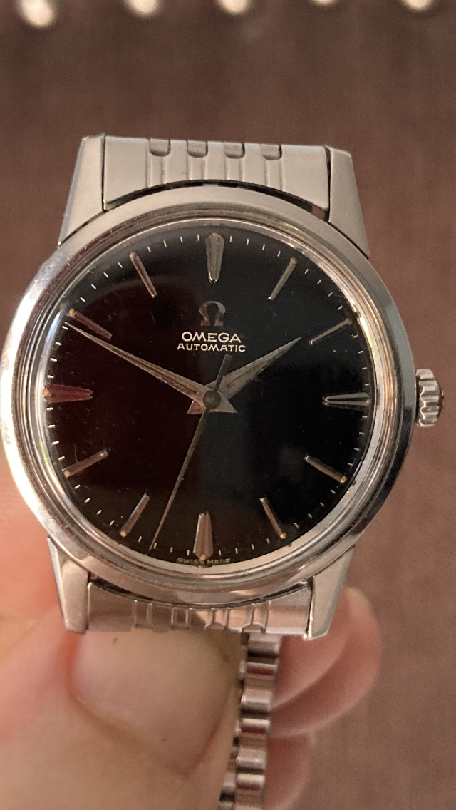

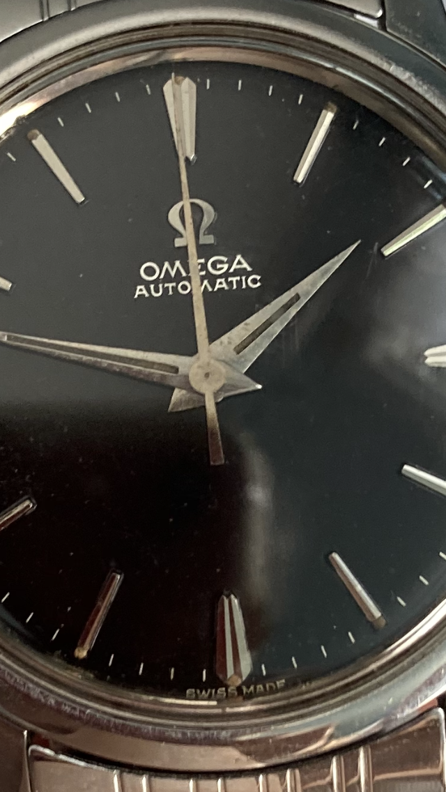

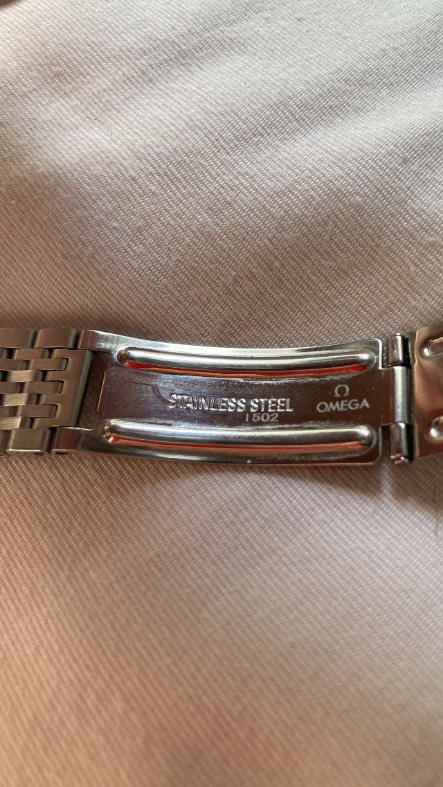

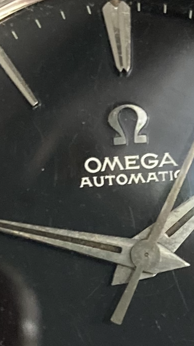

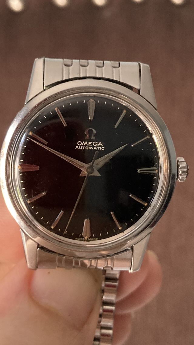

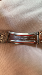

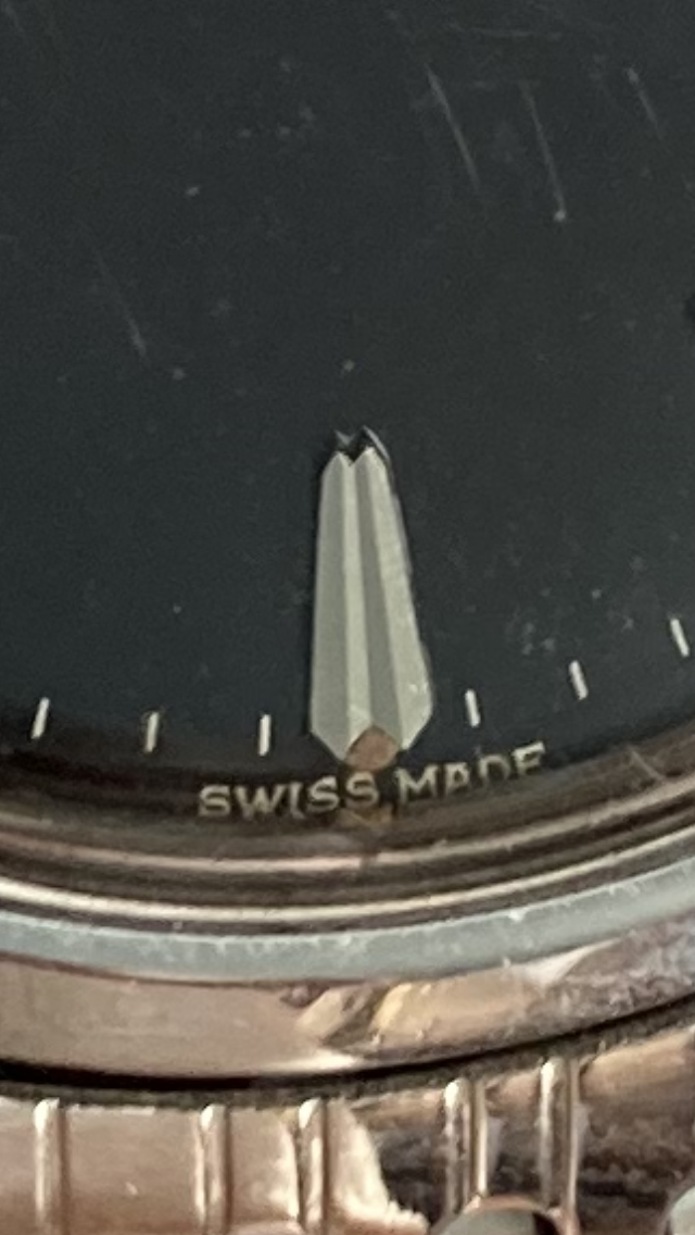

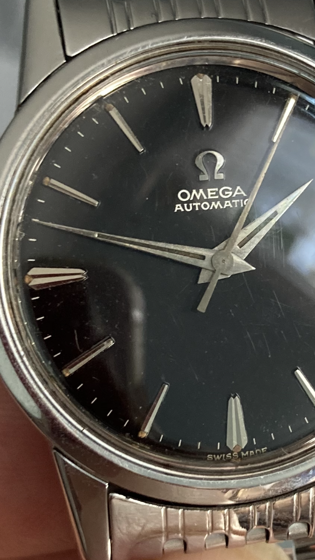

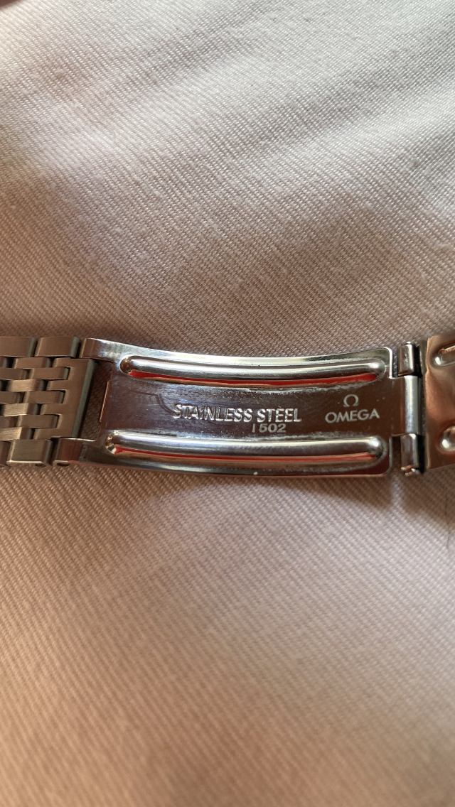

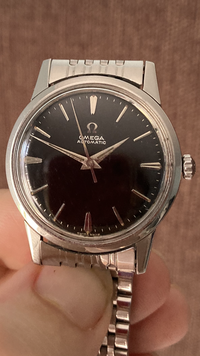

Those pics are low resolution. Here are the high-resolution pictures which should make it easier to see.
The bracelets 100% junk.
Every element, the clasp, claps ‘engraving’, links all wrong.
4,857
12,285
I agree now, looking at the better pictures.
4,857
12,285

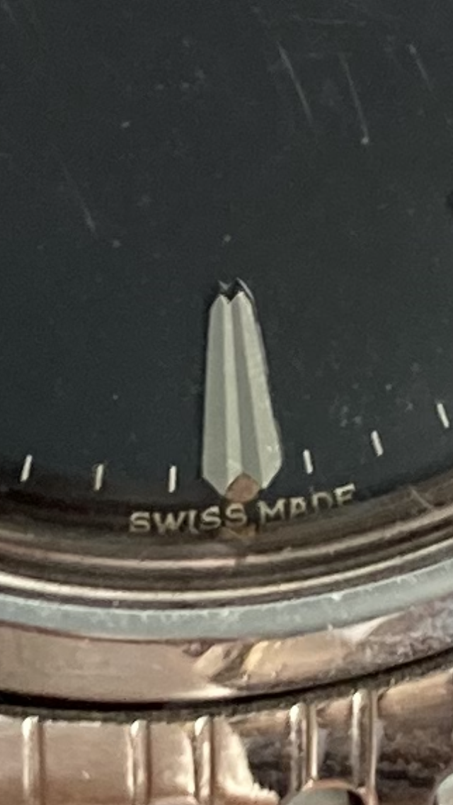

I still think the dial is original btw
Maybe so, perhaps others will weigh in.
24,850
55,293

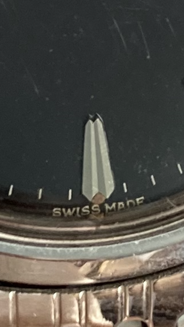

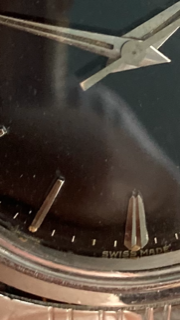

The printing looks pretty good. My concern is mainly the apparent paint "shadow" around all of the markers which looks like it could be from paint pooling/climbing the sides of the markers. That aspect looks unusual to me for an original dial, but it's obviously not easy to rule out possible artifacts in the photos.

Just an update. So I went back and forth with the seller who didn't want to accept the return, and offered me $150 discount. Ultimately he did agree to accept the return. Luckily eBay has good policies that compell this. The seller said he took it to a shop to verify that it was the original dial before listing it. If it is original it is in an unusually pristine condition for its age. It looks very nice on the wrist. A learning experience for me. I'll be less hasty and do more research/due diligence before buying in the future.
2,816
6,951
I also think the dial is original, especially since it registers on a Geiger counter.. unlikely it would be relumed with radium (that’s assuming it’s not all from the hands of course).
