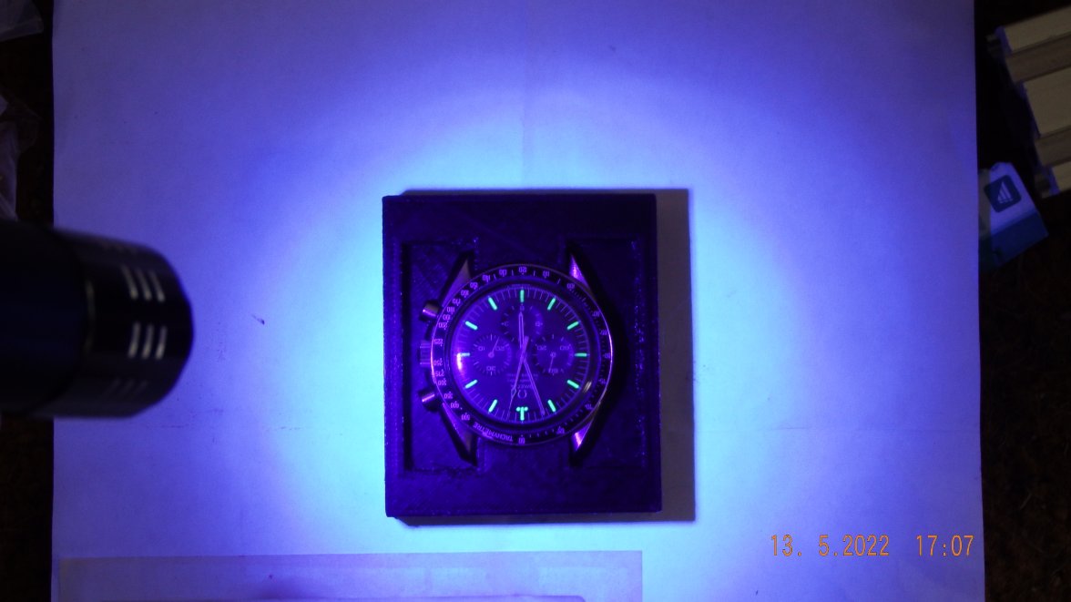

The hands really annoy me, almost as much as the o ring, but I am not a collector! If it was up to me I would want them bright, and glow in the dark.
Not much action under UV..
