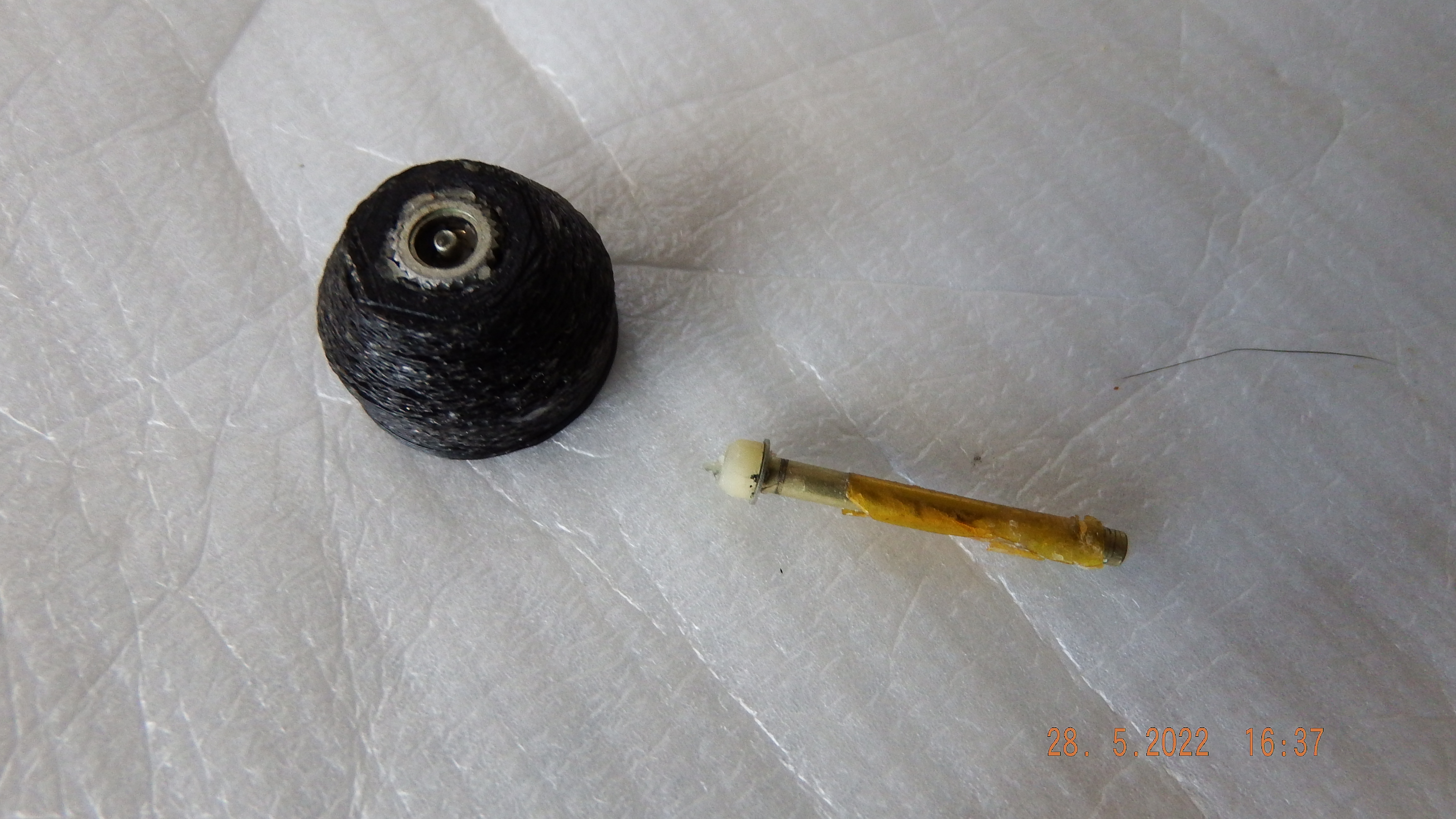

Any thoughts on an o ring grease? I have always used Apiezon, but that is old time, high vacuum, not watches.

Good luck - if you really dunked your watch in a fuel tank then anything could have happened, especially to the dial, hands and seals (they look okay in your photos).
Get it to Simon Freese and I'm sure he will be able to sort anything he finds. We look at these parts under a high powered microscope to check for wear and rust and polish/burnish/replace parts as needed to be able to provide a warranty. Whatever the bill, it will be terrific to have your watch running well and usable again after so many years👍.

I am hopeful our luck will hold on the old rust front. As it was nominally waterproof, it never filled with sea water, or petrol, just got
a bit of a whiff of both.

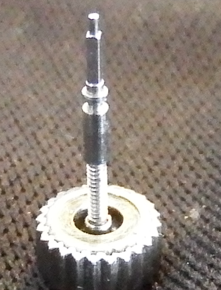

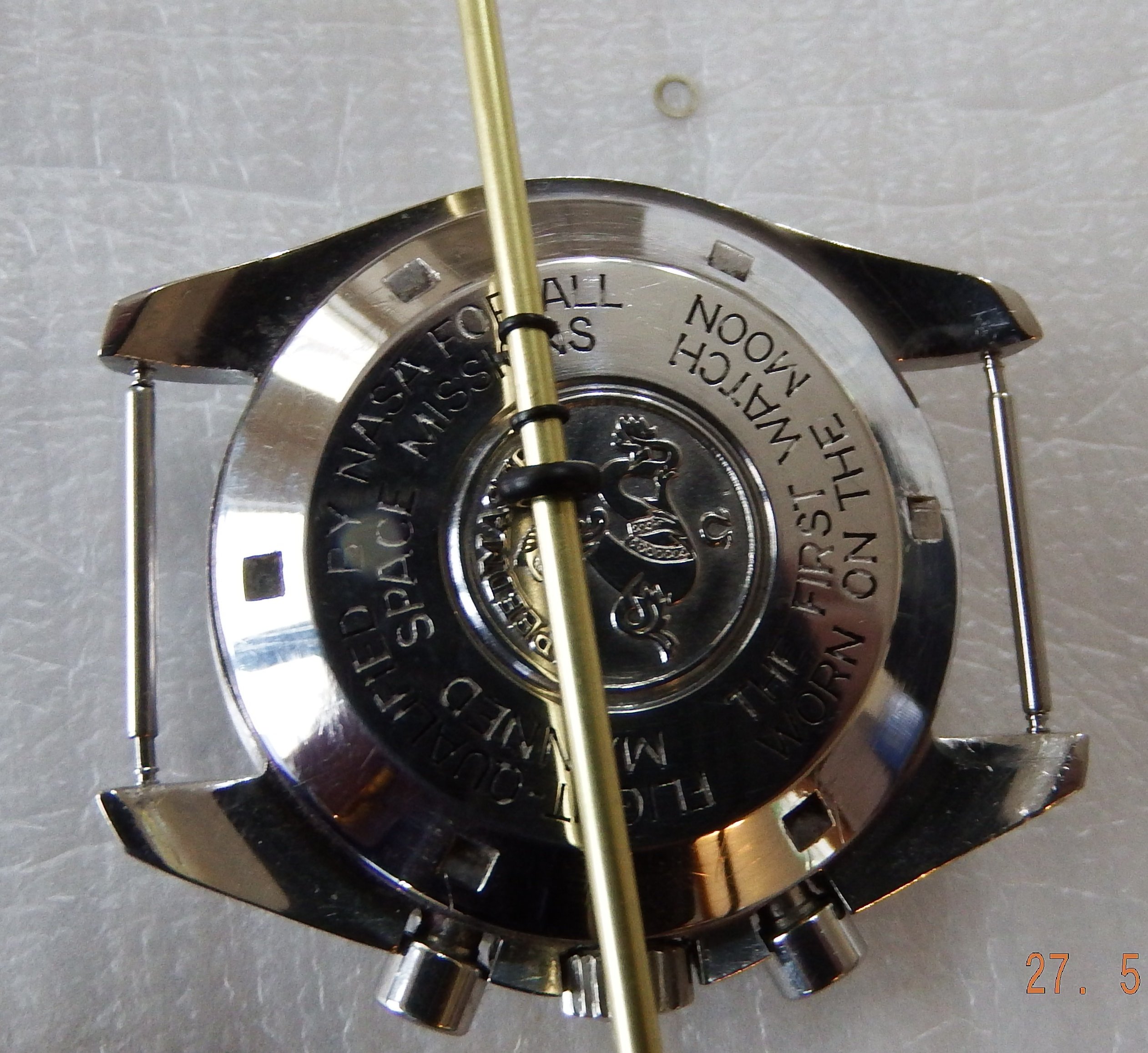

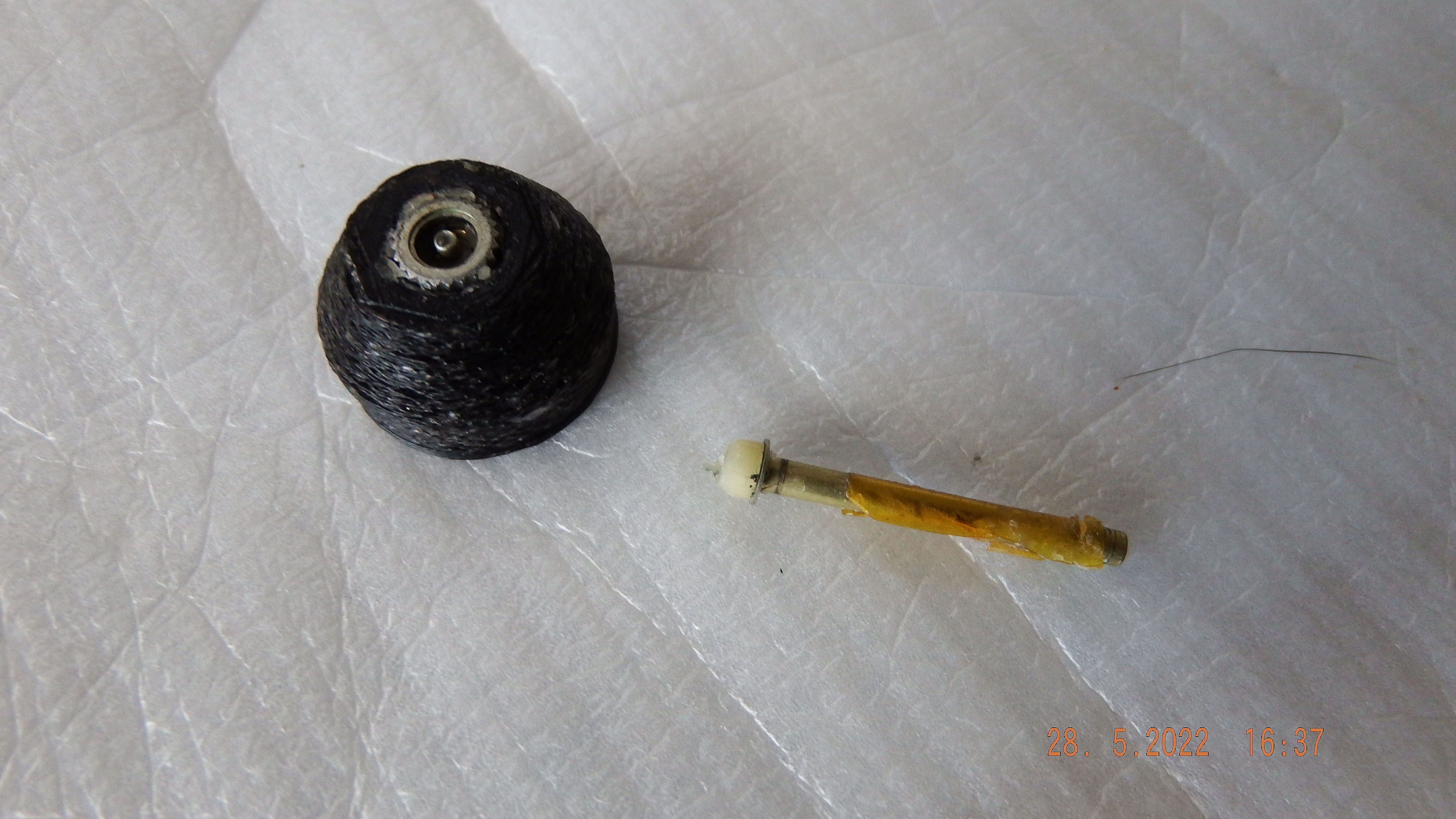

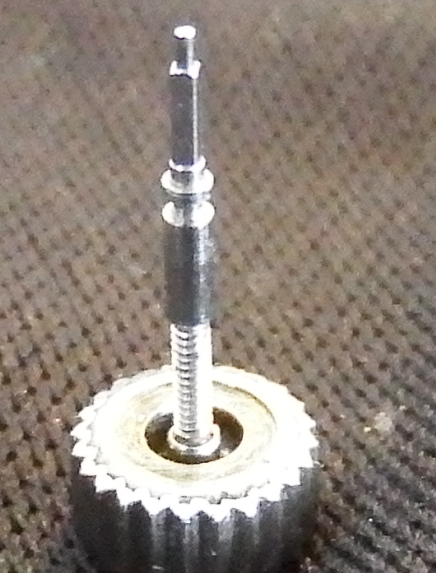

The pusher o rings are quite small, even compared to the crown o ring. The old ones were surprisingly intact, but knackered/pinched, shown together with a new crown o ring, which is not exactly huge.
Edit: The crown seal is not that big in cs for my crown, I was confused by The Internet(tm).

You can buy selections of these small O rings for the pushers from most watchmaker suppliers. I have fitted them many times but, why not ask the person servicing the watch to do that? It's probable that they will have a selection in stock and we'd normally replace anything like this that was needed for water resistance and a warranty.
I've said before that I doubt you will have much joy replacing the crown seal and ending with a reliable seal. Just buy a new crown, or ask the watchmaker to supply one. Of course, it's up to you.
Good luck, Chris

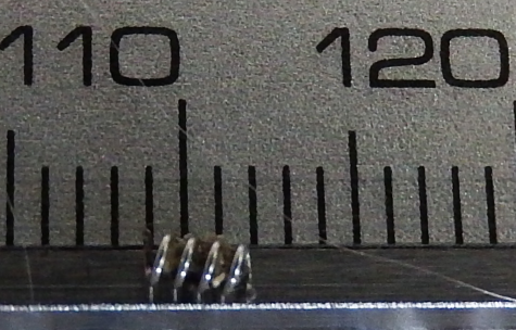

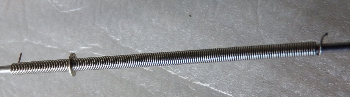

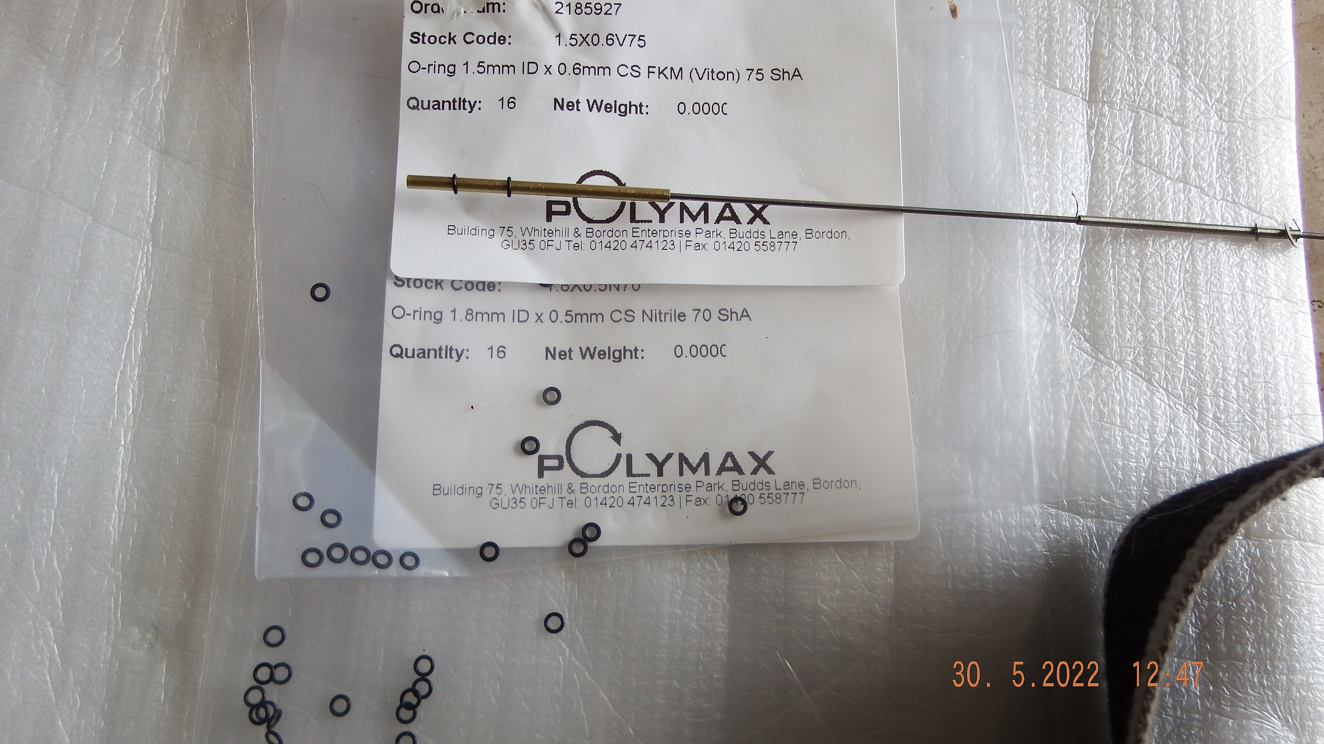

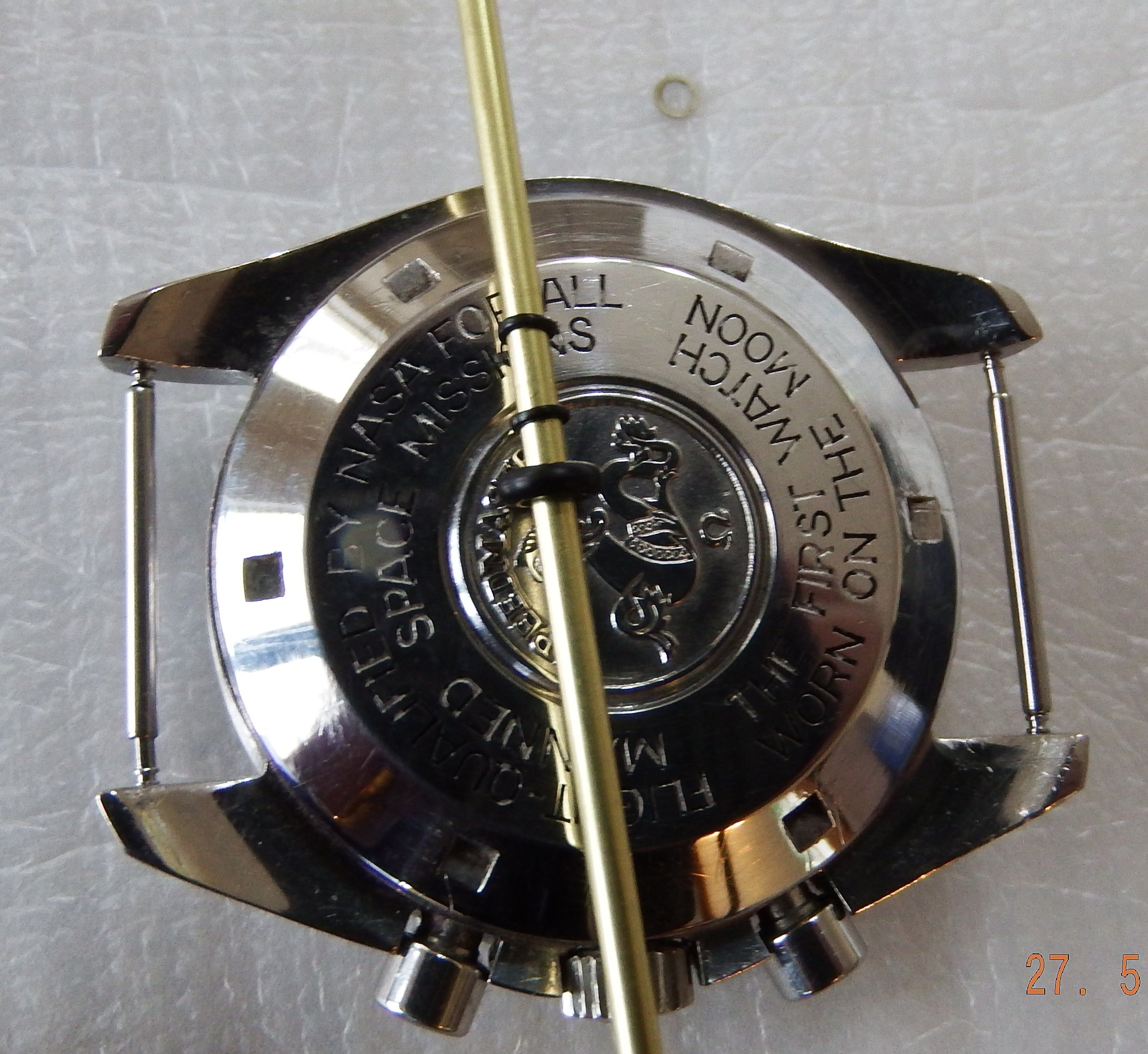

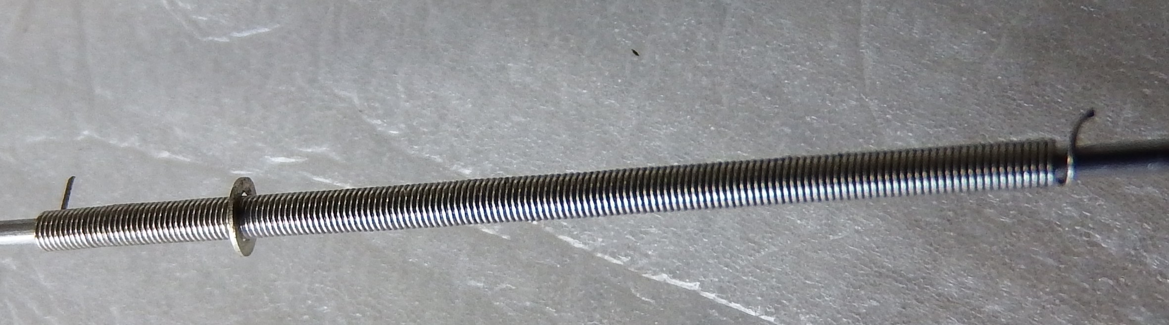

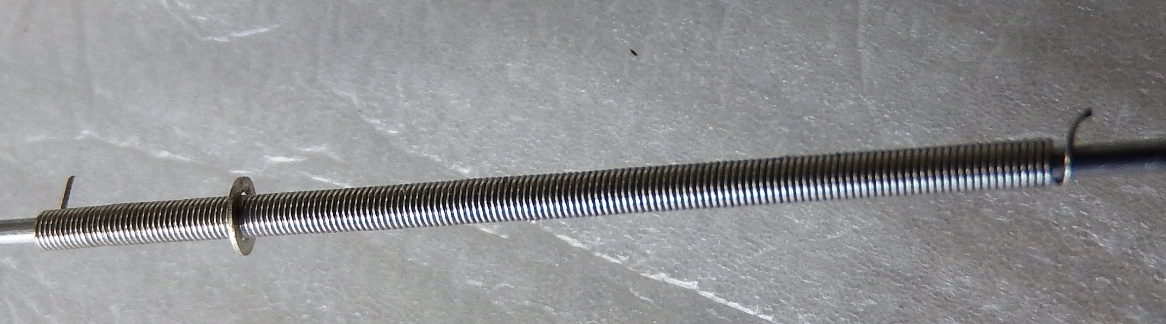

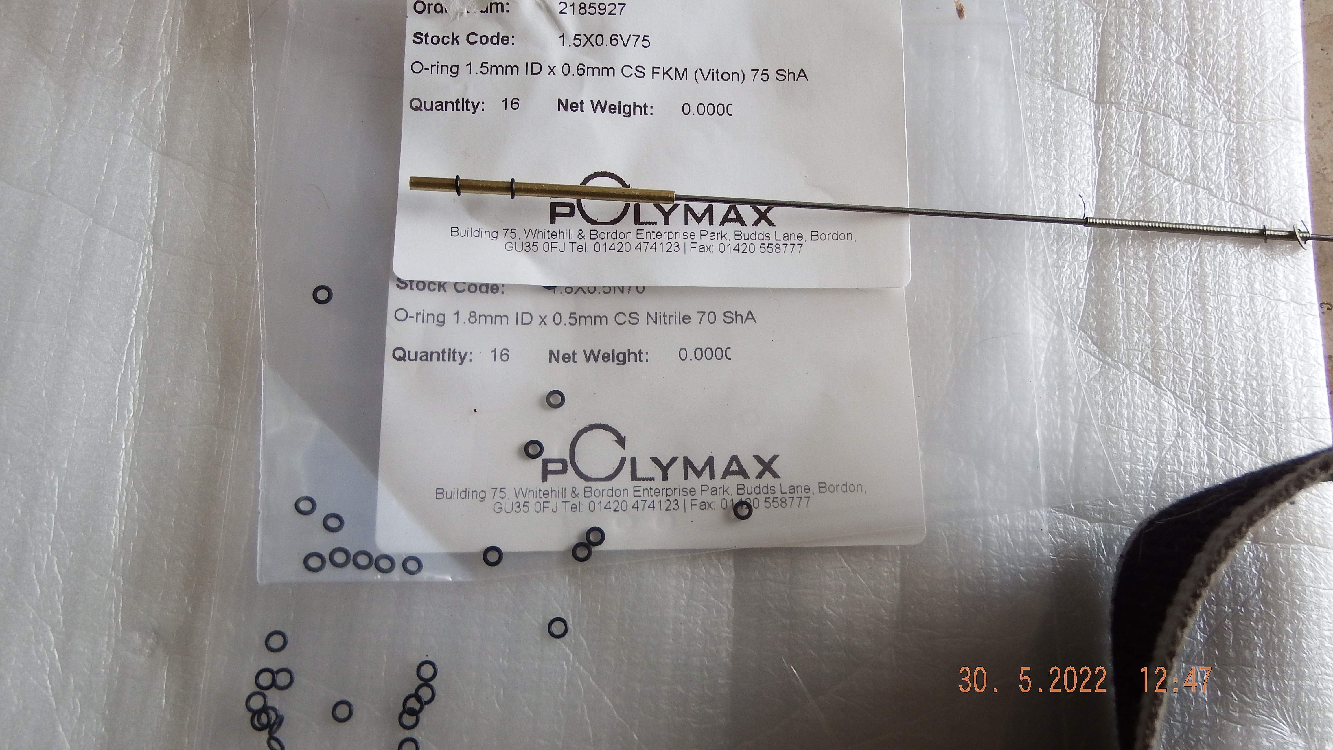

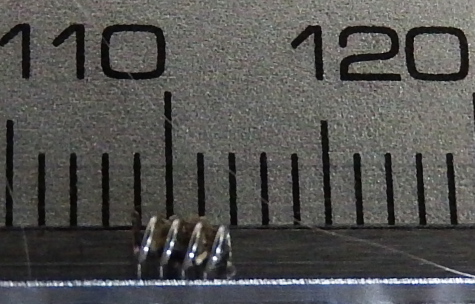

Thanks for the advice, much appreciated.. It is my risk. It is going to end up waterproof, even if it loses value as a result. I have a few (32x, min.order £10 ) pusher o ring seals, in two sizes, on order. The ones you recommended on The Internet(tm), #10 seem a bit on the small side in CS to me, but in any case could not find any of that size apart from Cousins, who only do wholesale.
I have a cunning plan for the crown, but we will see.. I intend to make 4 metres of spring (wire length), if anybody needs, ahem, a bit. I lost the spring, and then found it again in the carpet!. In the meantime I ordered the wire and mandrill.
The original (Omega?) spring is a bit rough on the ends IMO, and could damage the o ring.
ps. It seems a bit amateurish to double up on the o ring, if just the one leaves something to be desired.
pps. Like a Beagle, they make a bid for freedom at every opportunity, but at least my version has passed the week of warm seawater test. 😀
Edited much!
Should keep me in springs for a while.

Which one do you fancy, given my limited choice, and how many to stuff down the hole of the pusher of an old moonwatch?

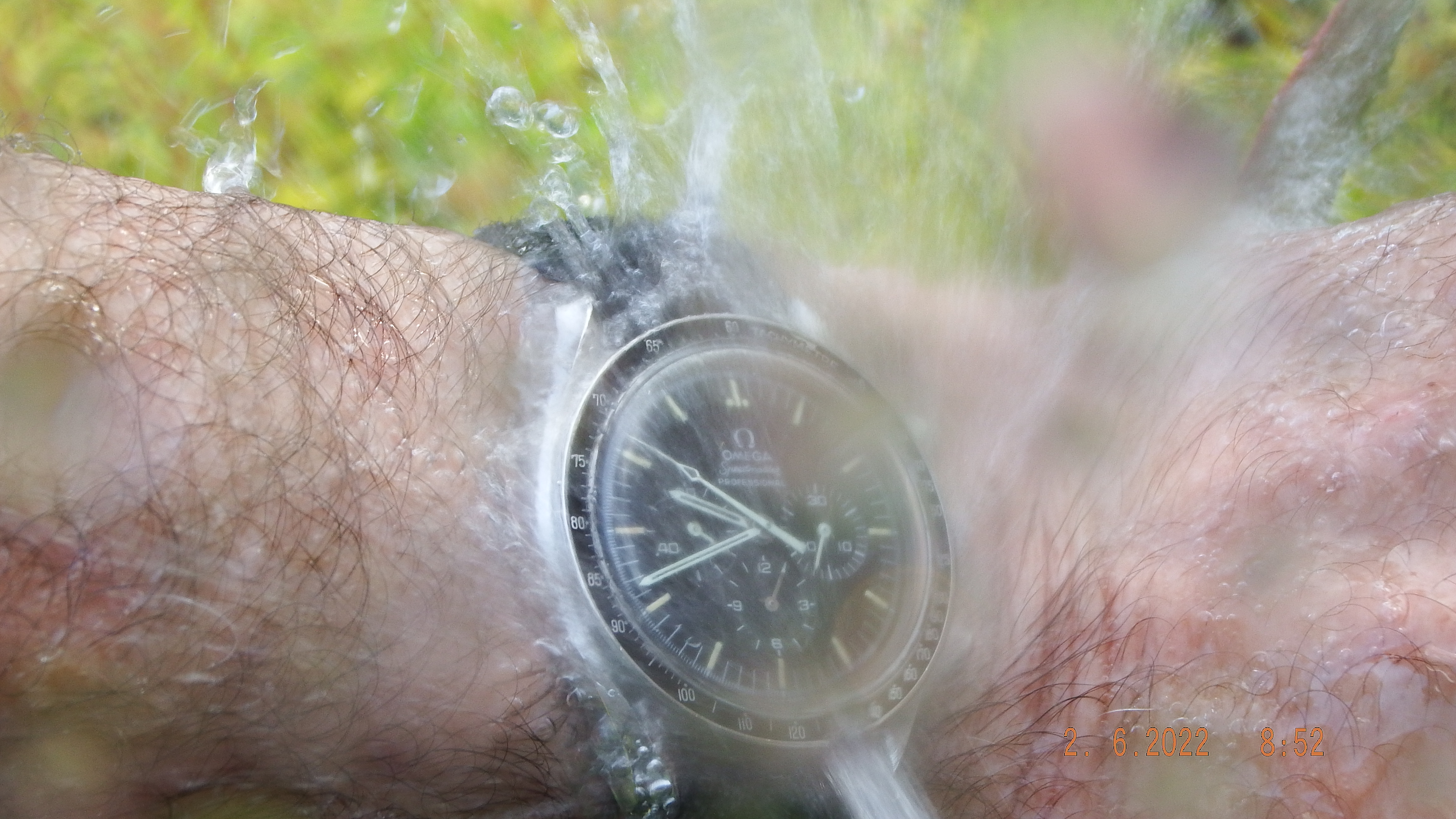

Good enough for what I need these days. New viton o rings fitted to back, original pushers, and crown, using Fomblin UT18 grease (as recommended by you know who 😀)
