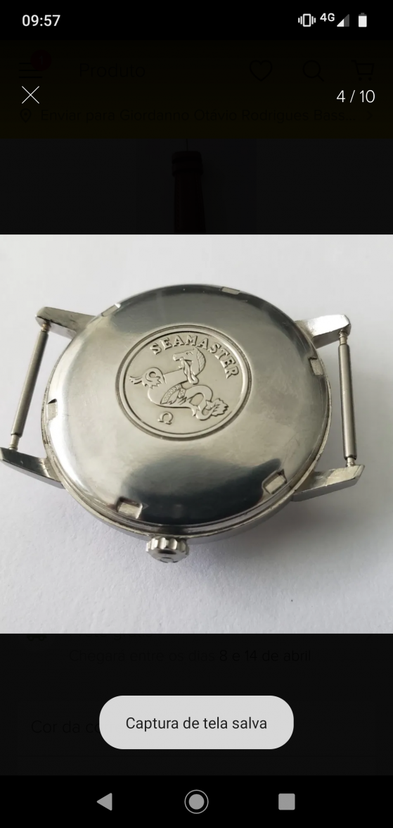

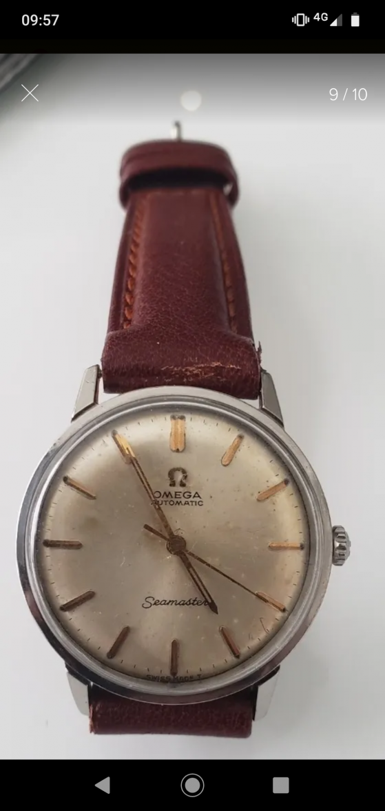

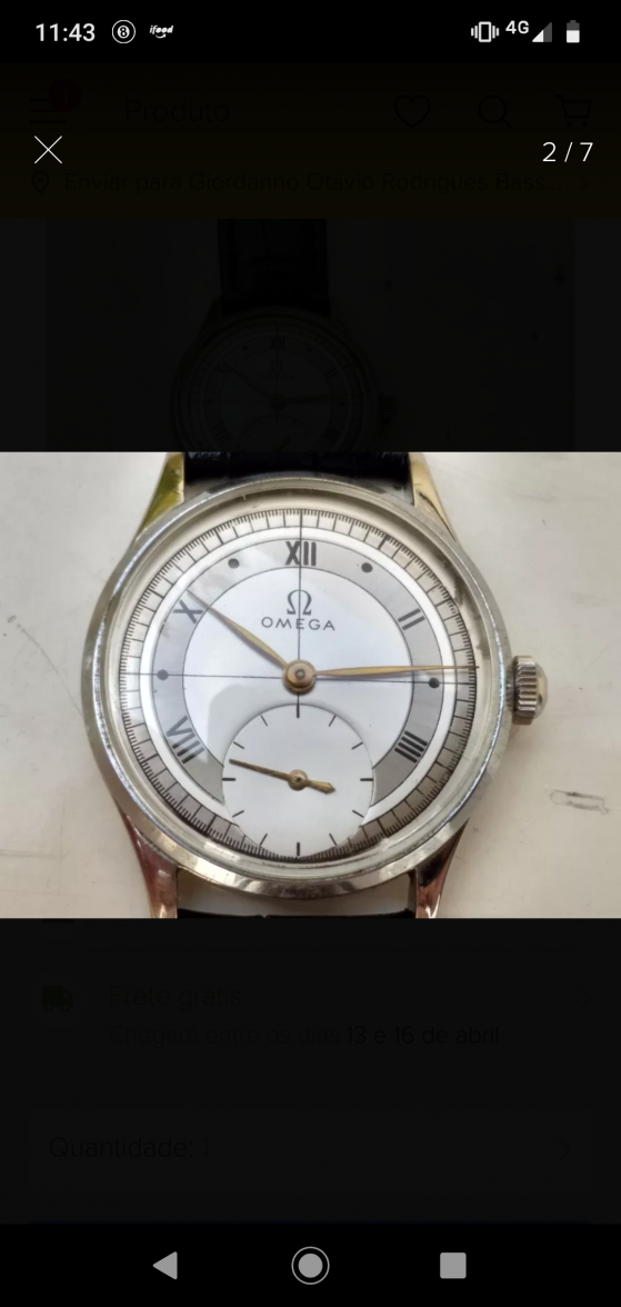

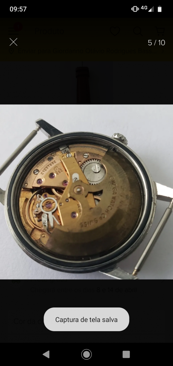

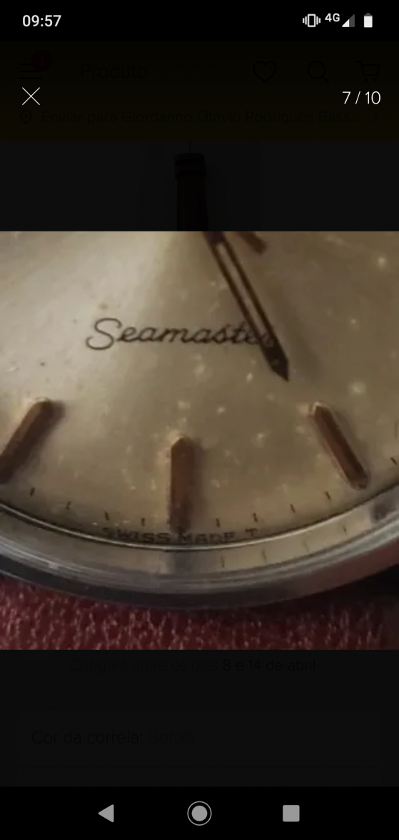

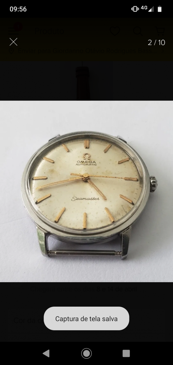

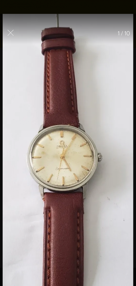

I'm new to the forum and have little knowledge of watches. I would like to know if this watch is original, and if possible its year.
Does it have something incorrect?
Thank you very much.

How much is it? Unless it's really cheap I would look for a better example.

Hi Giordanno and welcome here!
Looks correct at first sight but is in not so good condtion.
What is the asking price?

267 dollars, what do you think? It's worth it?

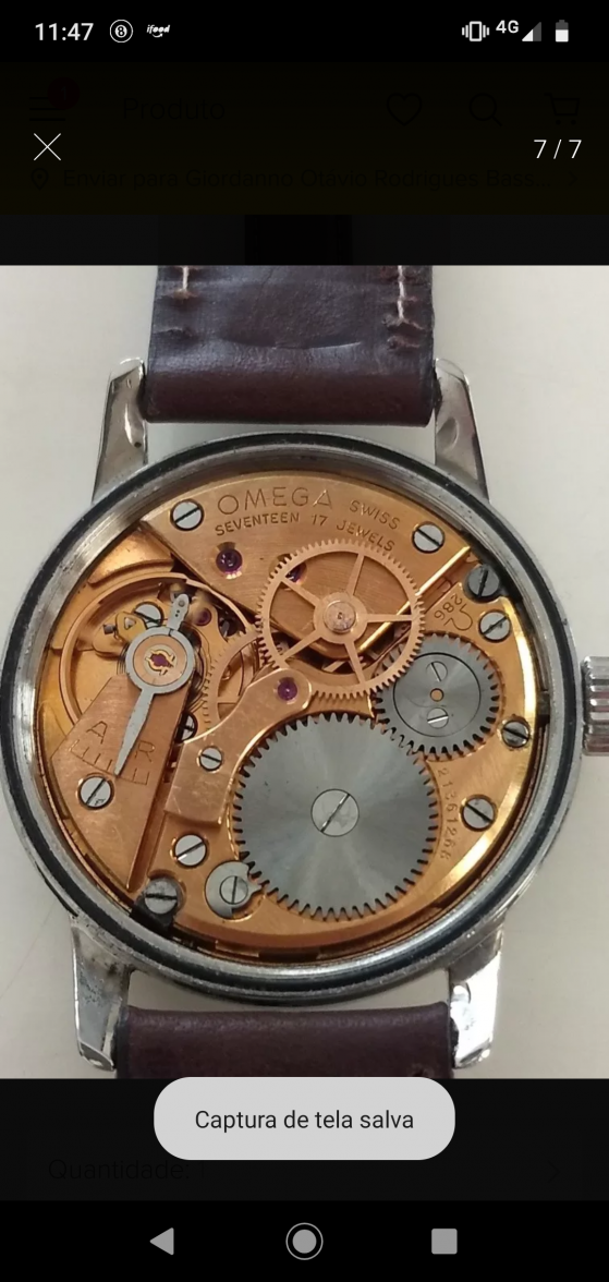

First thing for you to learn: You can check the year a watch was produced by the movement number.
24 mill is roughly 1966

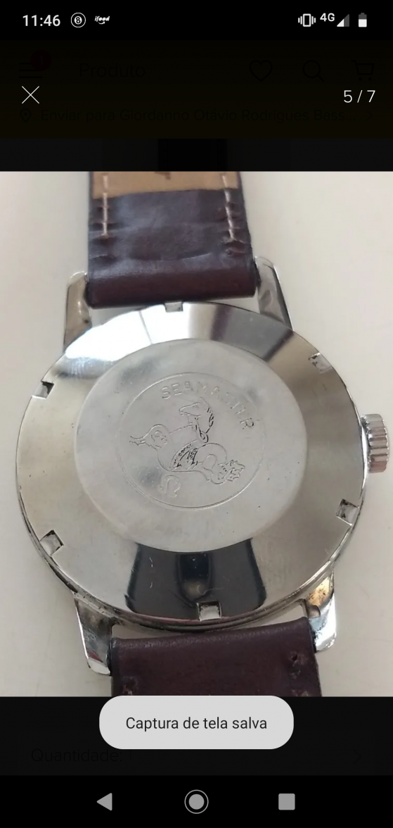

Not to me, but you're not me. You're going to easily put that much into it to get it serviced, plus parts. The lume is off the hands so you would probably want to replace them or get them relumed, so there's some more money. After all that, you're still going to have that dial.
My recommendation is to read this https://omegaforums.net/threads/learn-how-to-fish.52603/ and learn as much as you can before pissing away money. Save for a good example.

I agree with @efauser - the movement looks filthy and there’s not much you can do for the dial, even after service. 1960s Seamasters are still quite common and with a bit of patience, you can get a much better example, IMO.
Sorry but i believe it's 21 mil, which dates it to 1964. Not that it would change the elephant in the room.

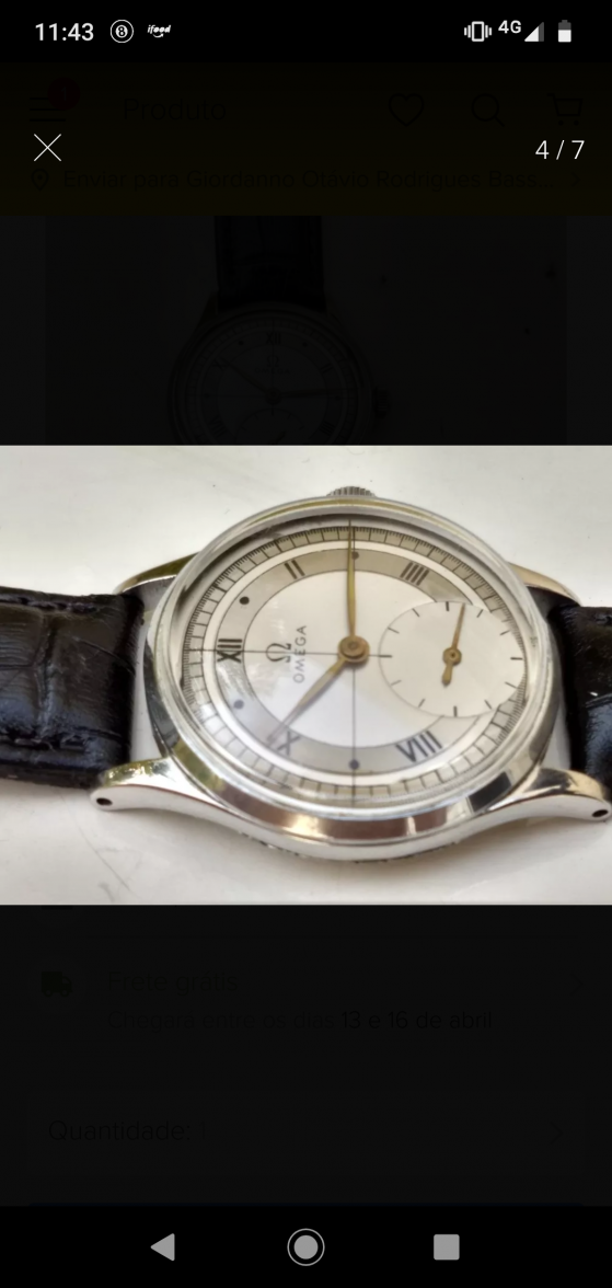

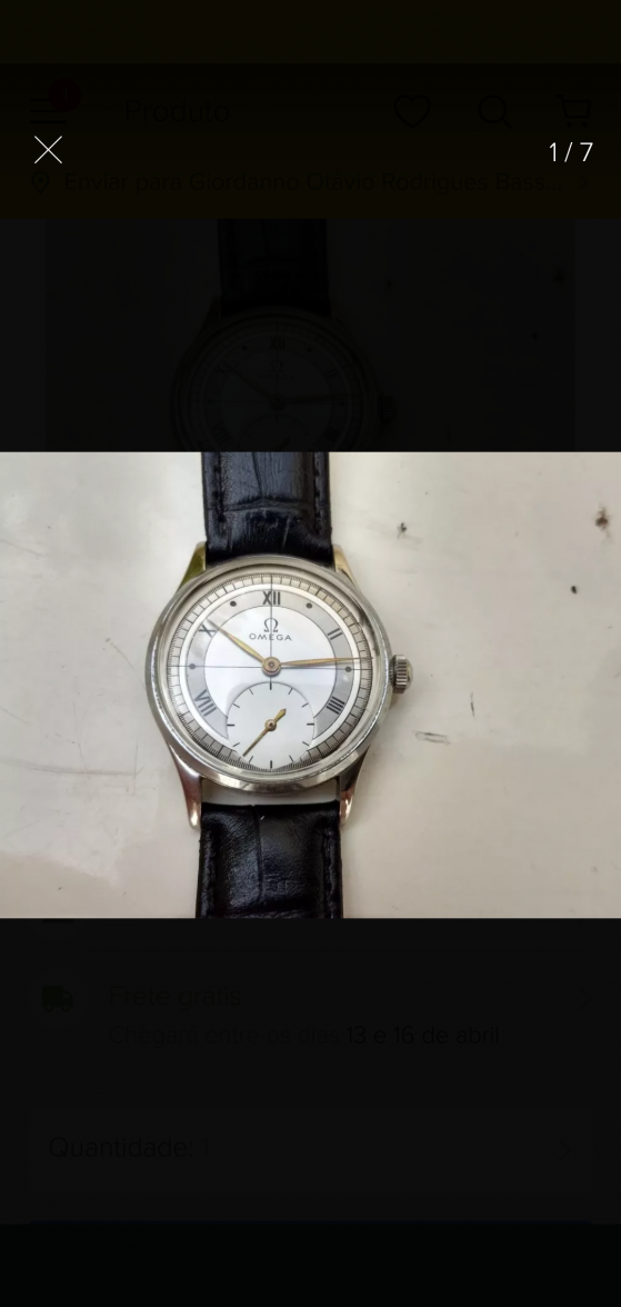

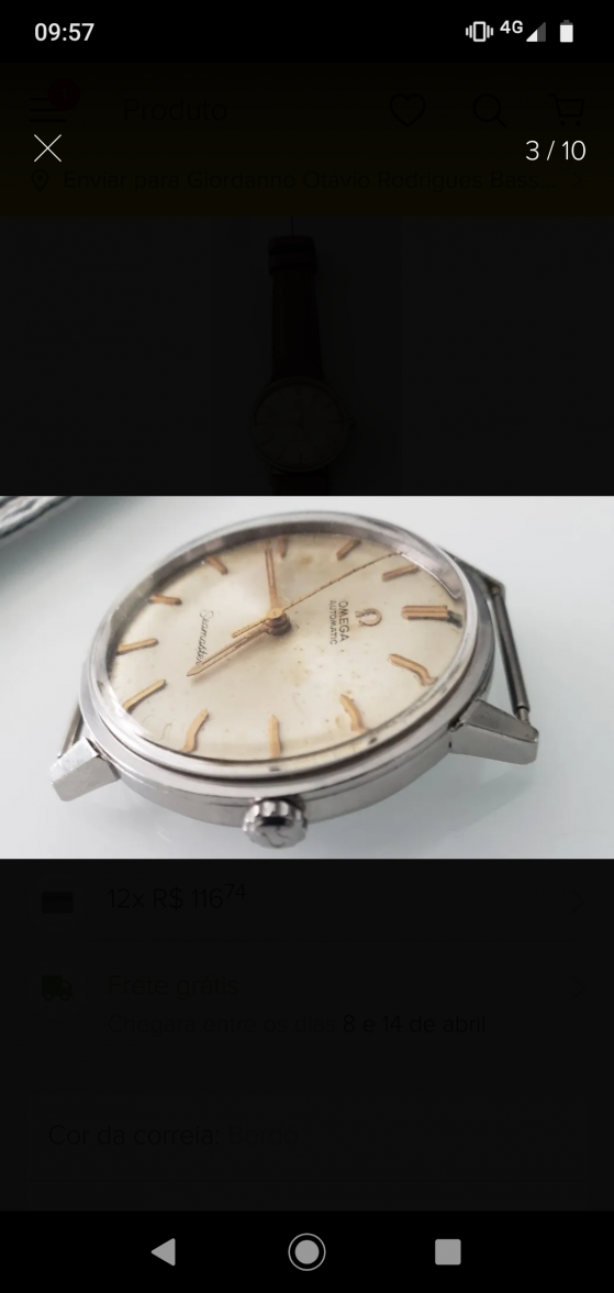

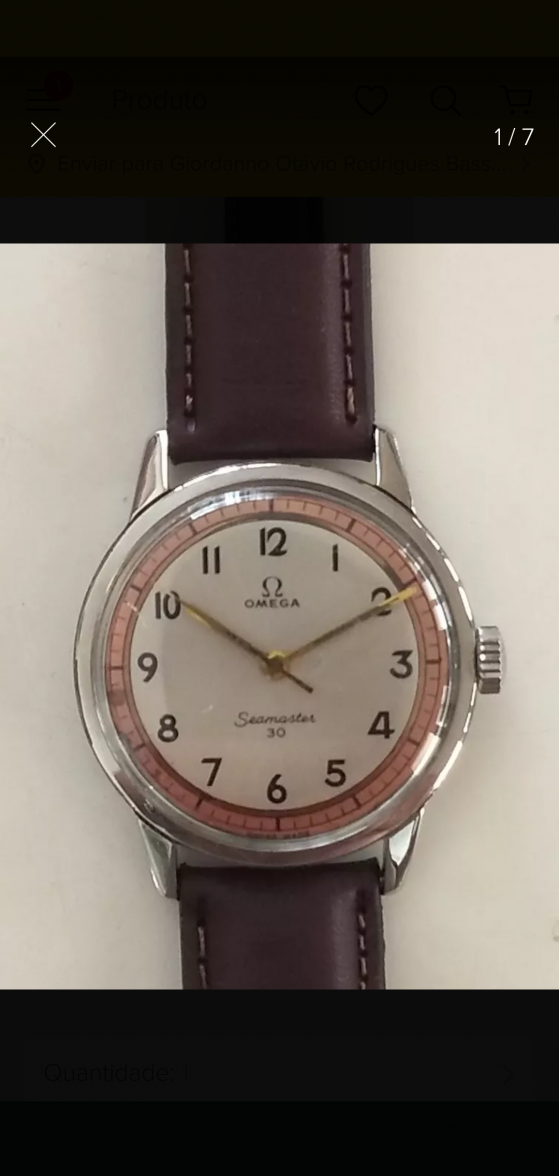

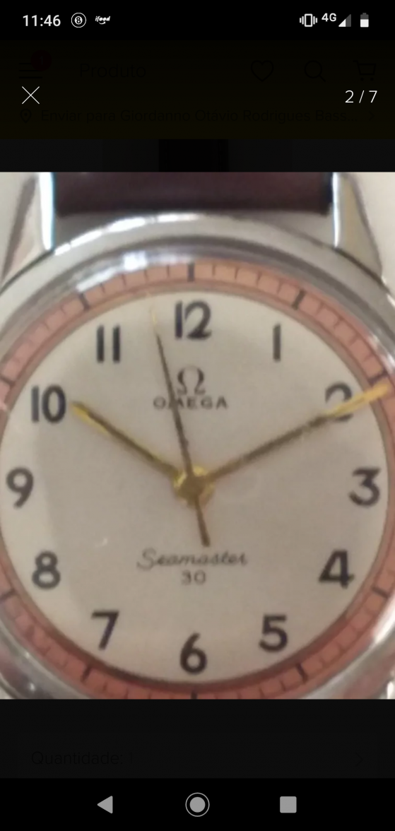

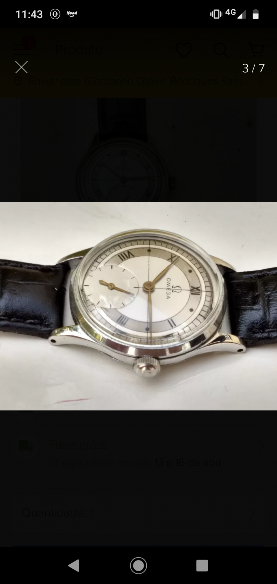

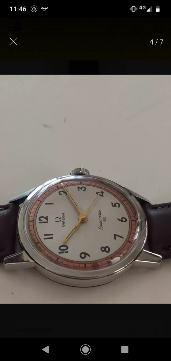

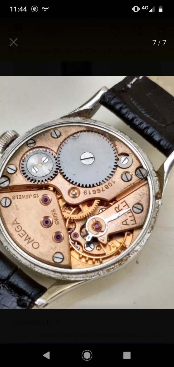

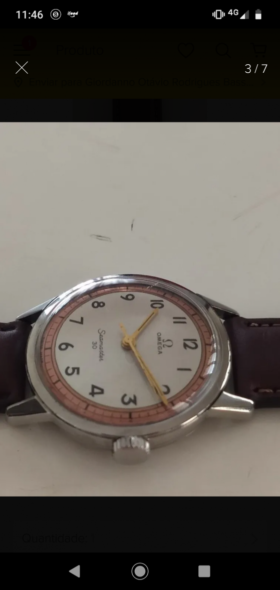

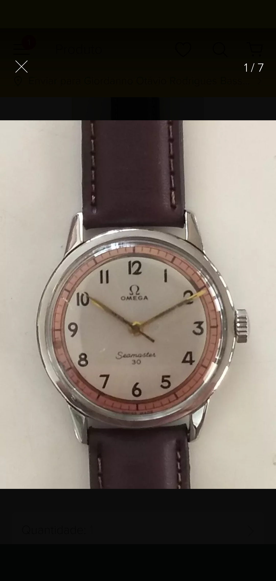

What do you guys think about this 2 watches? You have some information about them?
They are in a better condition
