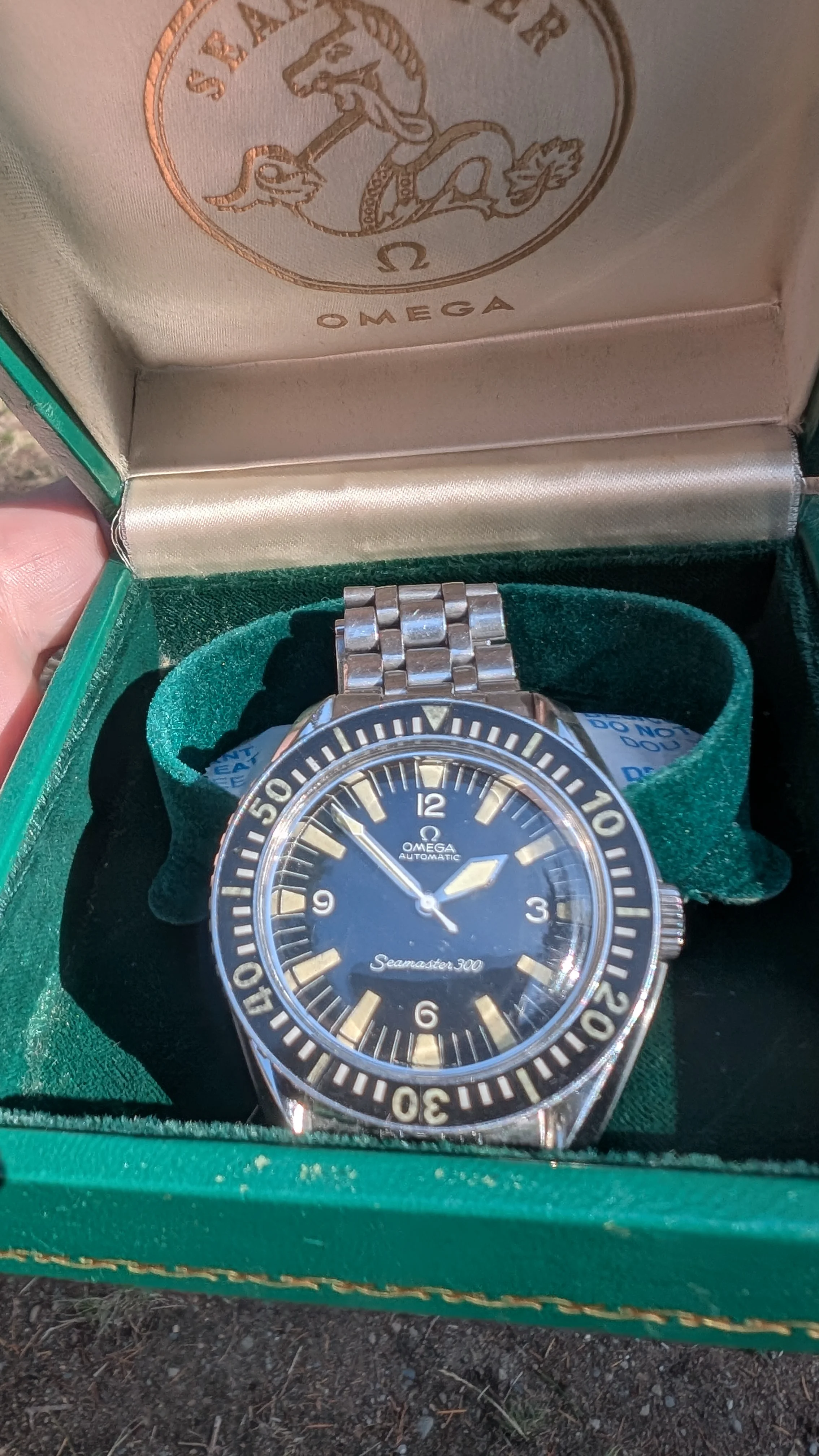

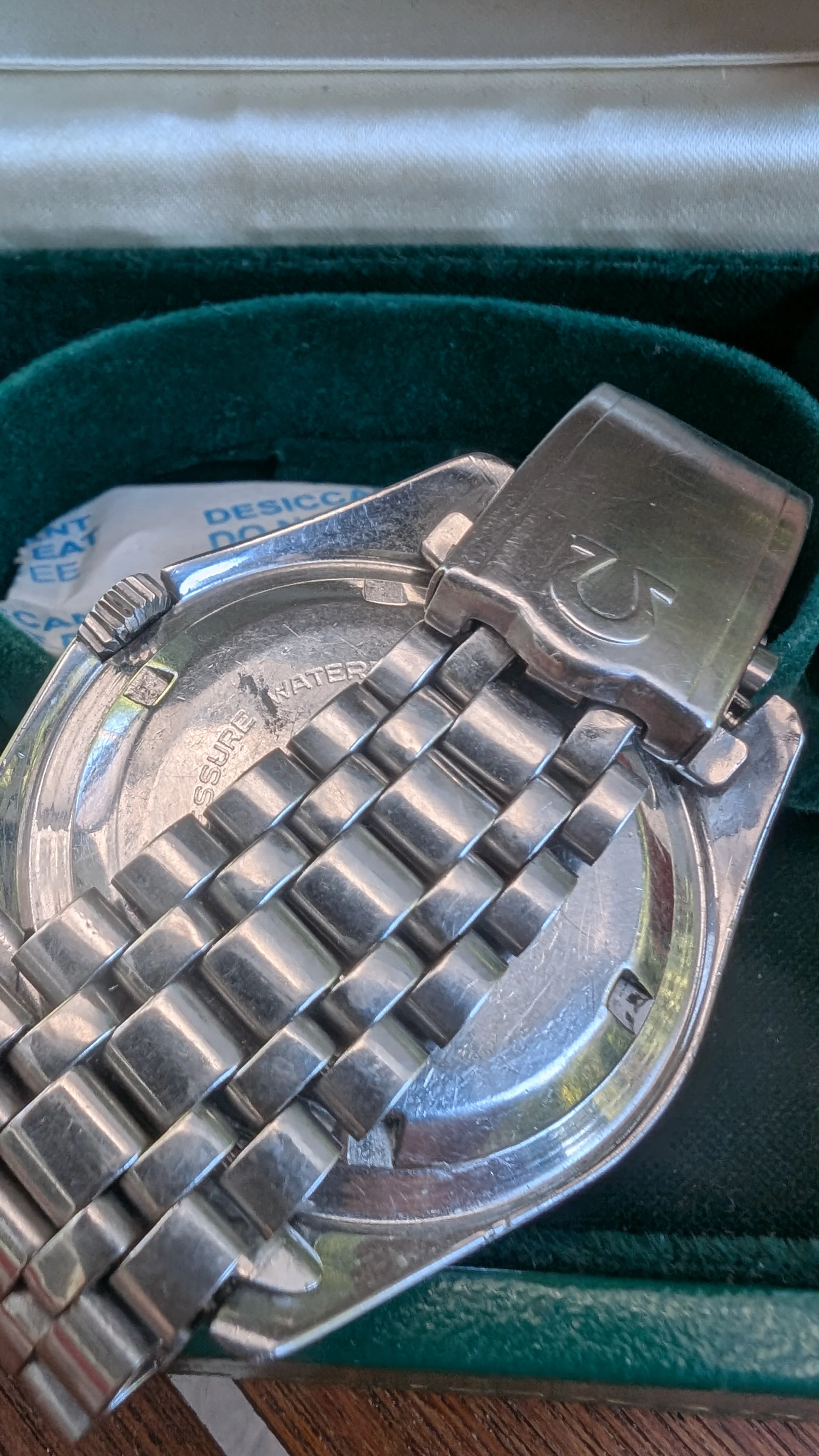

I know there's been discussions regarding the relationship between Holzer and Omega, but I can't find the specific info anymore.
Here's how I understand it.
In the 60s there were tax laws and tariffs in place.
Various companies including Omega could avoid some fees by supplying " parts" . In this case the complete watch head would be shipped from the factory without a bracelet, and Holzer Mexico were then commissioned by Omega to produce their Jubilee style bracelet as shown. This would then be sold as a complete new watch.

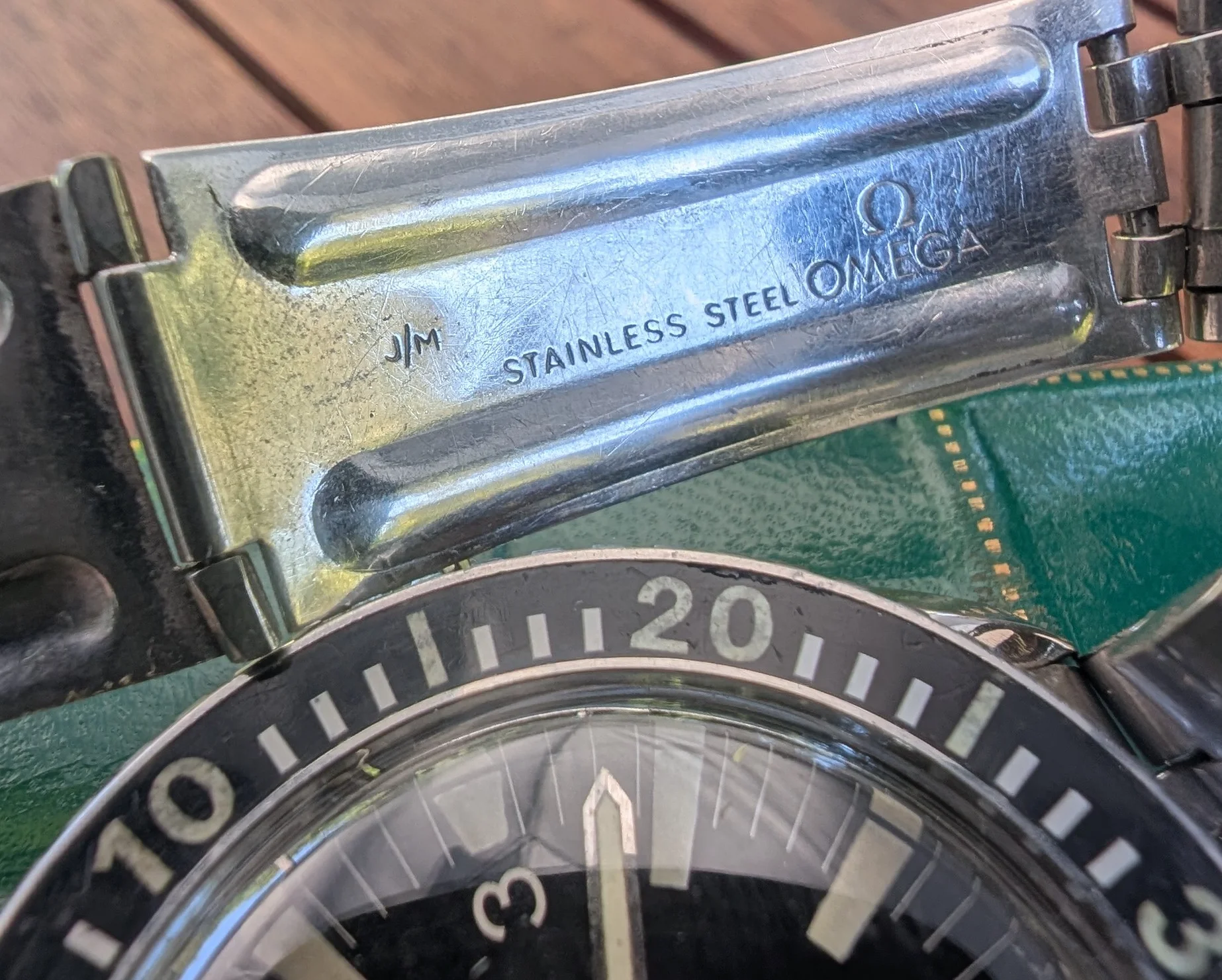

I've asked around to find these were also sold by some larger retail companies in the USA, Joske's of Texas was one, They were stamped JM on the clasp.
I understand the most common bracelet for the 300 is the 1039, but I'm looking for any info regarding the use of the Holzer as original.
Thank you

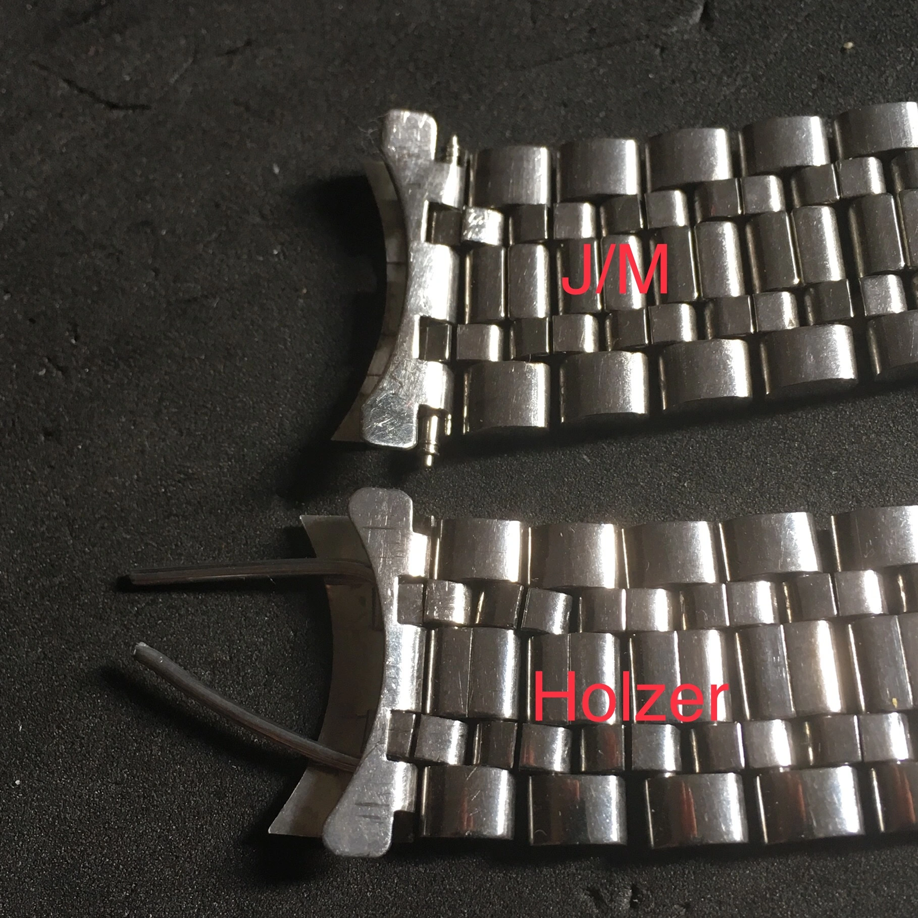

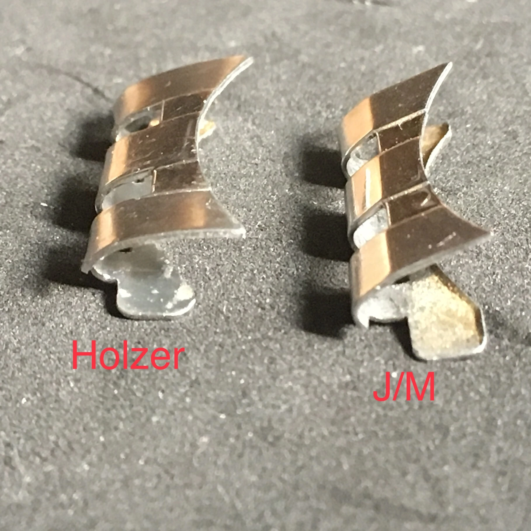

You will not find any information about this bracelets. I think they are a legit combination if the watch was sold in mexico or US and, probably, also part of south america. I observed J/M bracelet also on many references of speedmaster sold by mexican dealers (19, 20 and 22 mm), and also flightmaster. Also based on my experience, Holzer engraved bracelets are usually stamped with the production date too and are later with respect to J/M ones.
Last thing the endlinks of the J/M are different from the Holzer ones.
