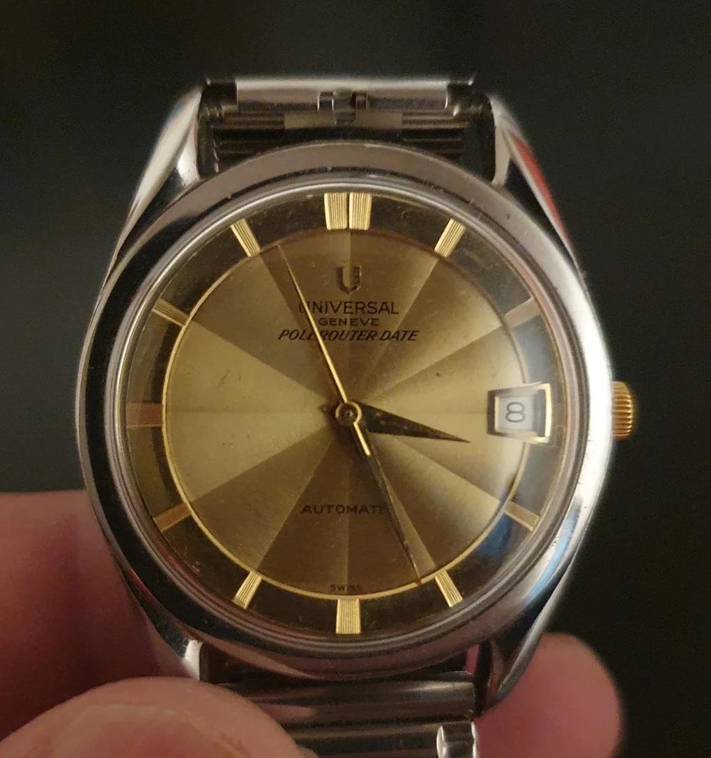

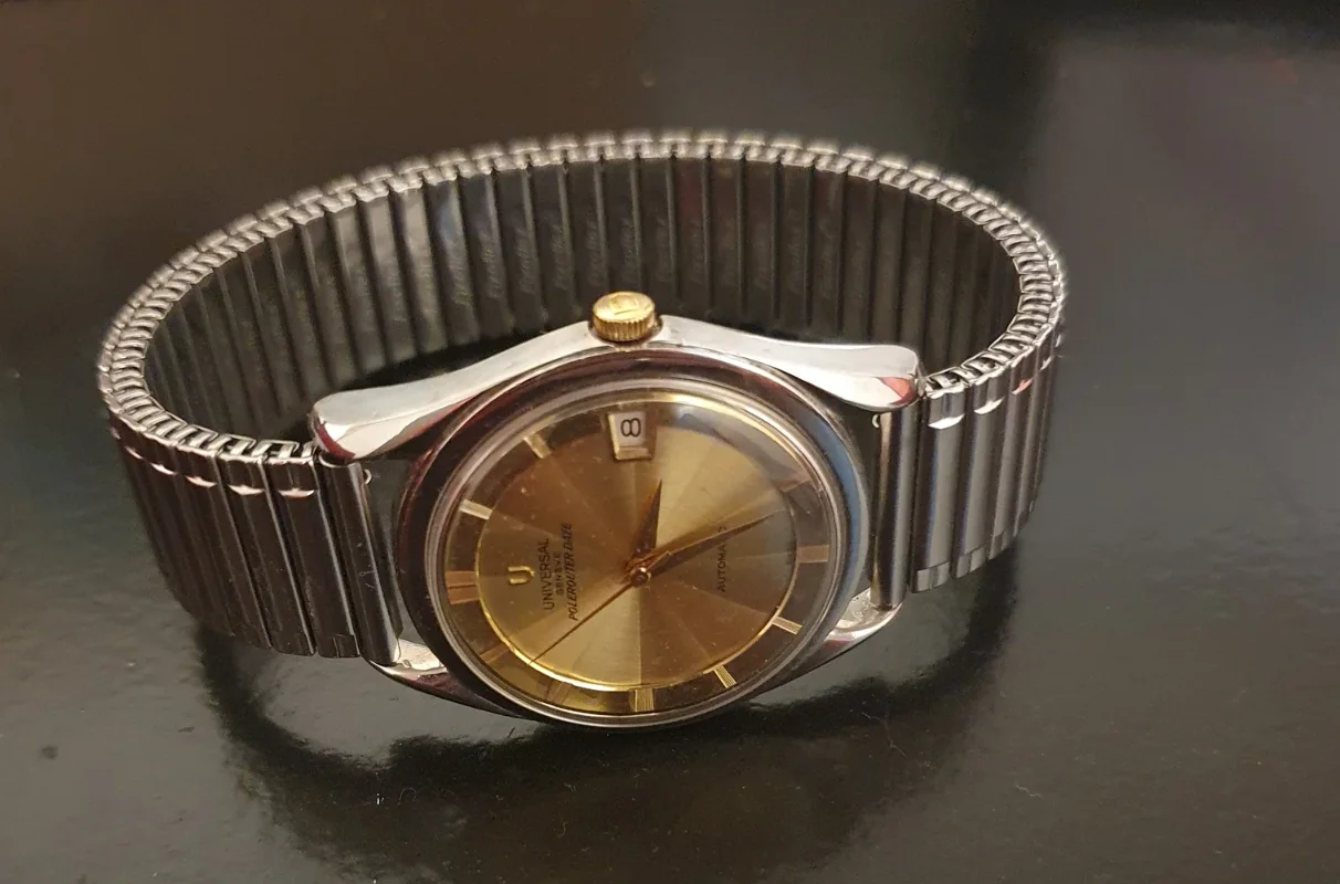

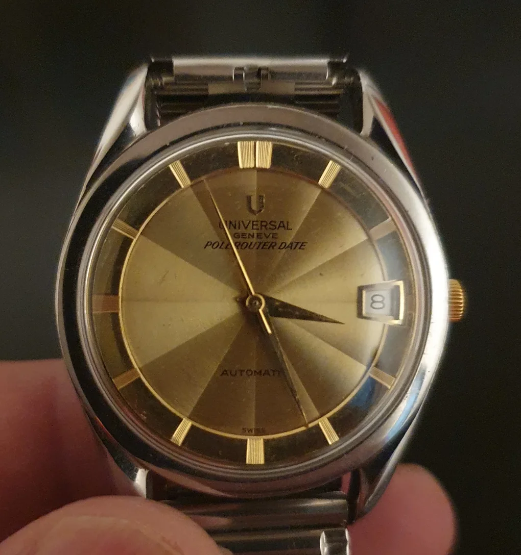

Help me identify this polerouter
17
15
I am considering buying this watch. For now these pictures are what I have to go with. What do you you guys say? Are there any red flags?
1,211
3,071

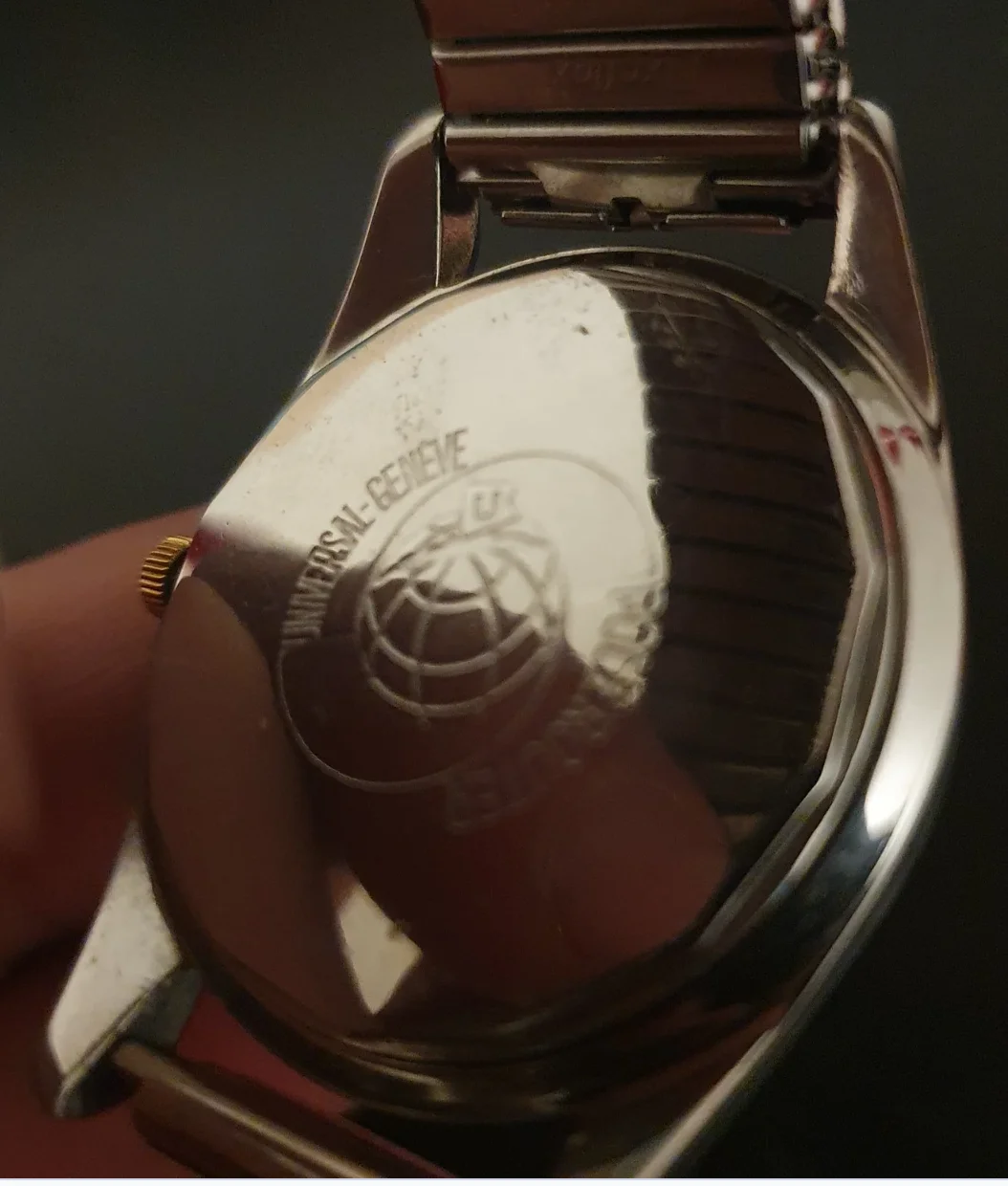

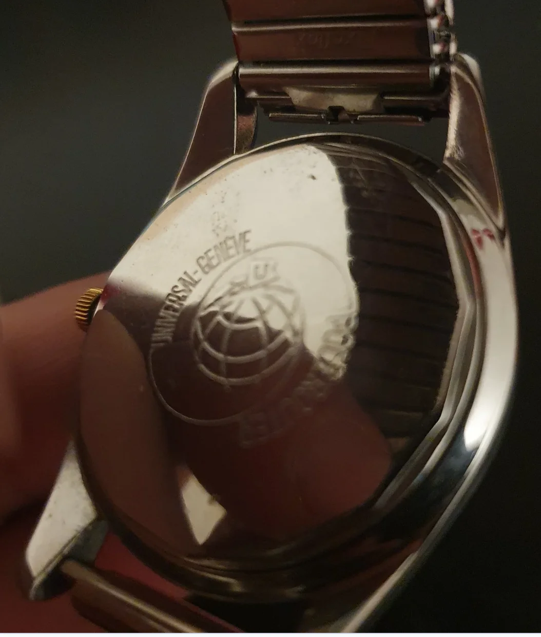

What is the reference on the case back?
Looks like a steel case (204607 or 869111) - the giveaway is the recess in the case for the crown.
But with a dial from a solid gold watch (169101/07) - the giveaway is that the indexes are recessed and the rest of the ring is polished.
If that's right, then it's one to avoid.
Thanks alot. I asked for more pictures and a reference nr. No answer, so maybe the seller knows that something is not right.
