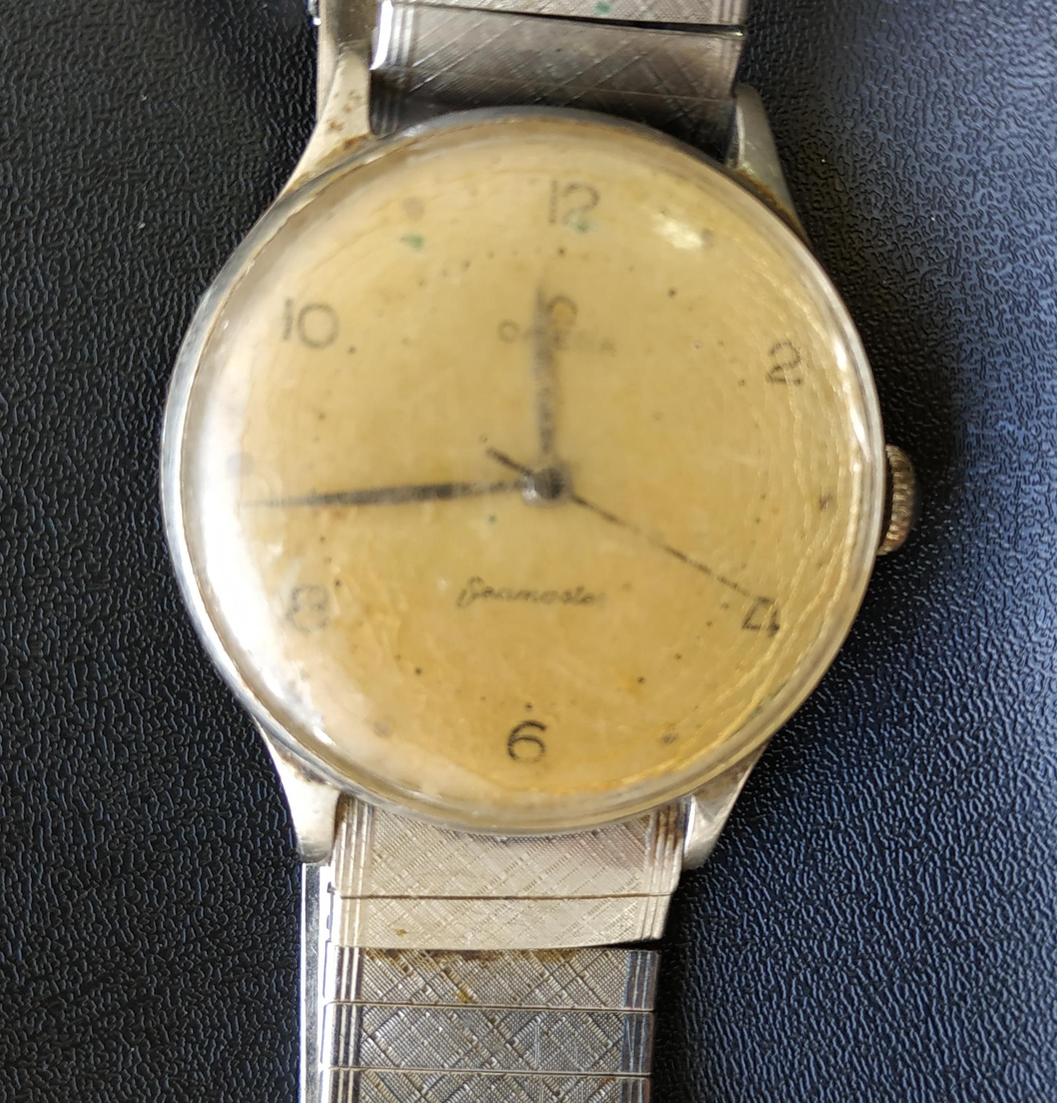

Help identifying this vintage Seamaster
4
I was helping someone clear out old things and was given this Seamaster. I am intrigued by it, and in looking at the various sites and Omega databases it has the "feel" of some late 40s/early 50s models, but I could not find something like it. The difference being the very thick crystal, the "flying numbers" (2/4/6/8/10/12) and the very thin rim. Would be eager for any guidance from experts. Please excuse these questions of a newcomer and the relatively poor pictures, which are hampered, also, by the worn thick crystal.
Thanks

i doubt its seamaster. looks 40s to me. it needs to be opened to reveal.

Looks like a 40s 30T2 to me. The 'Seamaster' has been written on at a later date by the looks of it.

It's not impossible to find a late 1940s Seamaster.
But this one looks like a redial, judging by the alignment of the numbers and the non-concentric minute track. "OMEGA" and "Seamaster" appear to be twisted as well.
I recommend to have the watch opened by a good watchmaker and have a closer look at the dial, movement and caseback.

Thank you all for this and the fine attention to detail. I will look for a good watchmaker nearby (how would I identify one in Haifa? Tel Aviv?) and report back (with photos) on what we see inside....

Unless this watch has significant sentimental value to you, I wouldn't spend any money on it. A service will cost more than it is worth.

I would wait before judging, I'd like to see the dial under that scratchy glass.

Even with glass in that condition, I'll confidently call it a redial.
