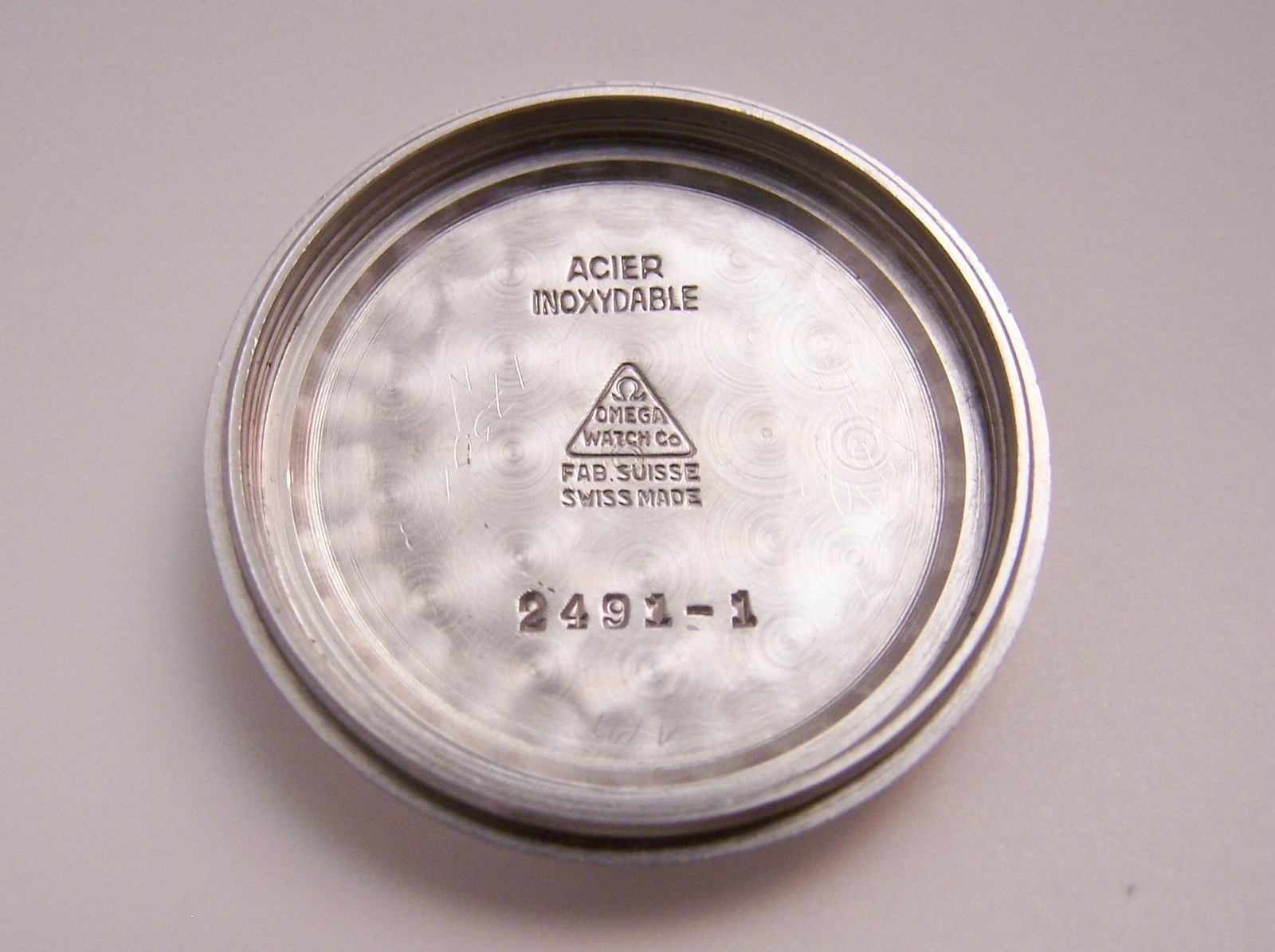

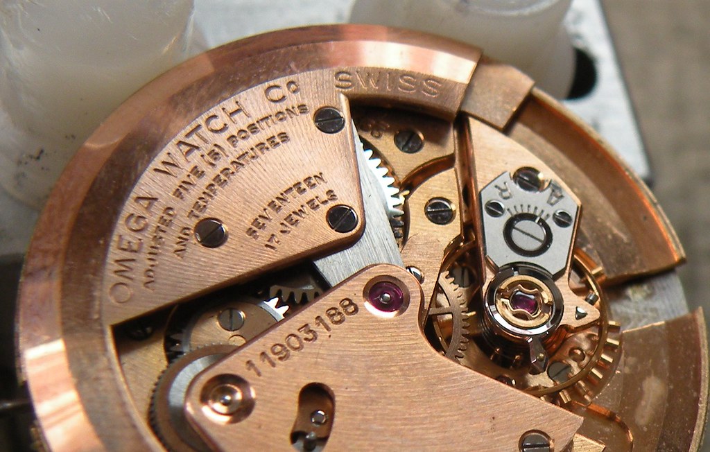

I have a watch with an 11.5M serial number that was identified as being from 1950 by Omega Museum.
This watch is slightly later than that, probably still 1950. Maybe early 1951. Can’t go by movement dating here, as it’s the cases that make them Seamaster, not the movements.
I think some case references had the engraving at this time and some did not. It’s very hard to identify early Seamsters as they don’t have any branding at the beginning (1948-9).

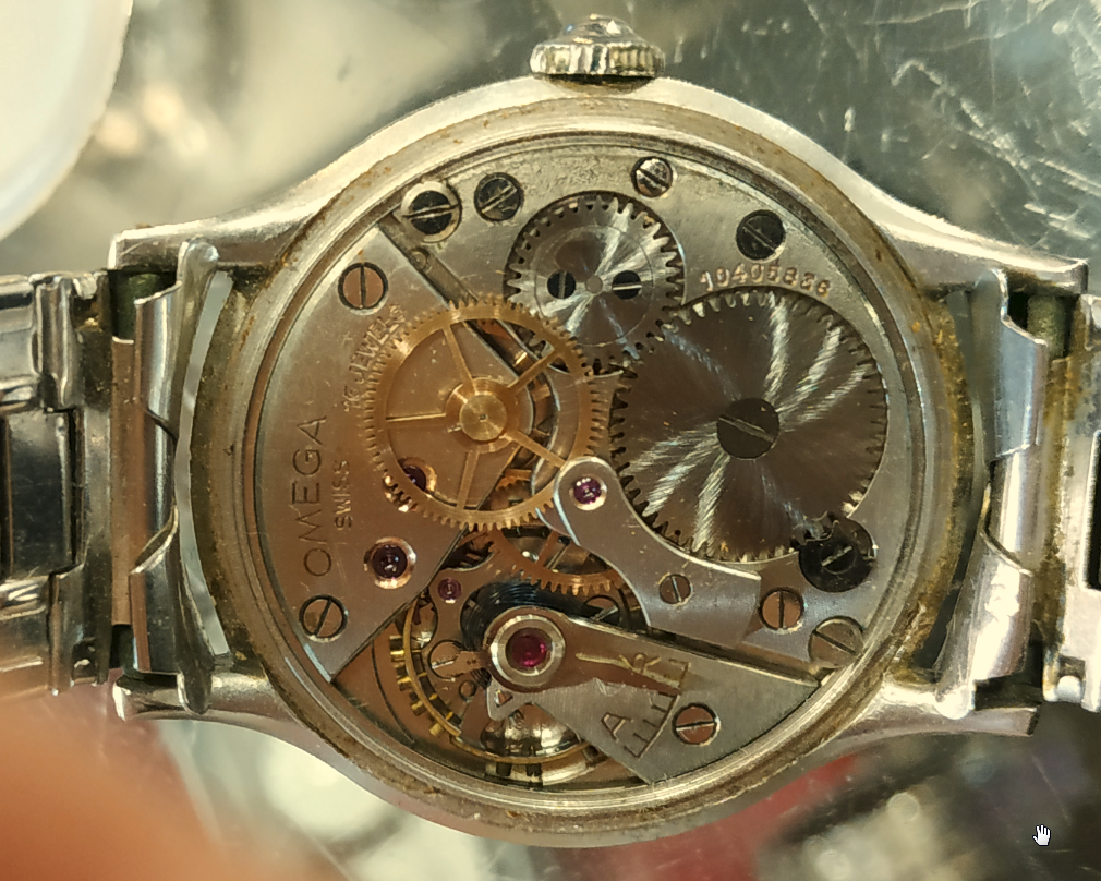

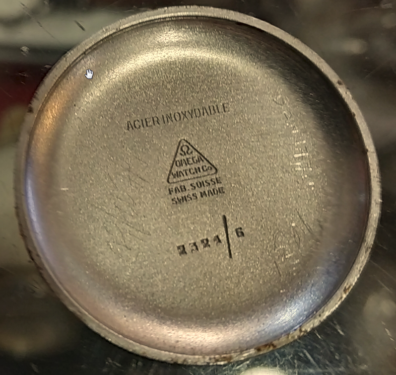

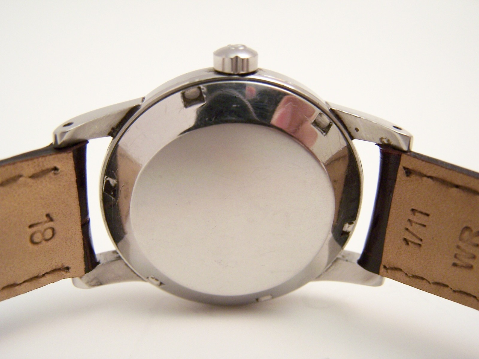

Dear all,
Getting back to you with the further details, as discussed, after opening. So the back popped off easily, and below are pictures of what we see.
Thus:

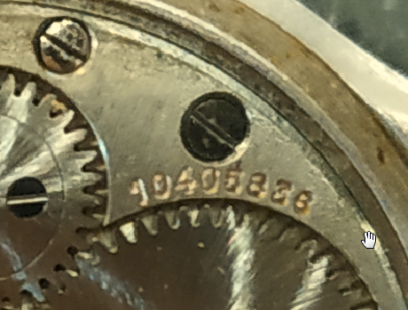

-- OMEGuy expected that the serial would be in the low 11 millions, and it is 10,405,838 (see below). I guess that would place it in the 1944-1947 range.
-- Bumper and others suggested different reference numbers, and the number here is 2321/6.
-- I see very faint hand inscriptions on the inside of the backing, and can use light at an angle and magnifying glass to decipher if that helps.
Given this, does that narrow down the model and value? How to proceed? I didn't feel comfortable with the local watchmaker taking of the crystal, but I can find one that can to tackle the redial question?

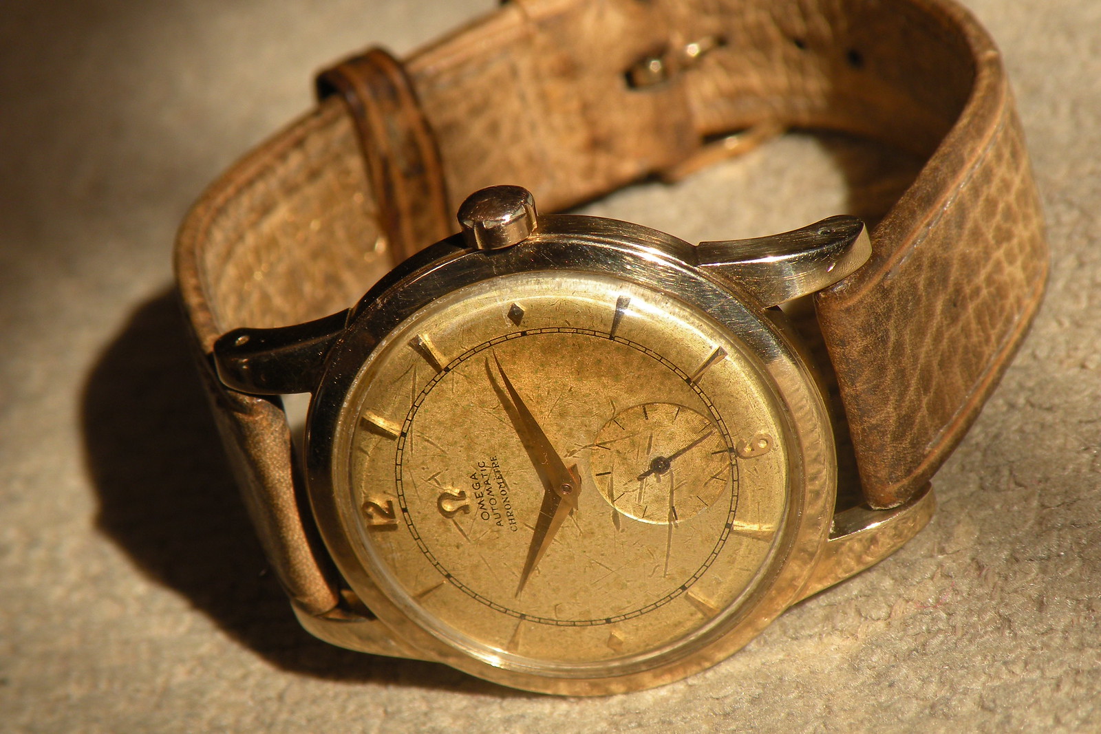

BTW, just paging through an image search of "Omega vintage seamaster" the one that was closest in overall appearance (except for the dial) was this one on Ebay, which also has a middle 10 million serial, the same thick crystal and appearance, and the same 2/4/6 numbering plus elevated silver dots at the 1/3/5 etc. positions.
Thanks.

Seamasters must be waterproof, this one is not a Seamaster.
Talking about early Seamasters, I agree with Gator.
The non chronometer Seamaster was powered by 28.10 with exposed buffing springs.
And the chronometer Seamaster 2419 that I have was powered by a 333.
Both do not have Seamaster on the dial or enywhere on the watch.
4
Thanks hoipolloi and Rochete for your resolution of this issue. So it seems that it is a non-model Omega from 1945-47 that was redialed with a Seamaster dial, is that right?
So, what would one do with this? Does it have value/worth to anyone, and how to get it to them?
Thanks.
You could sell it on eBay with disclosure of what you know.
Let the market value it accordingly.
