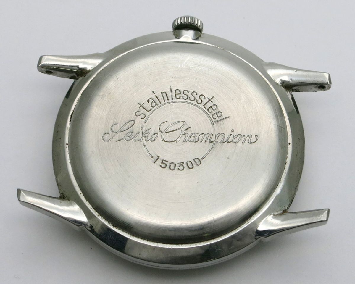

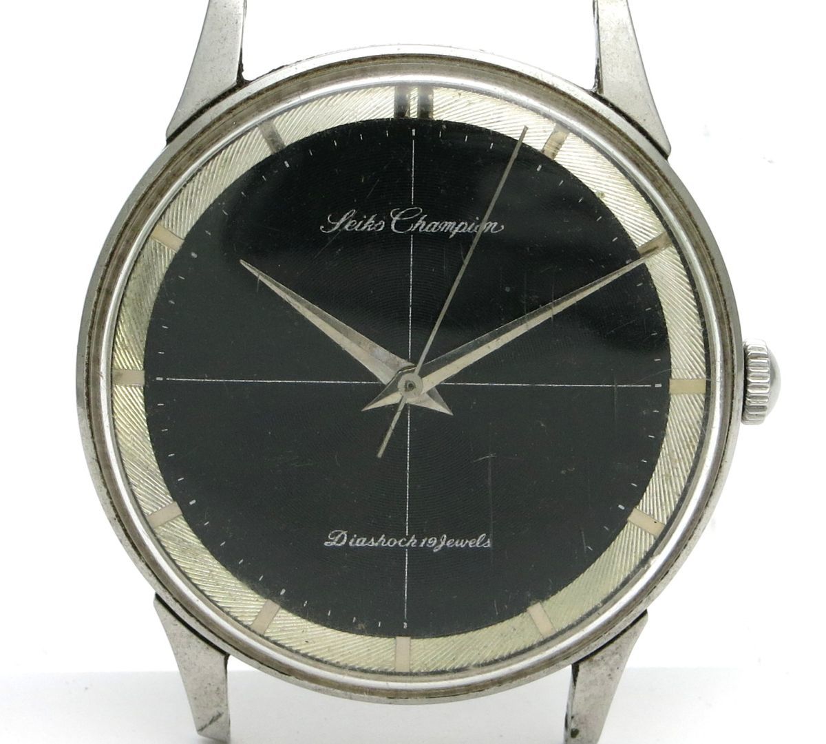

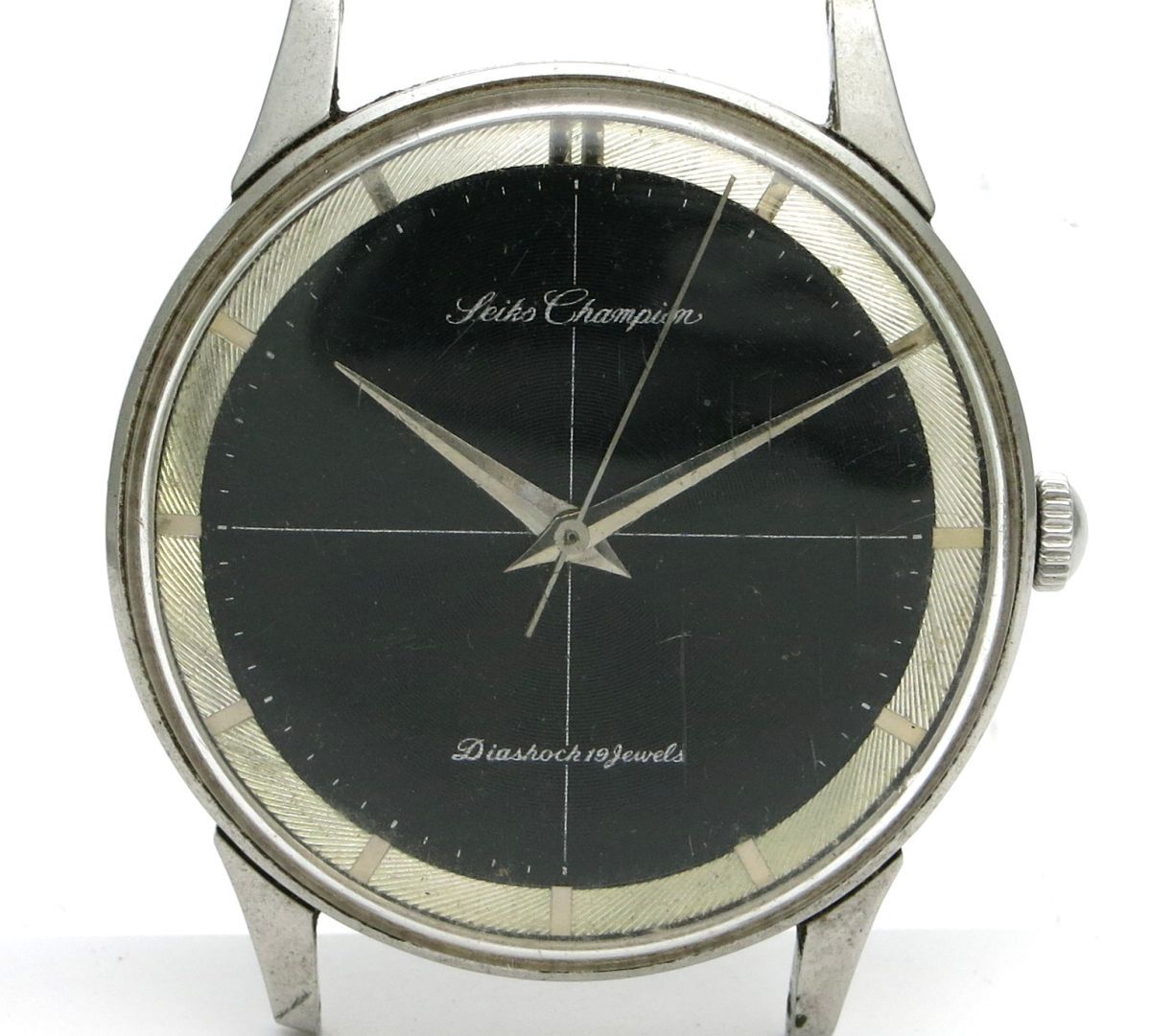

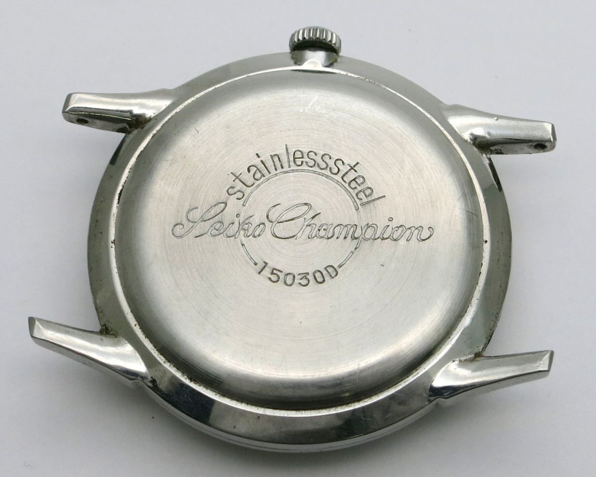

I just picked up this piece as junk for a project. I am wondering if the crystal can we salvaged using polywatch or would need a replacement? If so, could somebody help identifying the right crystal part reference for this case (15030D)? Thanks so much in advance for your help.
240
521

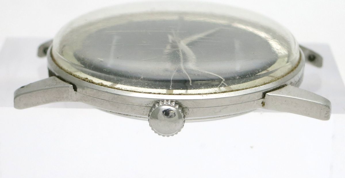

Polishing can get rid of scratches but not cracks. S it a crack on the side?
Not a 100% sure. Watch is still in transit.
917
1,781
When you get it, if it’s a deep scratch just use 1200 wet and dry with soapy water then finish with polywatch. Use a torch to ensure you got all the scratches before using the polywatch.
The torch will show the deeper scratches on the dial as you move it back and forward.
