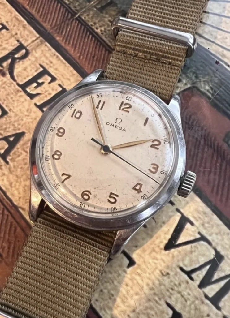

Correct crystal for this 30T2
187
173
Can anyone tell me the correct crystal for this? The one that’s in it now falls out as if it’s a hair too small.
1,453
3,024
Get a pair of vernier callipers and measure the gap. Then buy one in that size and another a fraction bigger. I usually buy 2 or 3 of each size. Then I have spares, as they’re cheap but then you have the postage costs.
384
375
Without knowing the case reference, all I can tell you is that the most common crystal diameters for vintage omegas are 29.6mm, 30.6mm and 31.6mm
187
173

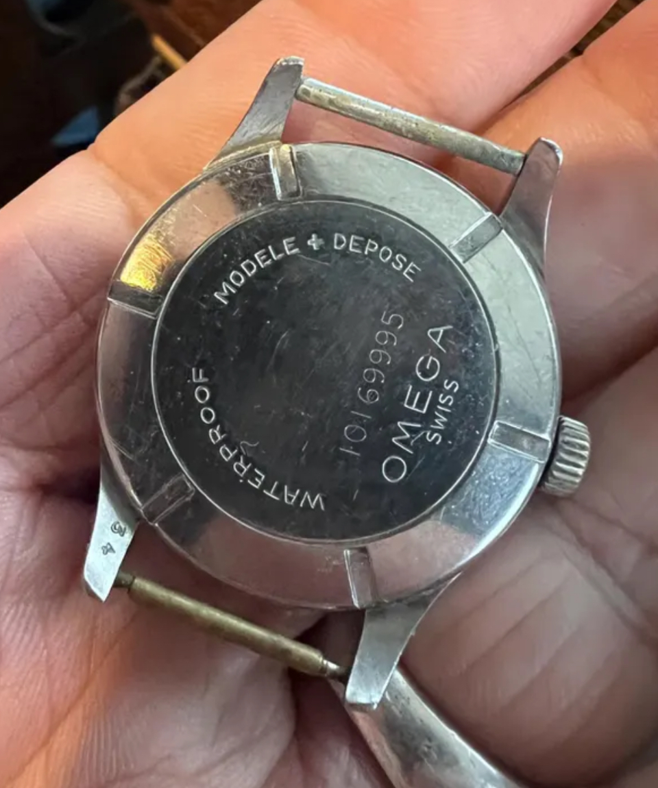

Inside of case back is just marked with 34.
