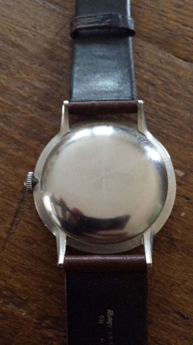

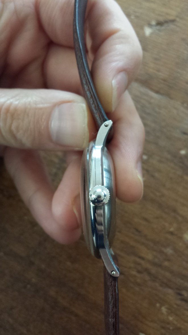

Hi,
I was given an Omega by my grandmother a few years ago that promptly stopped working. I believe before i was given it it was working and was serviced (not with Omega), the strap is obviously relatively new and not official Omega.
At the time she wasn't sure where it had come from but had been rattling round the house for a long time (maybe 50 years or so) and probably wasn't new then. My grandfather used to do legal work after the 2nd world war and often did it for payment in kind for those who couldn't afford what they needed, most likely this is how he acquired the watch.
I recently took it to a shop to get serviced and they quoted that it would cost over £1,000 to get working again and would charge me £60 to send it to Omega to get the exact estimate. This doesn't feel like it would be worth the money (could just buy another for less) as another shop i took it into to get serviced but they wouldn't do it and tried to buy it off me for £2-300.
I have no idea how to take the back off (and don't really want to in case i break it) but some advice on the following things would be great!
Any idea how old it is?
Any idea what watch it is?
Is it worth repairing for £1,000?
Any guesstimate on value?
I love the look of the watch
12,750
17,272
Watch is from the 1940's. It did not have a model name (most Omegas didn't back then). You should be able to find a local watchmaker to do the work for much less than you were quoted by Omega.
As an heirloom, the watch is priceless. As a collectible, I would suggest you look at completed auction listings on eBay and other auction houses.

Thanks for the help!
My best guess is that the value will be a couple of hundred quid when fixed.
I am taking it down to a local-ish independent watch maker to see if they can get it running perfectly. I guess as long as i don't spend more than the value of the watch it is not throwing money away.
And thanks for the advice about not getting Omega to fix it if i wanted to keep it looking vintage, the vintage look is the reason i really like the watch!
Thanks again!
Tom

Worth a bit more than a couple of hundred. Looks like a 37.5 mm sized model and these are always collectable.
Movement maybe a 30T2SC (sweep second) and nice dial design with silver leaf and blue second hand.
Similar to this movement
Probably just needs a cleaning. Maybe a £100 - £125 est. to clean and time if nothing broken
Simple movement to service
Worth hanging onto
DON
