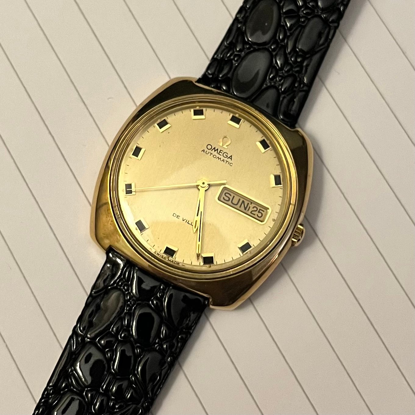

Help identify Omega Deville cushion case (no back!)
7

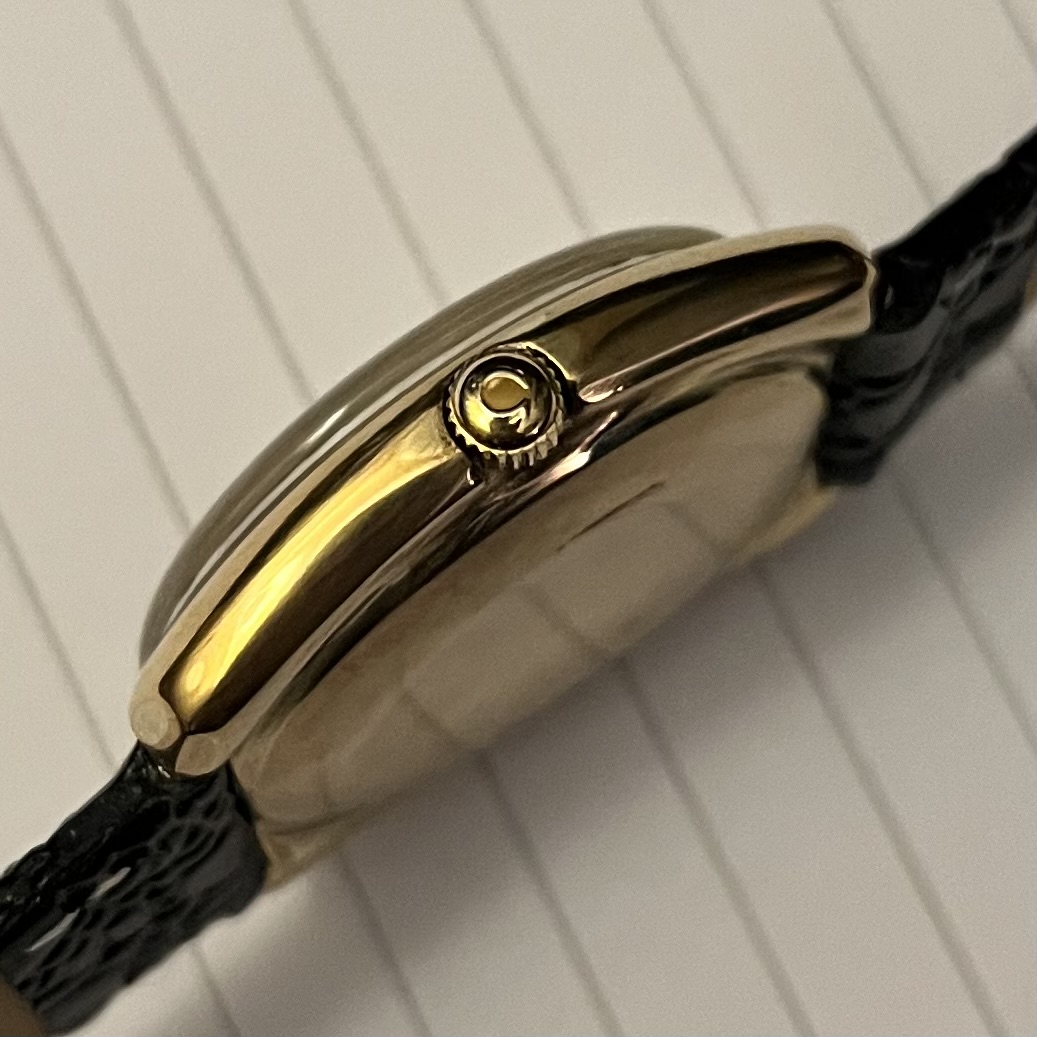

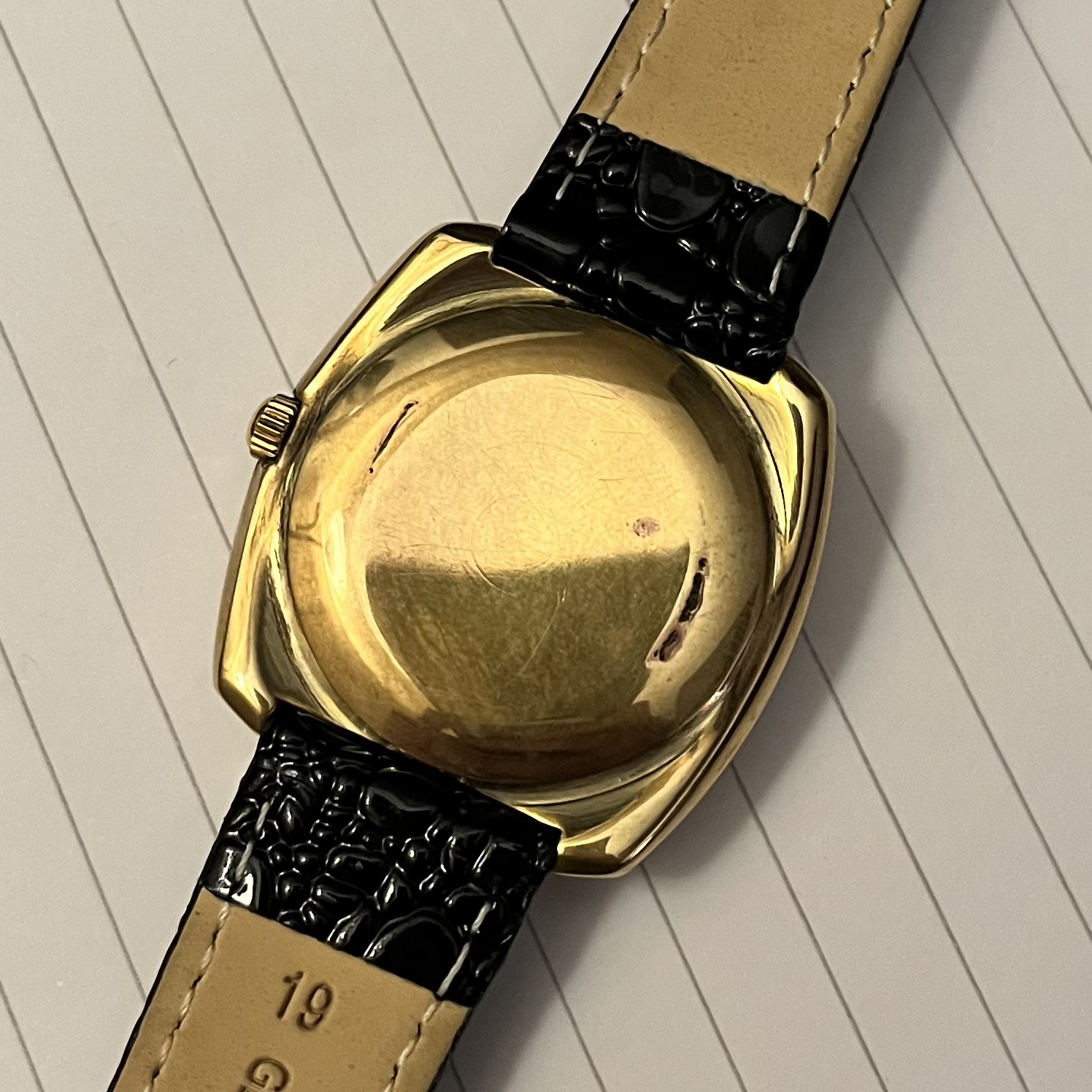

The case is all one piece (looks like movement installed through the dial side). I haven’t encountered a watch like this before so not sure how to take it apart!
18,840
39,184
Your case has had some incredible polishing done to it, possibly re-plated as well.
Or you could hope that it's just a badly polished BA 166.0053
The case is a monocoque/unishell style and the watch can only be opened using Omega Tool 108 to remove the crystal.
5,729
9,515
Don't.
7
Ah! Thank you for your read. I took another look at the article I posted and see now that the 166.0053 has the “mono” case design as well. A polished-down version of this model seems plausible.
It’s interesting that the dial is so well preserved while the case has been smoothed down. A testament to the engineering! At least she has a story and still wears beautifully.
