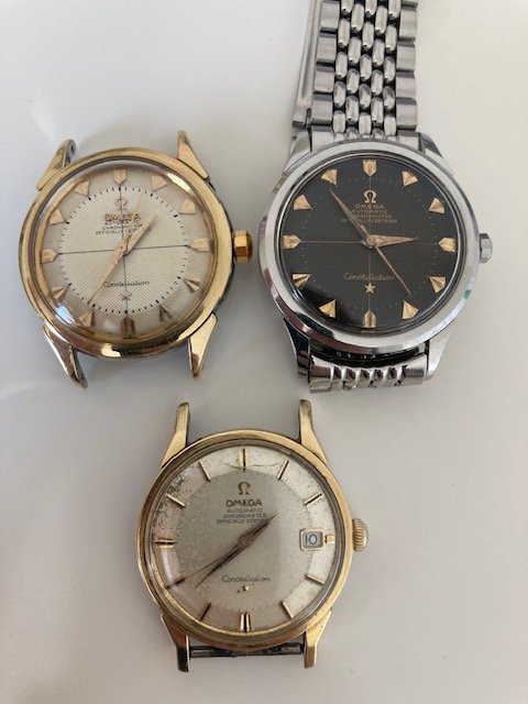

Hello, everyone! This is a follow-up to my previous thread asking for watchmaker suggestions.
For when I contact watchmakers, it seems that it will be helpful if I can identify the reference numbers. Can you help me with these three watches? Thanks very much!
Here are the pics again:
24,797
55,079
The reference numbers are inside the caseback and the movement calibers will be on the movements. If you can’t open them, then just let the watchmaker do it.
906
1,739

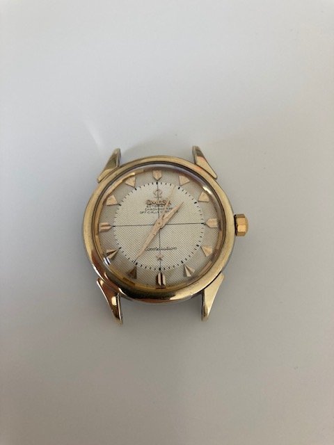

That waffle dial is a redial.

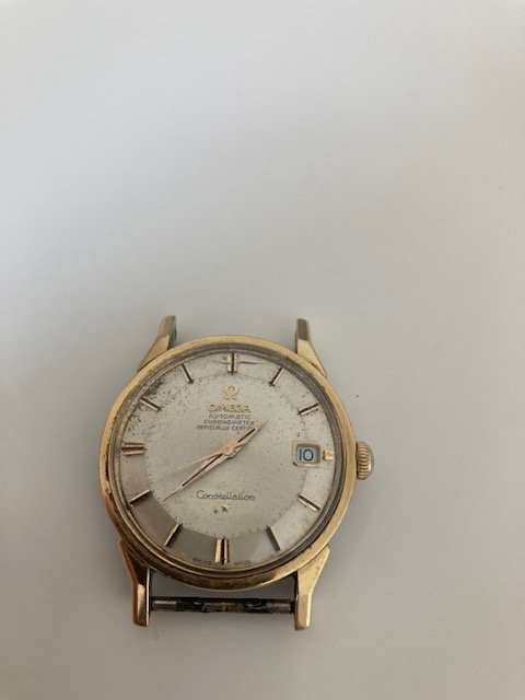

Not sure about the pie pan, markers look off. Photo is blurry.

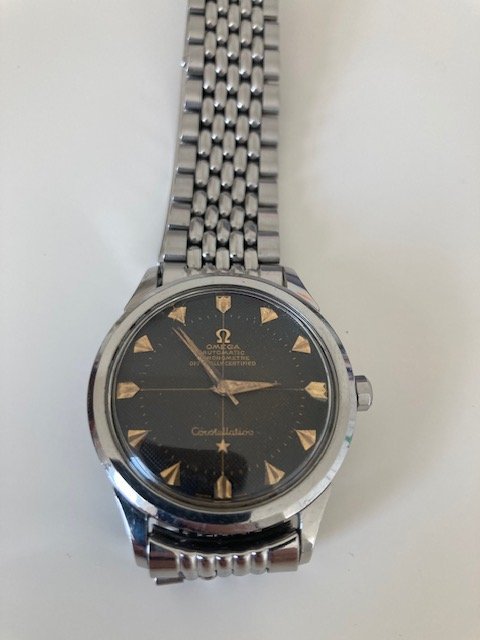

The black one may be ok. Looks bigger too, so a jumbo?

Thanks, Bruce 235--Yes, the gold-capped waffle dial is a redial: I learned this in a prior thread here on OFs. It's too bad, but I still like the watch, and am interested in being able to wear it.
I don't know much about the pie-pan's history--only that it belonged to my father-in-law: I doubt that it ever went in for a service: are you saying it looks like it has been redialed in some way?
Glad the black one looks ok: some people here on OF have wondered if it, too, was redialed. I think it looks bigger only because of my poor camera skills: all three are the same size.

The photo makes it hard to say. I think the minute markers are inconsistent, but may be bad crystal and dial damage. The words officially certified did not appear on some references at times, so not definitive.
201
96
Oh--that's interesting. I'll pull the watch out and look more closely at it tomorrow. The crystal is definitely damaged and the dial seems stained or marred: I'll double-check the markers.
Thanks for drawing my attention to these things.
