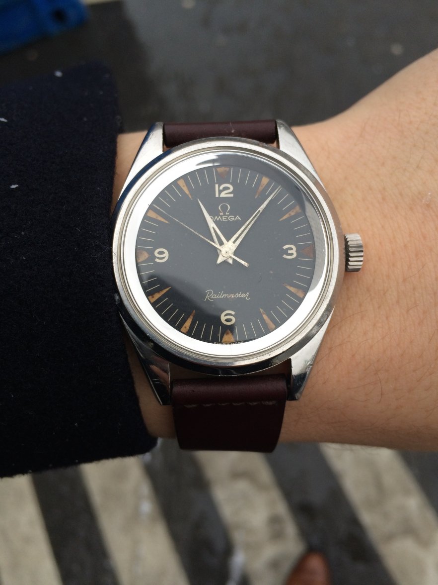

Looks like I'm the only one interested in keeping this thread alive but just wanted to let you know what the watch looks like now that it's back from service=)
First of all, huge thanks to @MSNWatch for providing a period correct crown for my 2914, forever grateful!
Here's a first picture of the watch in its current shape on a shell cordovan strap. I'll try to provide some more pictures if anyone's interested.
The watch received a complete movement service and a crystal replacement. Other than that the worst gauges on the case got taken down ever so slightly, all and all the case is pretty untouched and still looks very beaten up=)
/Anton
/Anton
Great to see that crown on the watch. Wear it in good health! 👍

Awesome watch. I just read the entire thread. Great story! I hope I can give watches to grandchildren someday and the watches are treated with the same respect you have shown.

Came out amazingly well, and what a great family heirloom!

That looks so good. I'm glad you left the dial and hands as is. Enjoy that wonderful piece of family history!
387
196
I agree. Don't polish it. Every mark was made by your grandfather....look at a new scratch every day and just imagine what he was doing when the watch was dinged!
