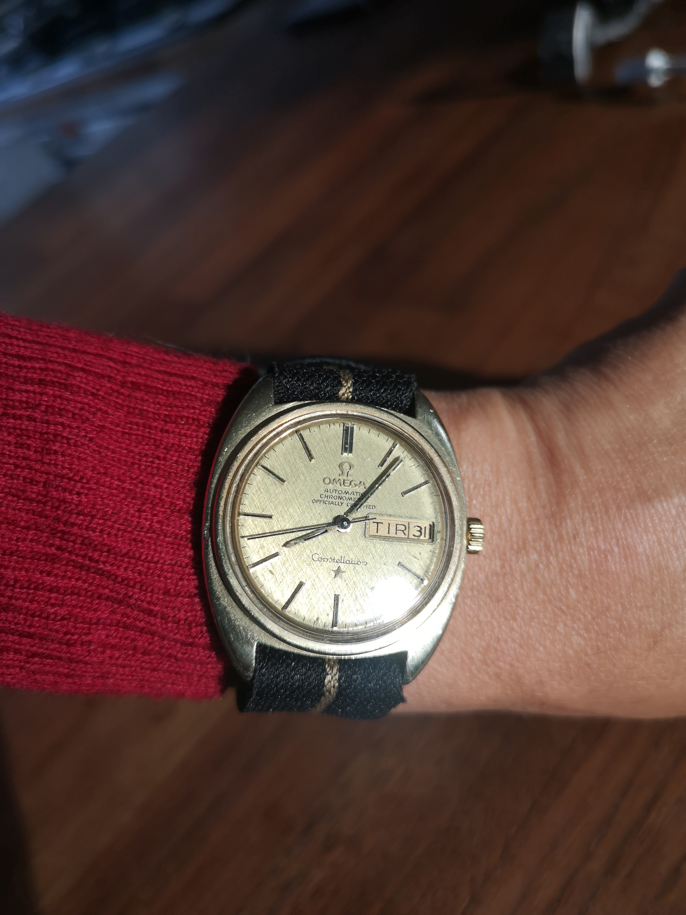

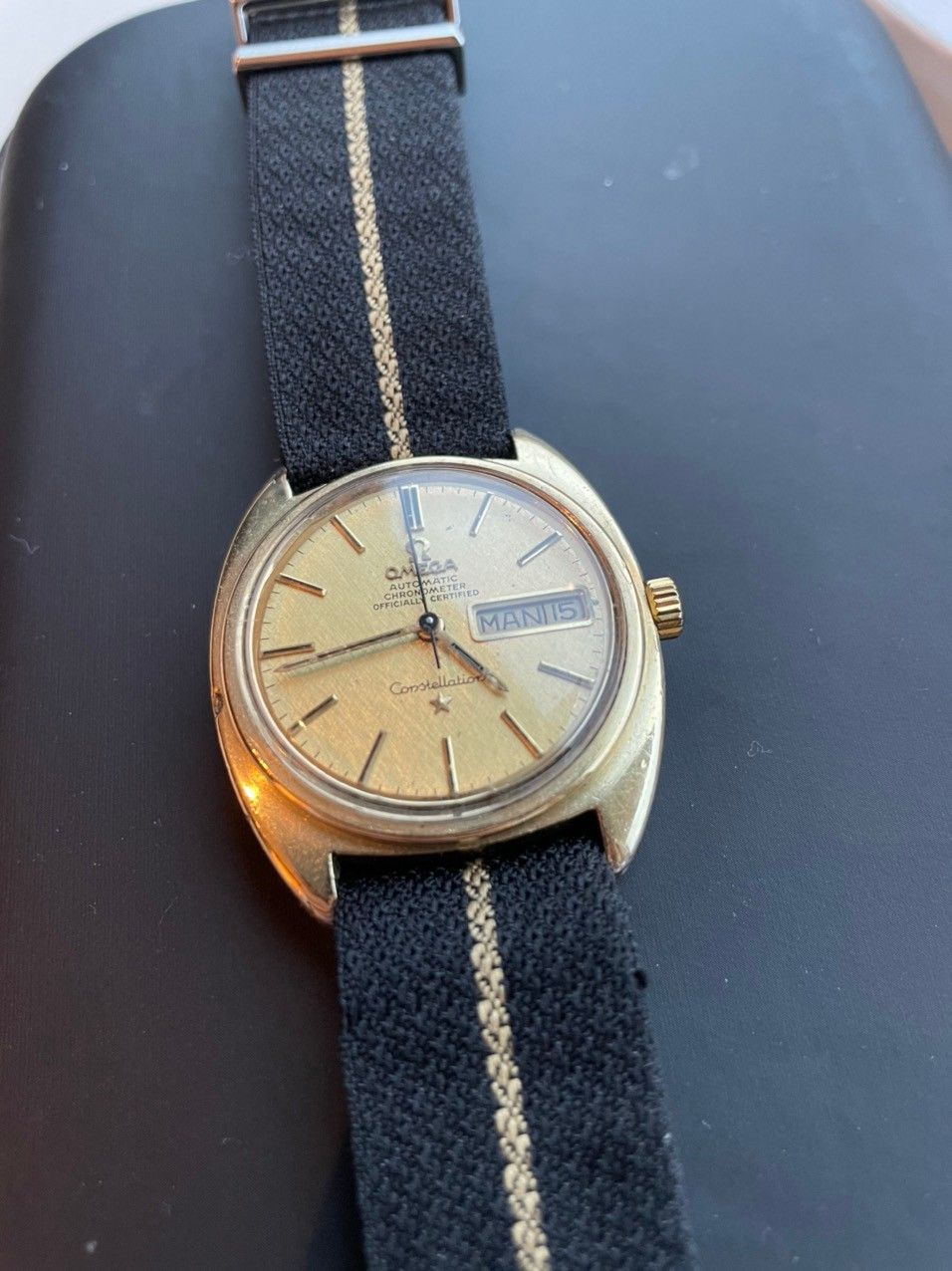

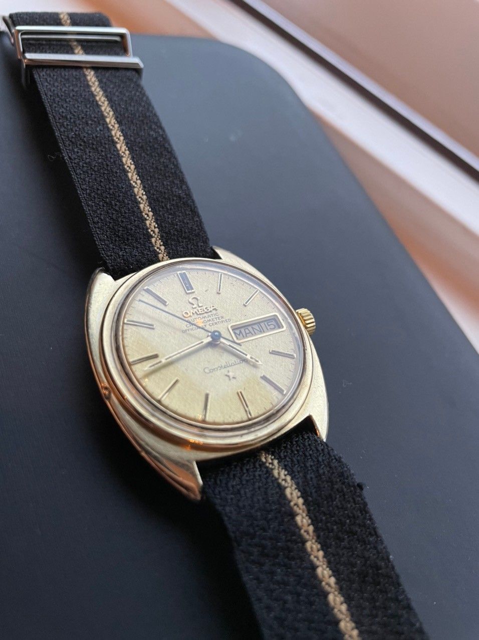

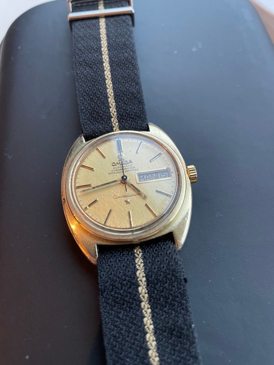

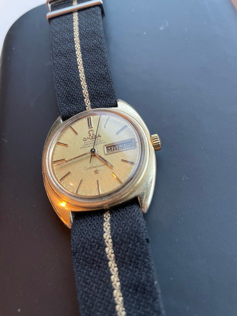

I am brasilian and I starting geting in love with omega, special the vintage ones. But i had a very bad experience in the past and bought a fake one thinking it was real. So, i do not want to passed for it again. Please, can someone can help?! I found a vintage an Omega Constellation Day-Date from the year 60s.
He said the previously owner said it was 1967 or 1968 and have the original crown and class. I really like it. The price is 750 dolars. Can someone look on this picture and tell if it is reall omega and if worth buy, PLEASE?
Thank you very much, I really appreciate it. And have a lovely day.

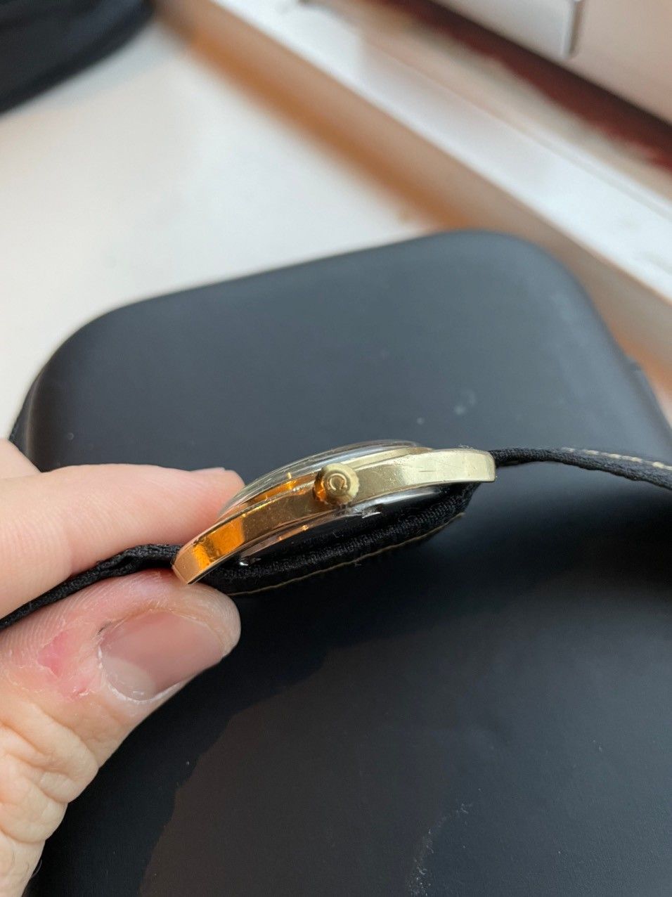

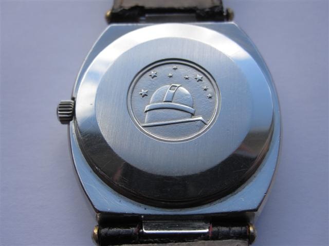

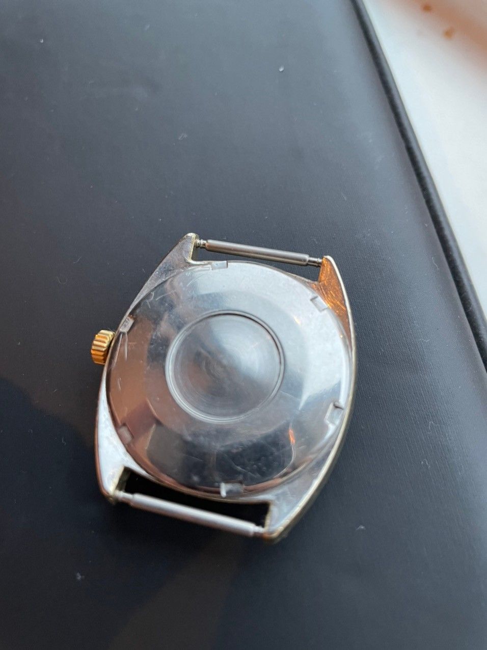

Most would advise against this watch. It is overpriced, and the case back is missing the iconic Constellation insignia.
There are many vintage Constellations on the market - wait for a better example.

The watch looks authentic to me, and it has a nice dial. However, the case and case-back are not in good condition.

Welcome @Ana - Brasilian
Constellations are dress watches and this one is in poor condition.
The linen dial looks nice but the gold cap covering is polished round and there is a large ding in the case at 9 o鈥檆lock.
the gold medallion has been lost or removed.
If you like c- cases take a look the c-case thread to see how they should look.

The case had a serious hit on the left side

Watch is original, seconds hand is a replacement, many awesome watches out there for $750

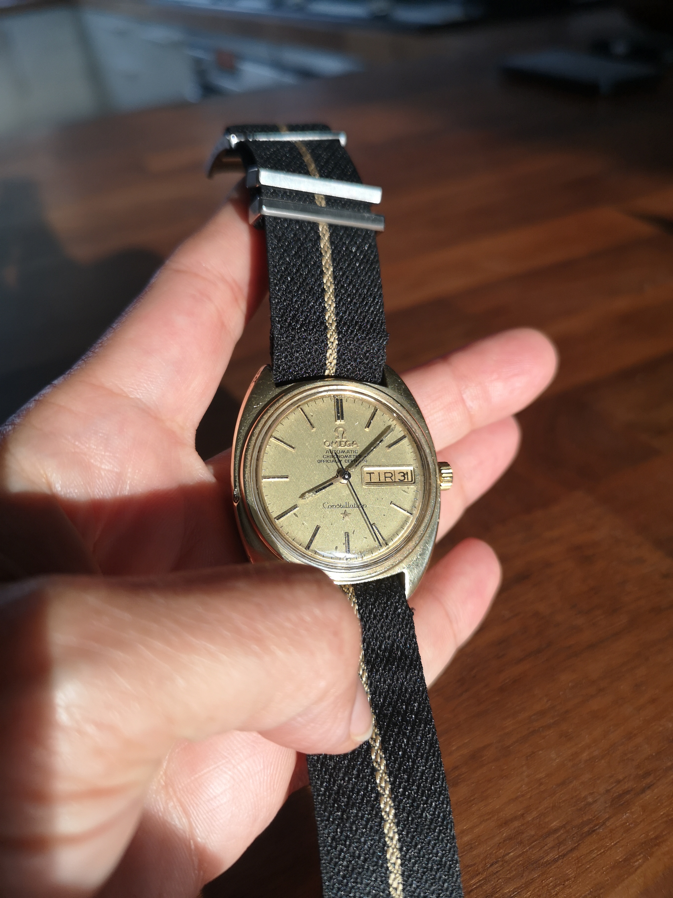

Hey everybody. Thanks for the help, I really appreciate it.
You guys are awoseme.
I but I bought it today because i live in Norway and the watch day/date is in norwagian and if i would buy outside of Norway, i would pay 25% more on tope of it. NOT COOL!
Well, Love make me do strenge things. I am doing it on myself right now :whipped: but at the same time i have a big small on my face. 馃榿.
