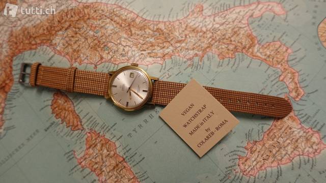

    Hello everybody
    Second post on the forum.
    I have found locally an offer for a Omega Seamaster Cosmic:
    Referenz 1660098
    Automatik Kaliber 1481
    Durchmesser 35,3mm (mit Krone 38)
    1970?s Jahre
    555chf without the strap
    bad quality photo attached
    However, after some research I have a weird feeling as the case and caliber fit more with an Omega Geneve. Cosmic are usually different. I could not find much info about the reference either.
    Do you think it is a redial?
    Is it a watch you would consider buying?
  2. Chi_spur Dec 13, 2018
    35
    20
    The photo is poor but doesn’t look like a cosmic case to my newbie eye just from the lug design. More likely a cosmic dial in a different case but can’t make much out from the photo...
  3. Edward53 Dec 13, 2018
    3,127
    5,384
    I would not consider buying any watch if I had that kind of doubts about it, plus it's not exactly cheap. You could get a 565 for that money.
  4. KingCrouchy Dec 13, 2018
    1,502
    5,665
    I would stay away from that deal. For that price you can get more iconic Cosmics.
  5. gju Dec 13, 2018
    7
    Thank you all for the feedback.
    I asked about the history of the watch, just for curiosity. I will post the info if something relevent comes up.
    Cheers
  6. X350 XJR Vintage Omega Aficionado Dec 13, 2018
    12,629
    29,961
    Reference 166.0098 is a Geneve.
  7. MCC Dec 13, 2018
    589
    529
    I would not trust the photograph I can barely see Rome on the map
  8. dan7800 Dec 13, 2018
    803
    811
    I have a cosmic from 68. The case looks completely different (front loader). Probably a franken.
    Move on
