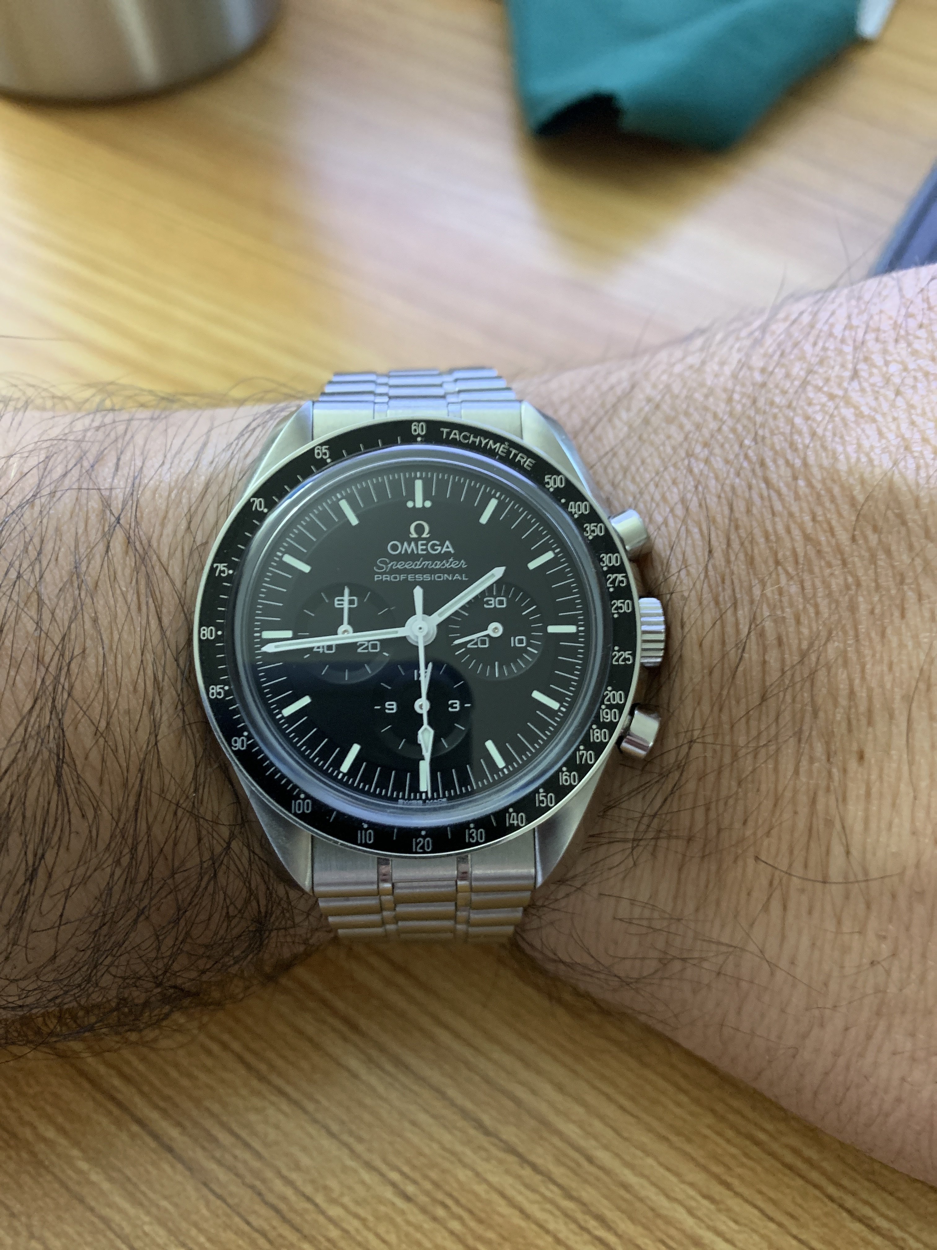

3861 Sandwich here.....got it 3 weeks ago.....just noticed this weekend that the 30 minute subdial register hand (@ 3 o'clock) can jump a few notches instantaneously (ie., from 17 to 12) if you tap the side of Speedy's case against your hand (without restarting the chronograph hand).....
Been using that counter as a date function so maybe the Speedy's movement can not withstand the sudden jolts and the force dislodges the subdial's gear from the arm in the movement that's keeping it in place (I'm not a watchmaker so I'm only guessing).....
I've been wearing my Moonwatch everyday since I got it and noticed it "jumped" after wrenching on my Harley (banged the Speedy a few times against the frame) and then a few days later after a long ride.....was able to duplicate the "effect" by tapping on the side of the case with the watch off against my hand....
I'm thinking of going to the OB where I got my Speedy, but I think they will just tell me it's not designed to take that kind of abuse.....I have noticed that when the chrono is reset it takes a really hard tap for the hand to "jump" vs when the chrono was stopped at a certain minute interval (for the date).....
The experience has gotten me to second guess my purchase, the robustness of the Speedy (although this is my first auto chronometer), and lessen the enjoyment of my first premium watch.....I am now thinking it should not be used as an everyday tool watch but rather for a nice night out with the wife or friends....
Looking forward to your replies and if anyone has had similar experience with the 3861 or prior generations....
...........................................................................................................(although this is my first auto chronometer),
I'm not sure whether that's enough "abuse" for the watch to behave like that.
I would take it in.

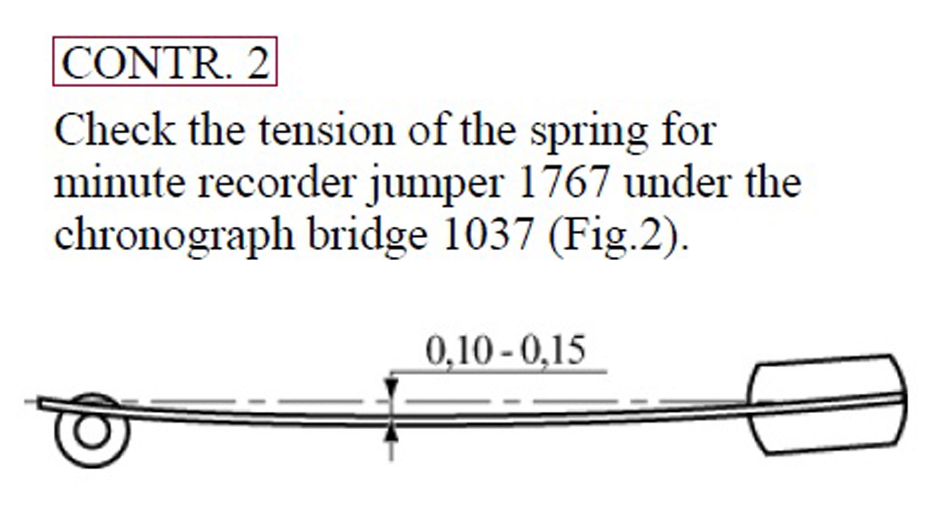

There’s a small spring that acts on the minute counter jumper that keeps the minute counter in place when the chronograph hasn’t been reset (so when it’s running or stopped).
The minute counter hand shouldn’t move with a “tap” but it can certainly move from a shock in the right direction. Can’t say if what you are experiencing is normal or not without knowing how hard this “tap” is...but my guess is what you are calling a tap is not really just a tap.
The spring has a specific adjustment that is part of the chronograph controls that are defined so it would e unusual for it not to be adjusted properly on a new watch. The tension on the spring can be increased, but doing so means that it will take more torque to advance the minute counter, and this can cause the watch to stop as the minute counter is tripped.
Cheers, Al

Just FYI - these are the adjustment parameters of the spring, which is located on the underside of the chronograph bridge:
Cheers, Al
thanks for the info...I appreciate your expertise and taking the time to post on this topic.
to provide more detail, tap = the following:
1) remove wristwatch
2) hold Speedy with your hand
3) Approx 18"-24" away quickly swing the hand with Speedy towards the other free hand
4) the side of the Speedy case is slapped/tapped with the free hand abruptly stopping all acceleration.
When the hand was in the 17 mark in the minute counter, I only have to "tap" it once for the hand to jump to the 12 minute mark. When I reset the chrono it took 4-5 taps for the hand to move from the 30/0 mark to 12. Perhaps there is more tension in the spring when the chrono is reset to "lock-in" the hand at that position vs when the chrono is stopped?
Anyway, since it can certainly move from shock in the right direction, I'll just remove my Speedy when I'm working around the house/bike/cars. The "jumping" does not occur when I normally wear the watch, desk diving, self adjusting the watch on the wrist when you shake it, etc..
I don't have have any gouges or scratches (that I can see) and I'm very happy with how accurate the Speedy is...

So based on this, the watch is not behaving any differently then what I would expect, so I don't believe there is anything to fix here.
When the chronograph is running, or when it has been run and stopped (but not reset) the only thing holding the hand in location is the jumper and spring here:
It's a small finger that drops in between the teeth of the wheel. When the watch is fully reset the hammer is on the cam, so the minute counter cannot move:
Cheers, Al
I’ve had my 3861 sandwich for a month now, and I’ve experienced the same 30-minute sub dial “jump” that you described.
I also keep the chrono band stopped at 37 seconds (so the omega logo is unobstructed), and after tossing around a football with friends, I noticed that the 30-min subdial had jumped to the 10-min mark.
This was routine pitch-and-catch with a nerf ball, seemingly less jarring than what you described. This has only happened once, and I haven’t been able to replicate the issue. Also worth mentioning that I’ve had no other problems with the piece - it’s been incredibly accurate both before and after the incident.
I love my speedy, but I’m concerned (like you) that routine vibrations may cause that subdial hand to lurch forward…
